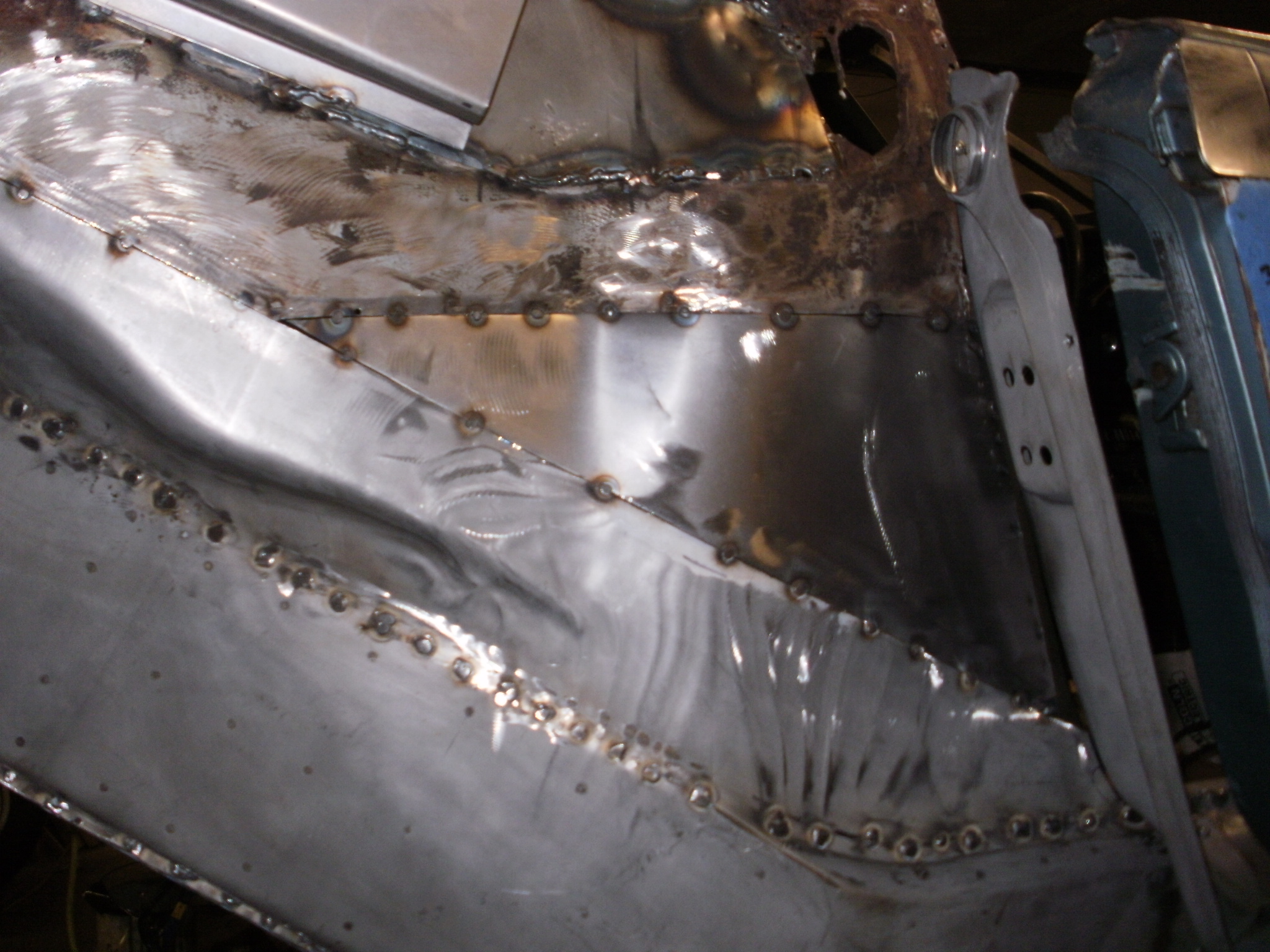

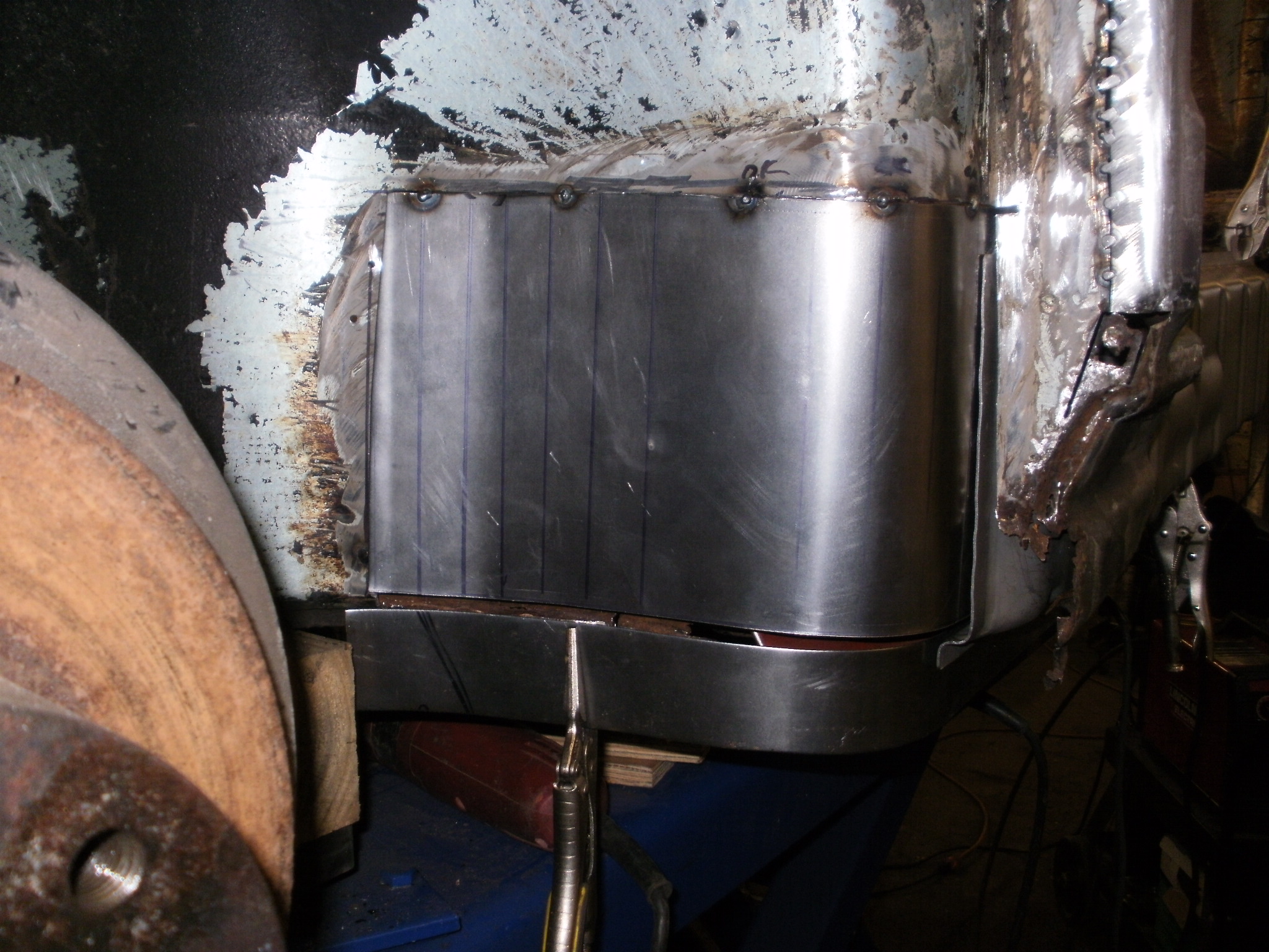

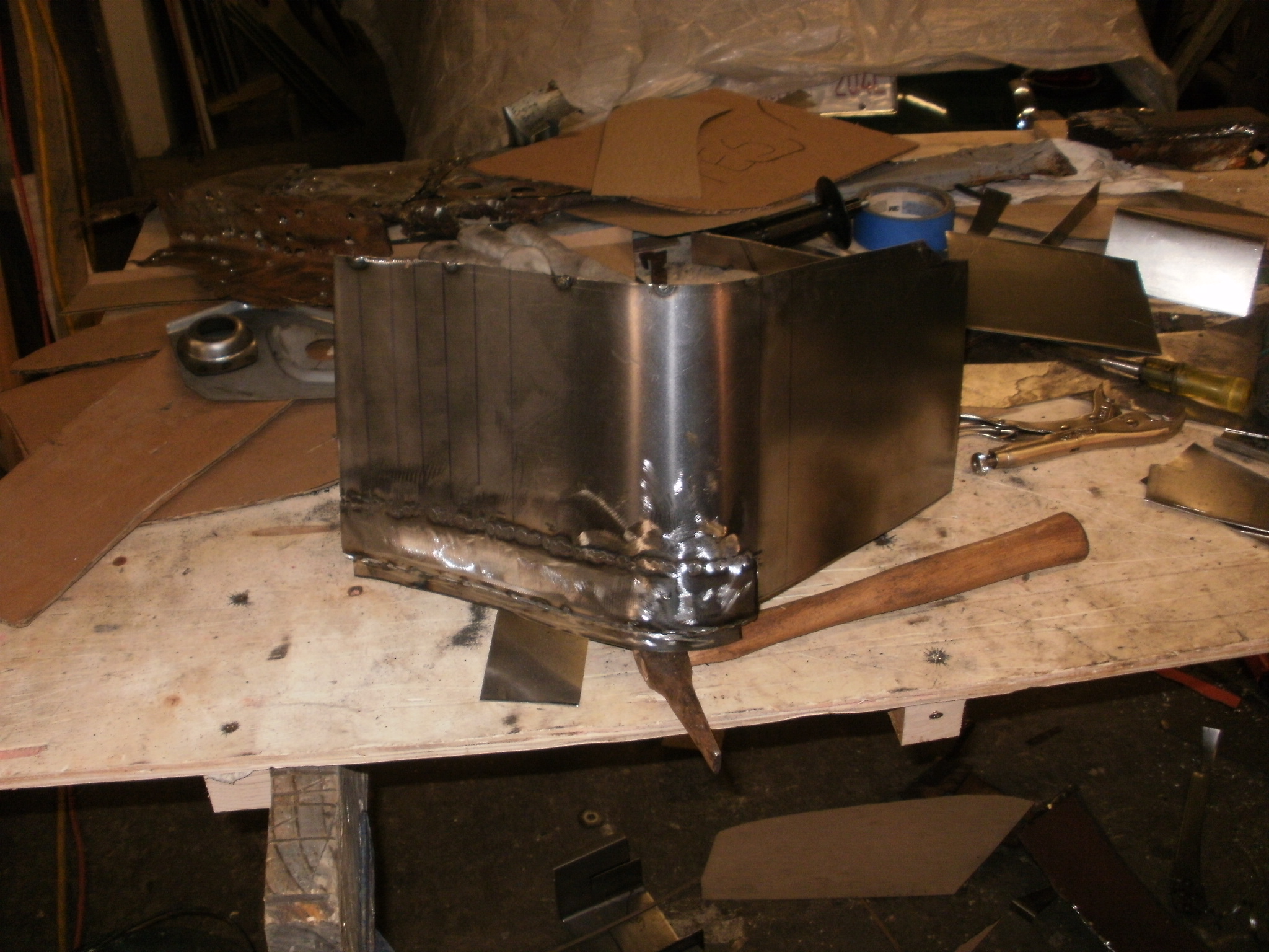

Getting closer to having the passenger side complete
I have been lucky to be able to sneak away from the office for an hour or so

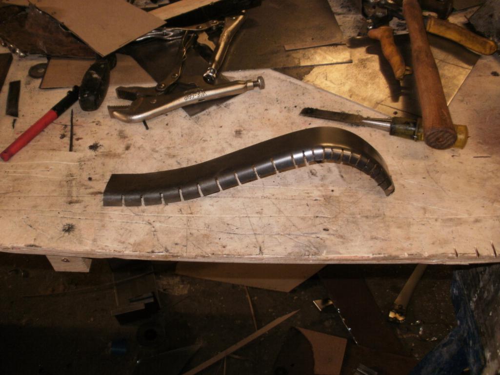

Next up is completing the additional structural (double layer) to the engine side Attached Image
Being careful to stagger the splices and fit everything reasonably tight. 18ga across the board

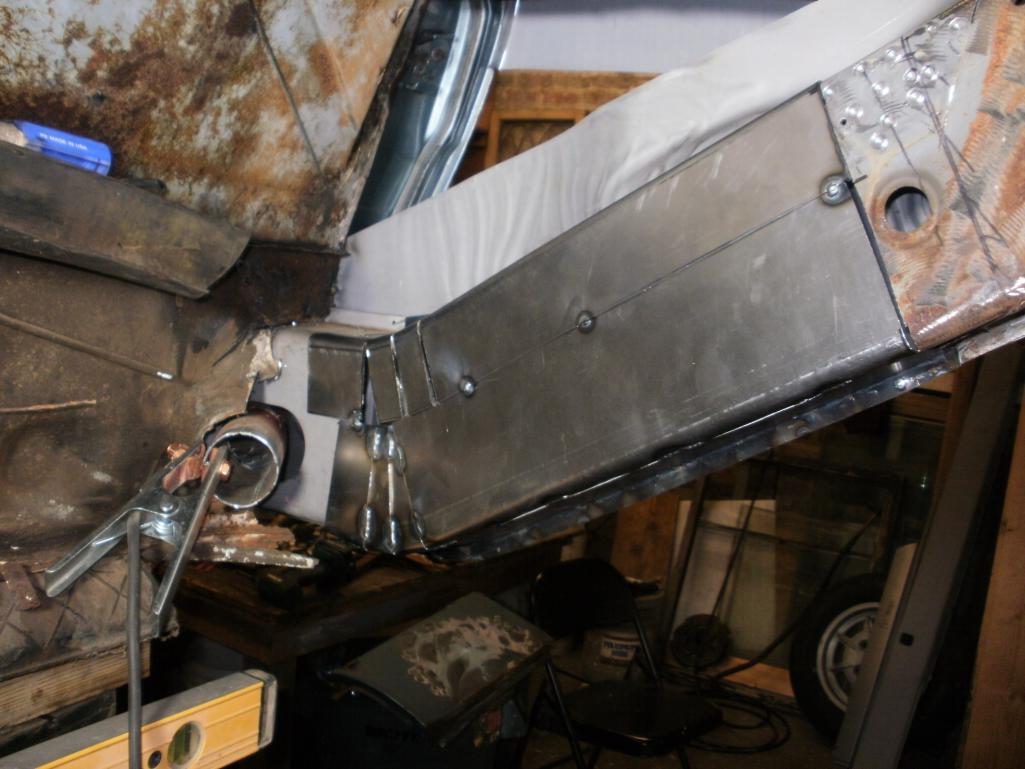

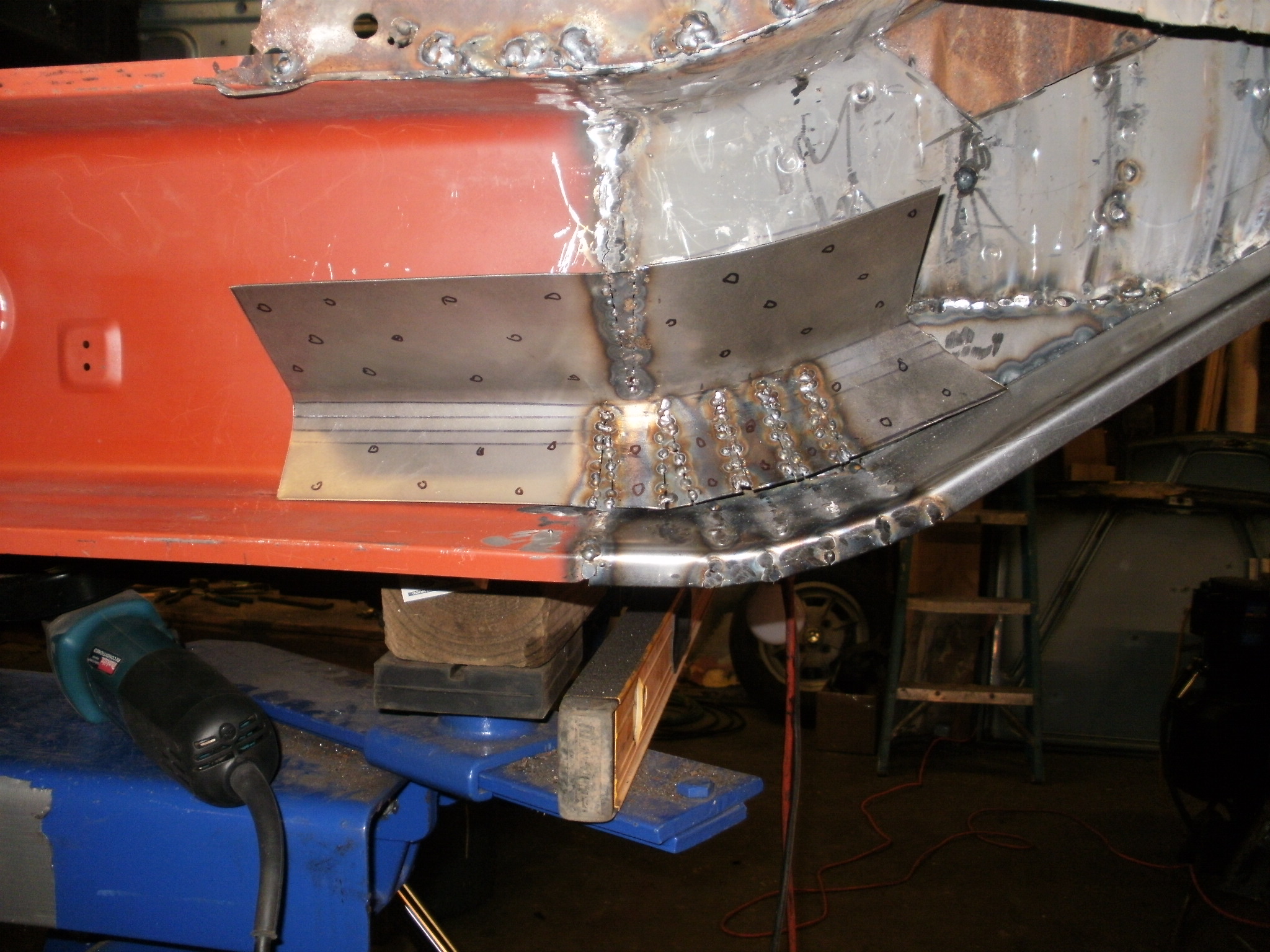

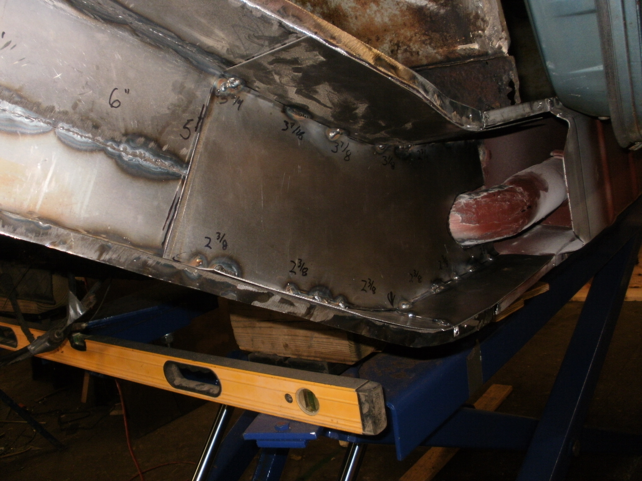

Double layer to the inner half (engine side) of the long extensions
Time and patienceAttached Image
Checking, re measuring, re checking, got things within a 2mm. From what I gather from the factory book 2mm is the number

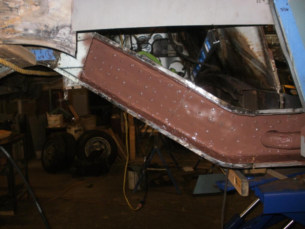

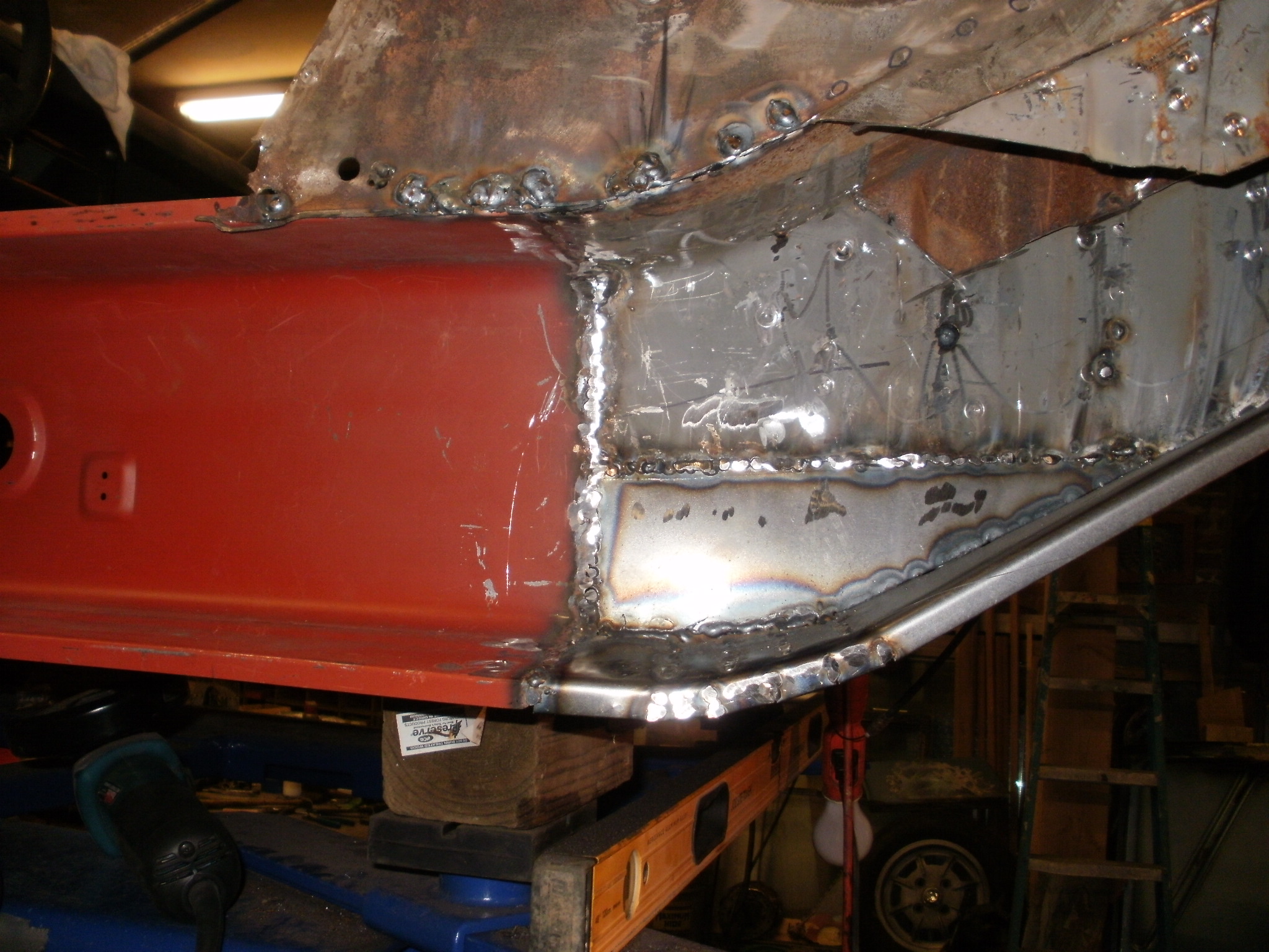

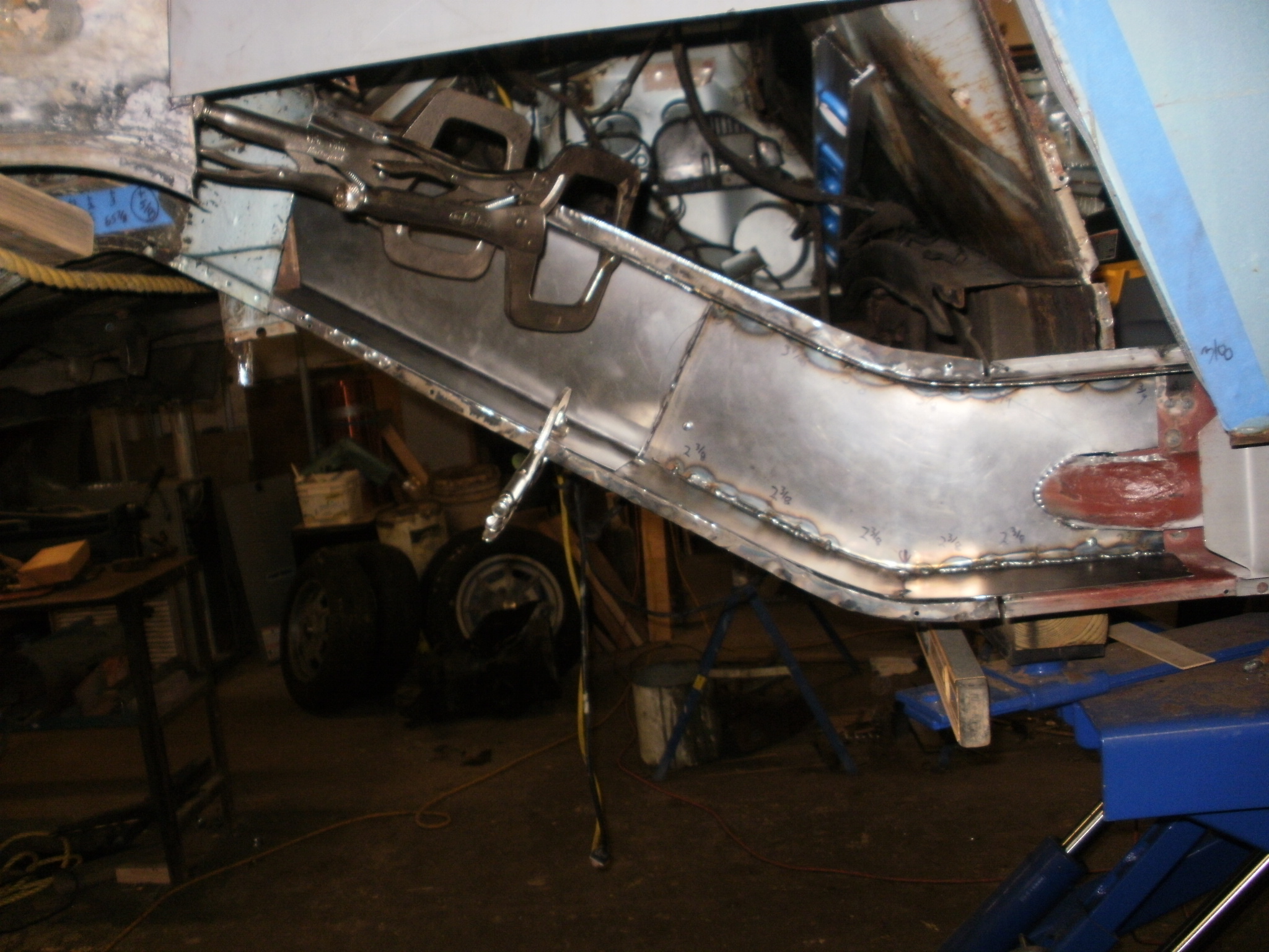

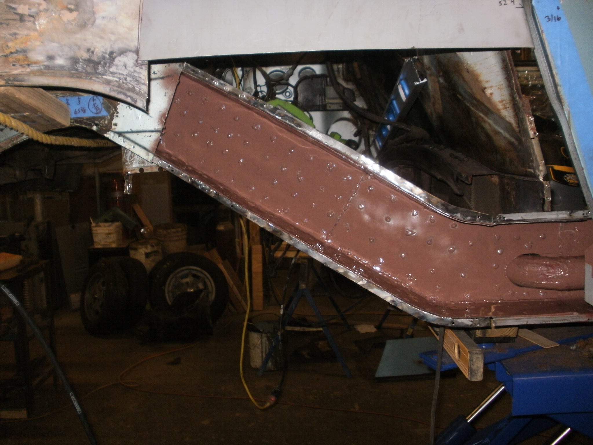

Inner section all welded and primed
Got the double long section wrapped up, plug weld the outer and move on
Cover fit, ready for plug welds/primer and on to the next projectAttached Image

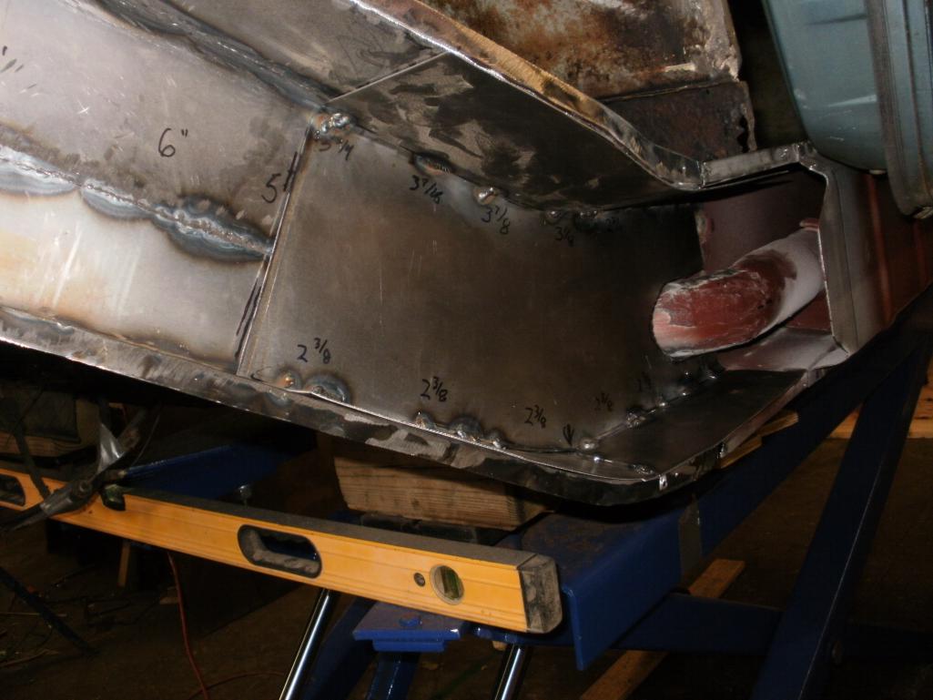

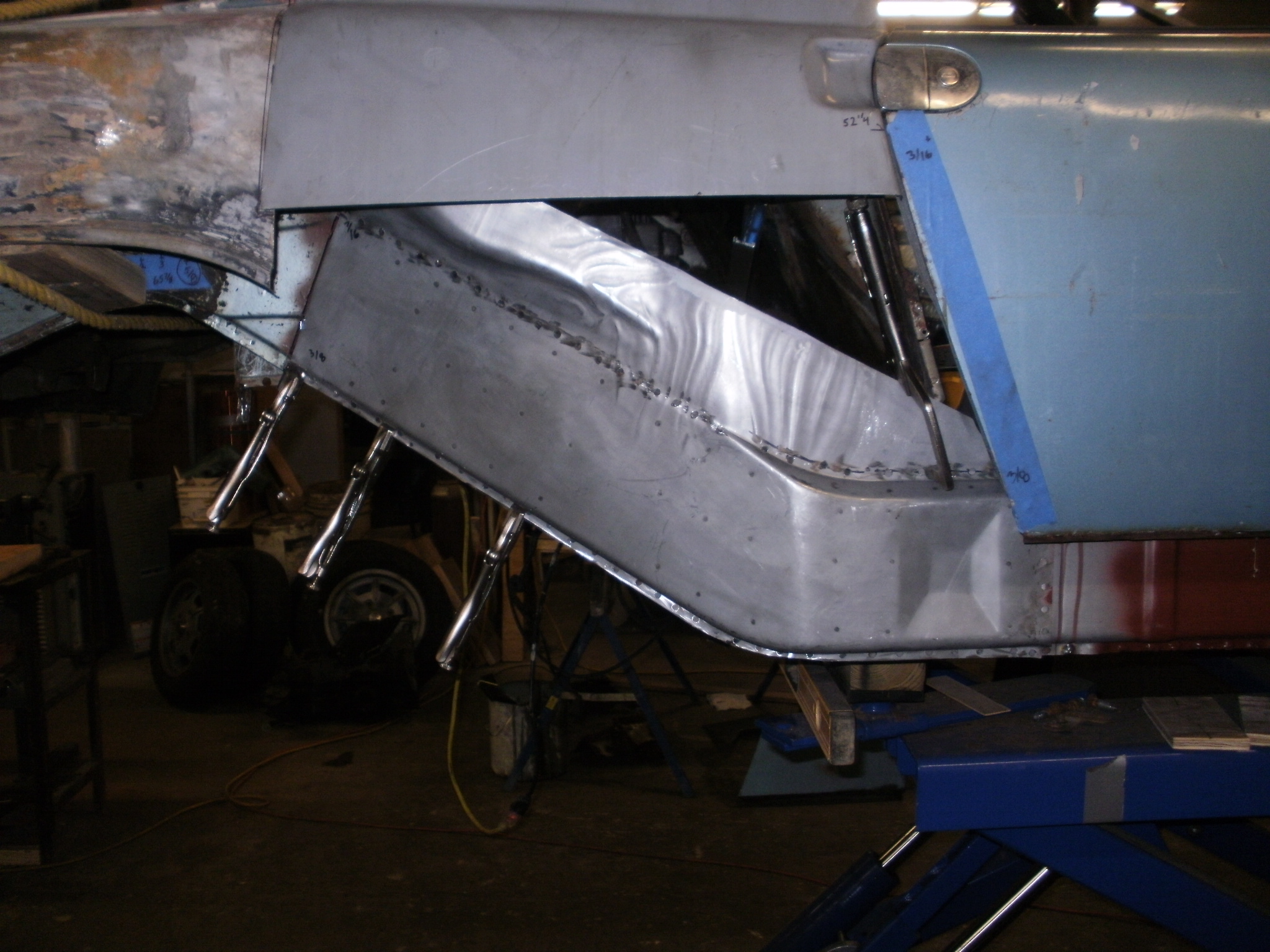

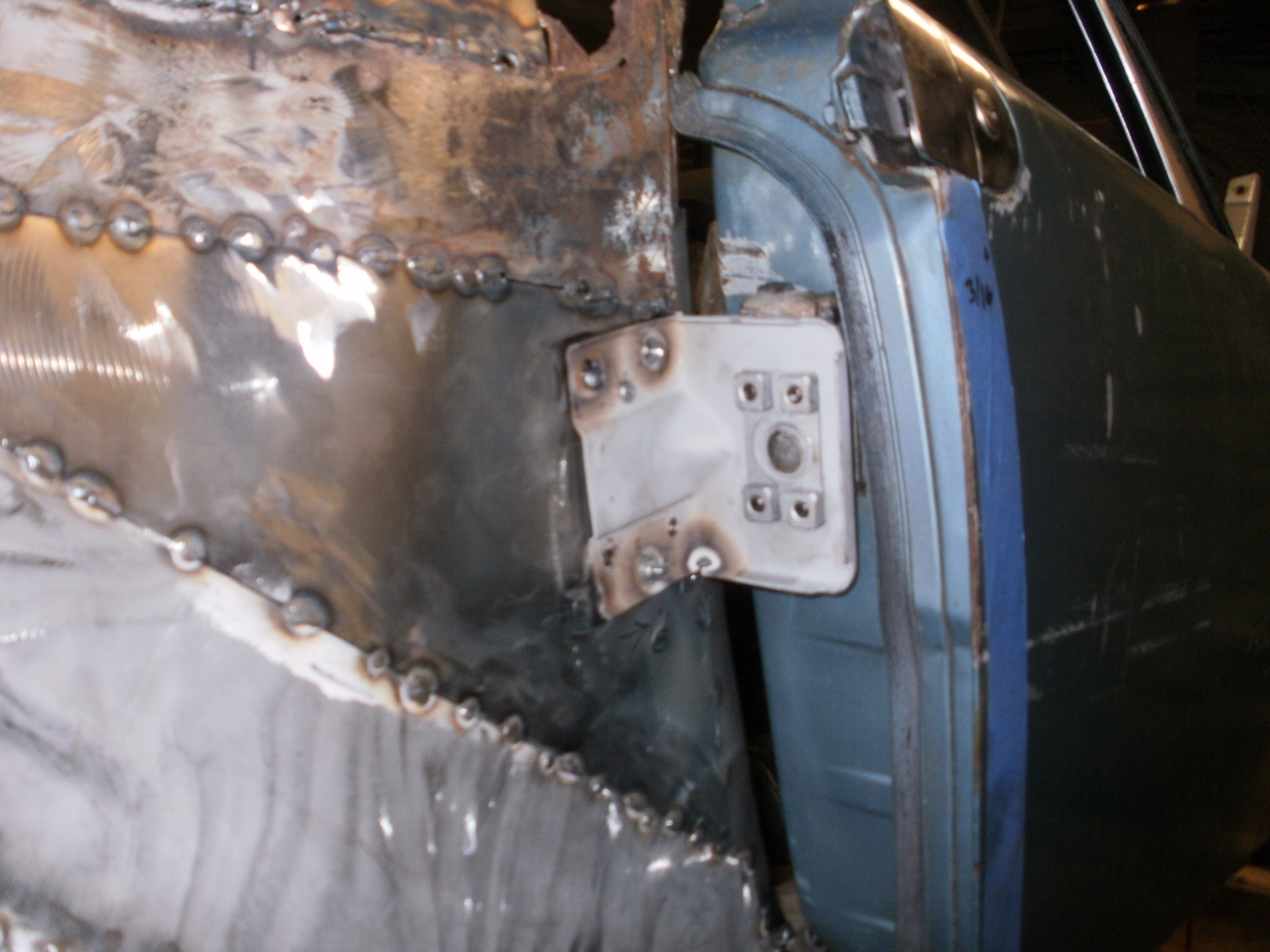

Passenger long just about completeAttached Image
Fitting the new RD door jamb and having the passenger door latch for the first time in 30 years, VICTORY Attached Image
No photo yet, but I was able to test fit the targa roof panel, fits great. Also, I made a template fitting the windscreen frame and targa bar. Checked it from side to side, all is good. I used cardboard then 3/8" AC plywood. from what I can tell, this double checks several body dimensions/geometry

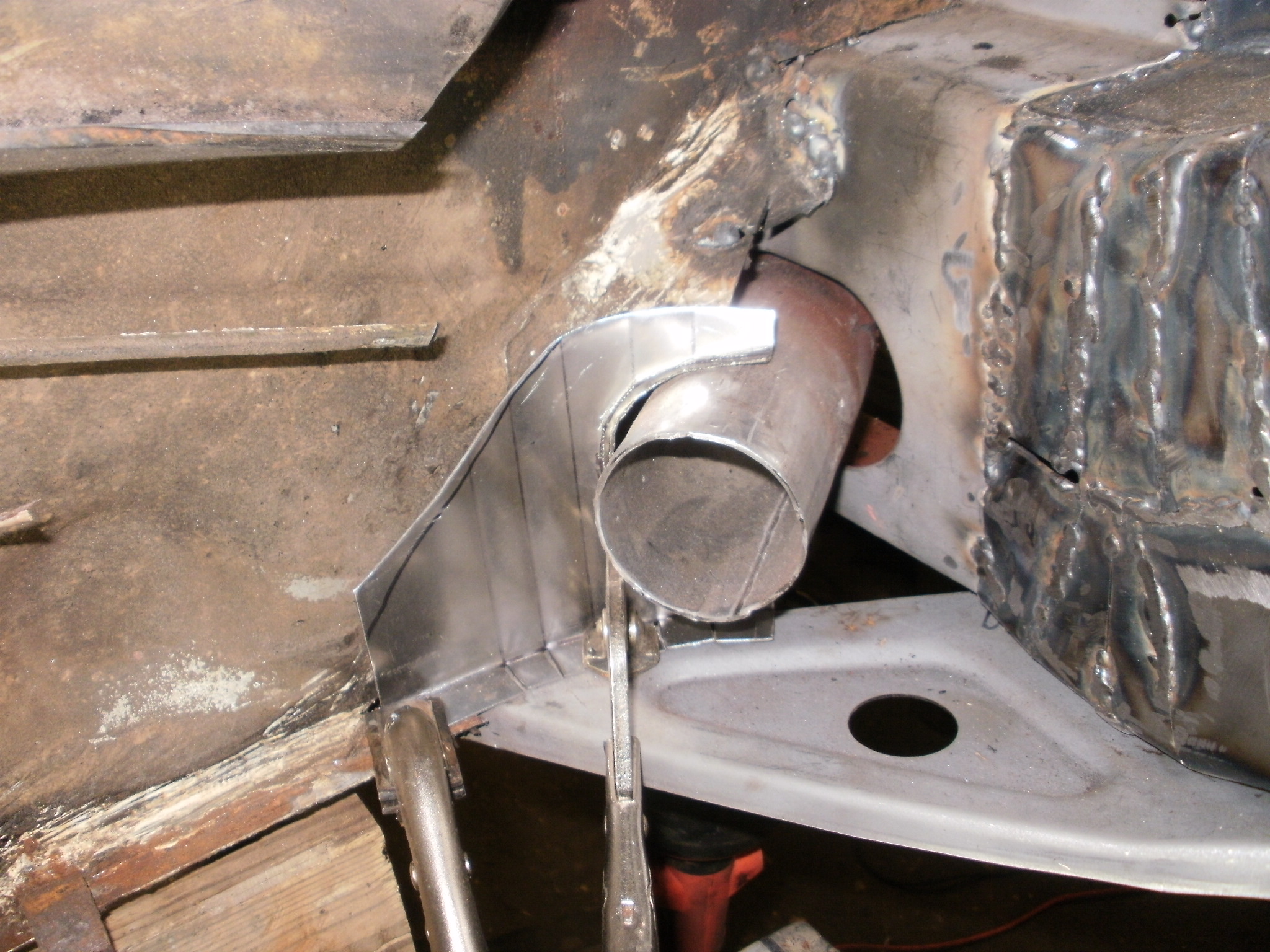

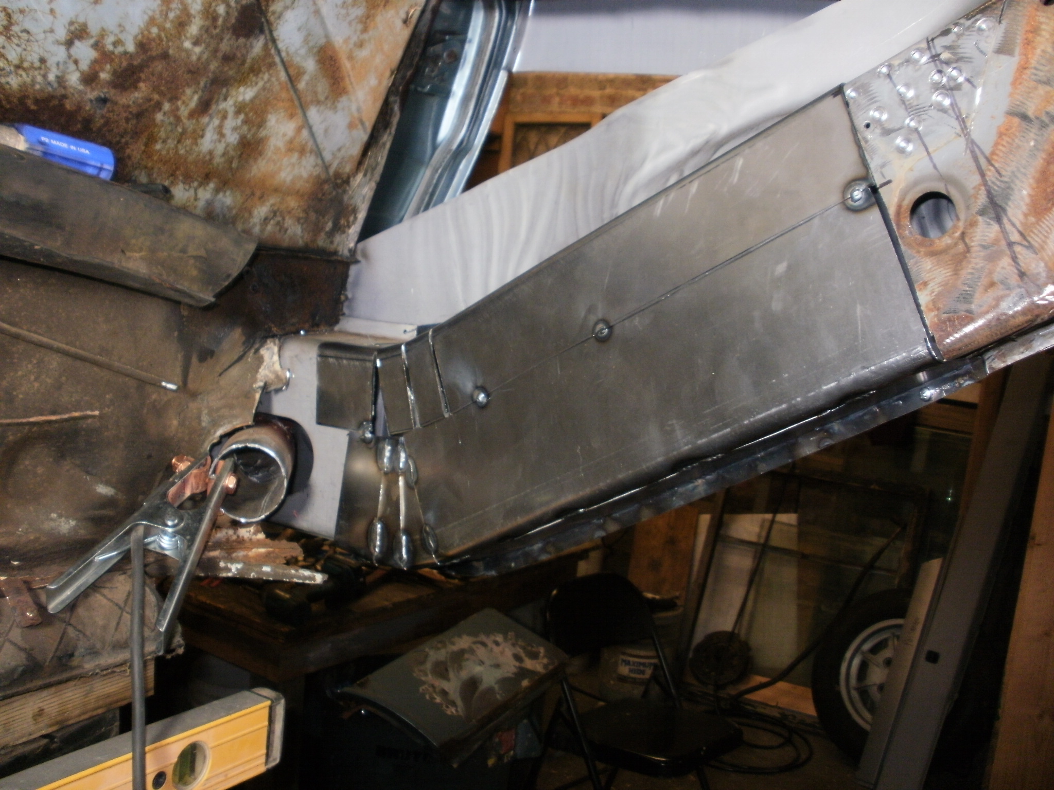

Yep, I went and did it, made the jump for a /6 conversion. There is this 2.7 short block laying around the shop, getting moved everyday because it's in the way. I placed an order with MB911 for his oil tank and engine tin to get the conversion started. I am looking for a Western New York shop to fix a few broken head studs and get the 2.7 along the path. In my spare time I got started on the drivers side: Attached Image
Kind of reminds me of dissecting a frog in grade school

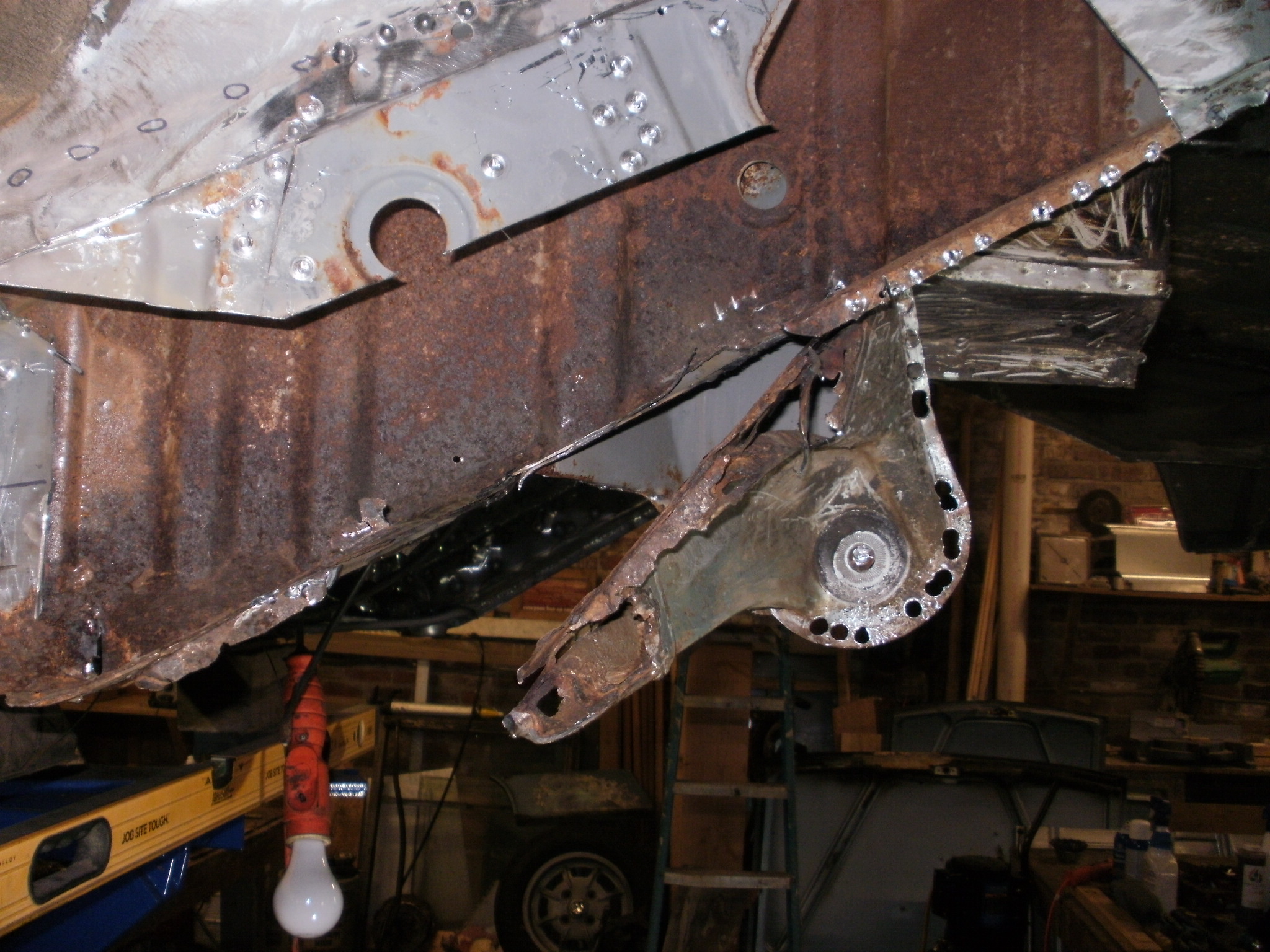

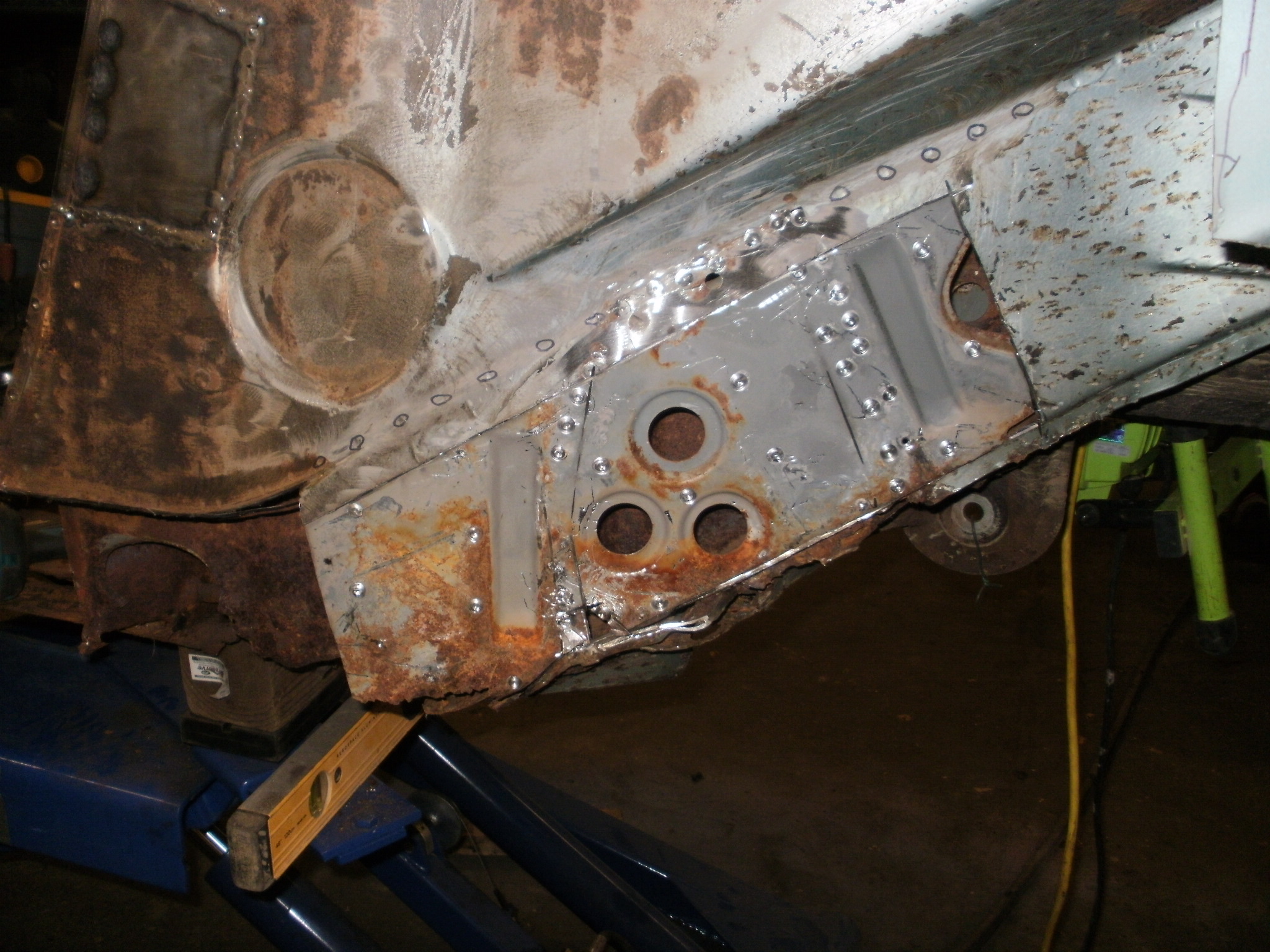

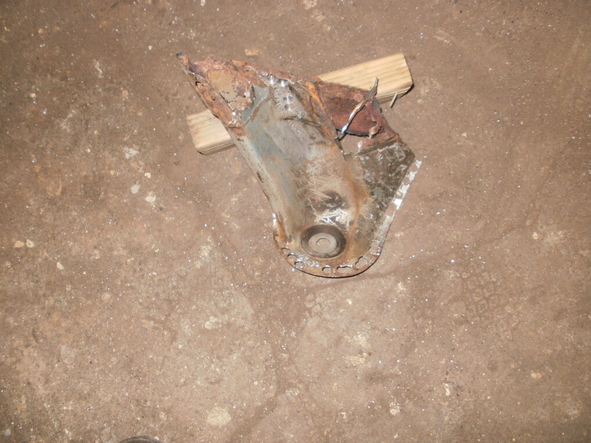

And I was thinking the drivers side was in better shape, fooled again!!Attached Image
From what I can tell, these trailing arm mountings are not being reproduced, if so please forward the contact information. Otherwise we are re creating from scratchAttached Image
Not for the faint of heart, but none of this is
914_teener
post Feb 1 2021, 01:40 PM
Post #150
Posts: 5,270
Joined: 31-August 08
From: So. Cal
Member No.: 9,489
(IMG:style_emoticons/default/blink.gif)
Curious....no rust encapsulator for the internal parts or primer for the inside structural peices?
I think RD makes that peice but sometimes they are out and need to build inventory.
That as you probably know is one of the more important suspension tie in locations.
