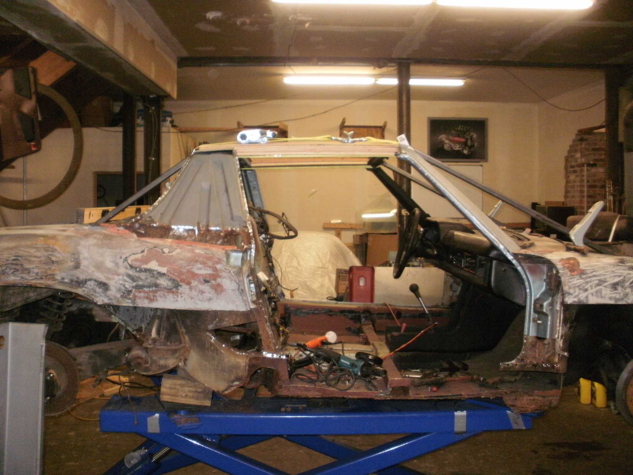

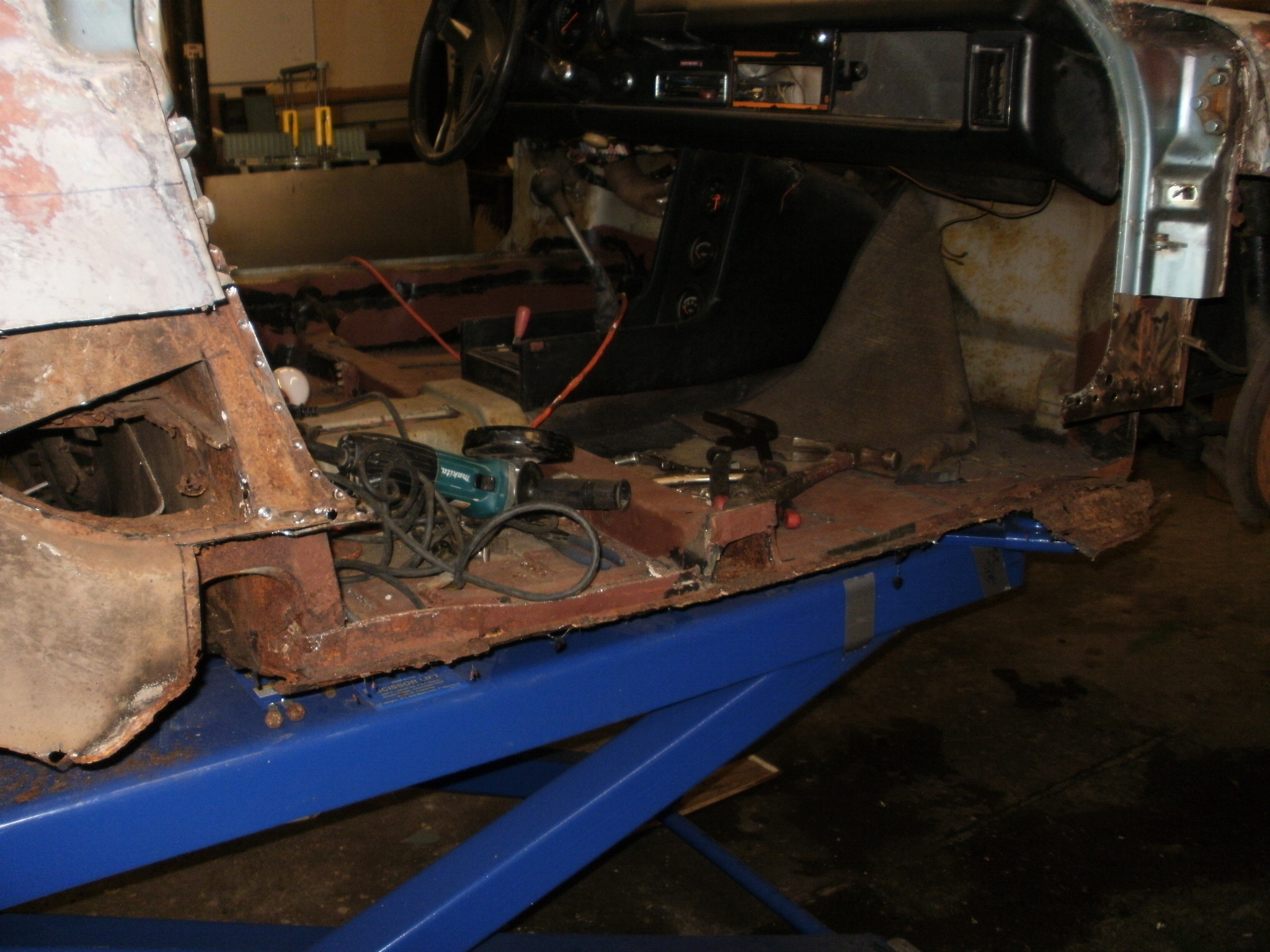

Had some progress in the shop today. I went with a different method of holding the body while she is being cut apart. Old inner long finally gave it up, but not without a fight.

Holy cow.

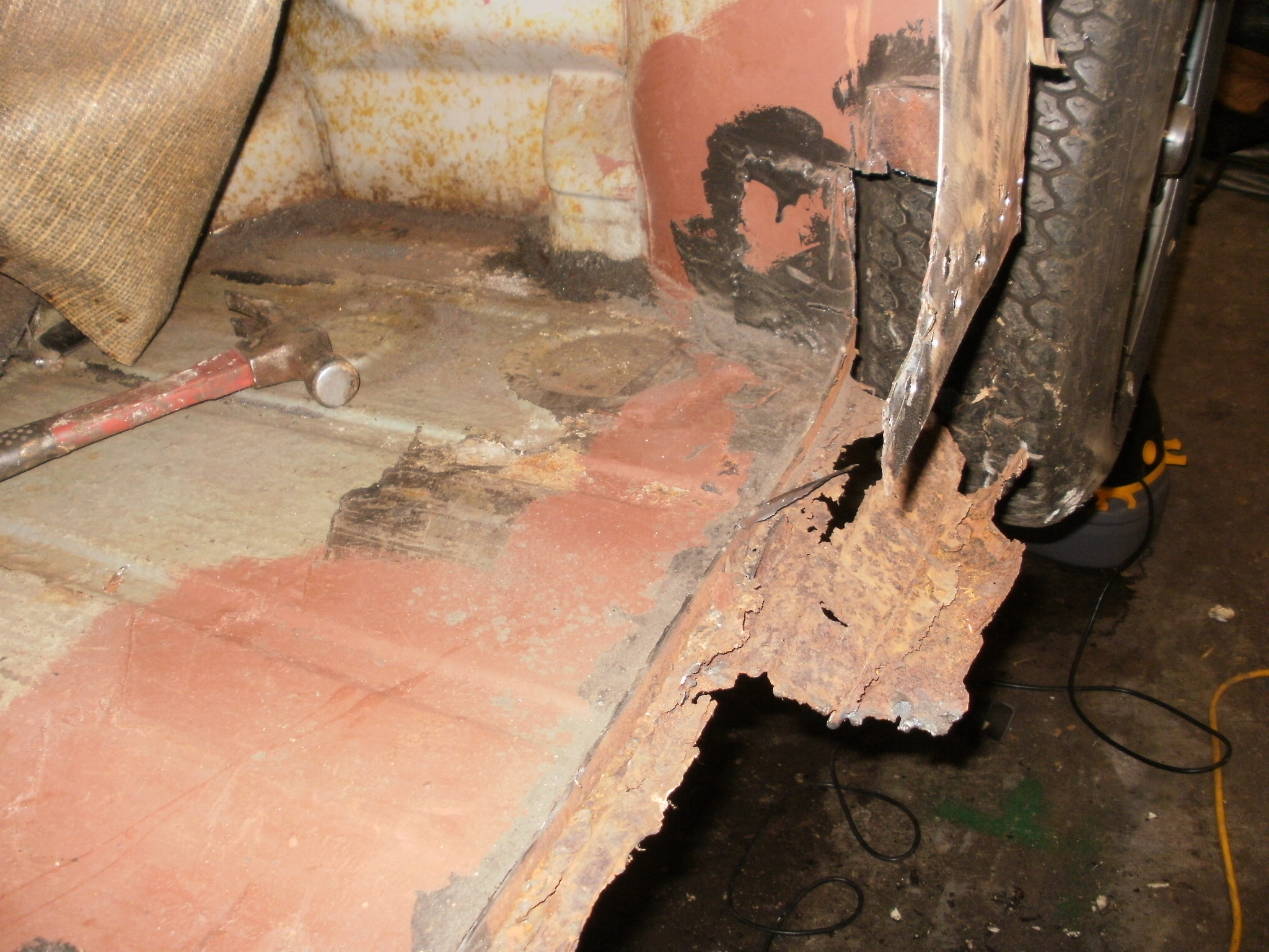

You should buy that tub from that guy in the UK...for $1,500.
Man...the entire long is kaput.
