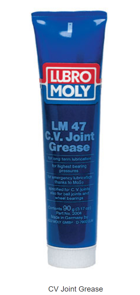

Curious what the consensus is . . .just bought 4 of these from PMB - shot in the dark for me:

Lubro Moly is what I use.

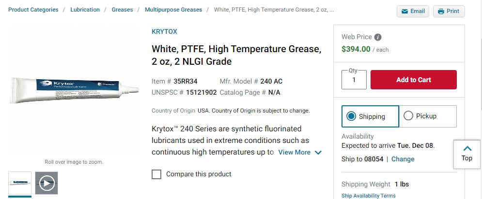

Magic Elixer is expensive - sure you want it? (IMG:style_emoticons/default/happy11.gif)
OK - Joking ONLY -- would not be appropriate for CV's. Again -- Not Serious before everyone gets wound up.

QUOTE(Superhawk996 @ Dec 4 2020, 06:40 PM) *
QUOTE(bbrock @ Dec 4 2020, 05:56 PM) *
What??!!! Do we have a unanimous consensus? Is The World broken? This never happens. (IMG:style_emoticons/default/av-943.gif)
Thanks all. Repacking was my leaning also but wanted to make sure there wasn't some magic elixir in the factory grease that could never be replaced.
Boy I hope you're right about these, @Superhawk996 , for what I just paid for this ambrosia - I could have had Tarrett axles . . .well, at least one.
