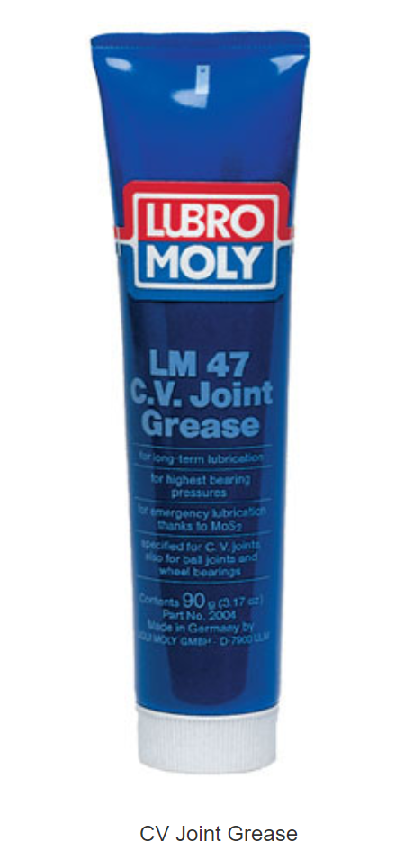

914Sixer
Lubro Moly is what I use.

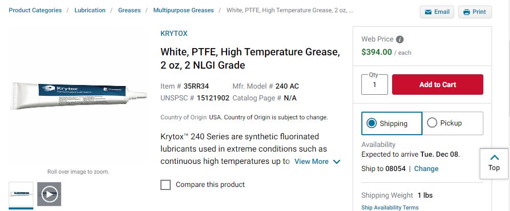

OK - Joking ONLY -- would not be appropriate for CV's. Again -- Not Serious before everyone gets wound up.
