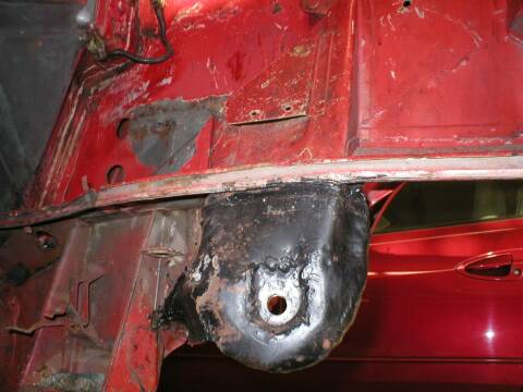

i'd say, check the suspension console ear first. initial symptom of a cracked ear is sagging of the car. once it breaks off completely, the car will just fall down onto the tire. not gud ...

Don't let someone else do the repair half-a$$ like the PO on mine...
Here's the beginning of the repair on my website.
