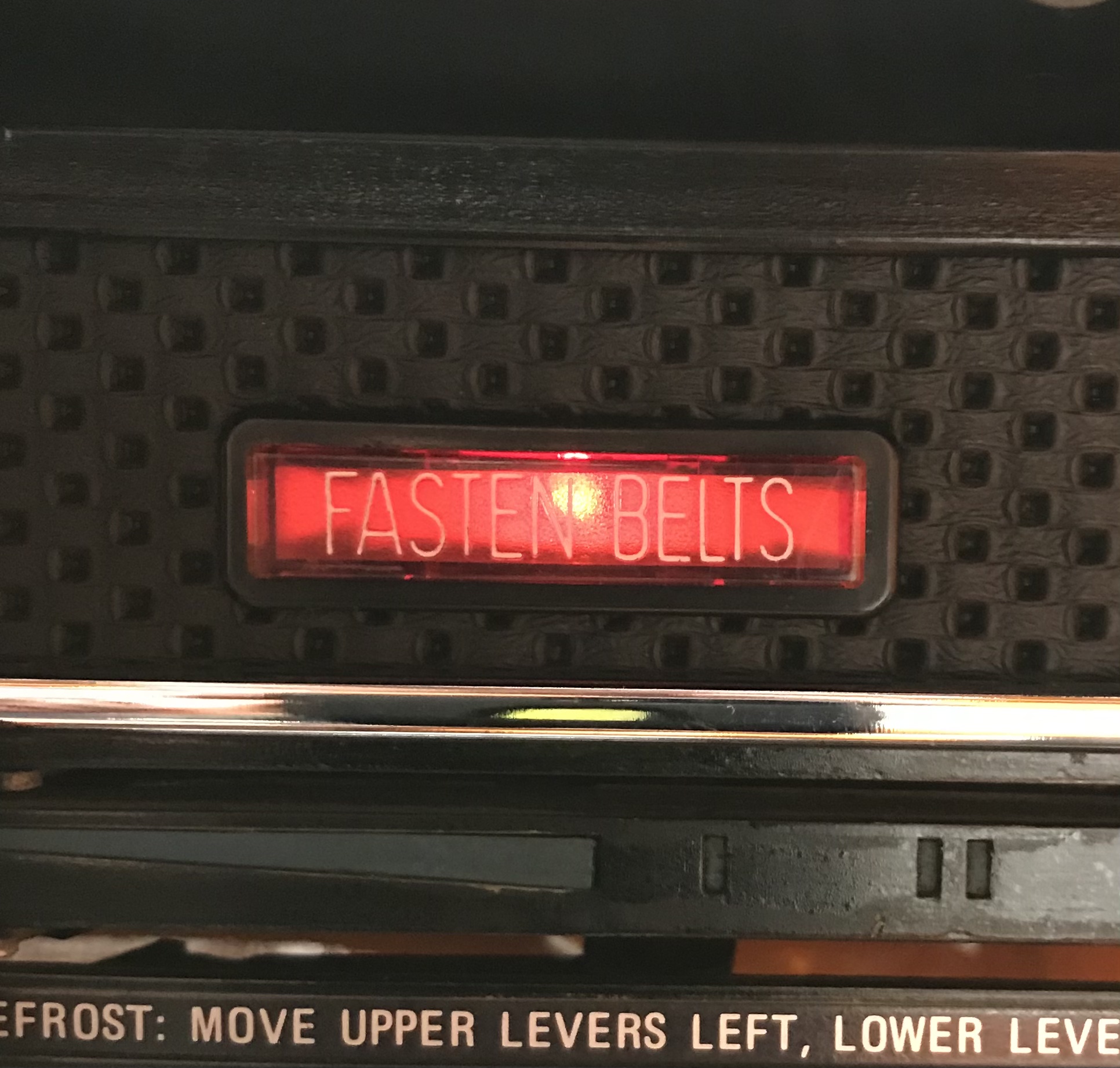

So I’ve been trouble shooting my Fasten Belts for a few days and not sure if I’m actually chasing a problem. With the ignition key in the off position and the key out with closed or open doors the light stays lightly dim. Thoughts?
