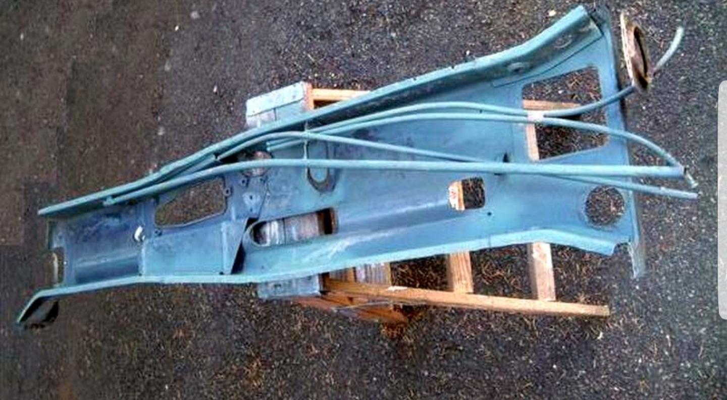

Handy pic for reference points that I located here on World
