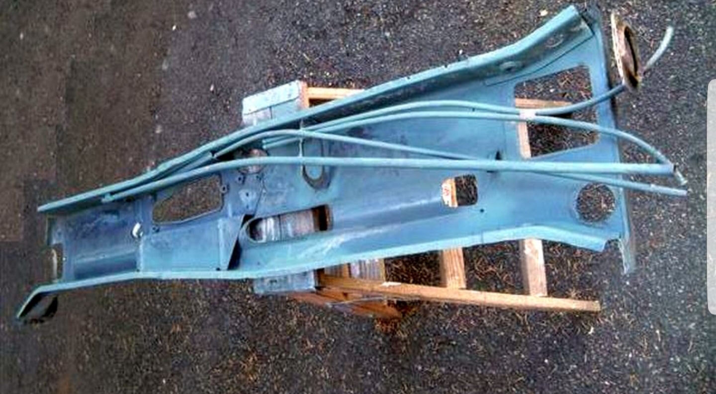

Maltese Falcon
Handy pic for reference points that I located here on World
