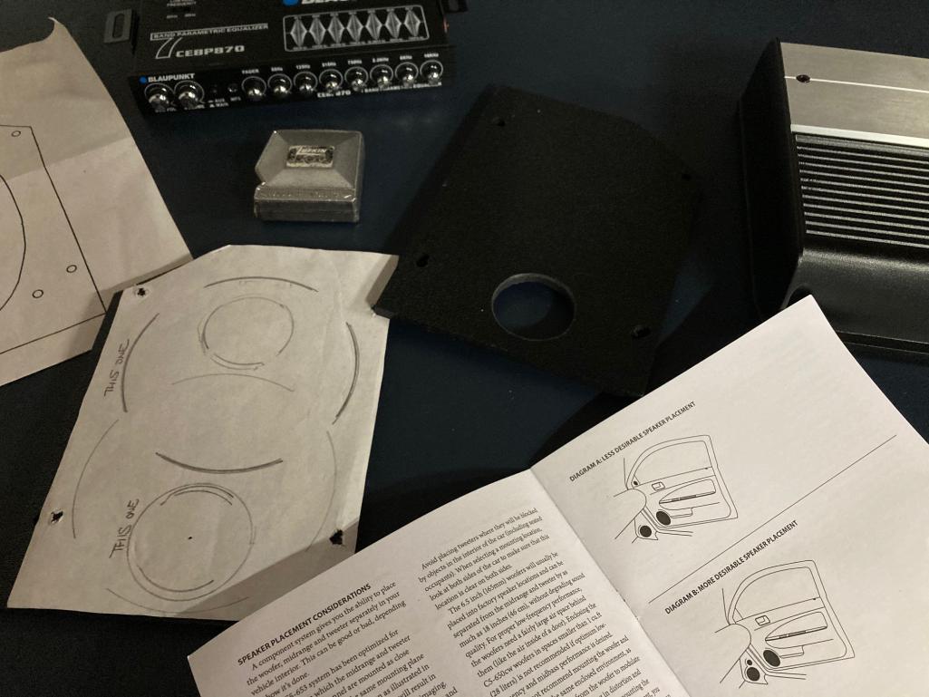

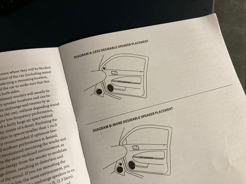

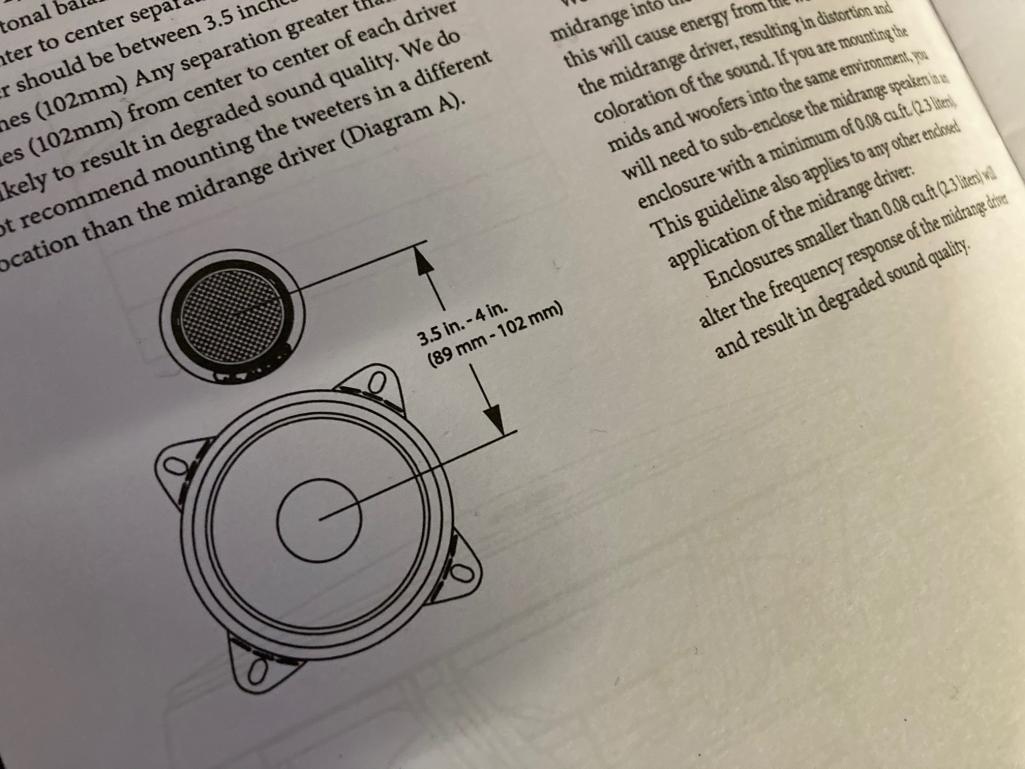

I never read the manual, either—but I was curious what it might say about ideal speaker placement.
As it turns out, the 914 speaker enclosures provide a place to put the tweeters and mids in the preferred location, and I'll keep the larger speakers in the doors since they're already cut.

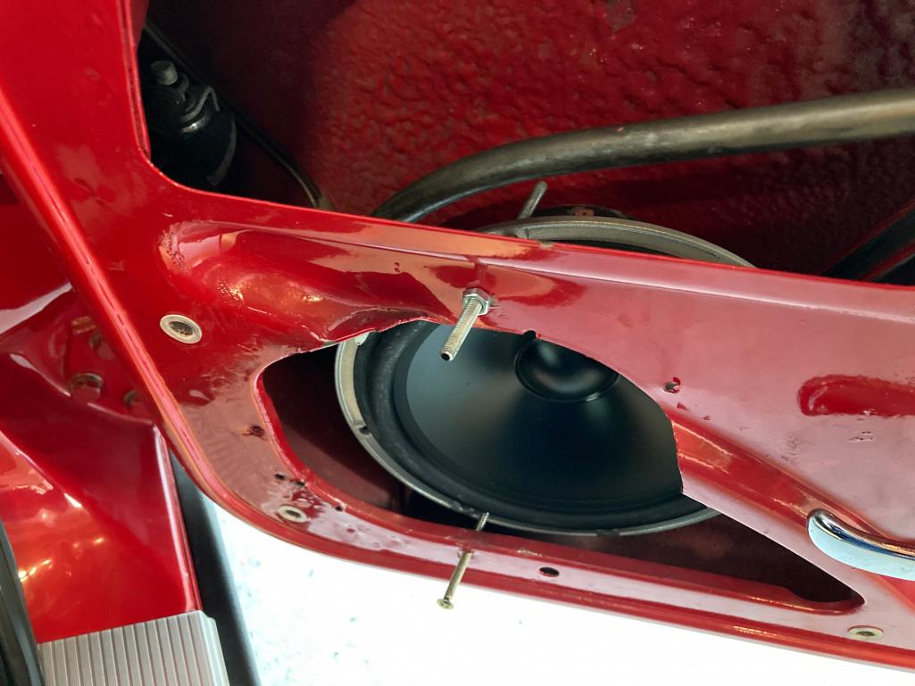

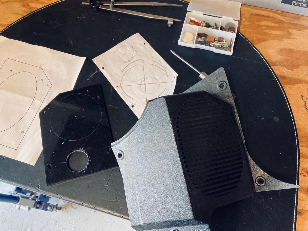

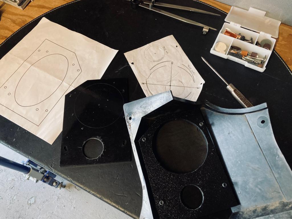

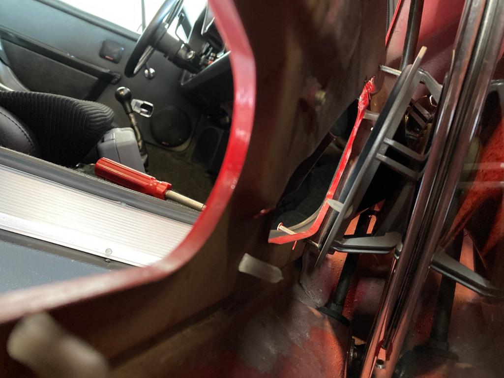

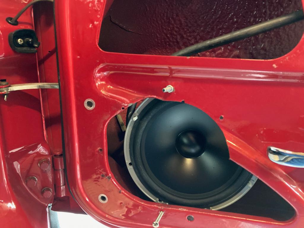

The mids & tweeters will easily fit into the factory enclosures with the recommended 3.5- to 4.0-inch distance between their centers.
The door speakers will be trickier. The "pro" installers butchered my inner doors back in 1990~. While it's surprising how rigid the doors remain, I'll have to cut even more steel to get the new 6.5s in the same way. So I'm looking to see if I can mount the 6.5 from the other side. (I've never liked the way the speaker has to be pulled to remove the door card, or the way it pinches the door card.) Turns out the 6.5 can be maneuvered into the door, and could be securely held there with three mounting bolts. A curved (3D-printed?) plastic "mounting ring" (1/2 to 2/3rds of one anyway) would add rigidity and aid with sealing, while a Metra cover would protect the back of the 6.5 from rain water. Also thinking about custom cut styrofoam to close the 6.5 into the oddly shaped relief.
Short term, I'll simply bolt my old Boston Acoustics speaker grille to my existing door card, but I have a pair of ABS door card backings from 914Rubber and am thinking about "venting" the 6.5s through holes punched into the depressions in new basketweave over holes drilled into the ABS door card. Not sure this is viable, but it would allow for invisible 6.5s—much like the factory speaker holes seen in early 928s and a variety of other models… (IMG:style_emoticons/default/idea.gif)

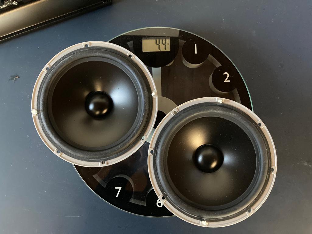

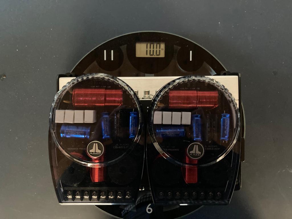

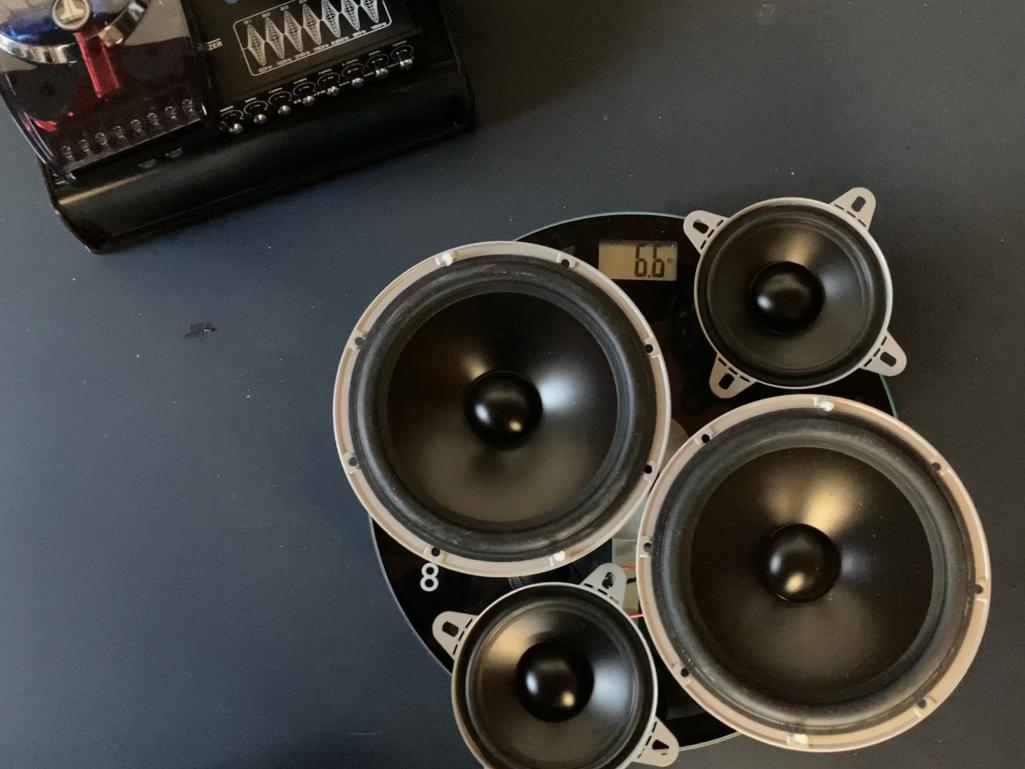

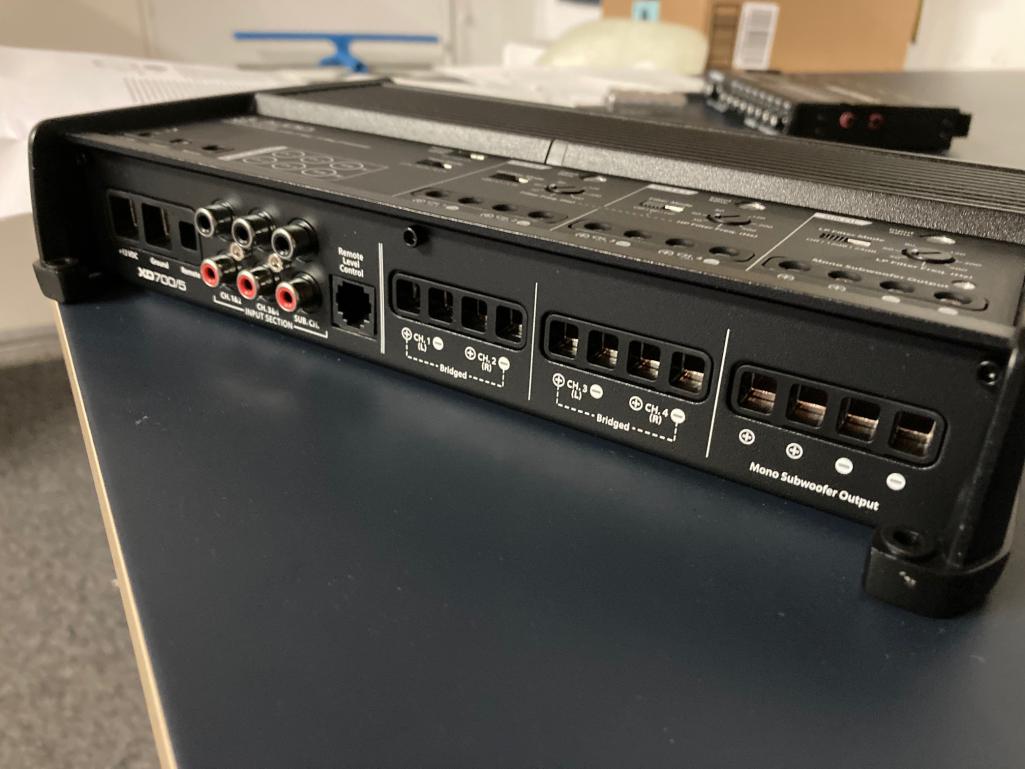

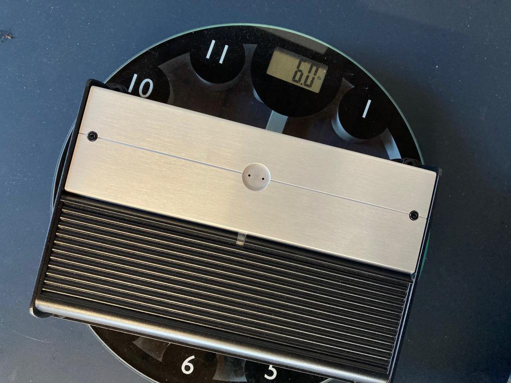

I was concerned about #4, as the new amp felt a lot heavier than the outgoing Pioneer amp. The crossovers felt chunky, as well. So I grabbed the bathroom scale. While I wouldn't trust it for postal use, things don't weight as much as I feared. And no head unit helps.
EQ + amp + crossovers > 10 pounds
Six speakers > 6.6 pounds

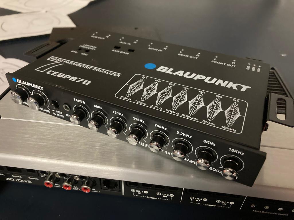

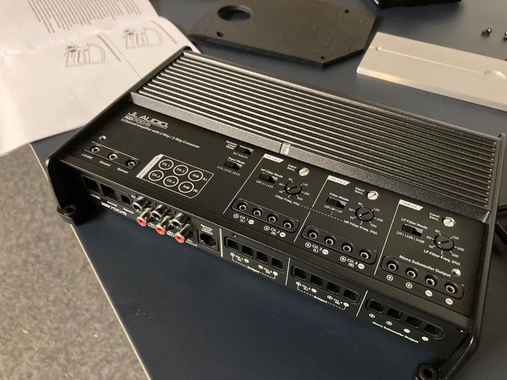

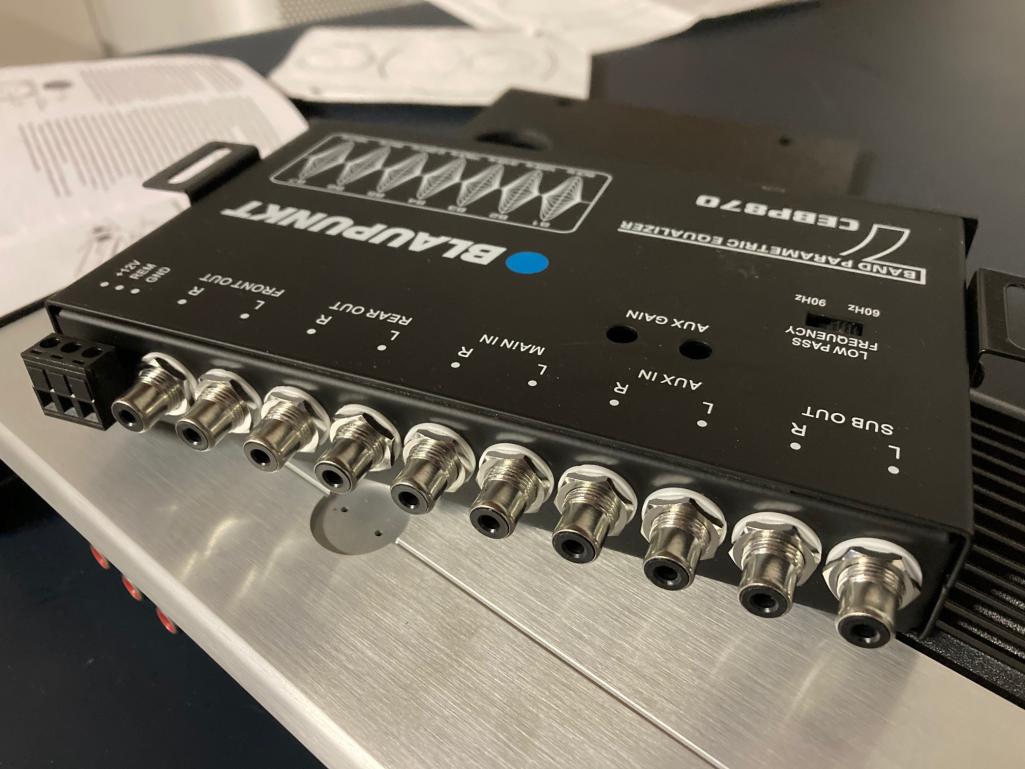

Goals with the amp are to power the six-speaker setup while providing easy integration of a rear channel and/or a subwoofer down the road. Where the old amp was fan-cooled, this one uses traditional heat sinks.
EQ will be used mainly to accept/attenuate audio from a smartphone and to provide a remote line to turn the amp on or off, but it's nice to have the ability to adjust things.

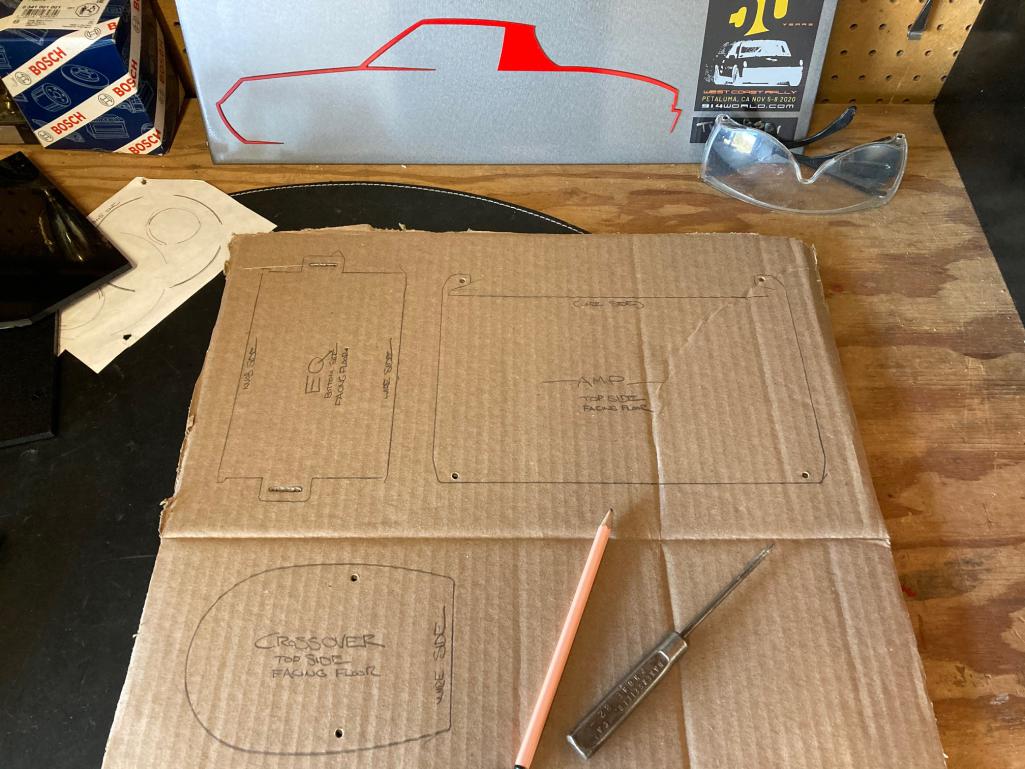

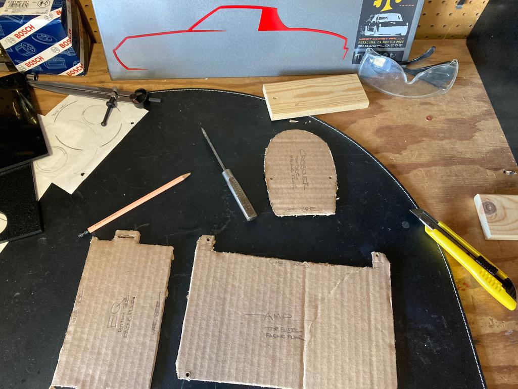

With speaker locations figured out, next up is locating the other components.
The plan:
-Amp under dash on custom mount, left of the glovebox
-EQ under dash, left of the amp (which puts it near the odo knob)
-LH crossover in well where a head unit would normally go
-RH crossover to right of glovebox

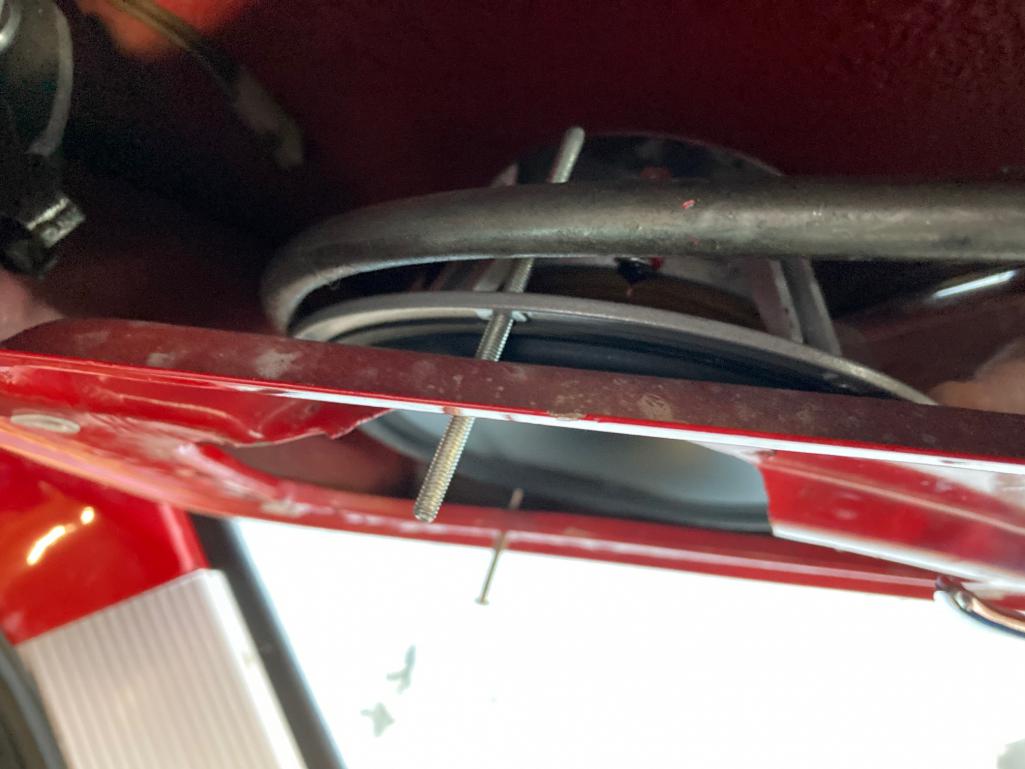

Hopefully this is just a silly question, but have you checked to see if the roll-up window will clear the door speaker when rolled all the way down? Back in high school, I saw plenty of home-grown speaker installations that had collision issues with various moving parts (window, door stay arm, etc.).
A suggestion for an alternate door speaker install:
Install the speaker on the inside (passenger compartment) side of the door sheet metal (like it looks like how your old speakers were installed. Then, trim the door panel to clear the rim of the speaker. Finally, install the speaker grill to the face of the door panel. This should give you more clearance inside the door shell for moving parts and still let you remove the door panel without having to remove the speaker first.
horizontally-opposed
post Dec 21 2020, 03:49 PM
Posts: 3,456
Joined: 12-May 04
From: San Francisco
Member No.: 2,058
QUOTE(BillC @ Dec 21 2020, 07:15 AM) *
There are no silly questions! (IMG:style_emoticons/default/beerchug.gif) I just want to do a thoughtful, methodical audio install, so feedback is welcome.
I did check for window clearance, and everything works well with this setup—at least with the inferior early style window regulator (1970 thru early 1973). This system will actually be cleaner than the old one in terms of the windows, as the crossover hidden in the door (what a life...and one of the crossovers sounded like a maraca when I pulled it out) moves into the cabin and the tweeter mounted high at the center of the door and its wiring will be disabled and/or removed.
The lower front of the doors is "found space," and the curve of the early window regulator almost looks like it was made with a large speaker in mind. Not sure what happens to this concept with the later "scissors" type window lift.
The approach you mention on mounting the speaker is interesting, and could work and/or be better. I'd want to figure out a way to mount the speaker grille to the door card, and the speaker to the door, for a finished look and to avoid figuring out how to trim the opening in the basketweave. May end up going this way, as it would be easier. Only real downside I see is the need to cut my door up even more. Not ruling it out, however…

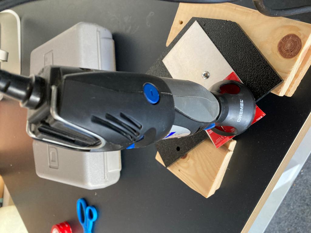

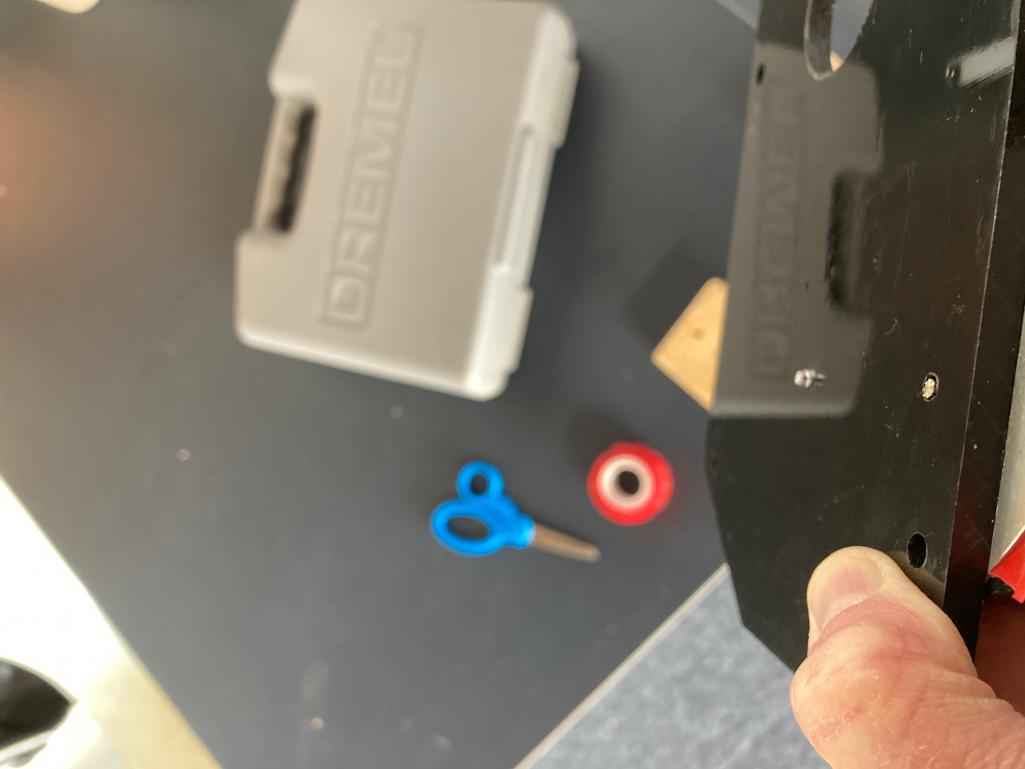

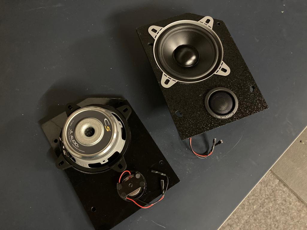

Not a huge update, but finished the rough cuts of the boards to mount the tweeters and mids. My thanks to @johannes for the excellent template for the factory speaker enclosures. I still managed to goober some bolt holes, but that's entirely on me.
I decided to use black ABS plastic order from TAP Plastics for the speaker boards, mainly as I wanted a stable mount that would not be compromised by time and/or moisture. I'll isolate the speakers with a bit of rubber, and have some hand finish work to do yet, but my initial worries that I had gone too far with the thickness of the boards disappeared once I cut the larger circles out. They are light, strong, and should work well.

In factory enclosure, and with the speakers test fit.
