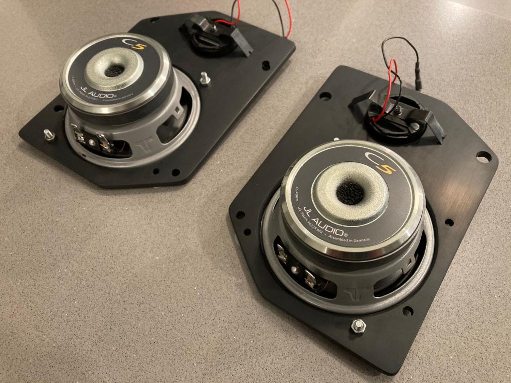

Plans to go for a drive in my 914 this weekend were dashed by yesterday's stay-at-home alert, so I finally dug into a minor project I've been putting off: Rebuilding the car's 28-year-old audio system. While it performed well for 15-20 years, a mixture of age, heat, moisture, etc eventually caught up to it.
System goals: 1) Install a system powerful enough to be enjoyed with the top on or off; 2) maintain/improve "period correct" appearance with no head unit and, if possible, no visible speakers; 3) minimize weight; 4) avoid or minimize additional holes/etc.
I'm going into this with the understanding that it's entirely possible the exercise will be futile with a 2.2-liter flat six, but I have been collecting the parts over time and figure it's worth a shot. Some of this stuff has been sitting for years and thus may not be available anymore—but plenty of alternatives are.
Old system components:
Tape cassette head unit Smartphone flopping around on seat > EQ
Pyle graphic EQ turned on/off by factory rear defrost switch
Pioneer fan-cooled amplifier (~1991)
Boston Acoustics four-speaker set in doors (~1991)
Pioneer ducted bass wedge in passenger footwell
New system components:
Smartphone with a proper mount > EQ
Blaupunkt five-channel parametric EQ
JL five-channel amplifier
JL six-speaker set for factory speaker enclosures and door
?? subwoofer in passenger footwell (prepare for now, add later)
Fair warning: This thread may proceed at a glacial pace, as midlife plus a small business means my days in the garage are fairly rare in this chapter. I'm also figuring this out as I go, and will use this thread as a journal and a place to share ideas.

horizontally-opposed   The mids & tweeters will easily fit into the f...   Dec 20 2020, 09:43 PM
BillC   The mids & tweeters will easily fit into the ...   Dec 21 2020, 09:15 AM

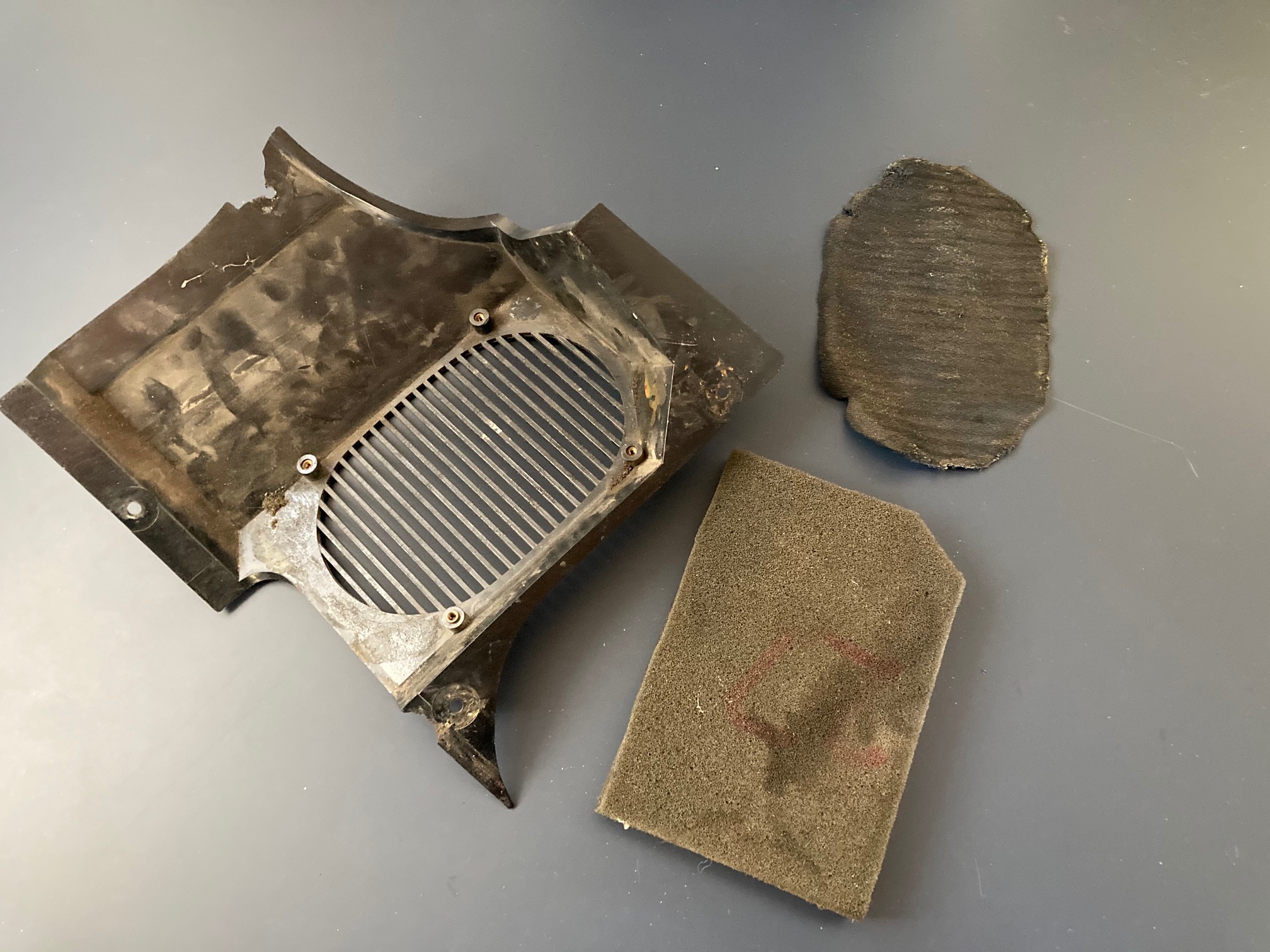

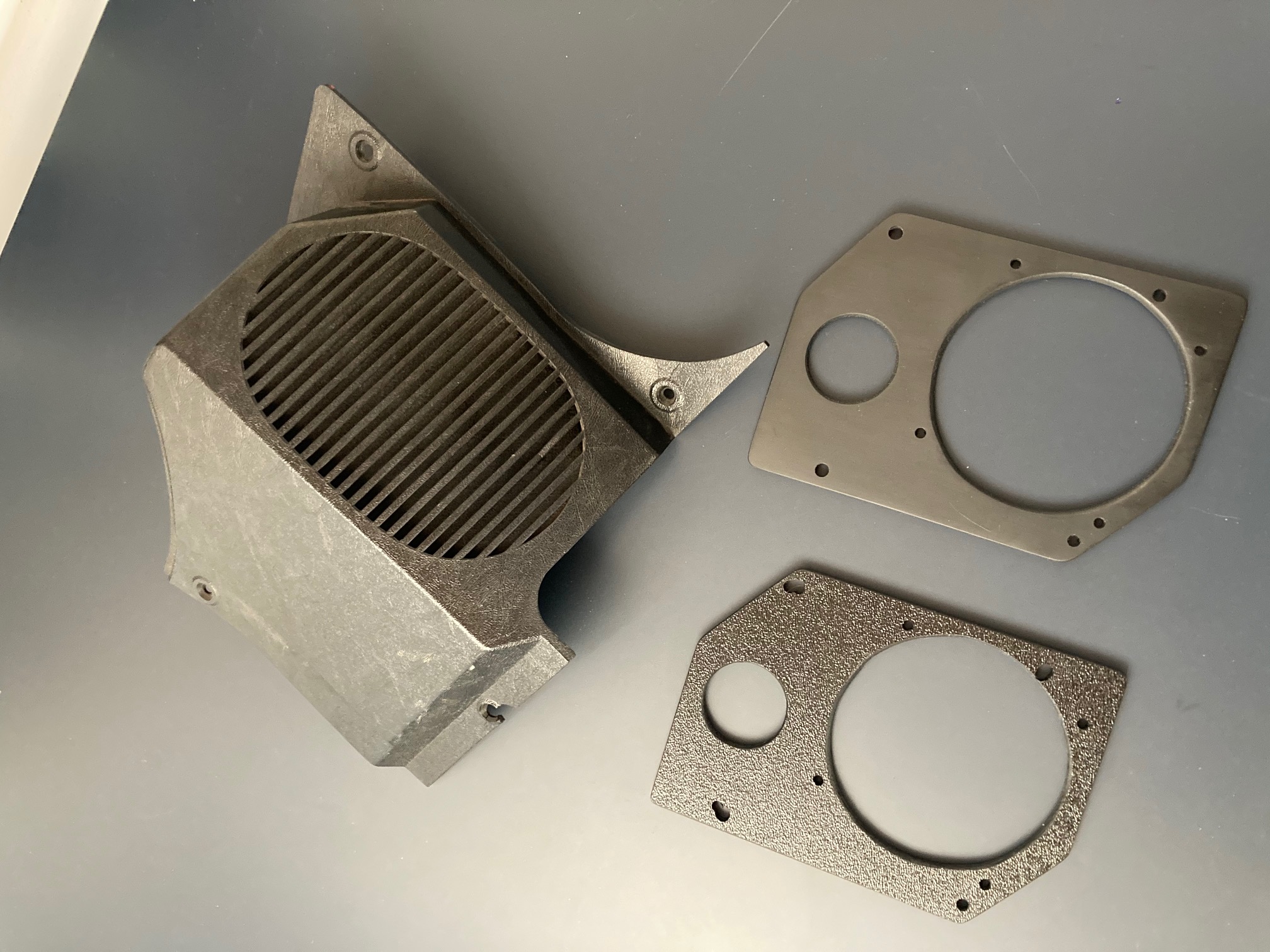

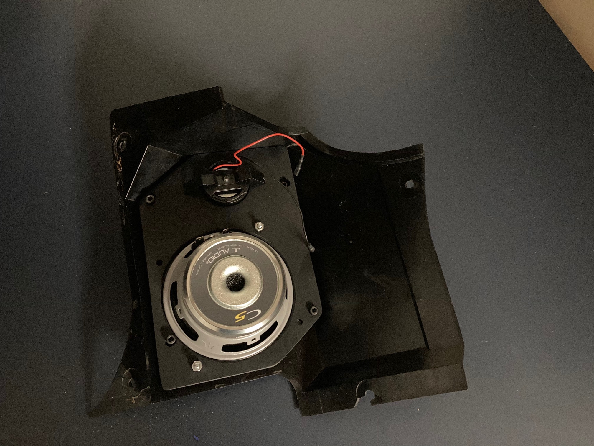

horizontally-opposed   Not a huge update, but finished the rough cuts of ...   Dec 26 2020, 11:03 PM
horizontally-opposed   In factory enclosure, and with the speakers test f...   Dec 26 2020, 11:07 PM
djway   My understanding of high frequency sound waves gen...   Dec 26 2020, 11:13 PM
horizontally-opposed   My understanding of high frequency sound waves ge...   Dec 26 2020, 11:20 PM
bbrock   My understanding of high frequency sound waves g...   Dec 26 2020, 11:44 PM

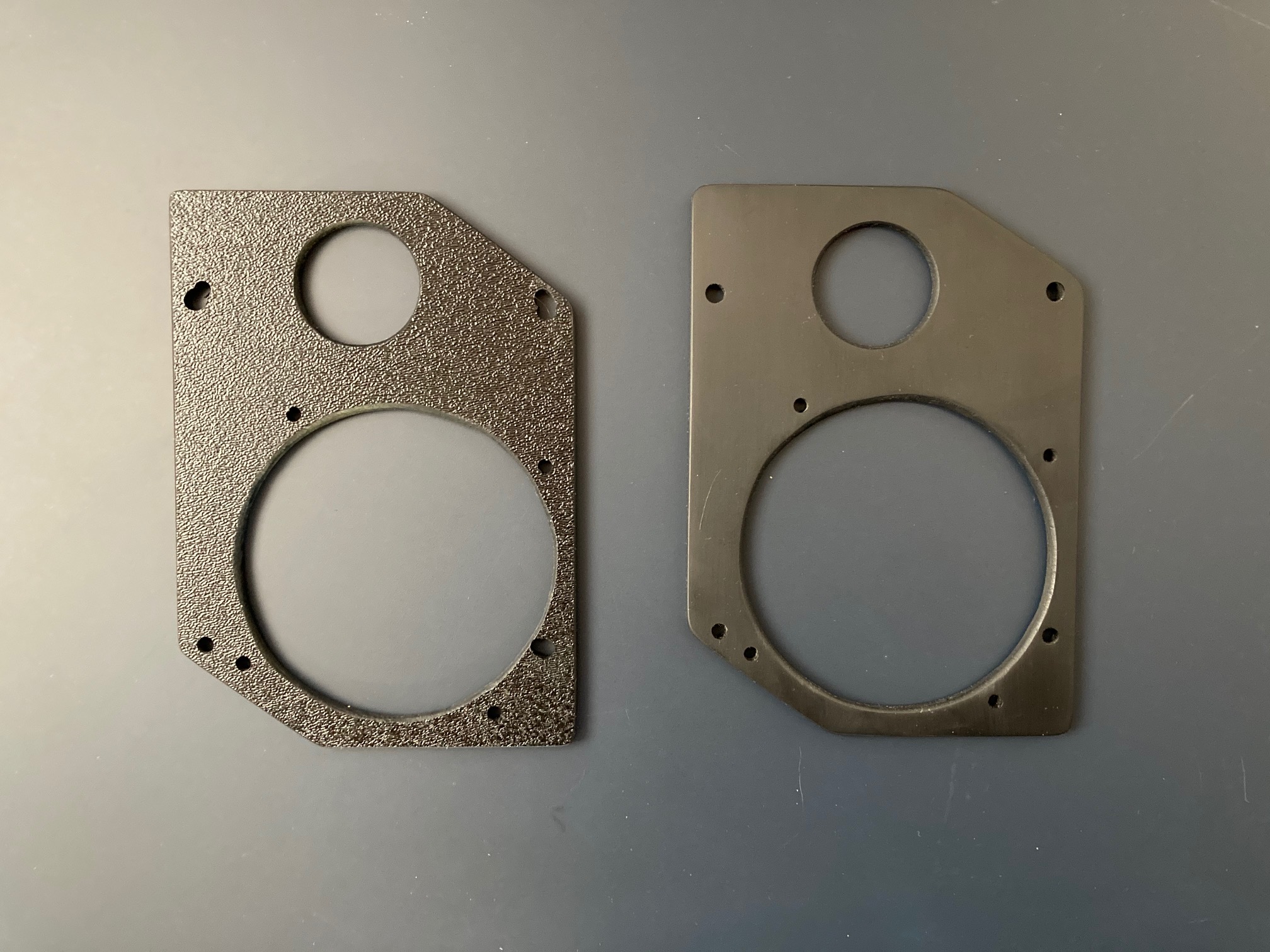

914_7T3   @horizontally-opposed Can you share the spec on ...   Jan 9 2021, 04:24 PM
horizontally-opposed   Can you share the spec on the ABS plastic that y...   Jan 10 2021, 03:31 PM
914_7T3   Can you share the spec on the ABS plastic that ...   Jan 11 2021, 07:44 PM

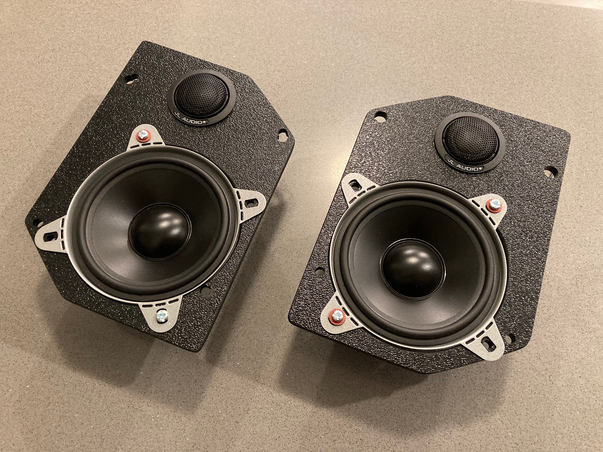

horizontally-opposed   Okay, back to a relatively simple but good enough ...   Jan 11 2021, 11:24 PM
horizontally-opposed   A bit of test fitting. May use rivets for the mids...   Jan 11 2021, 11:28 PM
IronHillRestorations   A bit of test fitting. May use rivets for the mid...   Jan 13 2021, 11:11 AM
horizontally-opposed   With the speaker enclosure plan coming into view, ...   Jan 11 2021, 11:36 PM
Rob-O   Those mids in the adapter plate look way too deep ...   Jan 13 2021, 12:47 PM
horizontally-opposed   Those mids in the adapter plate look way too deep...   Jan 13 2021, 12:53 PM
914forme   :agree: but I had also thought about building a sm...   Jan 13 2021, 01:13 PM
Chris914n6   I had to flip your end result and mount the tweete...   Jan 13 2021, 02:08 PM
horizontally-opposed   I had to flip your end result and mount the tweet...   Jan 14 2021, 09:36 AM
