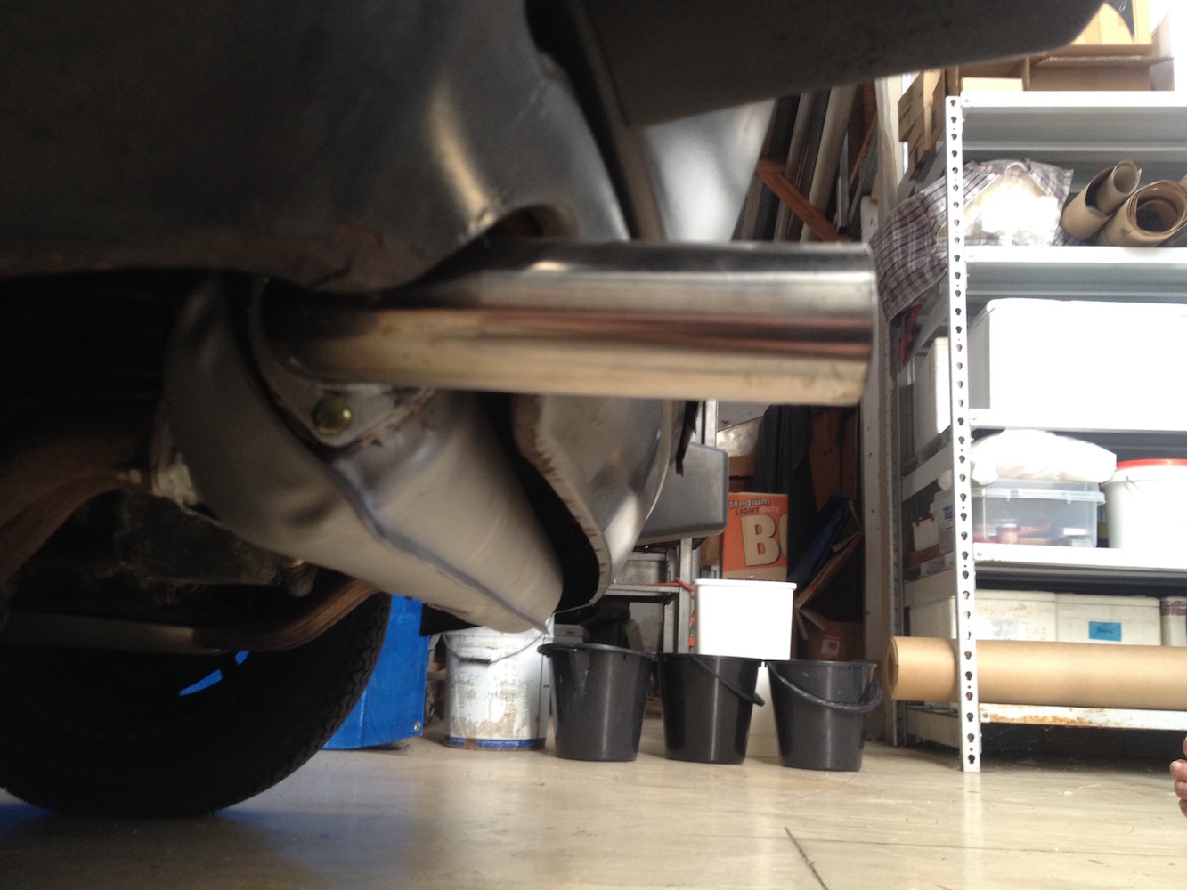

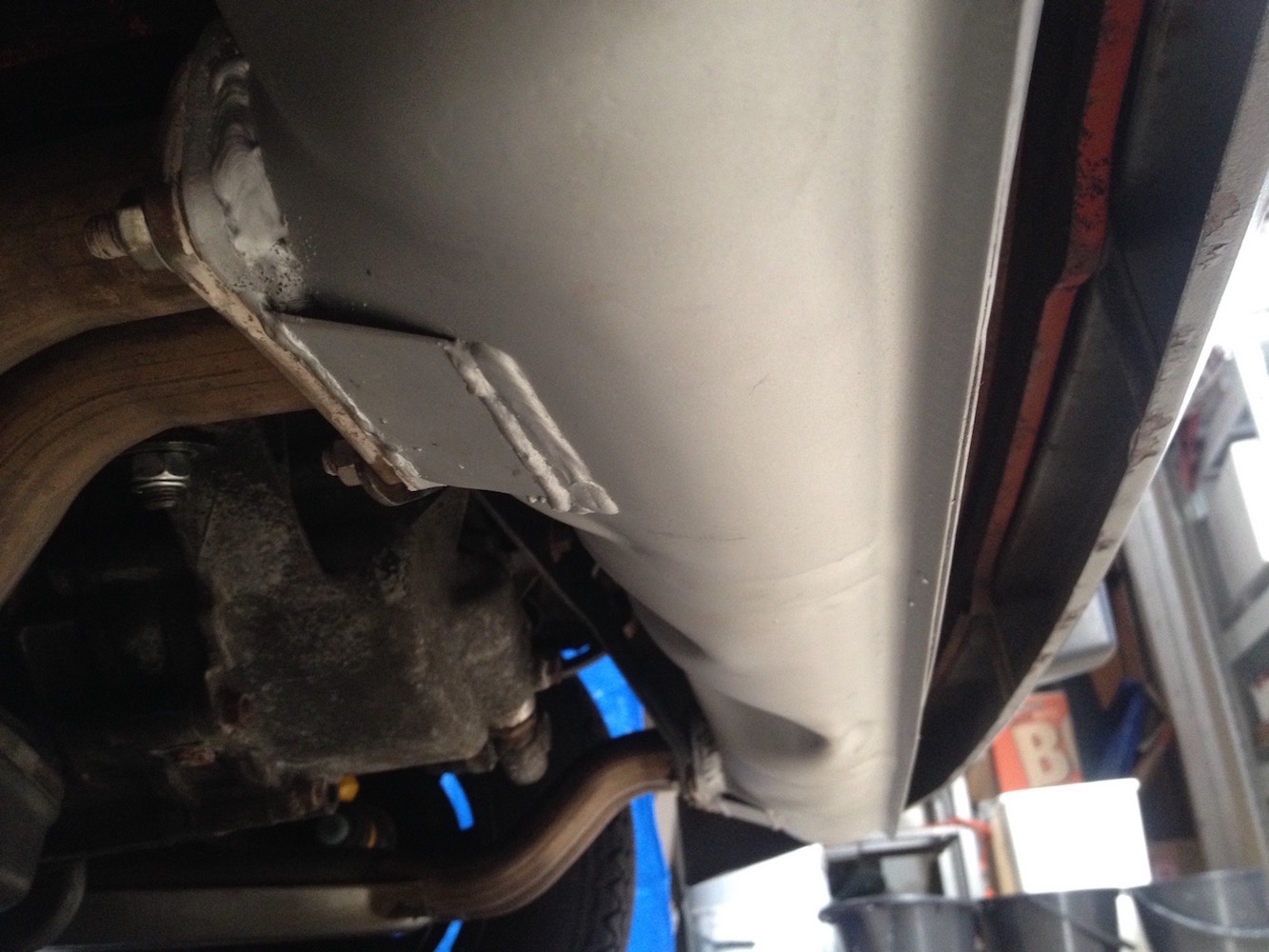

anyway. the problem got returned to this year. the problem of the almost kombi muffler and the tail pipe on the wrong side. and as you often do in aus, far from anything, you just think it out reverse engineering style and get it right again.
so the muffler we already had. the vw kombi muffler. and its a 914 1.8 muffler in all but its inverted coupling flanges to the tailpipes. we cut them out and did a bit of internal surgery. you have to dig in and reweld a few things just inside. and we had a 914 muffler again.

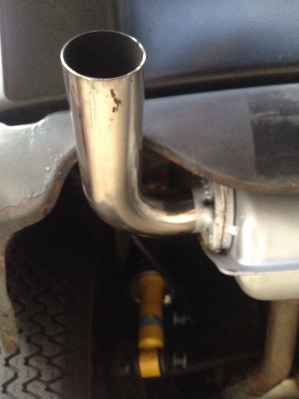

made a nice stainless steel tailpipe. i know its not original material. but its original shape.

there is an awful lot of stuff on 914s that are just slightly adjusted (or not adjusted at all) vw parts. you just need those part #s and something physical for a reference. the muffler is not one of them. but its secret is not that hard if you are handy with a grinder and a welder.

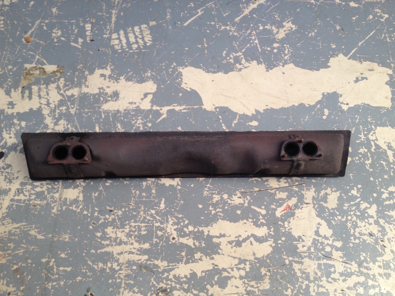

original muffler (kept in box).
reverse engineered to --- something close to original?

why they did this switch on type 4s i don't understand, i guess there must have been a reason. but given that the exhaust connection of a rear engined vw and a 914 is similar, ie a trapezoidal plate with two bolts on the low side and one on the high side, it meant that the 914 which retained its lhs tailpipe had to have those plates welded on inverted when compared to the vw 412/kombi version. when you look at a 411/412 or a kombi there is no impediment to the tailpipe exiting either side as it does not run through any notch or hole in the underside of the rear bodywork.
in the 914 parts catalogue it notes that the later muffler for the 1.8s supercedes the earlier muffler as the replacement part. i think because of this and the requirement that 914s were fixed to a lhs tailpipe due to earlier cars and the rear valence with the hole or the cut away, the 914 had to continue to have a special muffler with the altered plates so the tailpipe remained in original position.

i have looked closely now at the original muffler that came off the car. i am not certain its the original first muffler. i can just make out the brand name LANGE on it, and Made in W Germany. along with what looks like it could be a date. 1983. i think its a replacement but a genuine VW part as LANGE along with a couple of other german brands were OEM suppliers. what is interesting is that inside the end sections of the muffler there are no dual inlet pipes that lead into the central section of the muffler from the heat exchanger/manifold inlet pipes. instead the end sections are empty chambers that feed into the central section through an inlet hole in the divider plates. and there is no trace of ever being inlet feed pipes in the end chambers so they have not corroded away.
