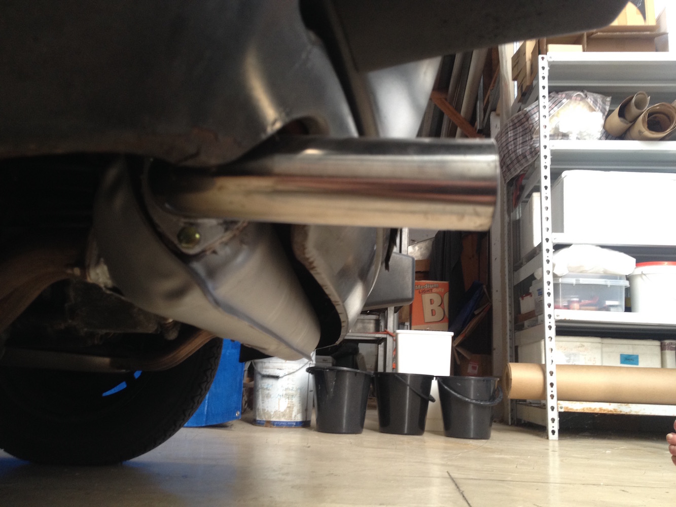

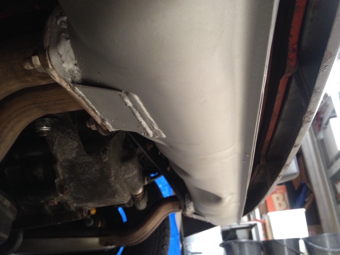

so the muffler we already had. the vw kombi muffler. and its a 914 1.8 muffler in all but its inverted coupling flanges to the tailpipes. we cut them out and did a bit of internal surgery. you have to dig in and reweld a few things just inside. and we had a 914 muffler again.

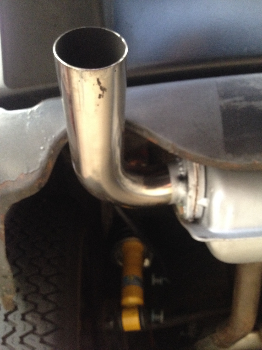

made a nice stainless steel tailpipe. i know its not original material. but its original shape.

image shows kook 1.8 at turn of century with emergency kombi muffler first hack at it.

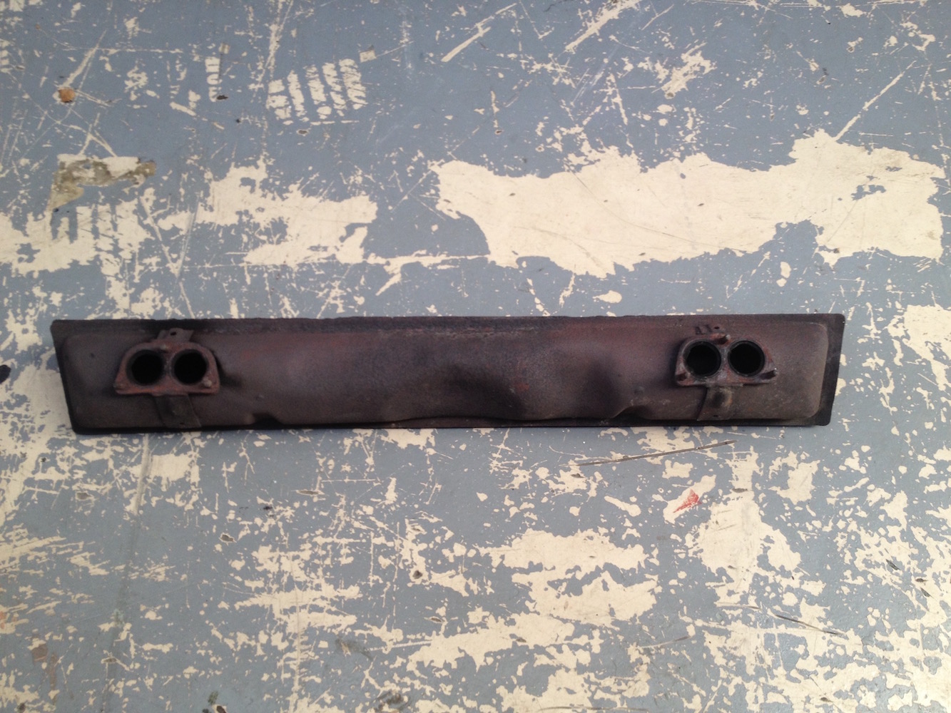

original muffler (kept in box).
reverse engineered to --- something close to original?

i have looked closely now at the original muffler that came off the car. i am not certain its the original first muffler. i can just make out the brand name LANGE on it, and Made in W Germany. along with what looks like it could be a date. 1983. i think its a replacement but a genuine VW part as LANGE along with a couple of other german brands were OEM suppliers. what is interesting is that inside the end sections of the muffler there are no dual inlet pipes that lead into the central section of the muffler from the heat exchanger/manifold inlet pipes. instead the end sections are empty chambers that feed into the central section through an inlet hole in the divider plates. and there is no trace of ever being inlet feed pipes in the end chambers so they have not corroded away.

The LANGE muffler that was on the car when i bought it in 89 might be a kind of factory variant "sport" muffler to give a louder or lower tone. not really sure. but it is different. I guess it is possible that all 914 factory mufflers of the single muffler type replacing the earlier ones had these empty end chambers.
