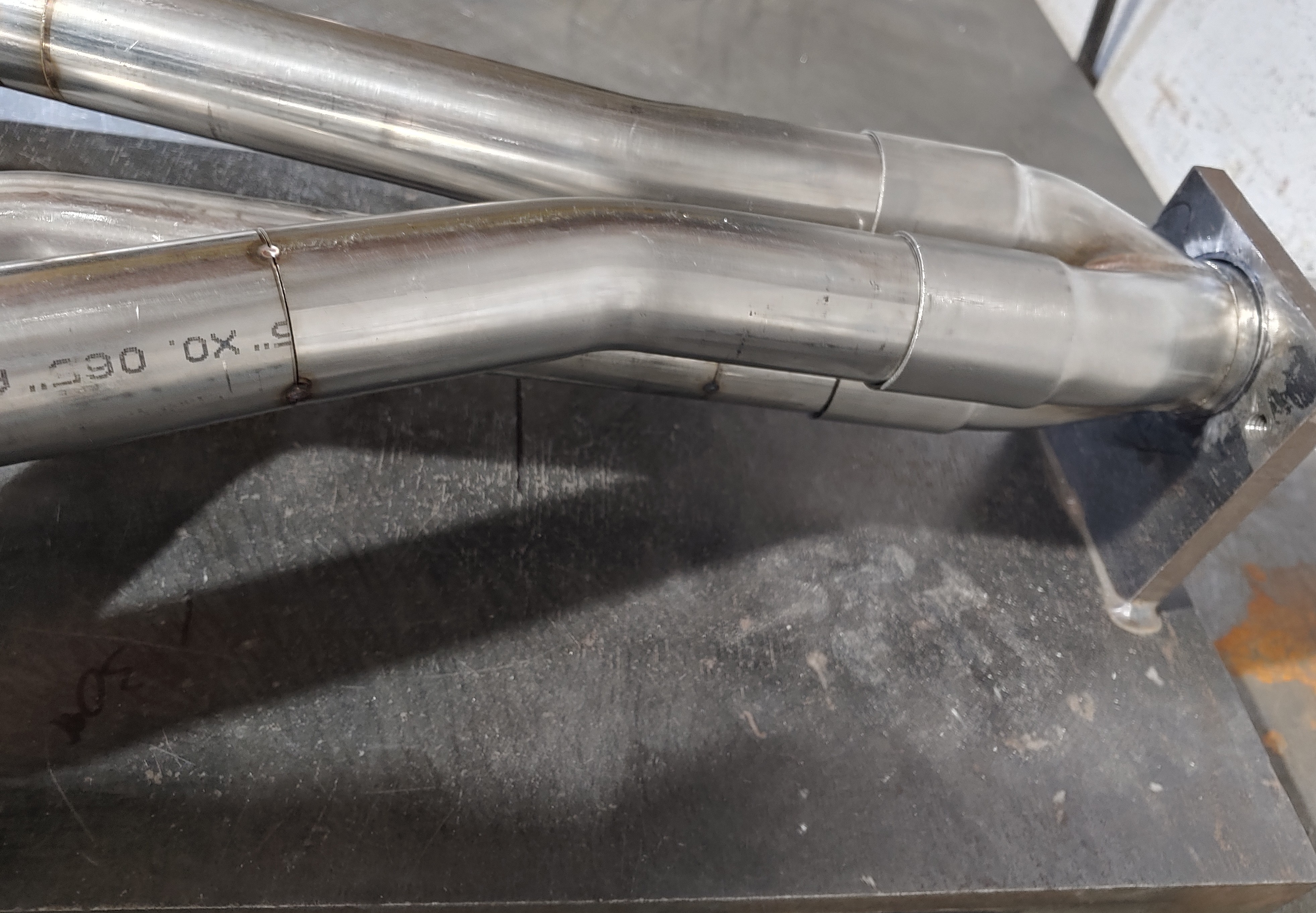

@mb911
Ben...what does the f1 merge collector look like compared to the stock.
mb911
post Jan 9 2021, 04:13 PM
Posts: 7,759
Joined: 2-January 09
From: Burlington wi
Member No.: 9,892
QUOTE(johnhora @ Jan 9 2021, 02:11 PM) *
@mb911
Like this

mb911
post Jan 9 2021, 05:07 PM
Posts: 7,759
From: Burlington wi
Member No.: 9,892
QUOTE(mepstein @ Jan 9 2021, 03:05 PM) *
QUOTE(mb911 @ Jan 9 2021, 05:13 PM) *
@mb911
Like this
What's the advantage? More expensive?
So actually cheaper but they are able to scavenge exhaust gasses and produce more power. Its what is often called the Burns style collector
johnhora
post Jan 9 2021, 05:20 PM
Posts: 902
Joined: 7-January 03
From: Derby City KY
Member No.: 107
OK...thanks very much for the pics and info.
I know it has a lot to do with gas extraction of the pulses of each cylinder in the firing order etc etc..
Not trying to get into the theory and such. I've read a little on it until my head hurts (IMG:style_emoticons/default/smile.gif)
Are there any clearance issues with this type on the 914?
Any dyno comparisons.
Thanks...

Mark Henry
post Jan 9 2021, 05:37 PM
that's what I do!
Posts: 20,065
Joined: 27-December 02
From: Port Hope, Ontario
Member No.: 26
QUOTE(johnhora @ Jan 9 2021, 06:20 PM) *
Thanks...
Marty at MSDS uses a similar collector, no clearance issues.
Ben's the only real game in town if you need big /6 pipes and heat, and that they're well made is the bonus.
