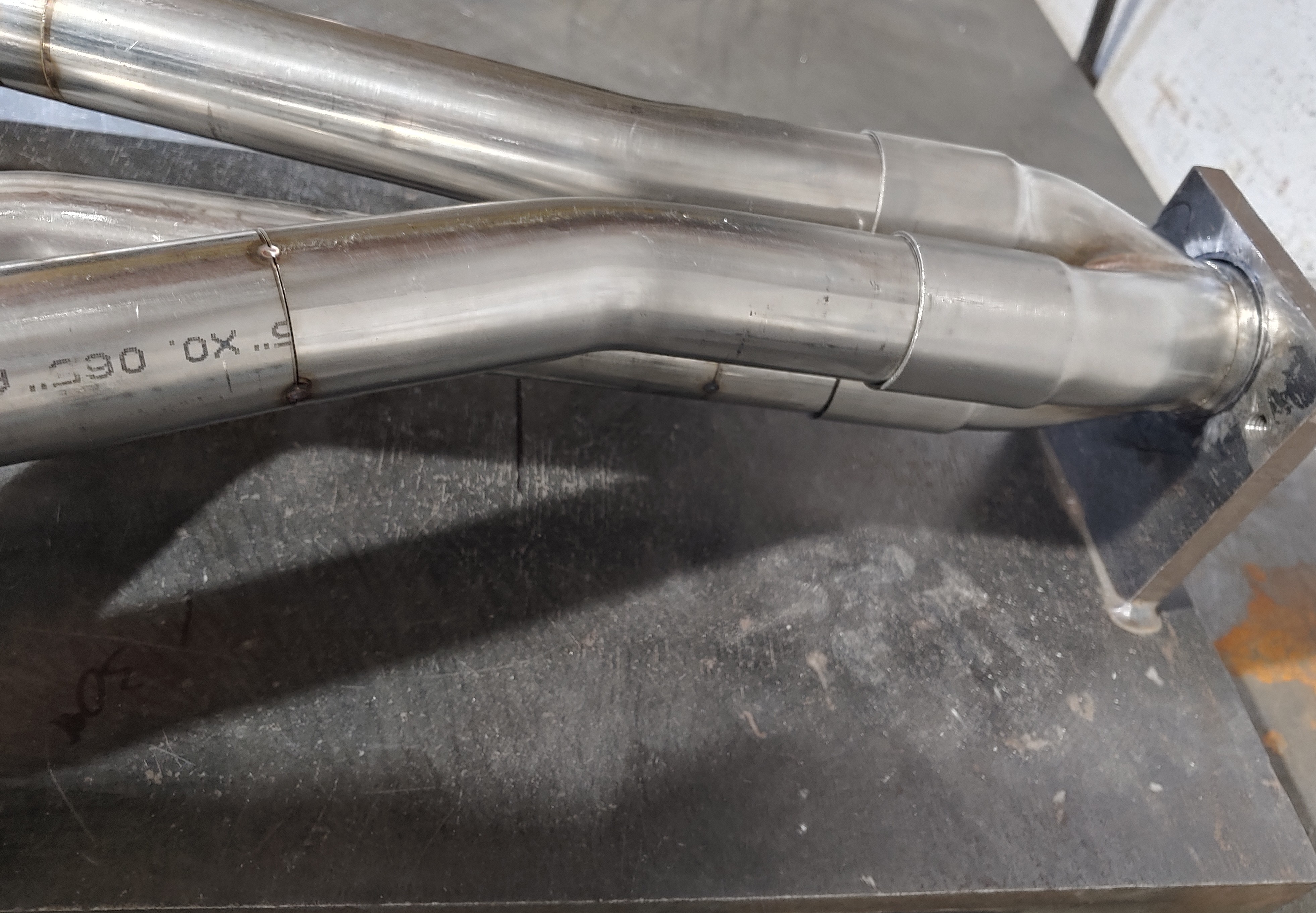

Like this

What's the advantage? More expensive?

So actually cheaper but they are able to scavenge exhaust gasses and produce more power. Its what is often called the Burns style collector

OK...thanks very much for the pics and info.
I know it has a lot to do with gas extraction of the pulses of each cylinder in the firing order etc etc..
Not trying to get into the theory and such. I've read a little on it until my head hurts smile.gif
Are there any clearance issues with this type on the 914?
Any dyno comparisons.
Thanks...

Marty at MSDS uses a similar collector, no clearance issues.
Ben's the only real game in town if you need big /6 pipes and heat, and that they're well made is the bonus.
The repop heat exchangers are a reasonable facsimile if you're building a stock 2.0 914/6.

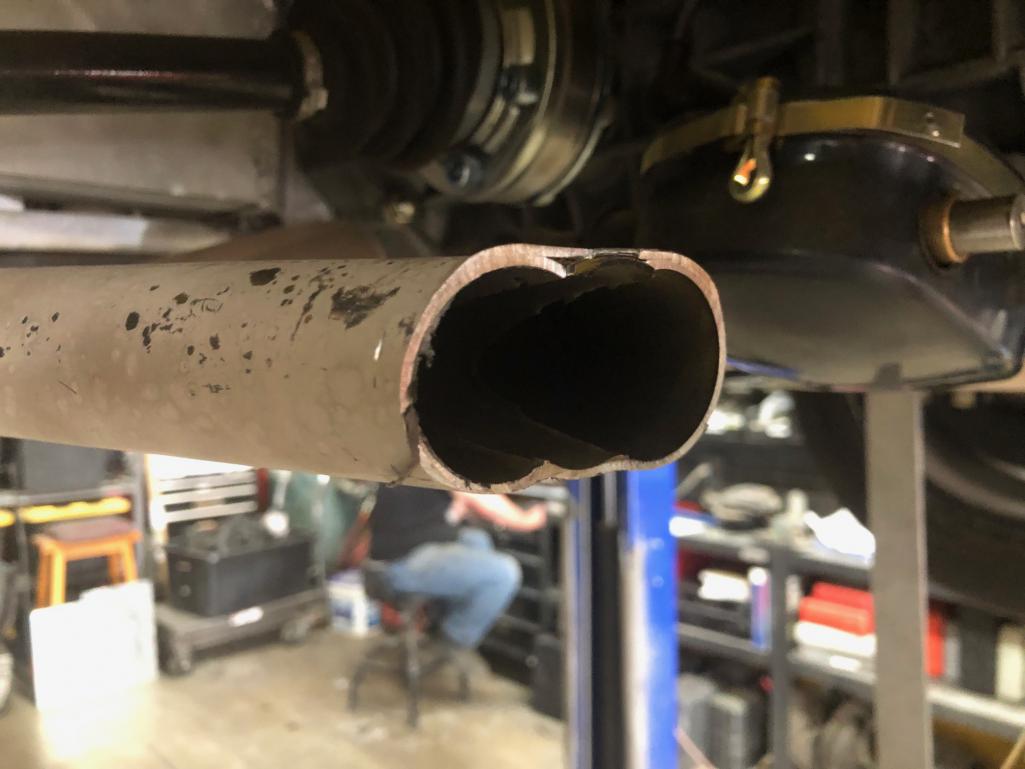

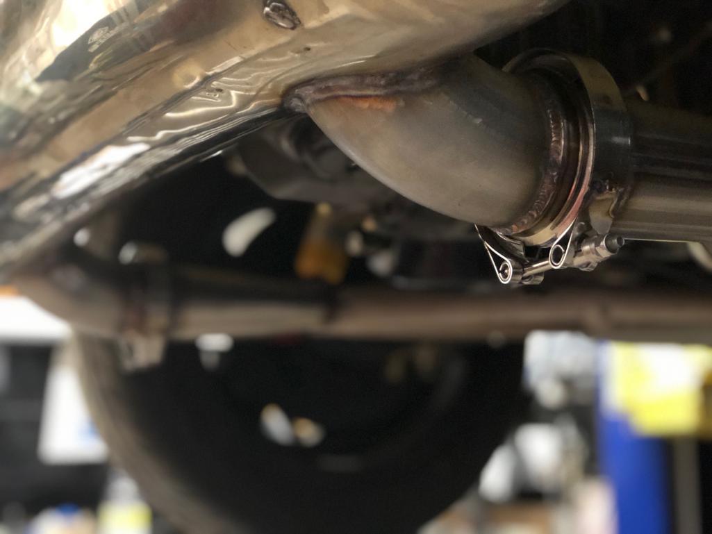

Hi my Brothers,
I do not want to take anything from Ben’s super high-quality Heat Exchangers but rgalla9146
Asked and as long as he has factory HE for 6 he can have this mod done for his car. I have a 3.0 with 3.2 heads with 46 PMOs
Hi my Brothers,
We have not Dyno test yet but, Eric at PMB says 40, that’s 40 extra HP
Stay healthy and safe,
Bob B
Bob B

Bob - I think Eric is pulling your leg. The stock HE’s still have 1 1/2” od tubing up to the collector and from the dyno charts I’ve seen, going from ok headers to great headers gets you a 15-20hp increase on a built 3.2. I guess it will be hard to know without doing a back to back comparison on the same engine, same dyno, same day, etc.

Eric may be pulling my leg but if you look at the cutoff of the area where the 3 pipes converge on to one it is 1.5 x 3 or 4 inches. That should allow a lot more gas to get out and not a bottleneck?
Bob B
1.5In at head Marty@MSDS may give us his take on this. Yes the dyno will be the real test by E says it feels so much faster and he was going by what Kellys car did with same mod.
Bob B
And happy new year to you buddy
