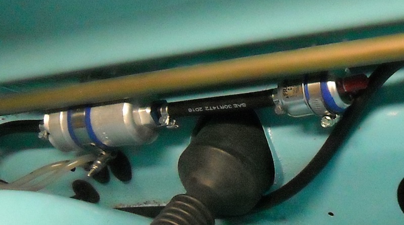

Most fuel pump noise can be reduced with soft rubber mounts. How was yours mounted?
You can use any 3 bar pressure pump. Just a matter of wiring and plumbing.

It is wrapped with silicon tape inside the mount.
It looks close to the sway bar in this pic, but is really about 1/4 in away from it.

Hi.have you checke the hoses ? Espacialy the suctionline.
I had a noisy Pump because of a colapsed suction line. I believe the pump came in cavitation. After rerouting the line the noise was a lot less.
Also check the Screen Filter in the Tank. Maybee rust particels have clogged it.
