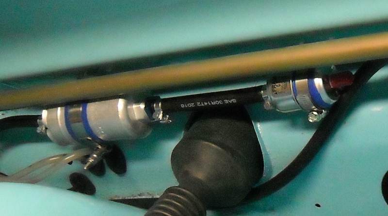

Mine is mounted under the tank.

Most fuel pump noise can be reduced with soft rubber mounts. How was yours mounted?

It is wrapped with silicon tape inside the mount.
It looks close to the sway bar in this pic, but is really about 1/4 in away from it.

Hi.have you checke the hoses ? Espacialy the suctionline.
I had a noisy Pump because of a colapsed suction line. I believe the pump came in cavitation. After rerouting the line the noise was a lot less.
Also check the Screen Filter in the Tank. Maybee rust particels have clogged it.
