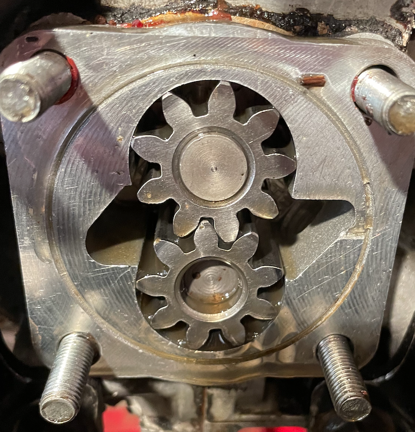

After a tear down of my 2.0l engine I started the build up to the 2056 big bore upgrade. Having a Bridgeport I started with the (5) 3/8 oil galley plug on the block halves
Drilling a hole in the plugs and a slide hammer to remove the old plugs then started the installation of the new pugs I was able to order from Type 4 store.

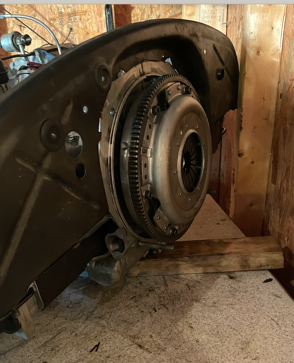

rfinegan   UPDATE: Just received the Engine yoke for the HF s...   Jan 25 2021, 06:50 AM
ValcoOscar   UPDATE: Just received the Engine yoke for the HF ...   Jan 26 2021, 08:22 AM
rfinegan   Woohoo..thanks Oscar UPDATE: Just received the...   Jan 26 2021, 08:24 AM
rfinegan   yoke   Jan 25 2021, 09:30 AM
VaccaRabite   Though I have built an engine on that type of yolk...   Jan 26 2021, 08:00 AM
rfinegan   Thanks for the Tip: I think I am going to use the ...   Jan 26 2021, 08:08 AM
VaccaRabite   Thanks for the Tip: I think I am going to use the...   Jan 26 2021, 08:34 AM

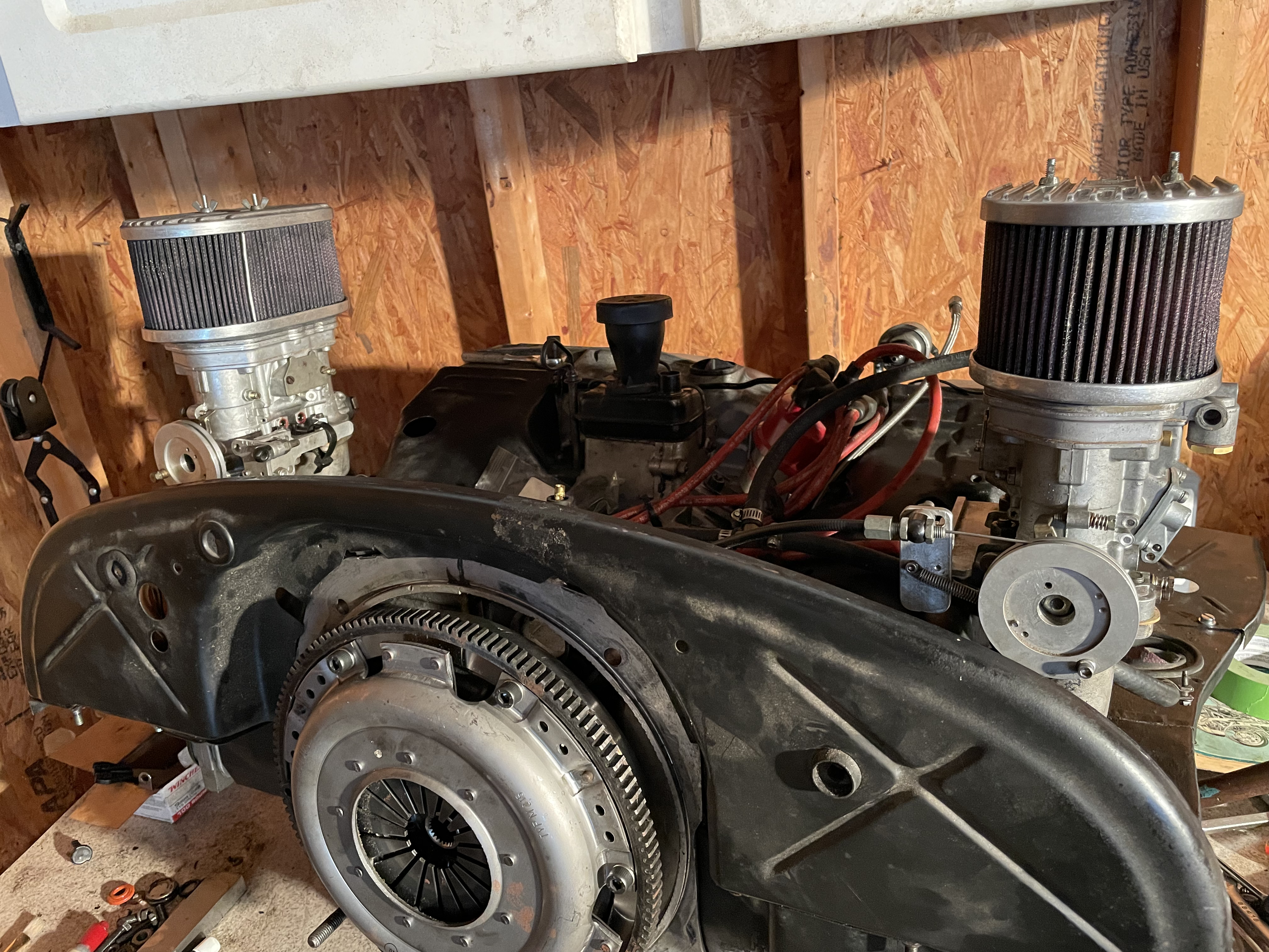

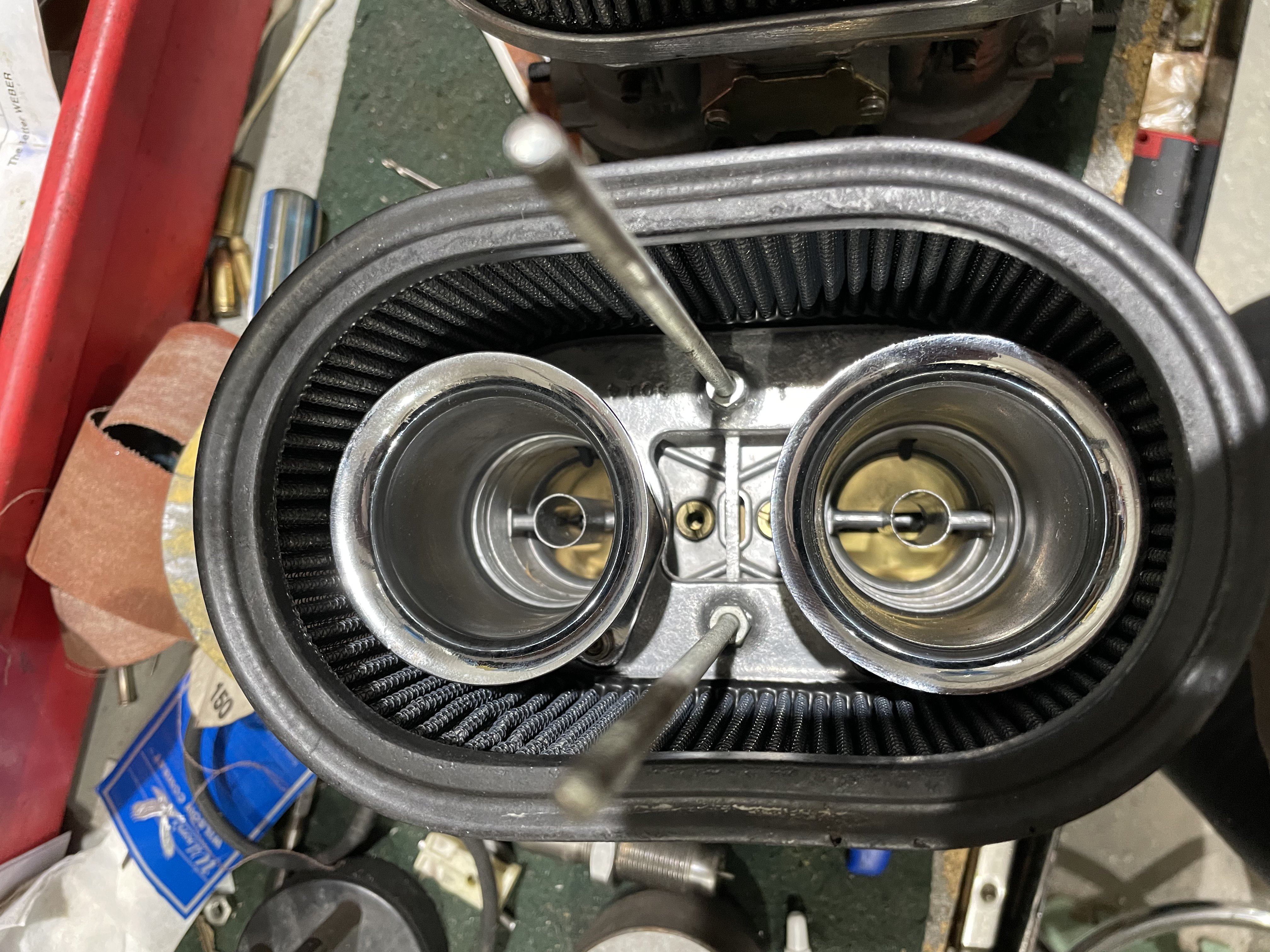

rfinegan   Tonight i decided to pull down the Old Weber 44 ID...   Mar 4 2021, 06:29 PM
rfinegan   other carb Solids are seen in both holes here too....   Mar 4 2021, 06:31 PM
rfinegan   a better shot of the plugs hole   Mar 4 2021, 06:42 PM

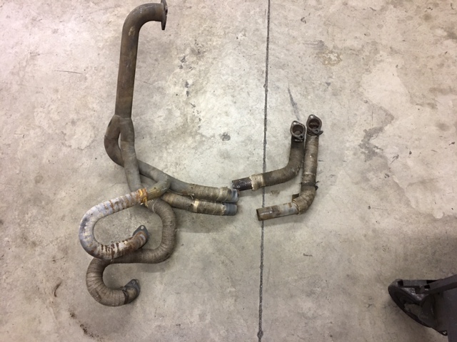

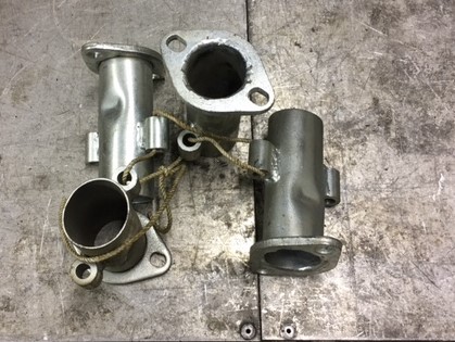

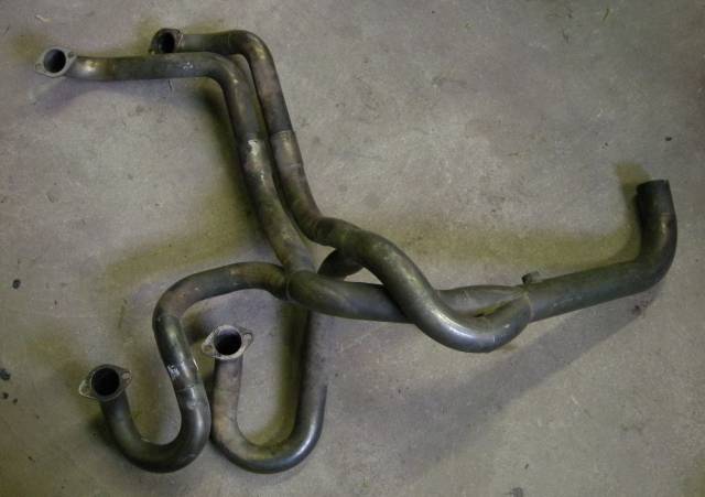

rfinegan   This week was fabrication work: 2 1/8 exhaust pipe...   Mar 18 2021, 03:55 PM
rfinegan   another view   Mar 18 2021, 03:56 PM
rfinegan   Sound clip LhNNEG_Mi6A   Mar 18 2021, 03:57 PM
rfinegan   forgot the shot of the pipe   Mar 18 2021, 04:14 PM

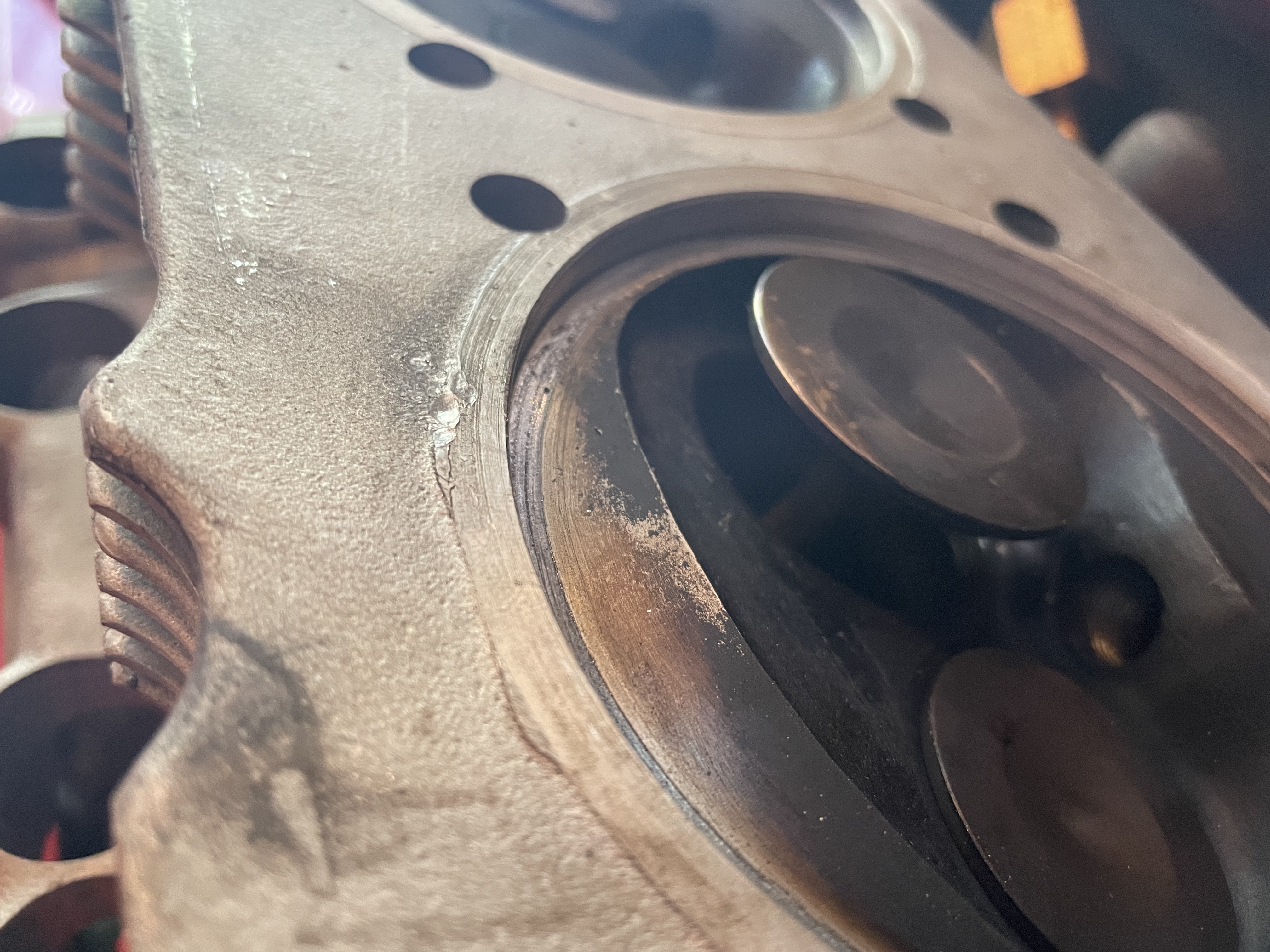

rfinegan   Heads: Started life as 1.8 heads Here is a pic fro...   Mar 24 2021, 07:20 AM

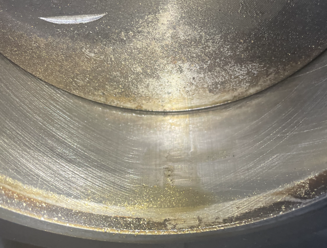

rfinegan   Main bearing time: ALWAYS measure your crank jour...   Mar 29 2021, 04:52 PM
rfinegan   another   Mar 29 2021, 04:53 PM
rfinegan   another pic of the worst bearing F-ed up bearing. ...   Mar 30 2021, 09:08 AM
rfinegan   another pic of the worst bearing F-ed up bearing. ...   Mar 30 2021, 09:09 AM

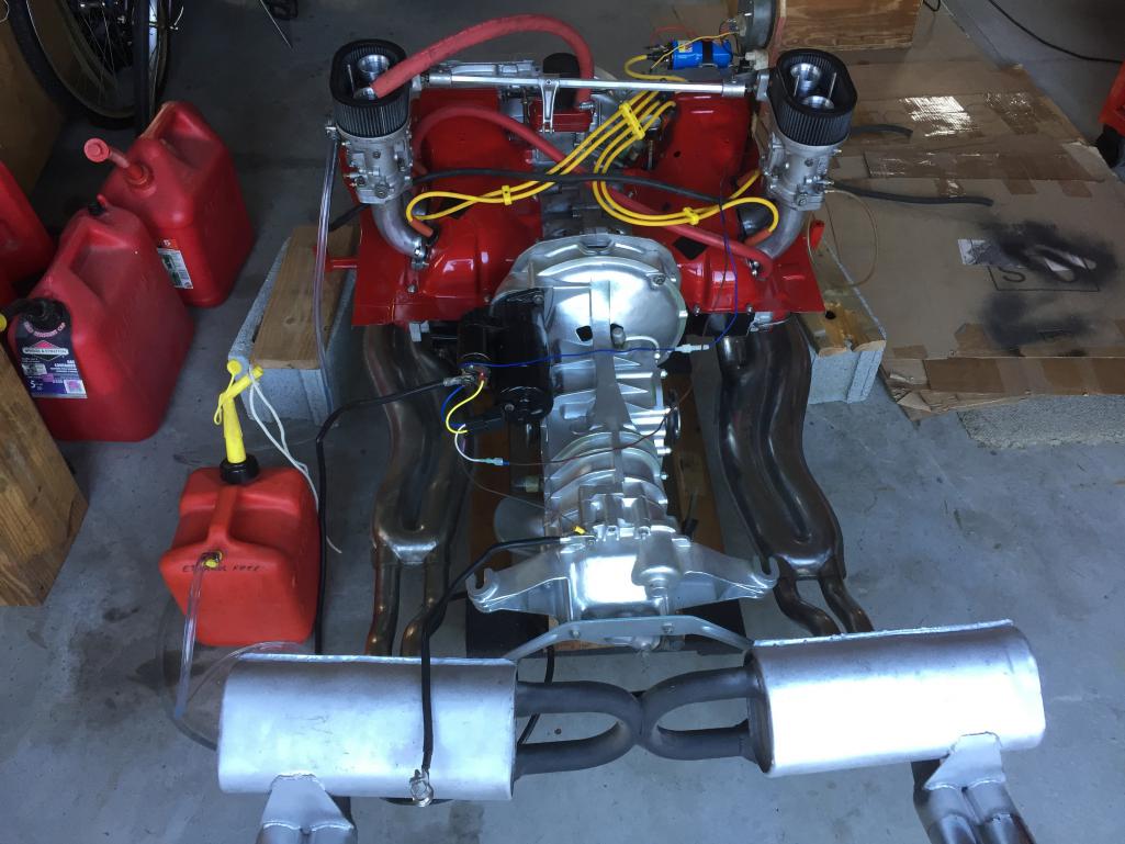

rfinegan   Last night had 2 hrs on the engine stand and have ...   Apr 23 2021, 04:38 AM
rfinegan   Sorry my last edits did not save...I Was looking a...   Apr 23 2021, 06:19 AM
