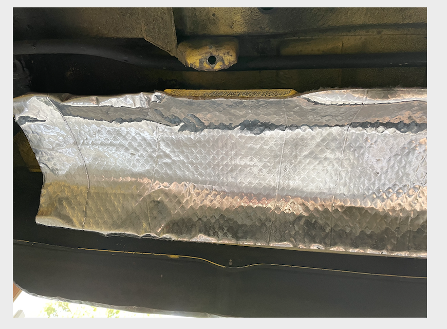

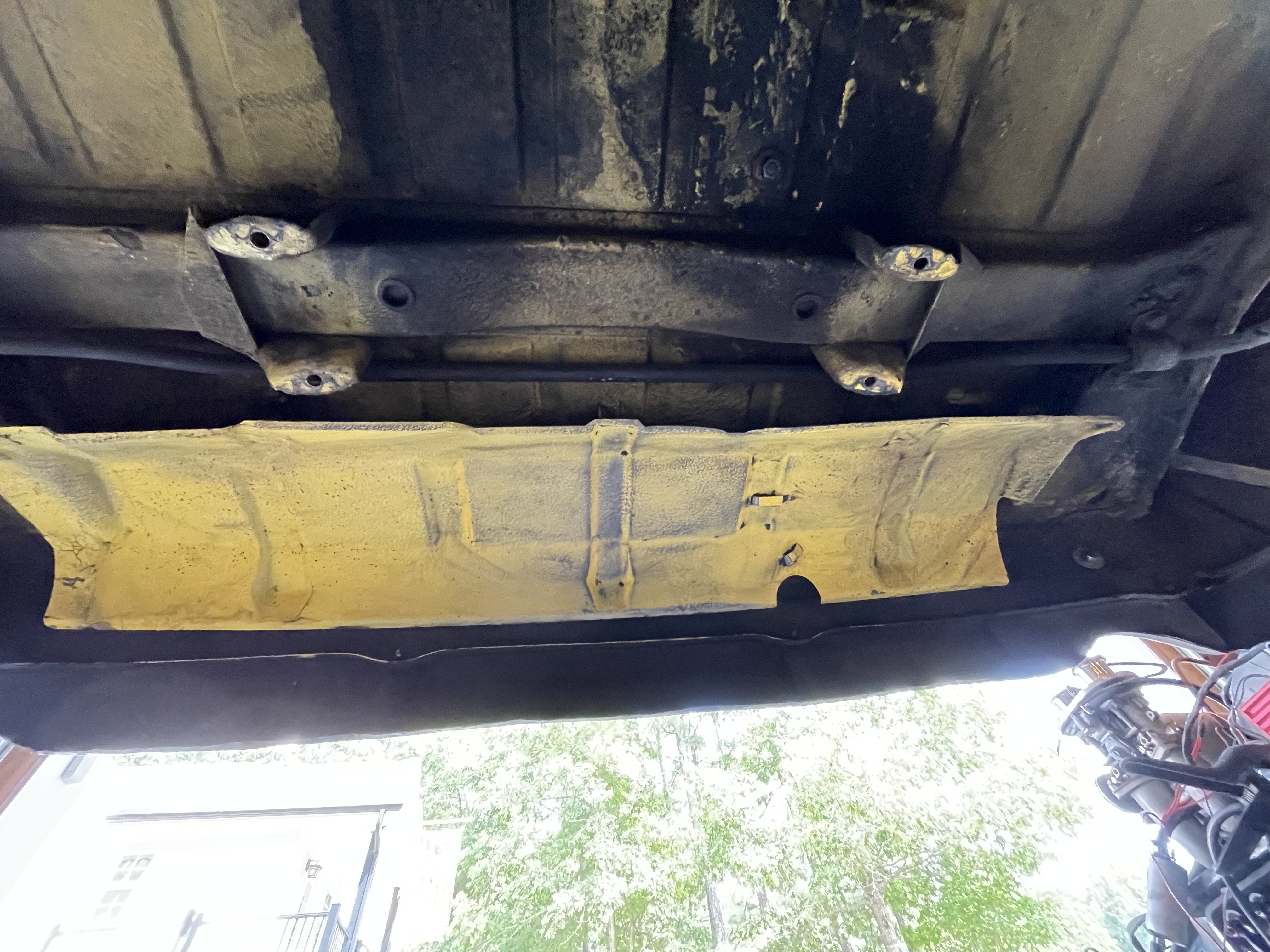

Cleaned the heat shield for the muffler pad I won at Octeenerfest door prize...
rfinegan
post Aug 29 2021, 01:58 PM
Post #162
Posts: 1,162
Joined: 8-February 13
From: NC
Member No.: 15,499
pad installedAttached Image

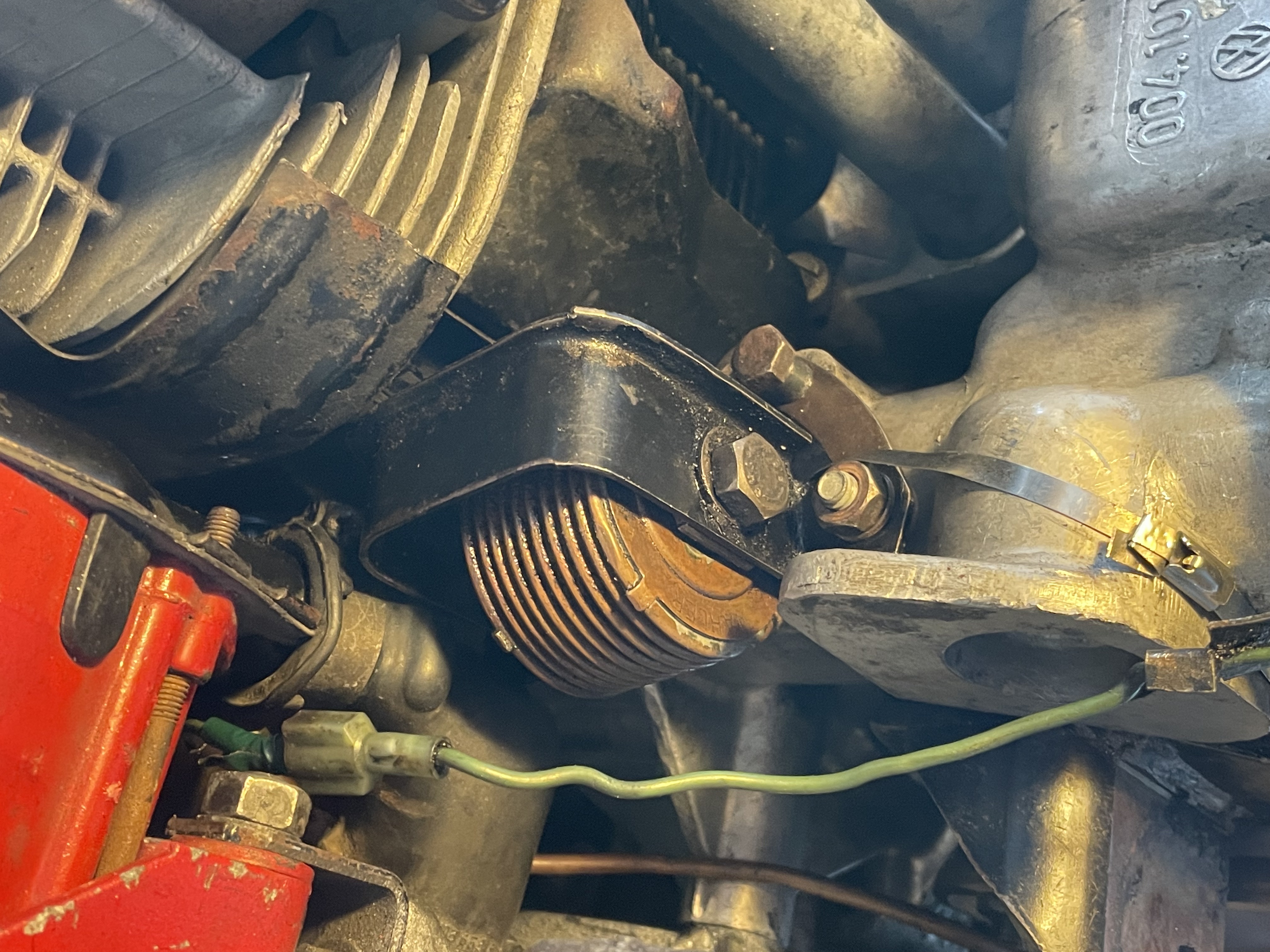

Thermostat removed for header tube
rfinegan
post Aug 29 2021, 02:04 PM
Post #164
Posts: 1,162
From: NC
Member No.: 15,499
relocated thermostat

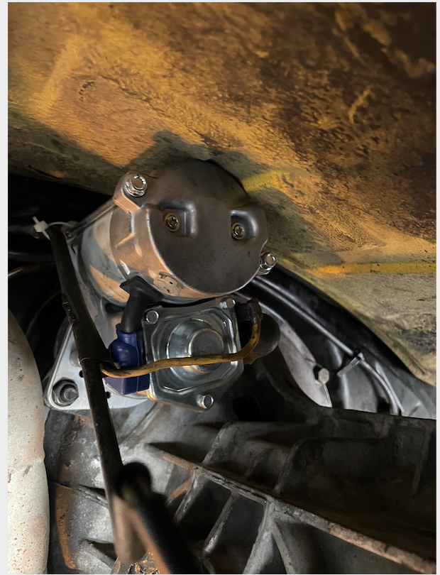

New Hi-torque starter is a little close to the Trunk /floor pan.
Little reclocking of the starter and a slight push up on the floor pan and Im good to go...

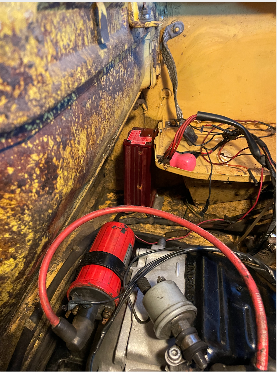

Malory HiFIre VI AL CD /rev limiter is installed where the ECU used to reside.
Did I mention how much I HATE the glue on the fire wall! (IMG:style_emoticons/default/mad.gif)

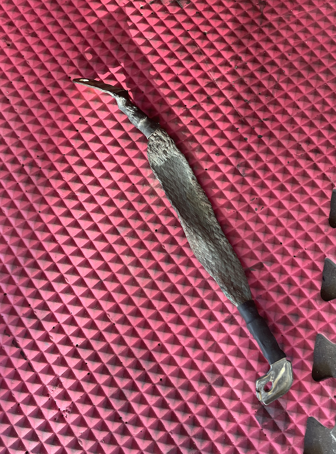

Today I added a different ground strap. The old one I think did not flow enough current for the starter and high load accessories.

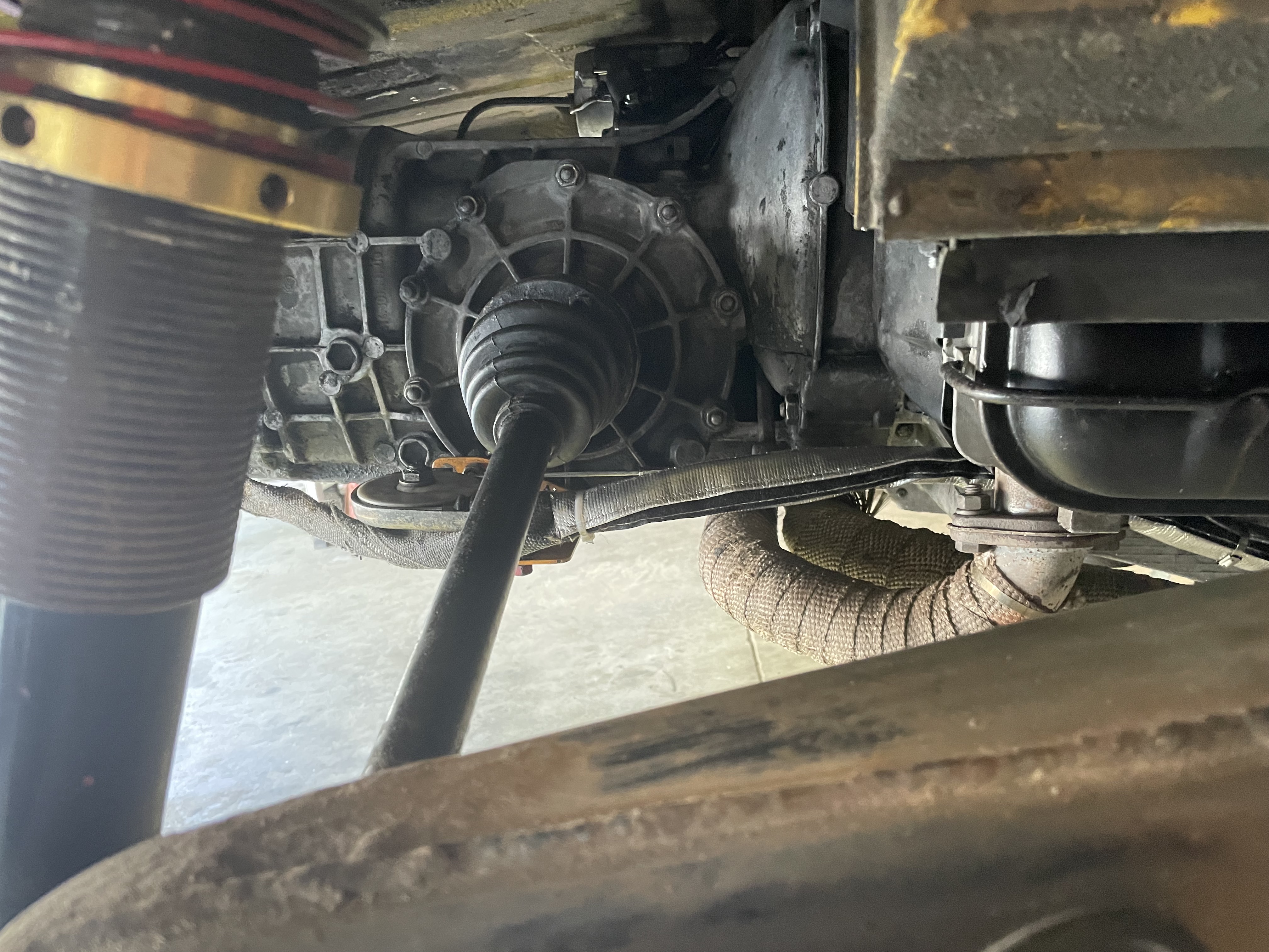

I have the bottom the the engine buttoned up and routed the NEW clutch cable with the speed in a heat wrap. Over the headers and out of the way of the wrapped pipes. NO low hanging cables, wires or such...she will get a good power washing once out of the garage.

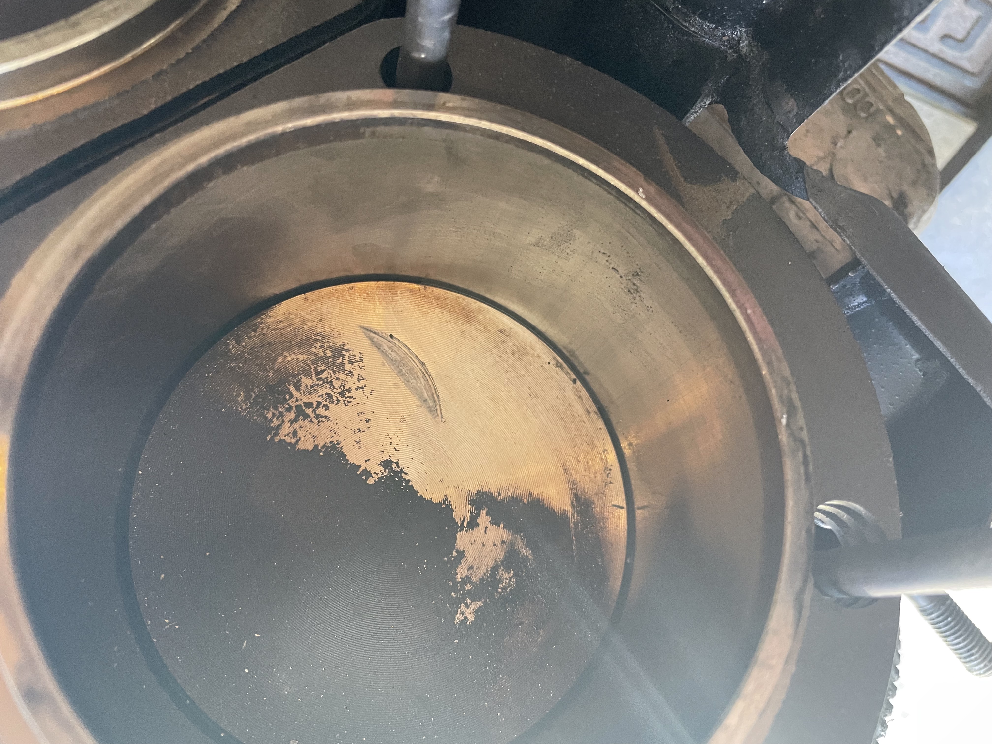

What happened? I had Ben here on Tuesday and he too drove the car for a short spin and it was driving out fine...Like the video. I put about 20 mile on her and is now about 100 miles total and did a fresh oil change just before.
2 problems under investigation
1) Heavy spark knock from time to time after spirited driving. Happens on over geared low RPM on tip in of throttle . not so much on down shift. Maybe lean carb or sticking weights in Malory ?
2) Heard what sounded like a dry bearing howl on idle that started to pull the engine down to a stall. put a few revs to here and noise went away This happened 2 times
...but every things seems to be pretty good till THIS:
Pulled the distributor on Thursday night to see it its sticking.. Pulled it apart and weights was just a little sticky but springs back k OK.. cleaned and lubed and reduced the mechanical advance to about 18*... SO 10 initial + 18 mechanical =28.. I was about 30 before. Maybe this will help. Installed and set up...but will not start. I tried lots of things but only popping.. IT tuns out I must have clock the advance plate 180* off?
YEP went out today at lunch and flipped the plate and installed. Started right up
set initial timing to 10* seem to be running OK...Went to check the timing at 3k

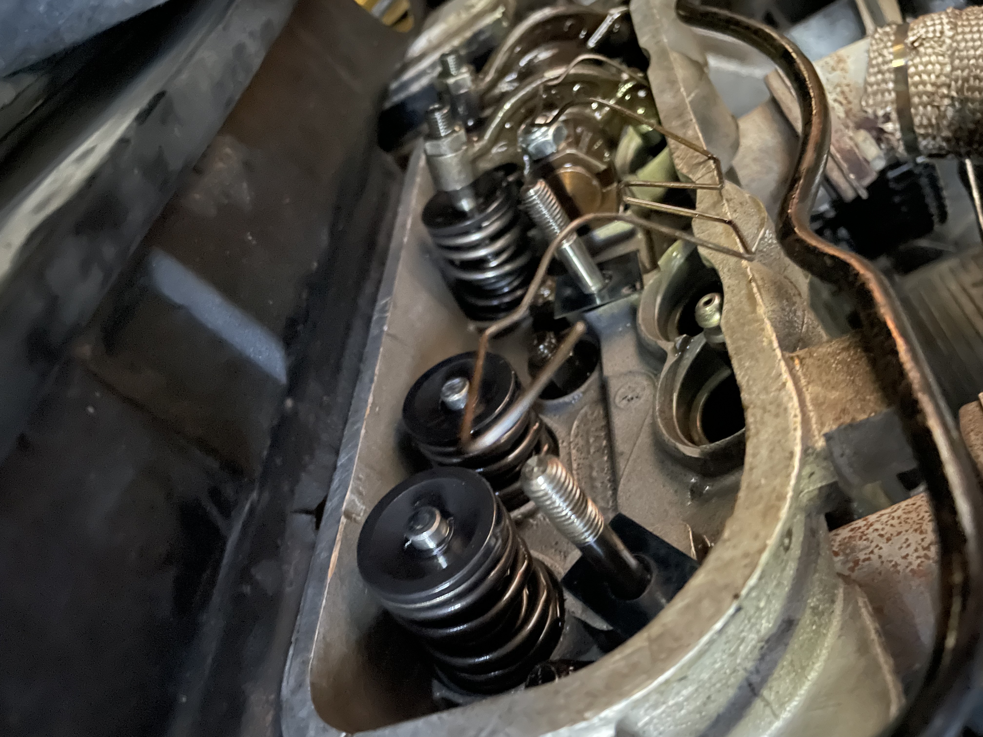

I increased the engine speed to 3k and started to set timing light to 28. Before I could find the mark, the engines startle clanging and clacking like somethings was loose in the valve train. Then that howl can back and pulled the engine to a stall .Restarted and engine had a miss fire turned out to be #3 and oil leak under car.. been dry to this point and now puddles
I pulled the valve cover and confirmed that the #3 intake valve was not moving and was stuck open. and pushrod was bent
Pulled Engine
Pulled head
Valve smacked the piston and bent intake valve. WTF! 3k is not floating the valves with double springs and rev limiter @ 6500. Never hit rev limiter at 6500
WELL in in this far, its getting bulled down to see if a spun bearing or something is causing the Howl.
I pulled the other head and Guess WHAt? Same thing. #1 intake kissed the head, looks like one time and bent the push rod and broke a pieces of the head by the push rod tube(it was bent)off the rocker
I noticed oil in the cylinder 1 with brass of bronze flakes and in the combustion chamber. This is odd as I just changed the oil and no metallic seen only the moly beack in lube( pretty good investigation for 4 hrs)

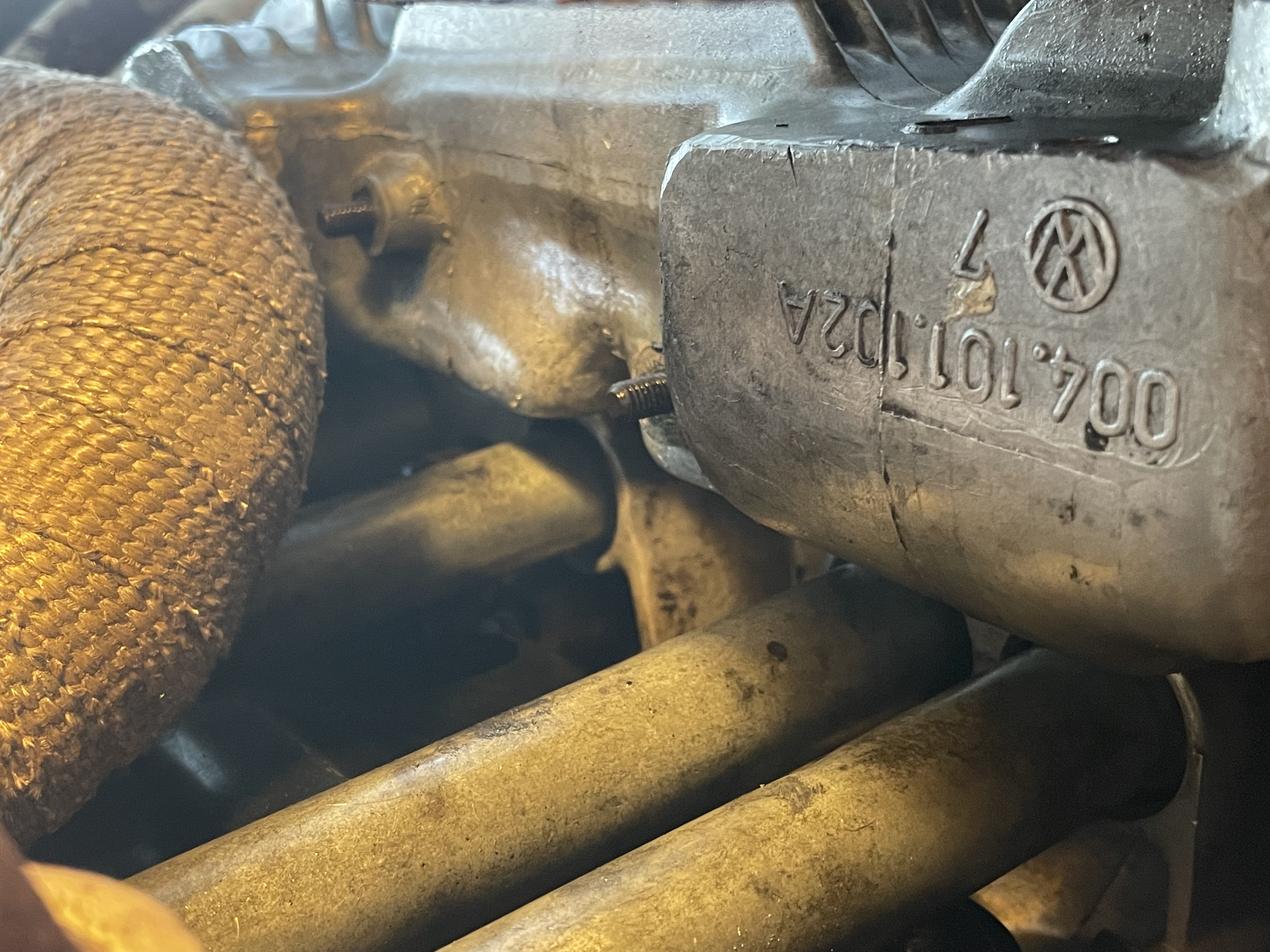

another pic
