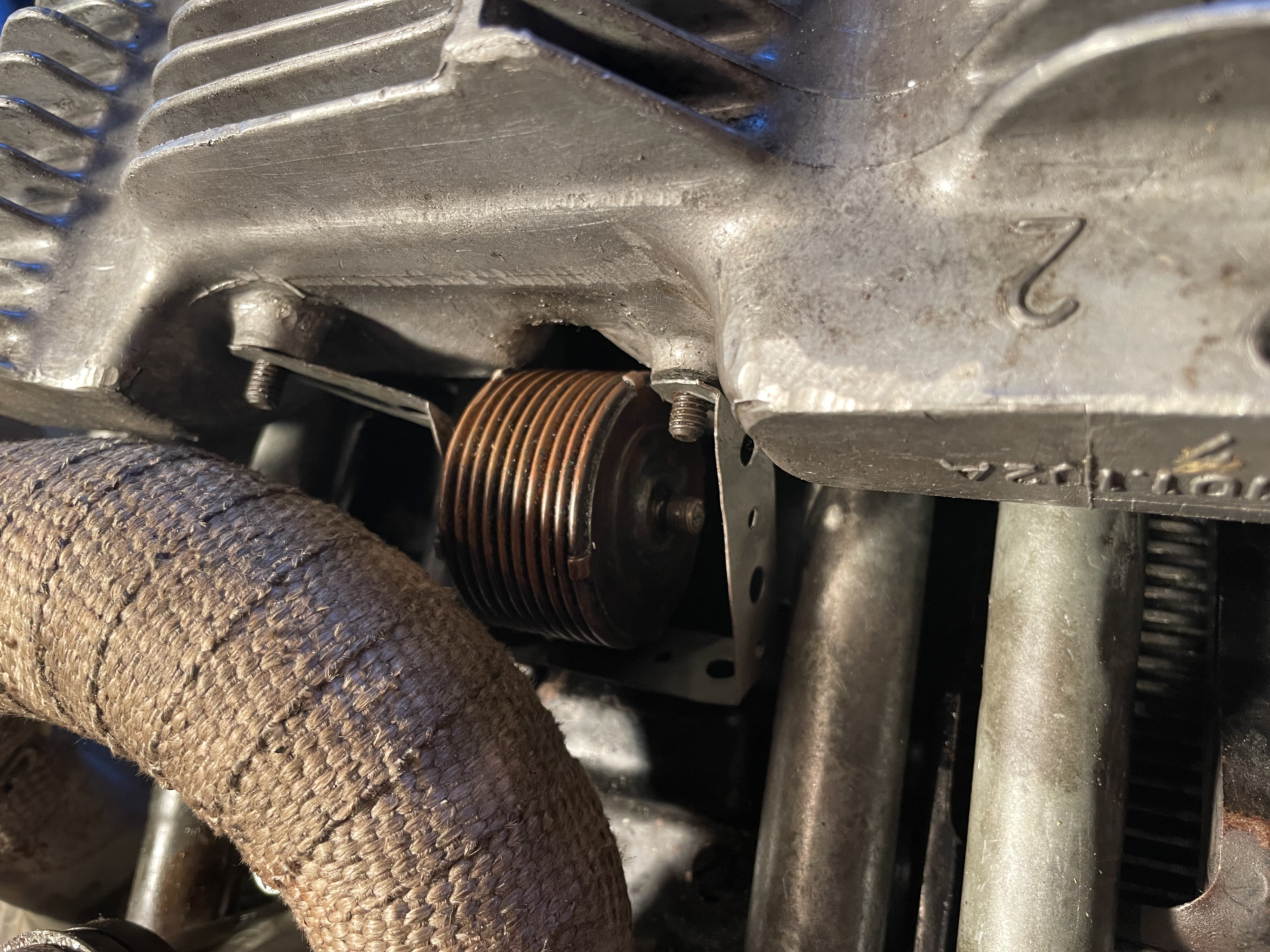

That thermostat is going to heat up pretty quick. I'm not sure it will improve the engine warmup versus locking the flaps in the open position.

Maybe a small metal heat shield between the therm & header? You could use the same two studs mount it. (IMG:style_emoticons/default/beerchug.gif)

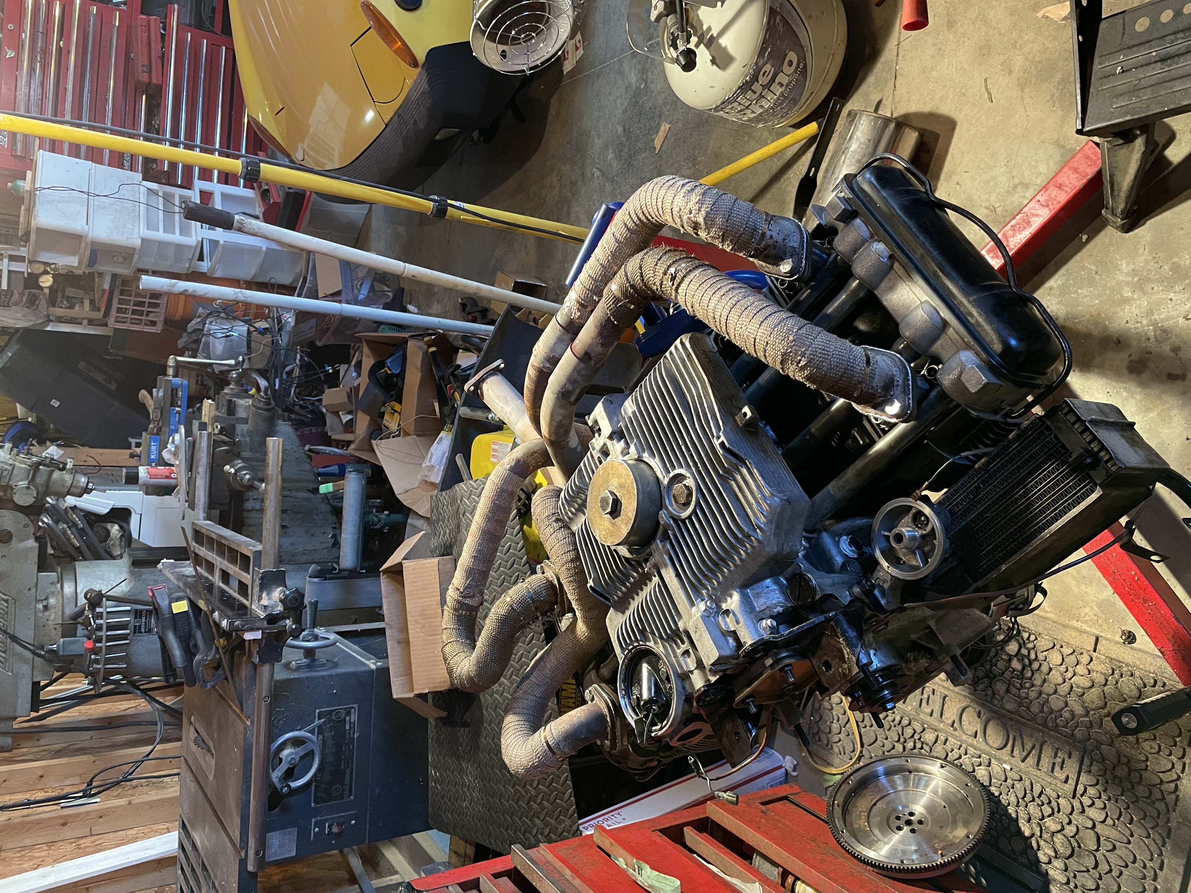

Today I finished the rockers and pushrods and set the valve lash for break in and installed new valve cover gaskets. I have the Stub pipes for the headers installed and the exhaust pipes while I have room to work. I will wrap the last of the pipes with the extra Fiberglass wrap I have left over.
I installed a new thermo couple on the # 3 head bolt and double checked the head torque on 3/4 head
Then I will start on the blow housing and tins, Plugs, wire etcAttached Image

I think I'll add a piece of coat hanger as a push rod to keep the Thermostat flaps in the open position till I get a thermostat location worked out. Last place did not seem to open after fair amount of driving

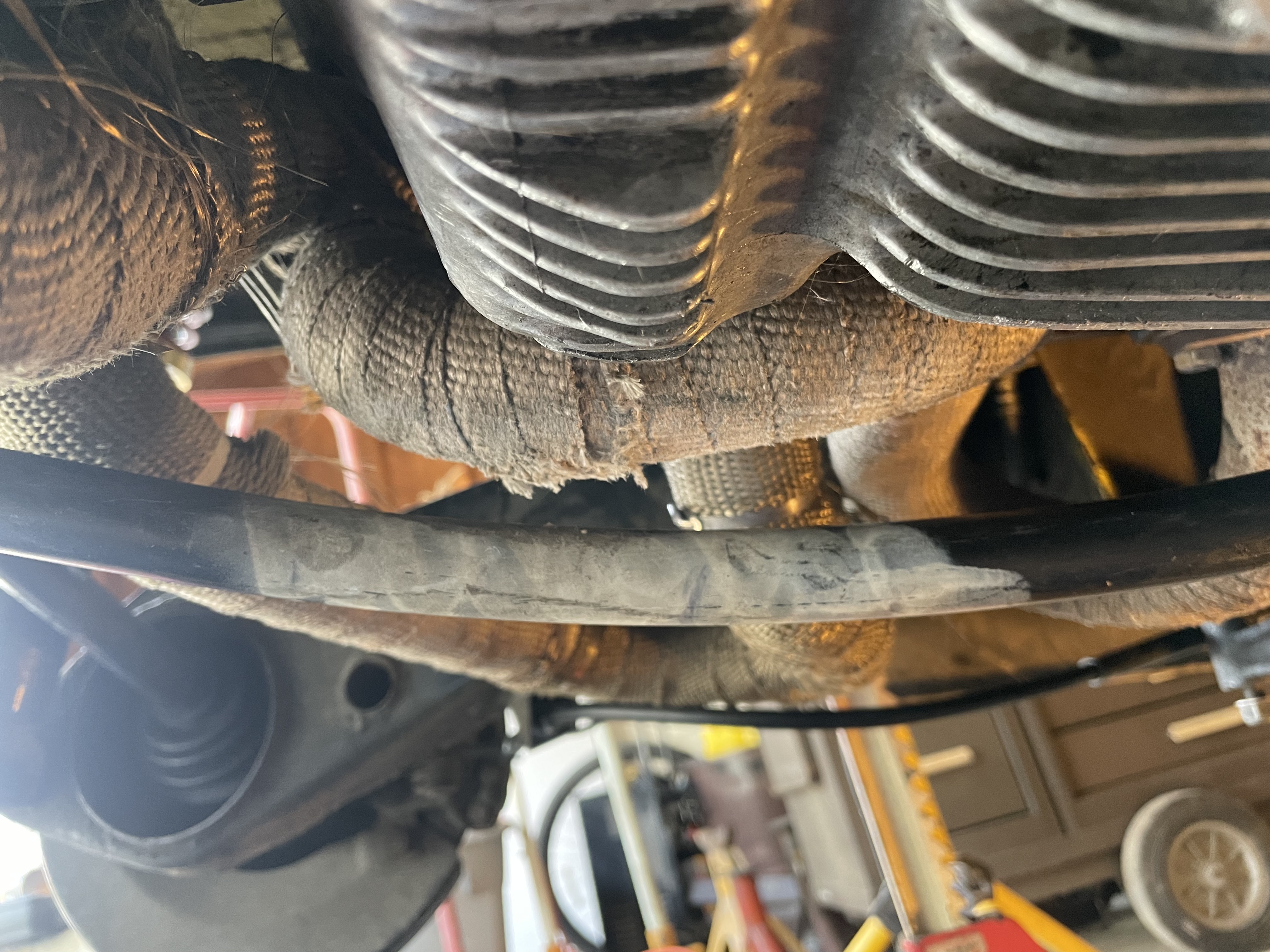

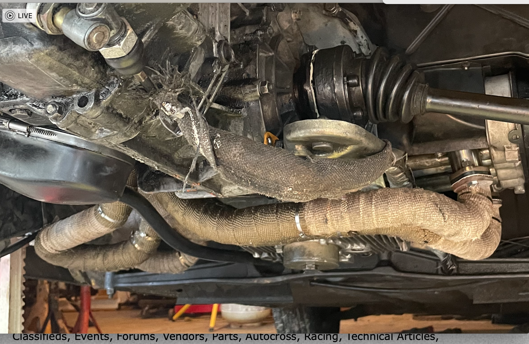

Shifter is now hitting the exhaust with the new sub pipes and the 1/4 flanges/gaskets. I have to pull the stubs and machine the steps off? or bend the shifter rod to get clearance for 4/5 gears

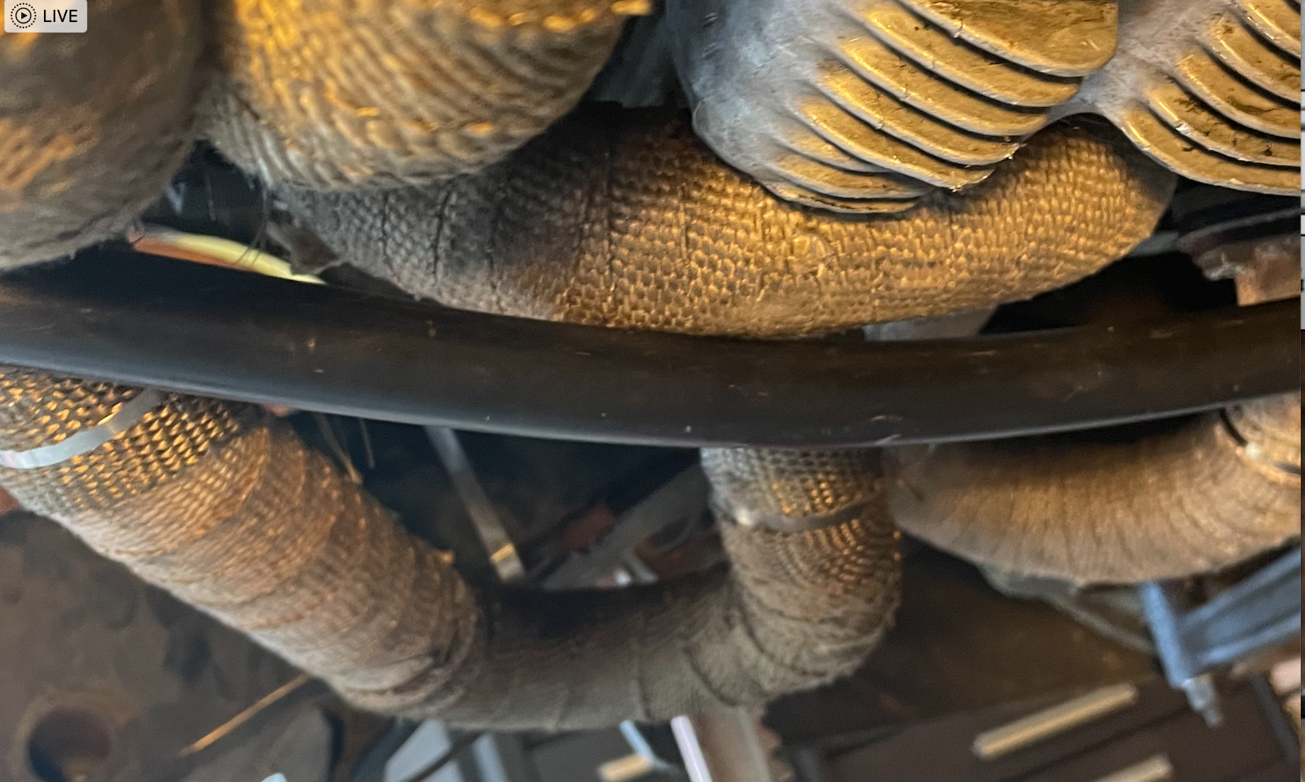

Member No.: 15,499
First pic is there it hits.
Here is the full shot under the car

Better to alter the rod than the stubs.
You can flatten out the rod a bit with a hammer if the interference isn't too severe.
The actual shape of the rod makes no difference as long as the ends line up correctly.

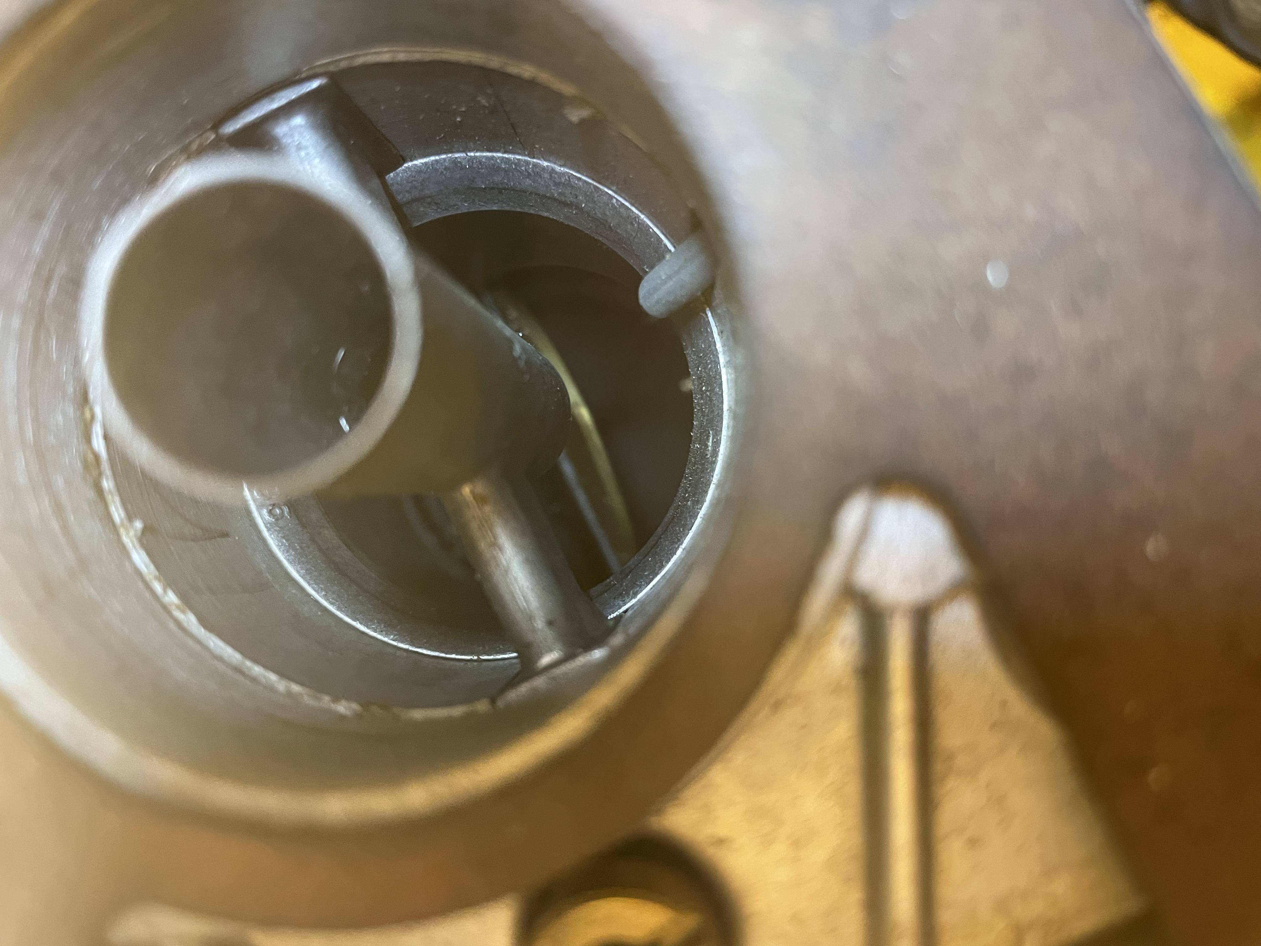

This is getting interesting...I think some on set the throttle pedal stop high to keep there kid from going to FAST!. ..
TIP: ALWAYS check Wide Open Throttle (WOT) when setting up your carbs or throttle plate.
MY stop on the pedal board took more that a few, to several turns to get WOT!
Heheheh..this is going to be FUN!
Now to hook up the ignition(Power) wires on coil and HIFIre/MSD then test fire and timing...
Take a look down the throttle bore HERE:

Working on the shifter clearance it from hitting the exhaust pipe. These are hollow and fairly easy to bend. I took @ChrisFoley advice to maintain the locations of both ends by tracing a template of the Original shape on paper with a sharpie. Then off to the Vise to alter the shape and bend to fit. It took a few tries but I think I got it. Seem to get all the gears and does not touch . I will have to changes the Shift stops of the Rennshift, but that is not difficult at all. The white is just cheap primmer to show me where the rubbing was happening. Ill dust some black paint on it when I install the cover and boots after a test drive
