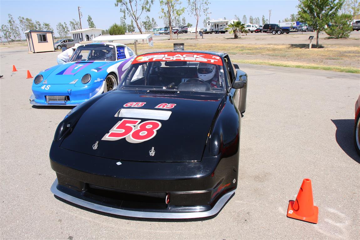

what say you? Will I be able to race this and not knock it off and trip over the new front spoiler?Attached Image

couple things that would be helpful here is exactly how much clearance each side and center then what suspension are you running. Would mainly be concerned about body roll and dive under braking conditions (full brake). How stiff is the car? Only then can someone (not me) do the math to determine if it is too low.

I hear you. ...I did not lower the car just replaced standard GT valence with 914 Rubber "sheridan" front spoiler.
This is how the car ran for many years prior to my ownership. I was thinking of taking it back to the configuration it ran as well as bringing it back to Irish Green.
I'm afraid with the 15's I run on the car may be too lower the car a bit too much. I still have the 16s... so we'll see.

Yes, you are likely to damage the front spoiler if you use the curbs. On some tracks the curbs are several inches tall. Also you will have to use ramps when loading and unloading from a trailer.
Another consideration is that you will be changing the balance of the car especially if the spoiler was added without a corresponding change in the rear of the car. I added a splitter to the front of my car and was surprised at the handling change. You may be correcting an imbalance or you may be aggravating a problem.
I had a nice splitter on my car but it ripped off in a race at Buttonwillow when I got a little too aggressive with the curbs. Never put it back on.

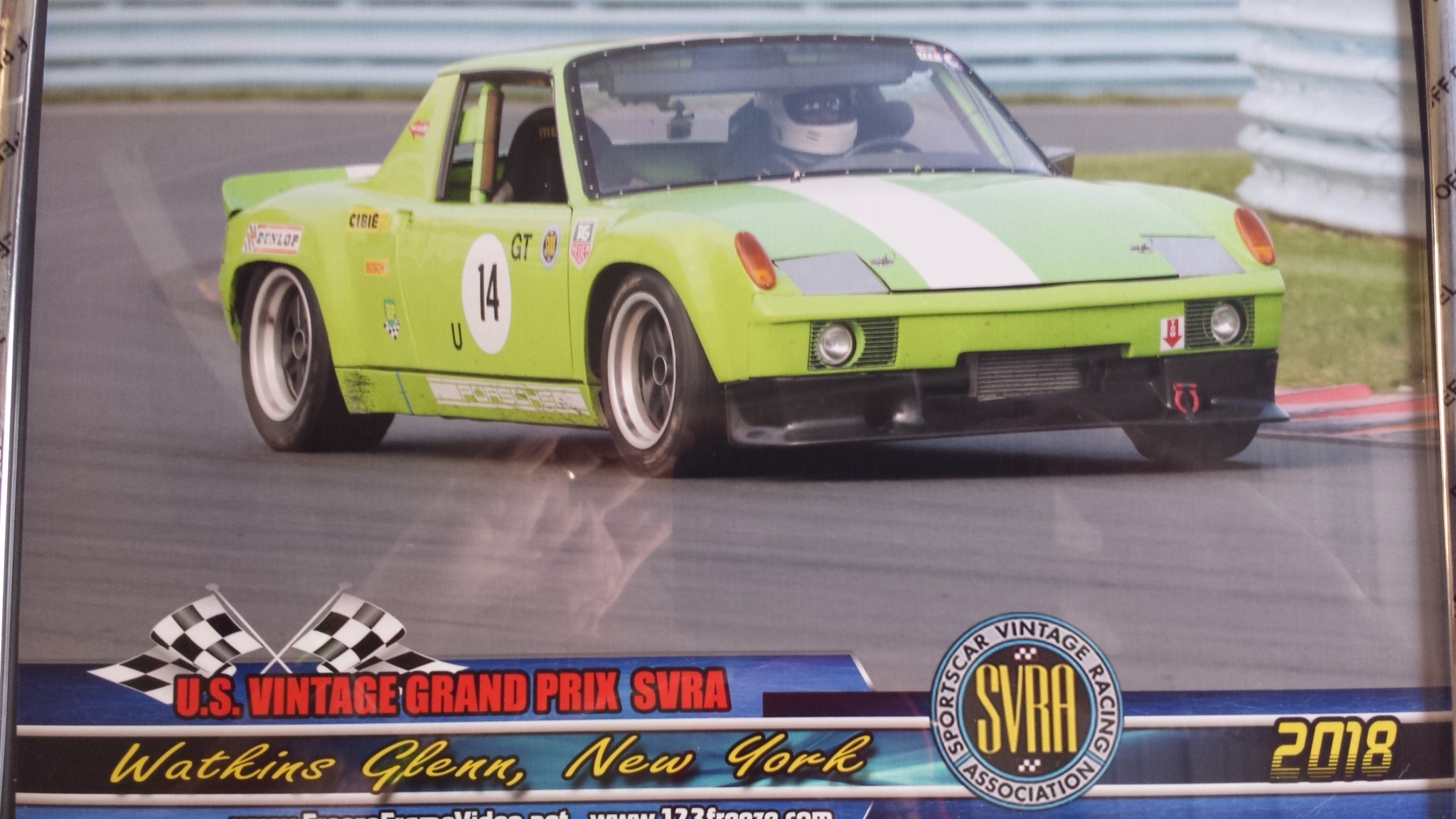

Here's mine with 15's--a bit higher than yours....ran it for years until going agricultural spin out at Roebling last December & ripped it off...putting another one on as we speak....Attached Image

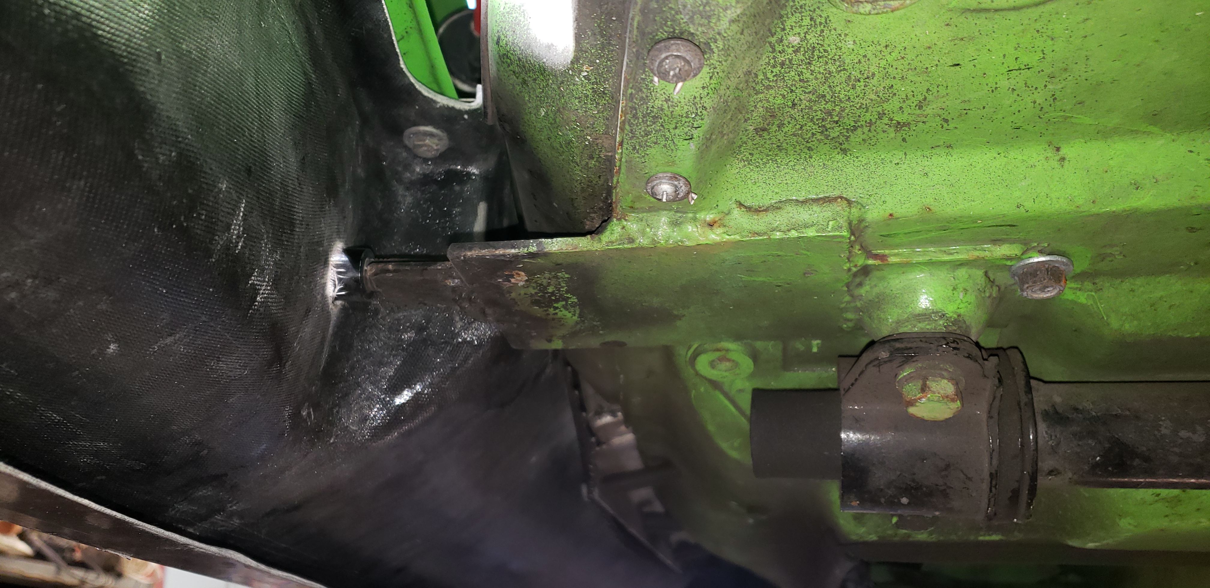

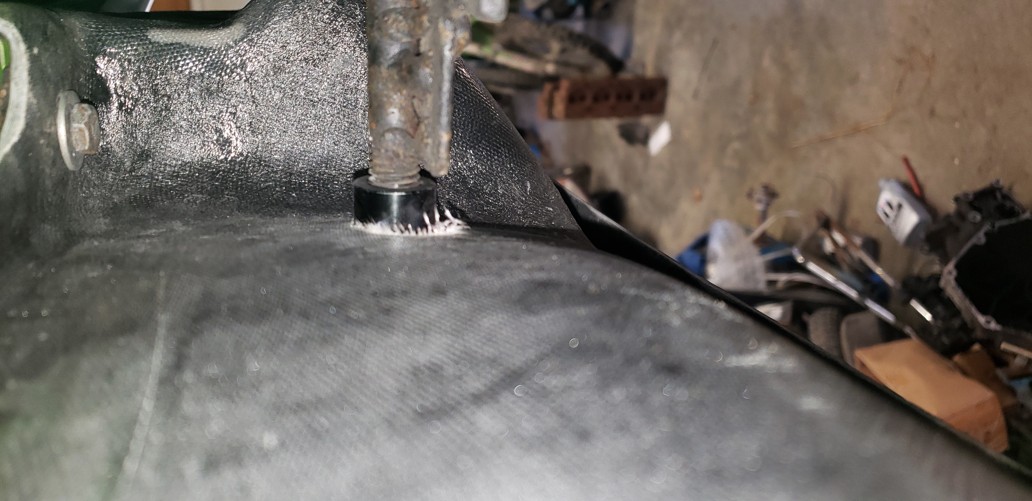

John, can you share the details of your tow hook? I need to re-engineer that now.

Pretty crude but works...Attached Image
Nother view...Attached Image

I'm at 4 inches....cleared serious corner rumble strip at Sebring...Attached Image

Damn. That’s no good. How effective are rubber lipped dams at stopping high speed air? The one I’m running is 3-4” from the ground but it has a rubber lip that flexes so it wouldn’t be as susceptible to damage from an or. I think I bought it from 914rubber.
