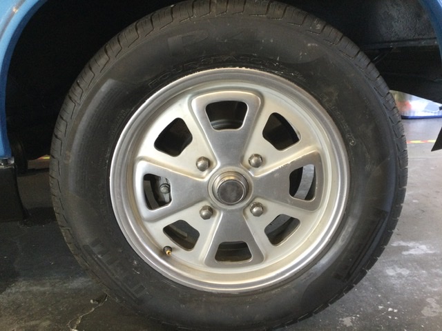

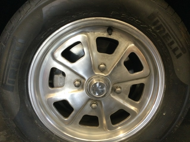

In process of cleaning up my wheels while engine and transmission are out.
I have read through many threads and have done countless google searches.
I have not found a definitive opinion or agreement among the brain trust of how to closely or best match the anodize look.
One rim looks pretty good after I did some polishing
The second rim however is missing some of the anodizing.
I really like the original look which I think is the polished raise parts and the anodized recessed portion.
Your Input is much appreciated.

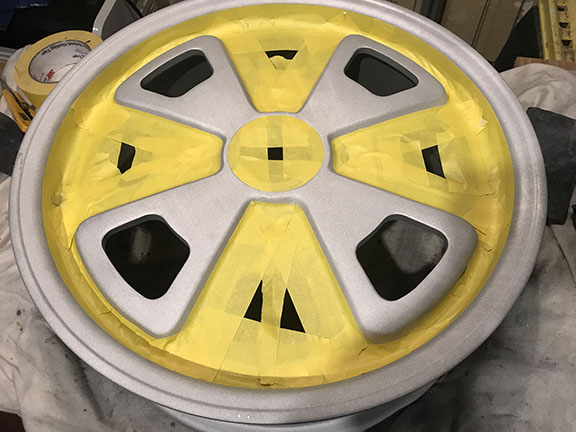

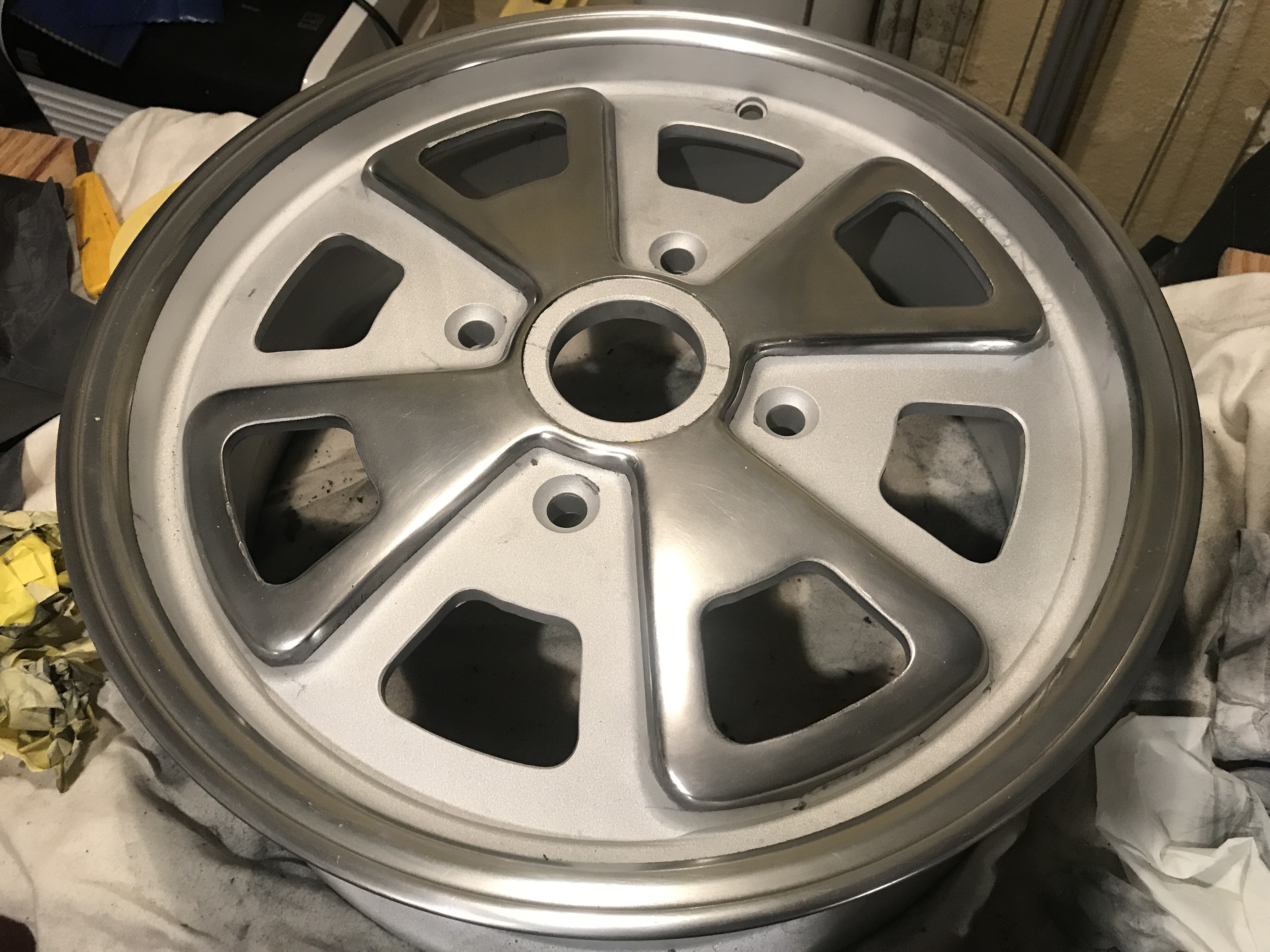

The best option is to have them restored by a pro like Al Reed. Wheels are really time consuming and as much as I like to DIY, having the wheels done professionally is money well spent. That said, I got decent results using lye to remove the anodizing, polishing / masking the petals and soda blasting the spaces in-between. Then sealing with clear coat...but if the clear ever chips, you’ll probably need to strip it off and start again. Here’s a few pics. I did this more as a proof of process, so I didn’t clean up all the rash. I'm happy with the look, but they took way too much time (IMG:style_emoticons/default/wink.gif).

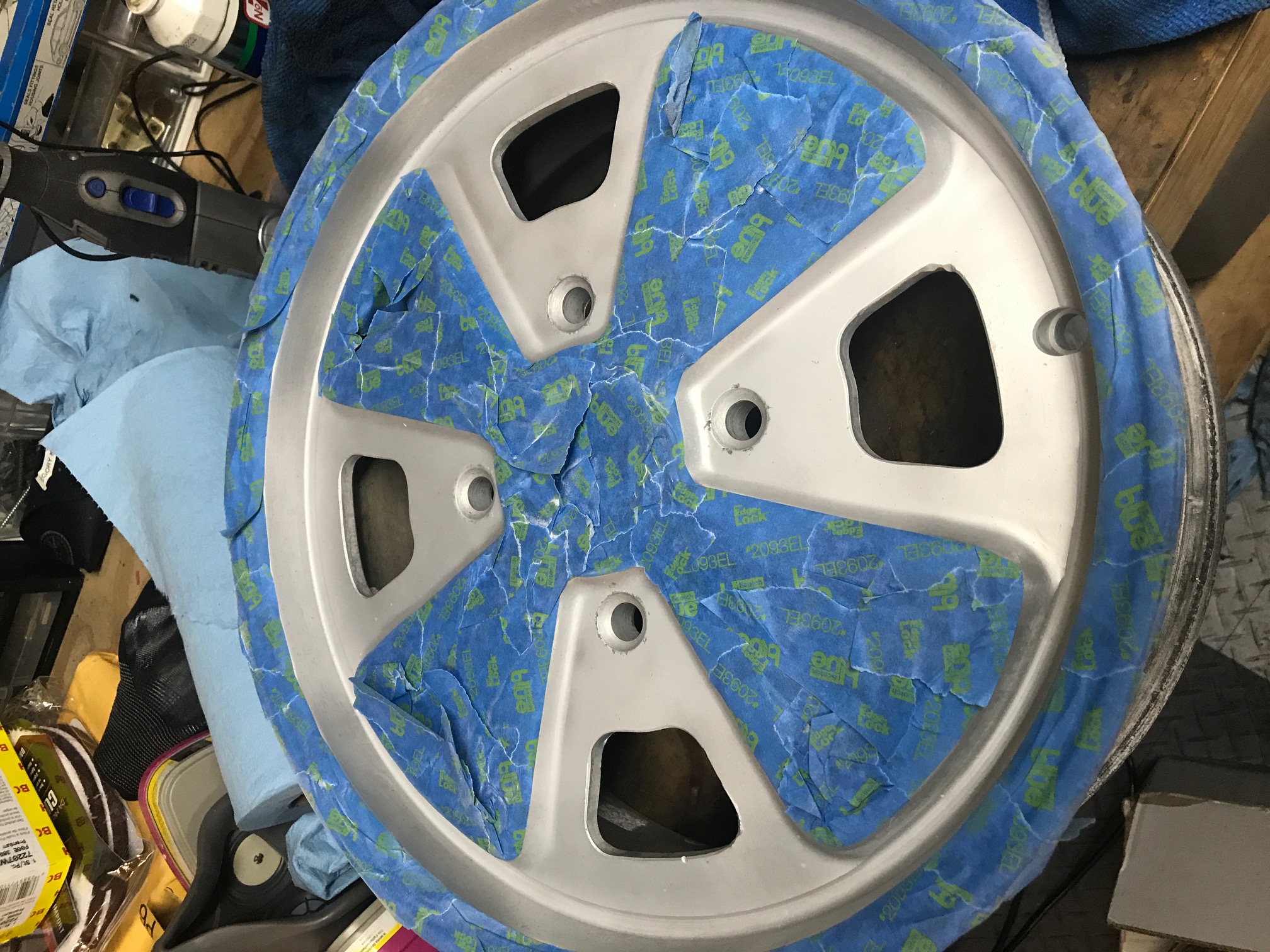

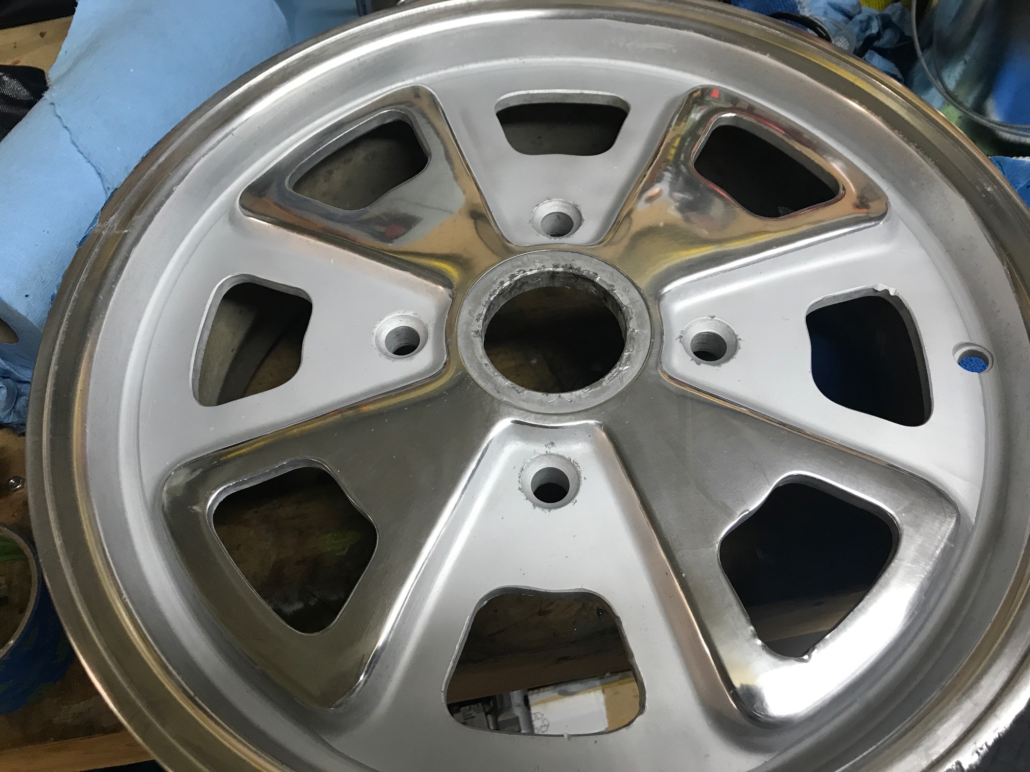

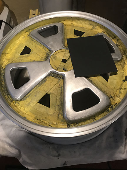

I went the DIY method like Ian. The PO of my car took the perfectly good but slightly faded clear wheels and sanded and painted them. I had them glass bead blasted and then masked and hand wet sanded. 2 weeks and a very sore shoulder, but I'm happy with the results. I didn't want them shiny polished, so I ended at 3000 grit and then hand polished with Mothers. Inevitably, some deeper scratches and areas where the blasting pitted deeper than my sanding still remains.
burlybryan
post Feb 15 2021, 09:52 AM
Posts: 134
Joined: 25-May 20
From: Saint Paul
Member No.: 24,311
Pic of the bead blasted wheel masked for sanding.
