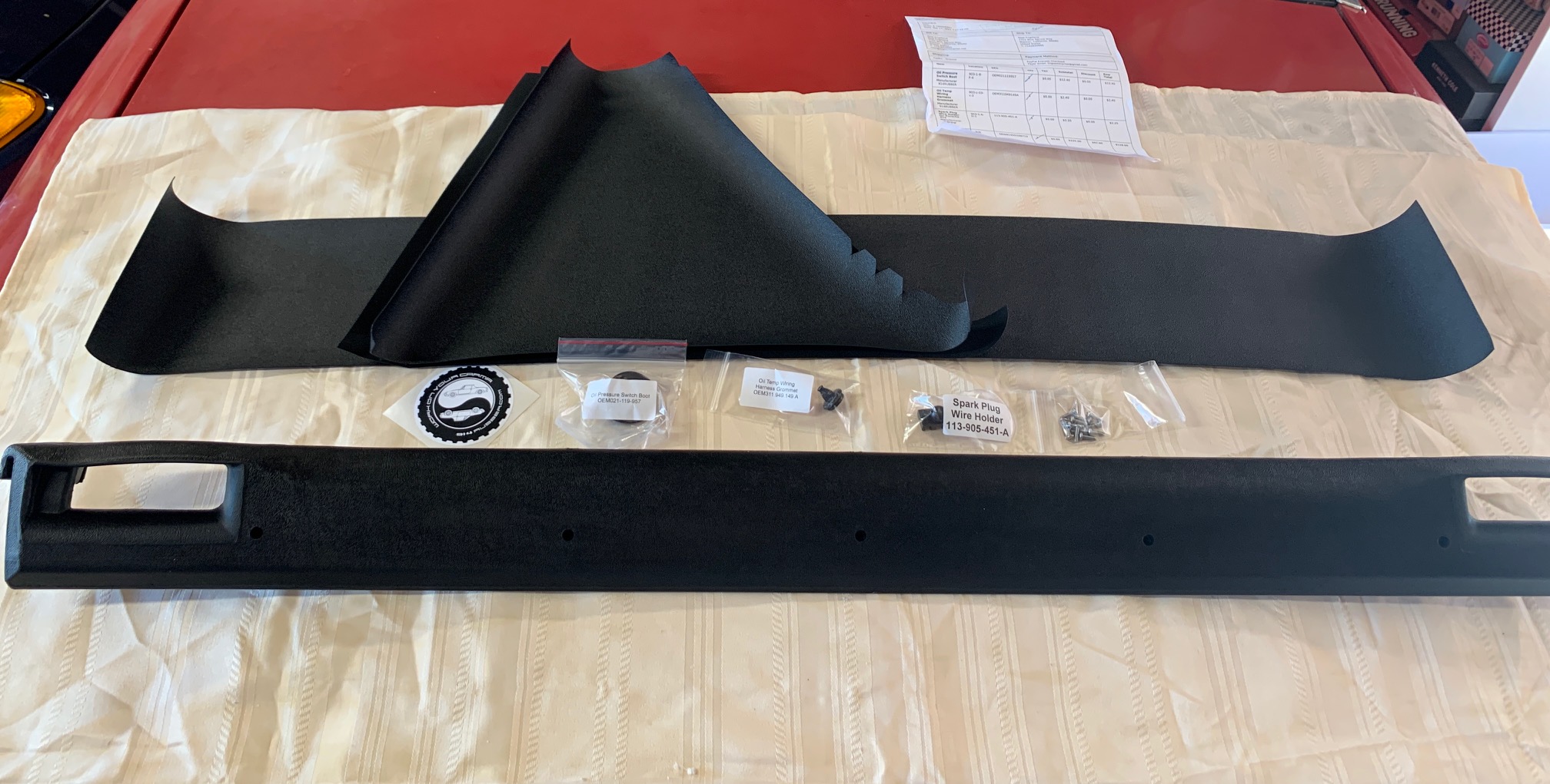

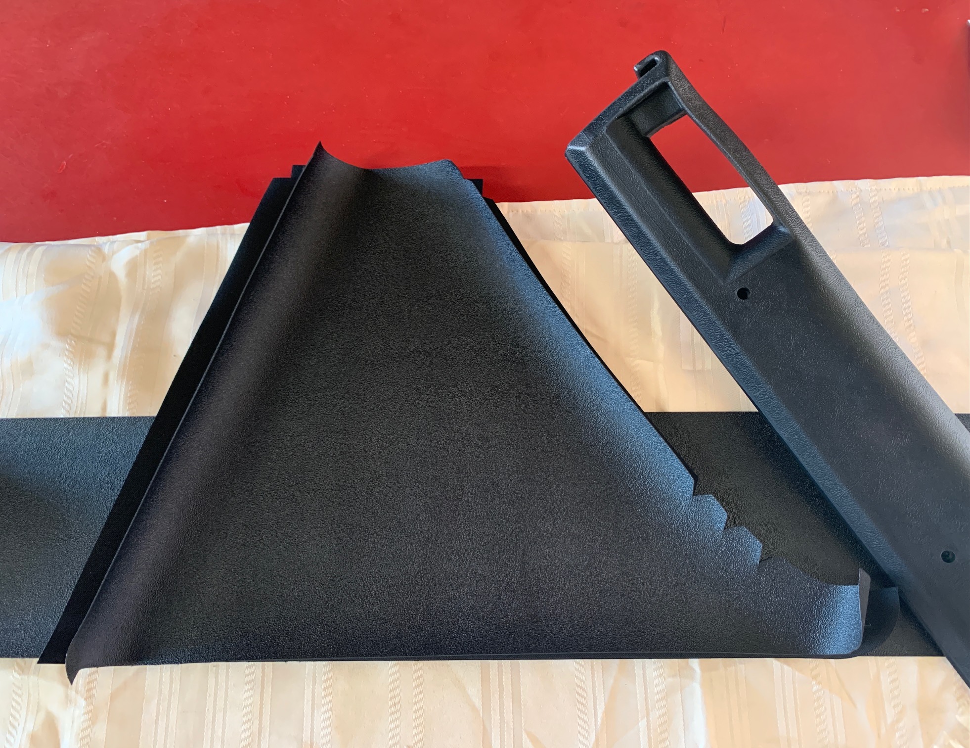

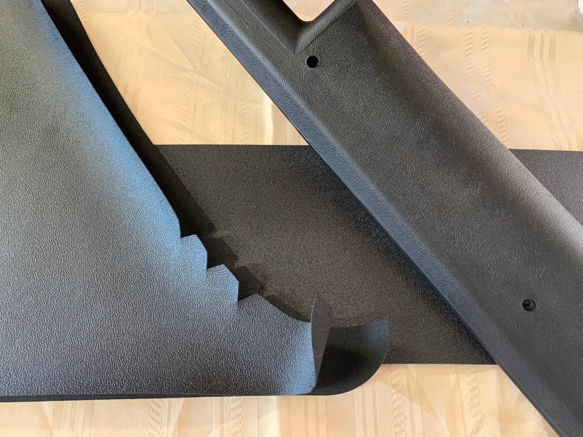

Thanks again Mark! Opened the box today and amazing items.
