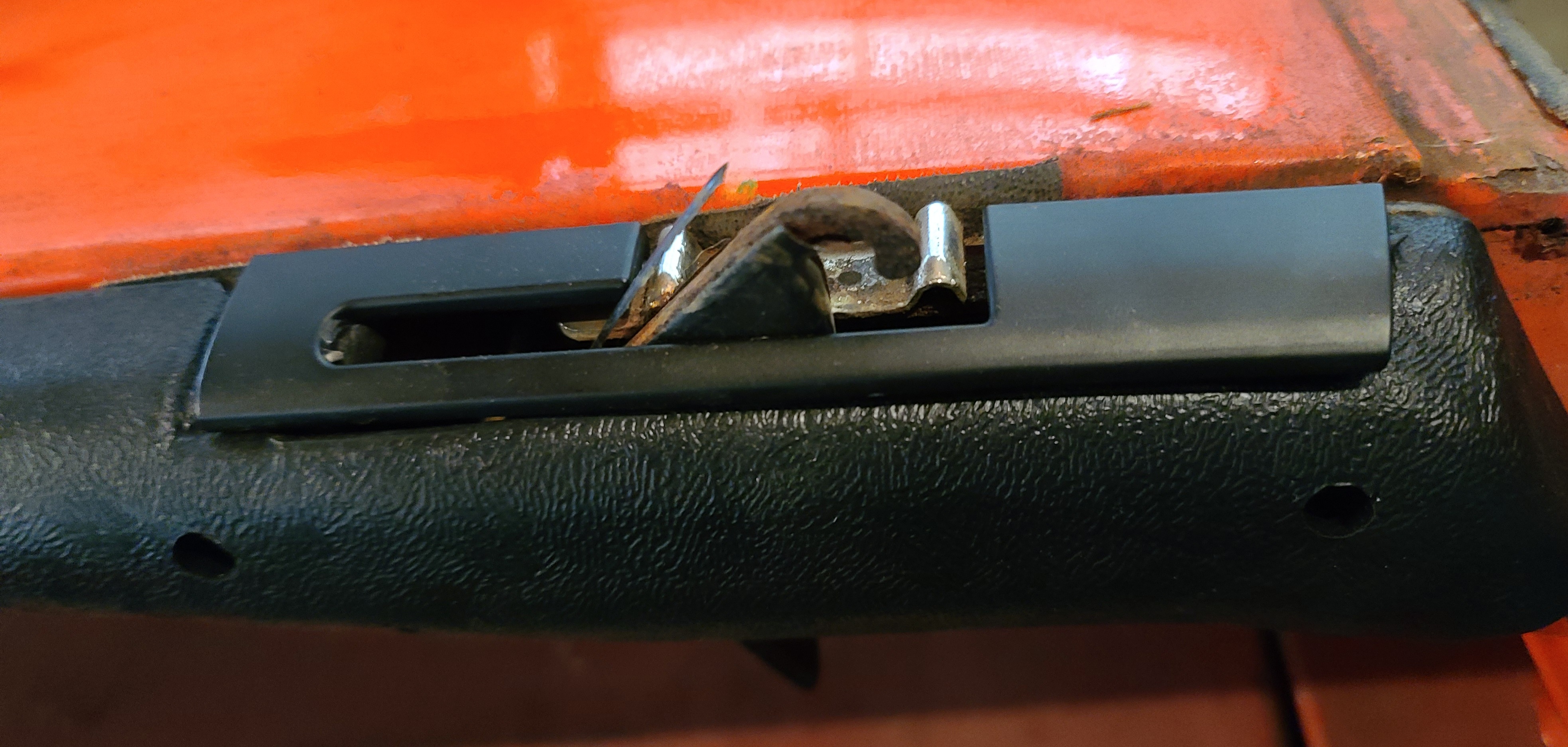

As promised. We made these covers to be able to offer up a solution for those that were having issues. This way, when you go to install you have options. The profile we changed slightly so that the ends towards the outside of the car taper to fit the parts detent. This was something that bothered me on the original part.
I ran these at WCR. We made some pins to push into the part to help grip it, wound up adding a little butyl as one pin was slightly off and they can't go too deep as there is a metal lip about 3/16" under the top of the part.
Pretty happy with the result. Also much easier to access the latch.

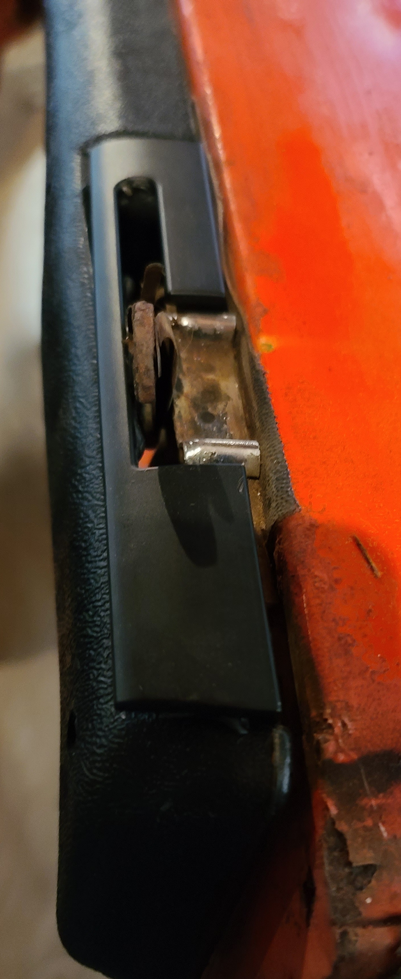

More

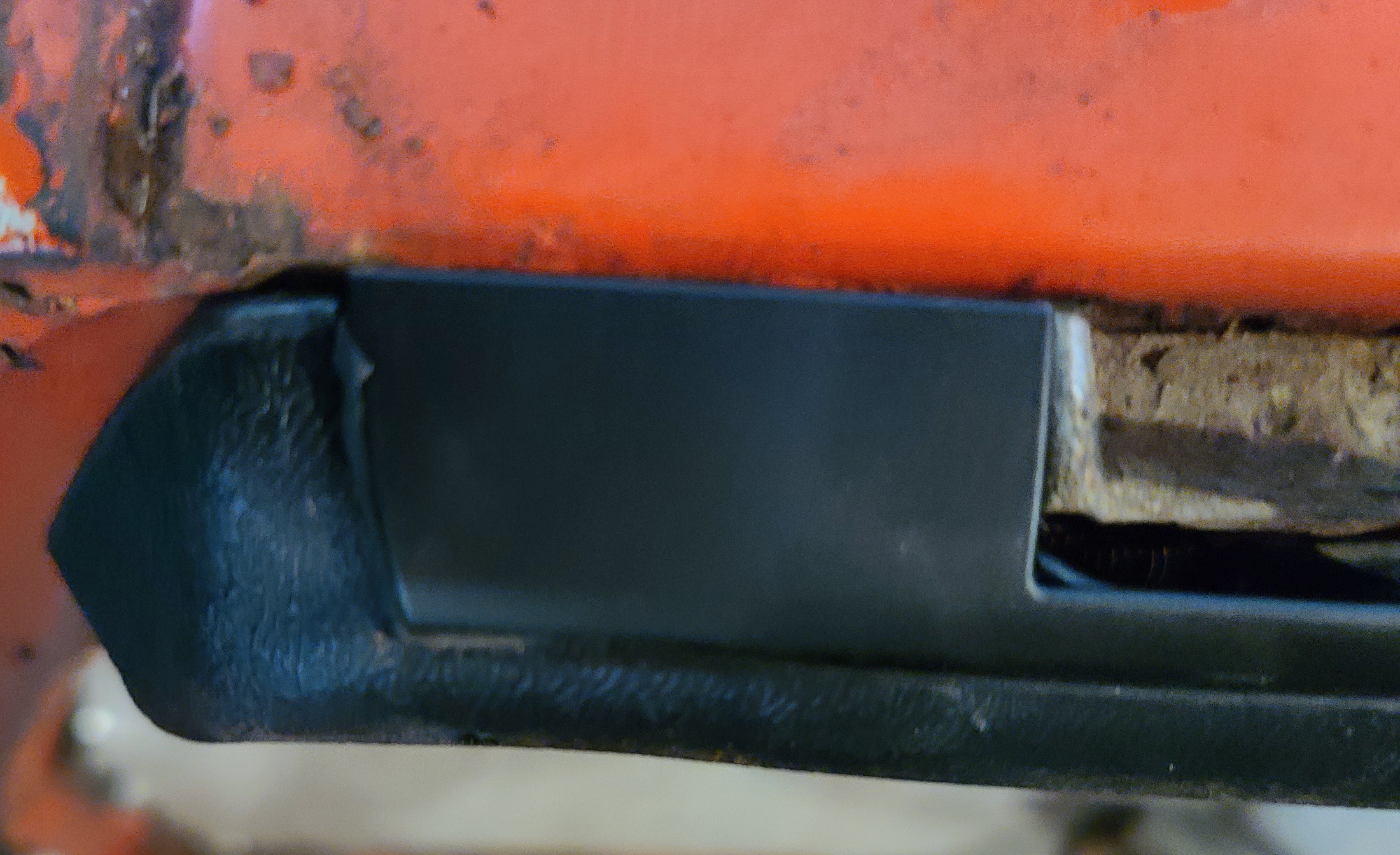

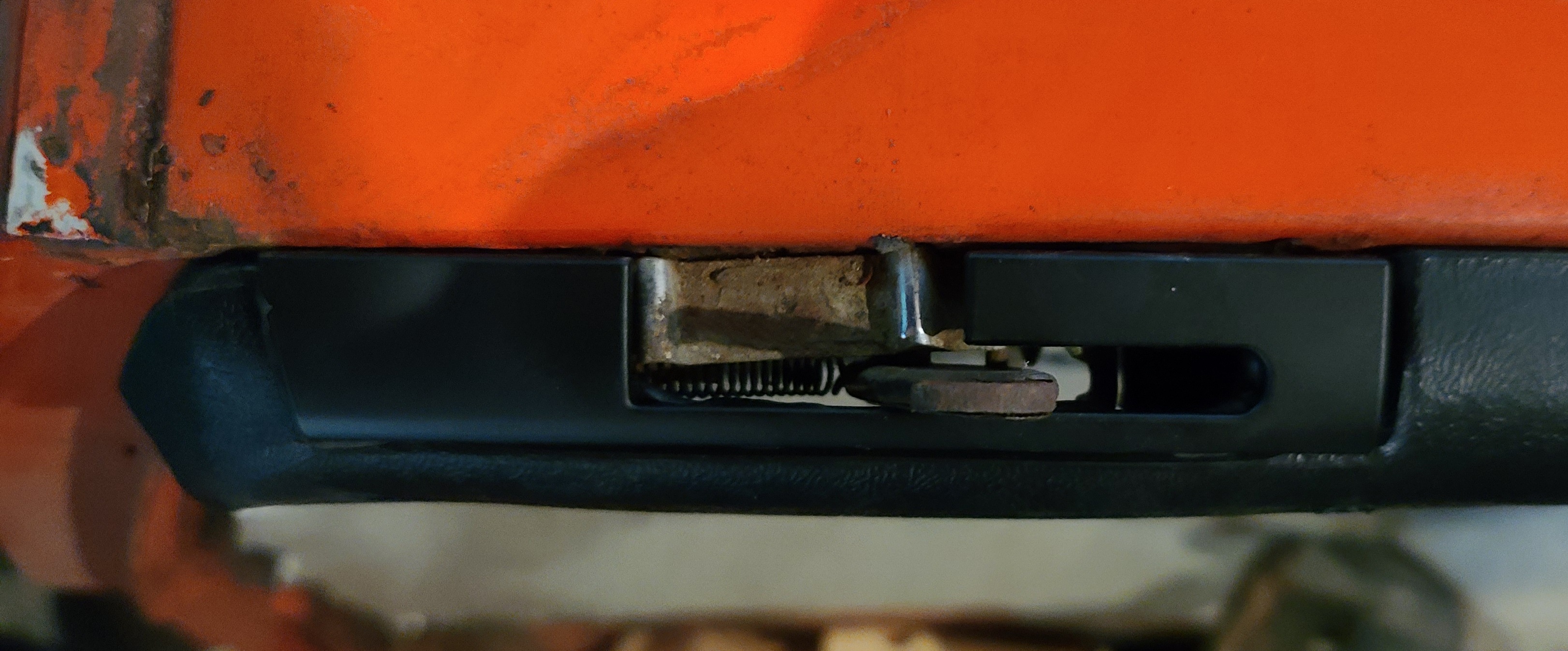

I test fit these on an early car here so I could make sure that there was no variation with latches that could interfere. Note that the roll bar pad is NOT screwed in. I do think some deformation is due to mounting screws being over tightened.
You can distort the pad buy over tightening the screws. There is a metal substructure that can exert enough pressure to pucker the part when tightened down. It also makes them more difficult to remove.
