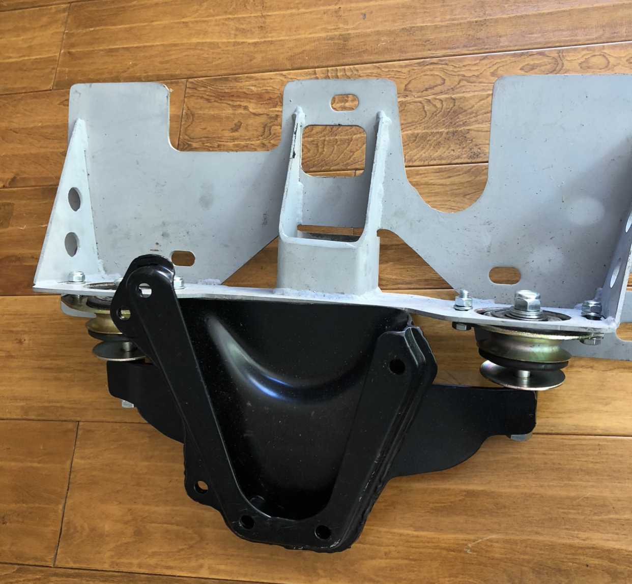

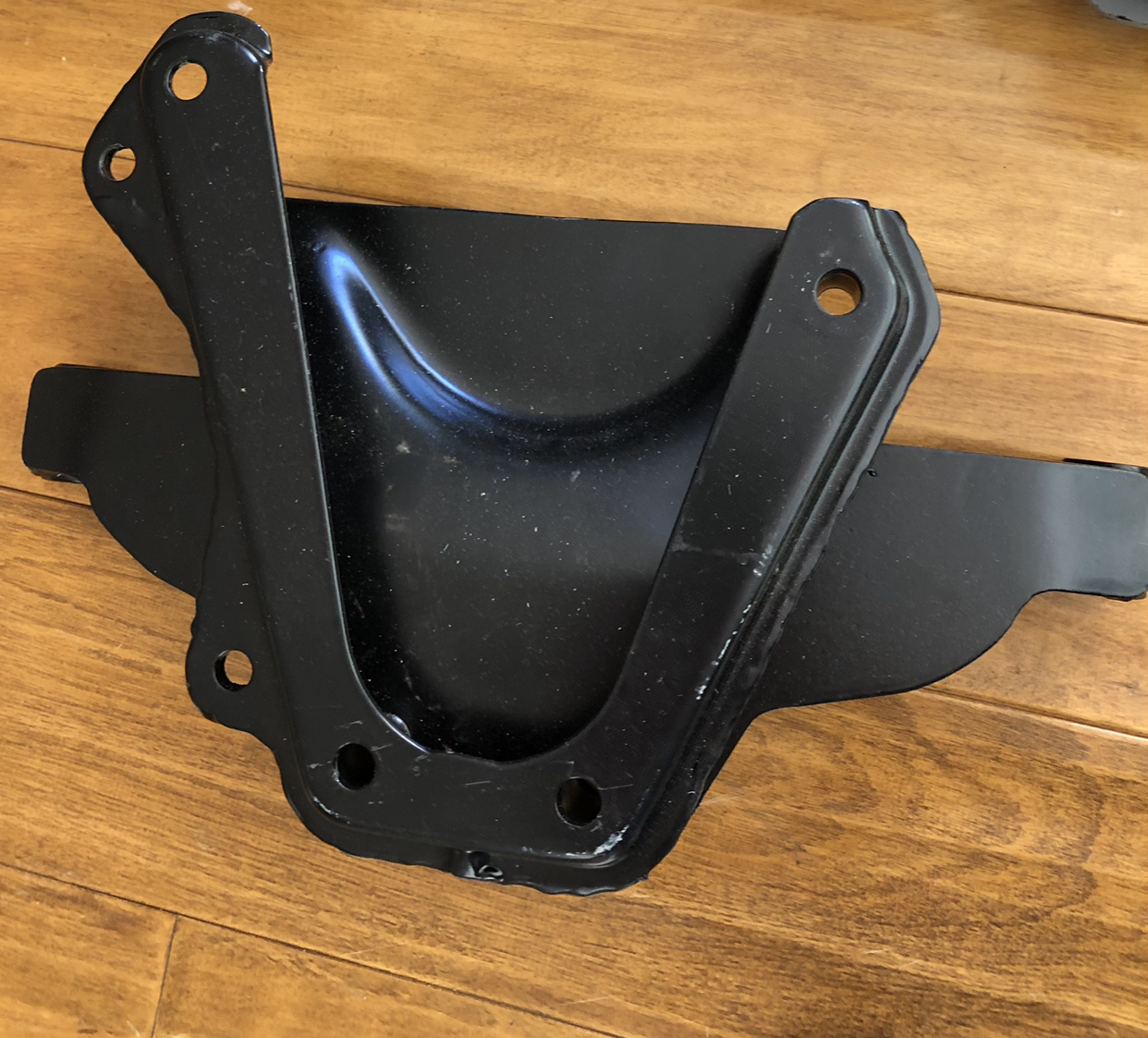

Can I ask for some help in figuring out what I’ve got going on here. This looks to me like an early design/replica of the factory 914/6 amount but it does not want to work with the work mount that actually bolts on to the engine.
When I did a test fit they don’t bolt up properly and the black engine side mount won’t fit vertically and is forced to be offset/angled which isn’t right of course.
So either the grey mount is off, the black mount is the wrong one, or these aren’t compatible. I’m not experienced enough to spot the issue, my hunch is the grey mount is OK and the black engine side is incorrect but that is a guess.
Thanks for any help you can offer.

Superhawk996   That definately is not the 914/6 OEM factory style...   Mar 14 2021, 08:25 AM
930cabman   Have you contacted the manufacturer? We recently ...   Mar 14 2021, 08:41 AM
sixnotfour   blk mount hangs below on the grey   Mar 14 2021, 08:43 AM
Superhawk996   blk mount hangs below on the grey :lol: :wors...   Mar 14 2021, 08:46 AM
Tdskip   Oof! So I have it upside down in the first pic...   Mar 14 2021, 08:53 AM
9146GUY   The grey mounts welds to the firewall. The black m...   Mar 14 2021, 09:07 AM

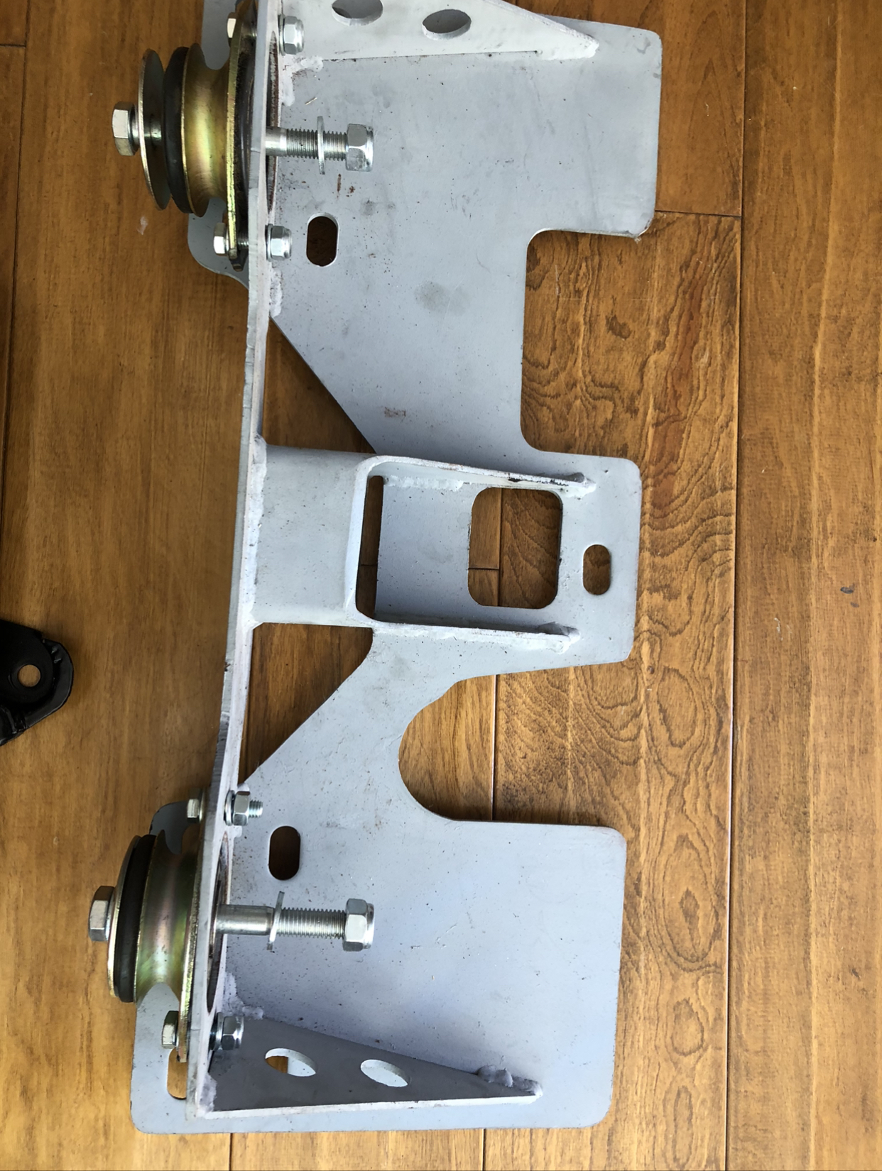

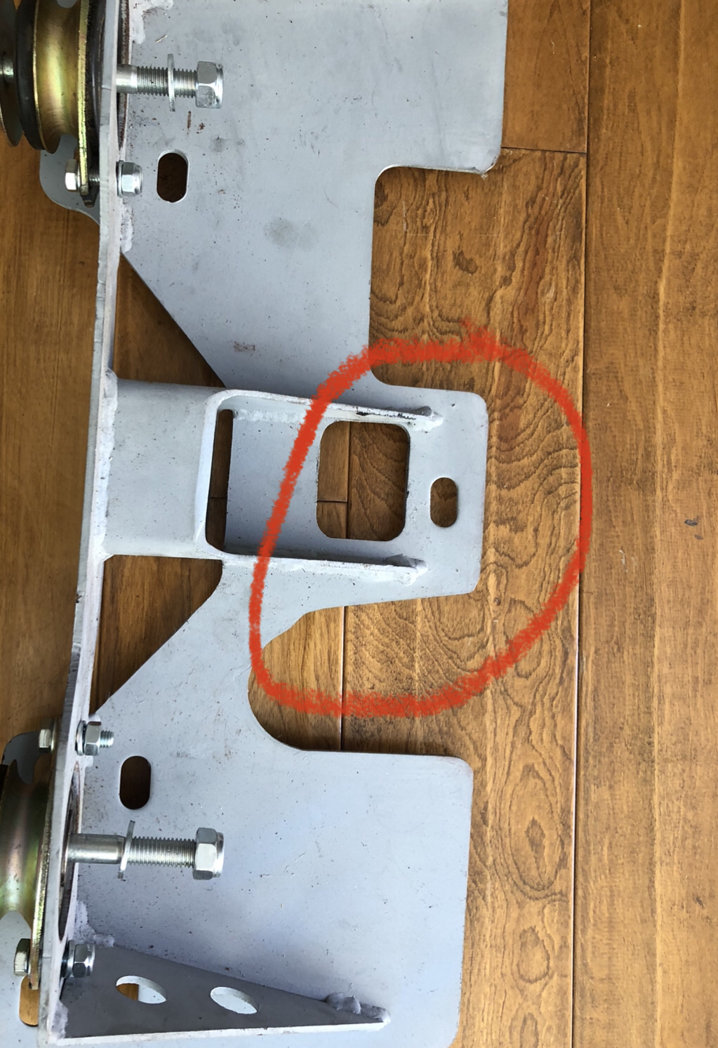

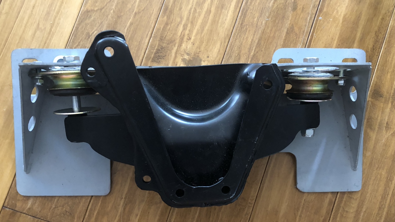

Tdskip   OK - right side up this time. Grin. I circled in ...   Mar 14 2021, 10:44 AM

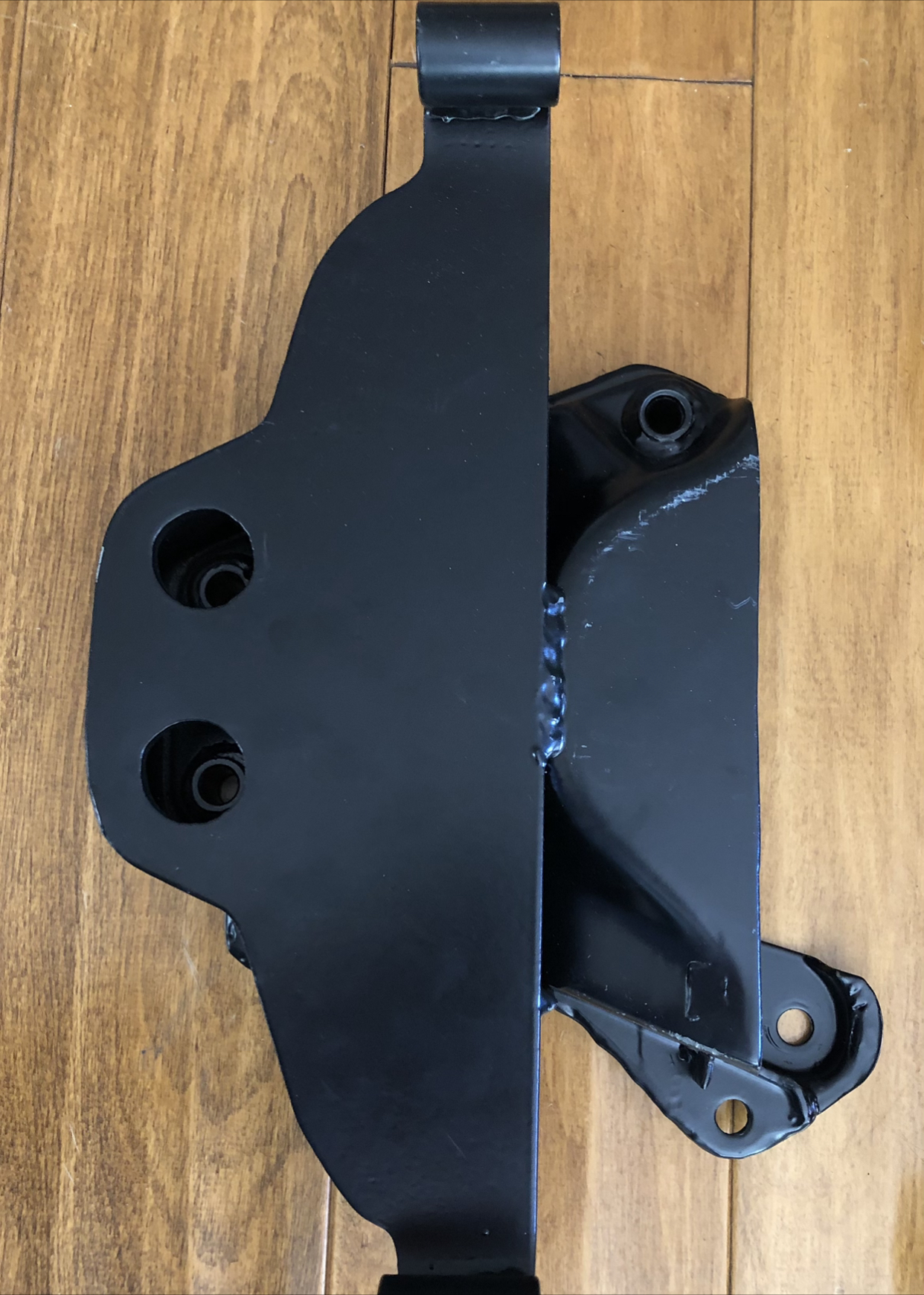

Mark Henry   It's like the RJ copy I made, the engine mount...   Mar 14 2021, 11:14 AM
Tdskip   It's like the RJ copy I made, the engine moun...   Mar 14 2021, 11:18 AM
Mark Henry   That's an old style mount, you have to remove ...   Mar 14 2021, 11:37 AM
Tdskip   That would be great, thank you. Can she just cut ...   Mar 14 2021, 11:43 AM

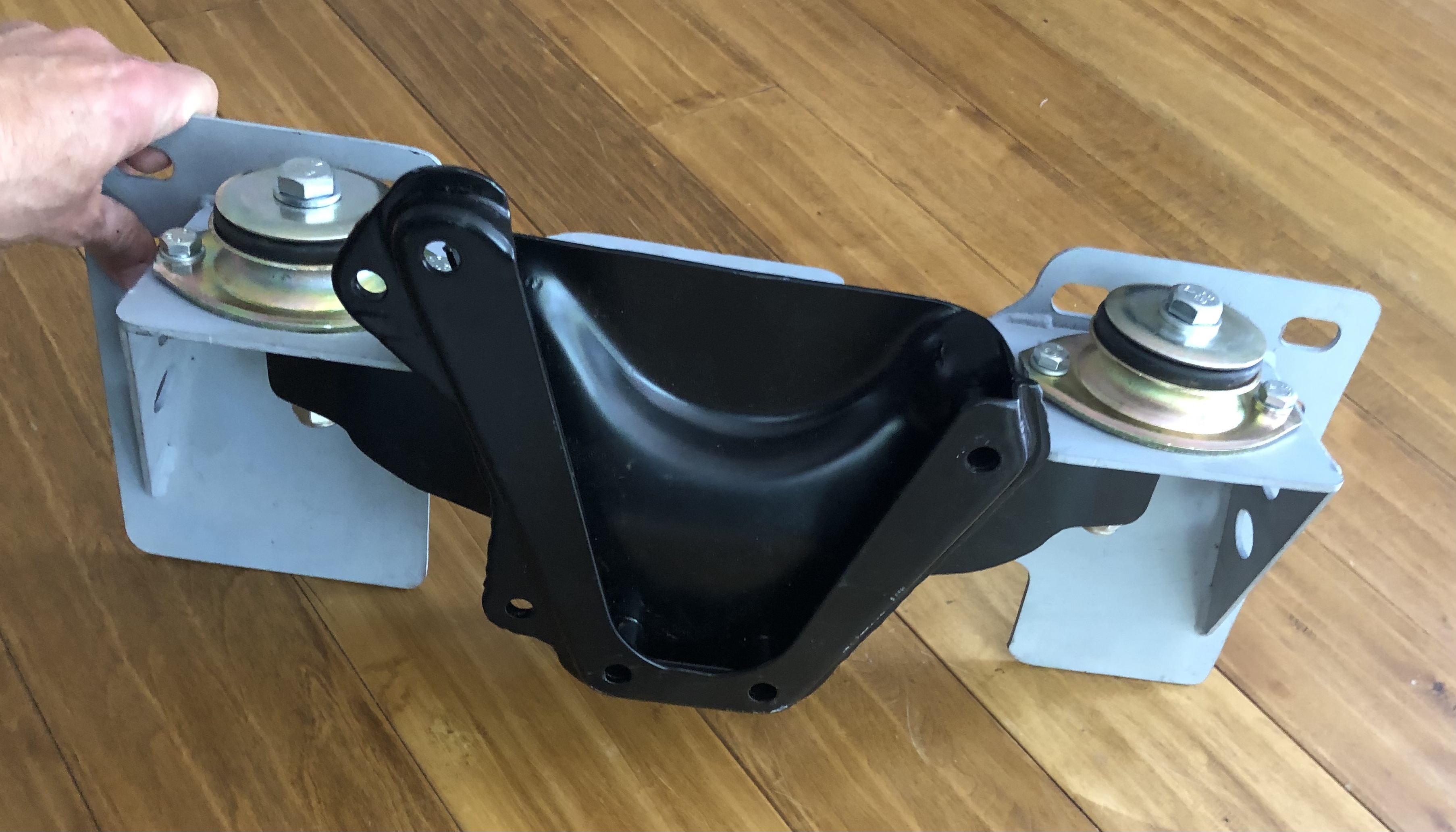

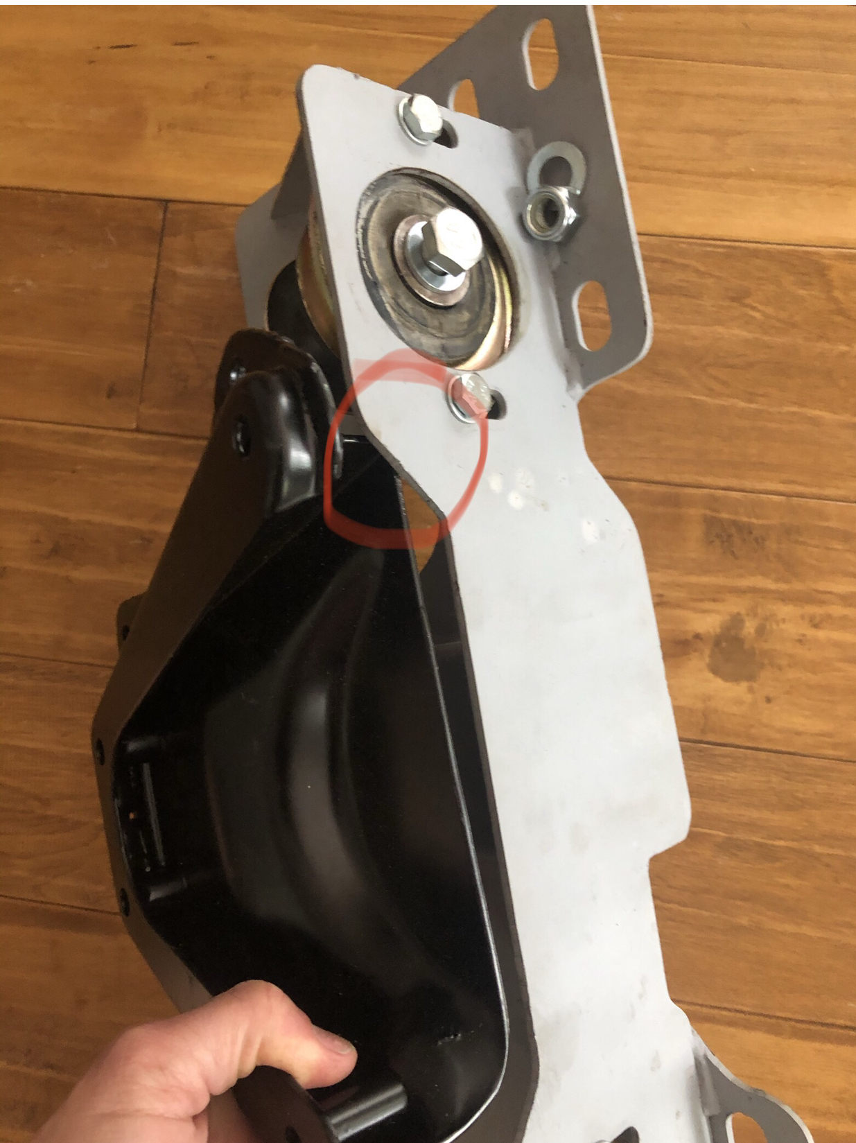

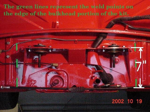

bretth   Doesn't the rubber mounts go through from the ...   Mar 14 2021, 12:43 PM
mepstein   Picture from Rich   Mar 14 2021, 12:50 PM
Tdskip   OK - updated.   Mar 14 2021, 03:57 PM
sixnotfour   rubber mount upside down   Mar 14 2021, 05:26 PM
mepstein   rubber mount upside down Yep. Keep trying. You...   Mar 14 2021, 06:08 PM
Tdskip   8th times a charm! I am such a dolt.   Mar 14 2021, 06:24 PM
930cabman   8th times a charm! I am such a dolt. I wou...   Mar 15 2021, 07:37 AM
rgalla9146   Cup washer on top faces up.   Mar 14 2021, 07:31 PM
Retroracer   Yup, you're working through every combination...   Mar 14 2021, 08:23 PM
