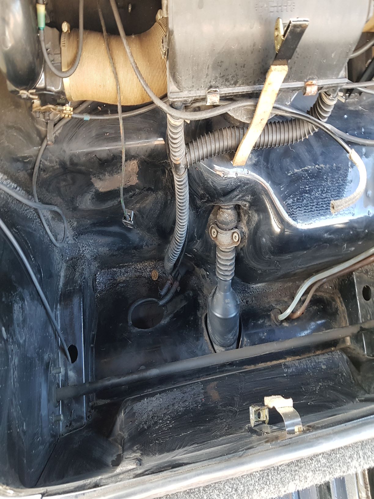

So the car is an Ohio car all its life, with.... a very solid body. I started stripping today and outside, the rear jack points and thresholds its very very good so far. Hell hole is solid from the top and had good photos of underside from Tom, so hopeful.

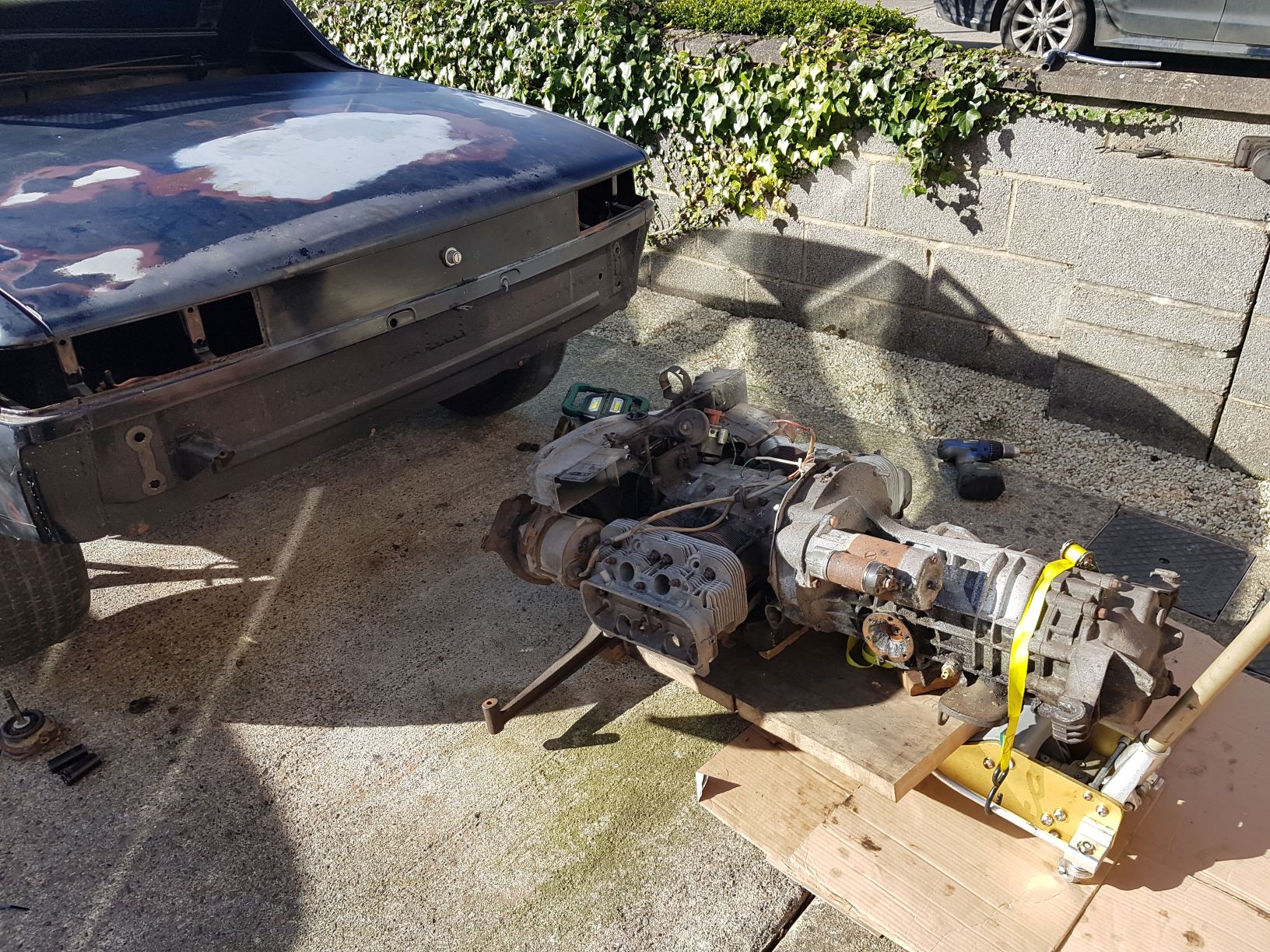

Had good weather here the last two days so got stuck in to the strip down.

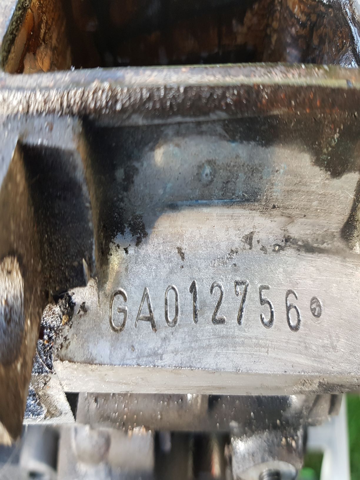

positives: the car is all very original, the engine number and stamp in the trunk all match, most of the rust I'm finding is mild to medium surface rust and the hell hole survived the jabbing screwdriver test top and bottom. i'm amazed there are so many places where there is no rust, like the rear panel which hold the lights and under the fuel tank, floors, firewall.

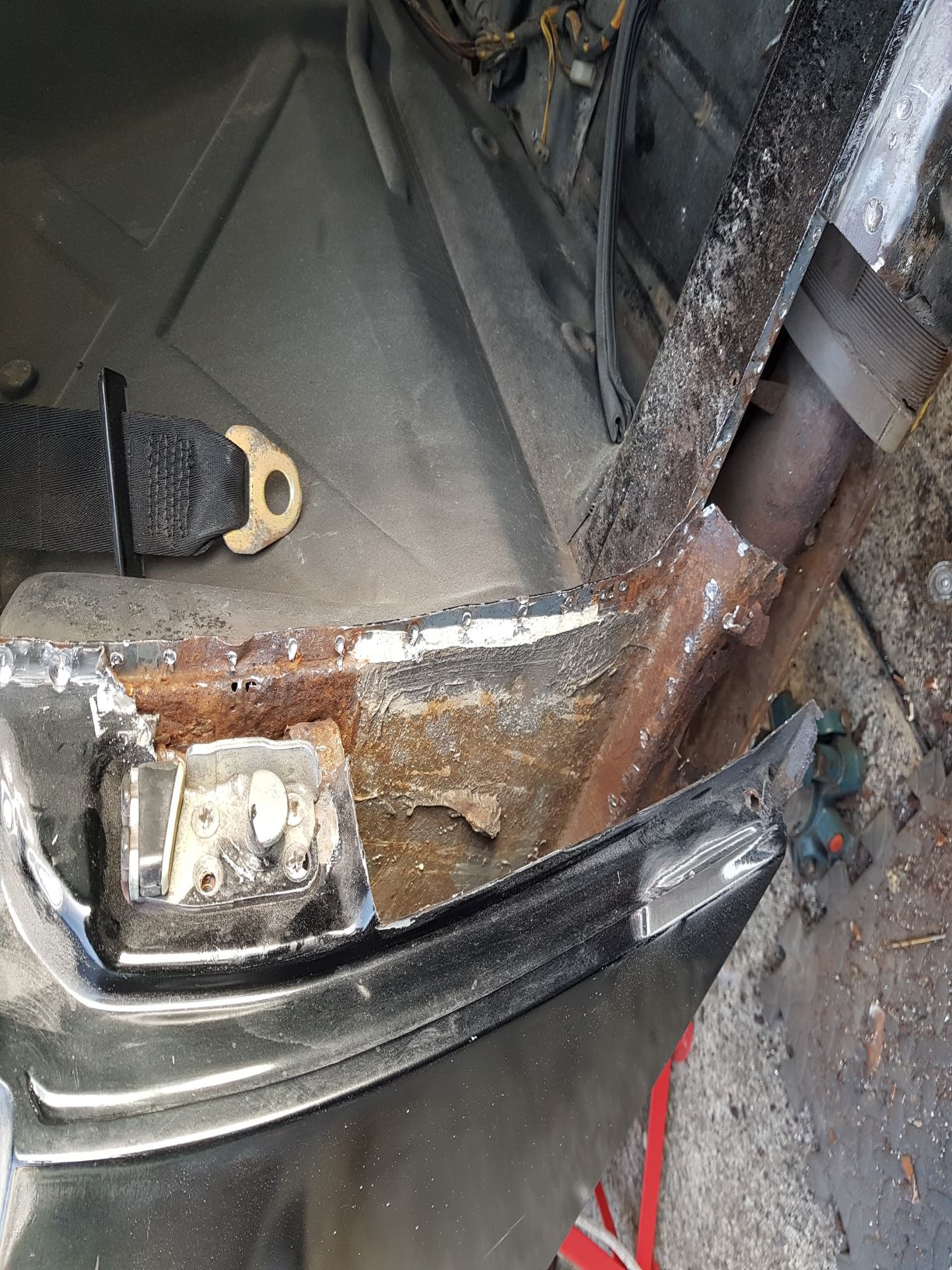

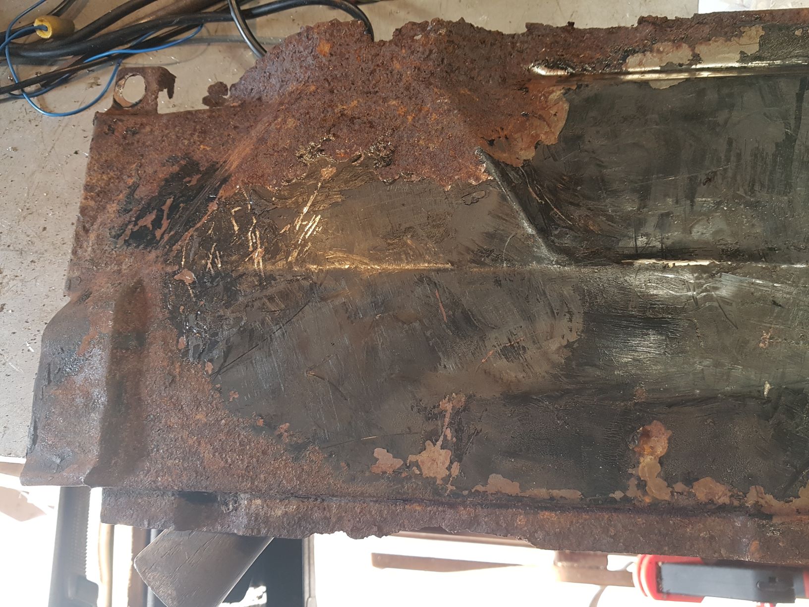

the challenges the rust around both rear jacking points is extensive, there is also one small pin hole middle of the rear trunk, right threshold and b pillar also have issues more than surface in places, need to investigate those more
the engine was partially disassembled, the heads hade been cleaned and had valve guides removed, the valve seats and sparkplug holes are perfect, but on one head an exhaust stud boss is damaged, and one intake valve guide boss. I cant tell the extent as some jb weld has be put in. i would prefer to have it repaired - welded, will have to see, any advice welcome. not sure how vital small bit of value guide boss is?Attached Image Attached ImageAttached ImageAttached Image

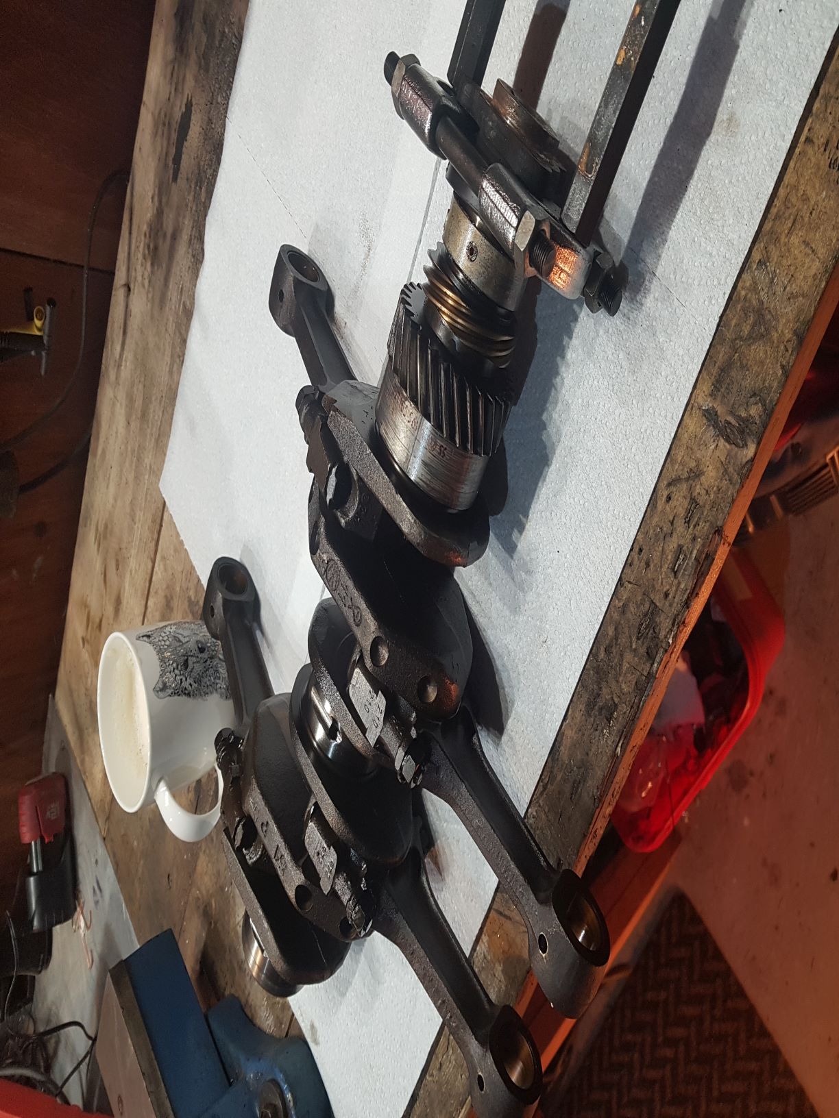

Short update, have been taking the do something every day approach, splitting between working on the body when the weather is ok, then in the shed when not.
Motor fully stripped now, it seems in good shape for 100k miles, only minor wear on all bearings, expect oil leaks and possibly valve guide wear got the PO part tear down started. Ordering parts now, going 2056 with stock FI and have sent the cam to Elgin cams for regrind (330-1), new injectors ordered as was missing one, new metal fuel lines in. MPS is buggered, have ordered the tangerine racing repair kit. Have decided to have the one damaged head repaired locally instead of going new, the chambers and valve seats are perfect still so feel its worth saving.

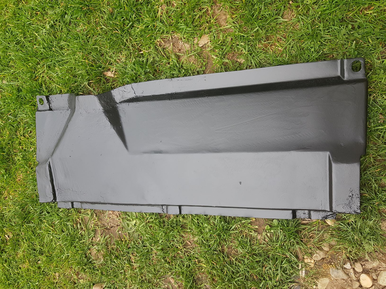

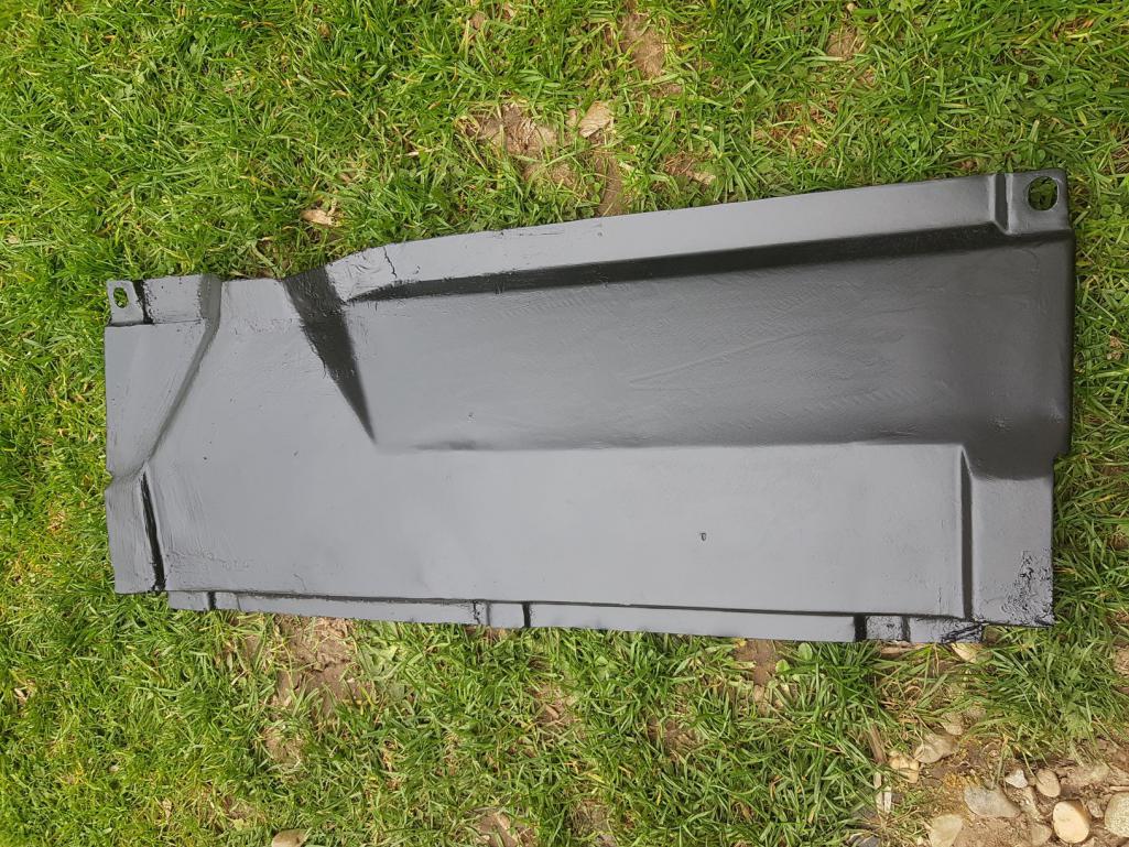

On the the body, thankfully the problem rust is confined to the area around and above the jack points on both sides, on the passenger side the door catch was only held in place by "the force" (have more than in the pic cut out now), new panels from RD have arrived so moving on to test fitting them with some self made patch panels before starting the welding

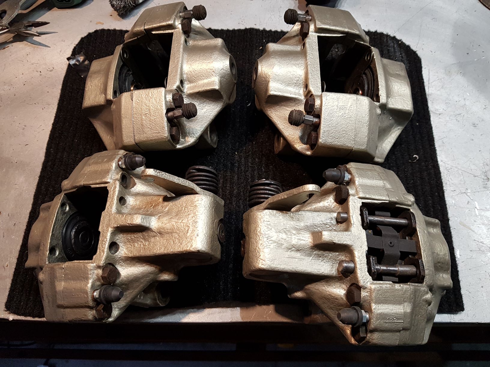

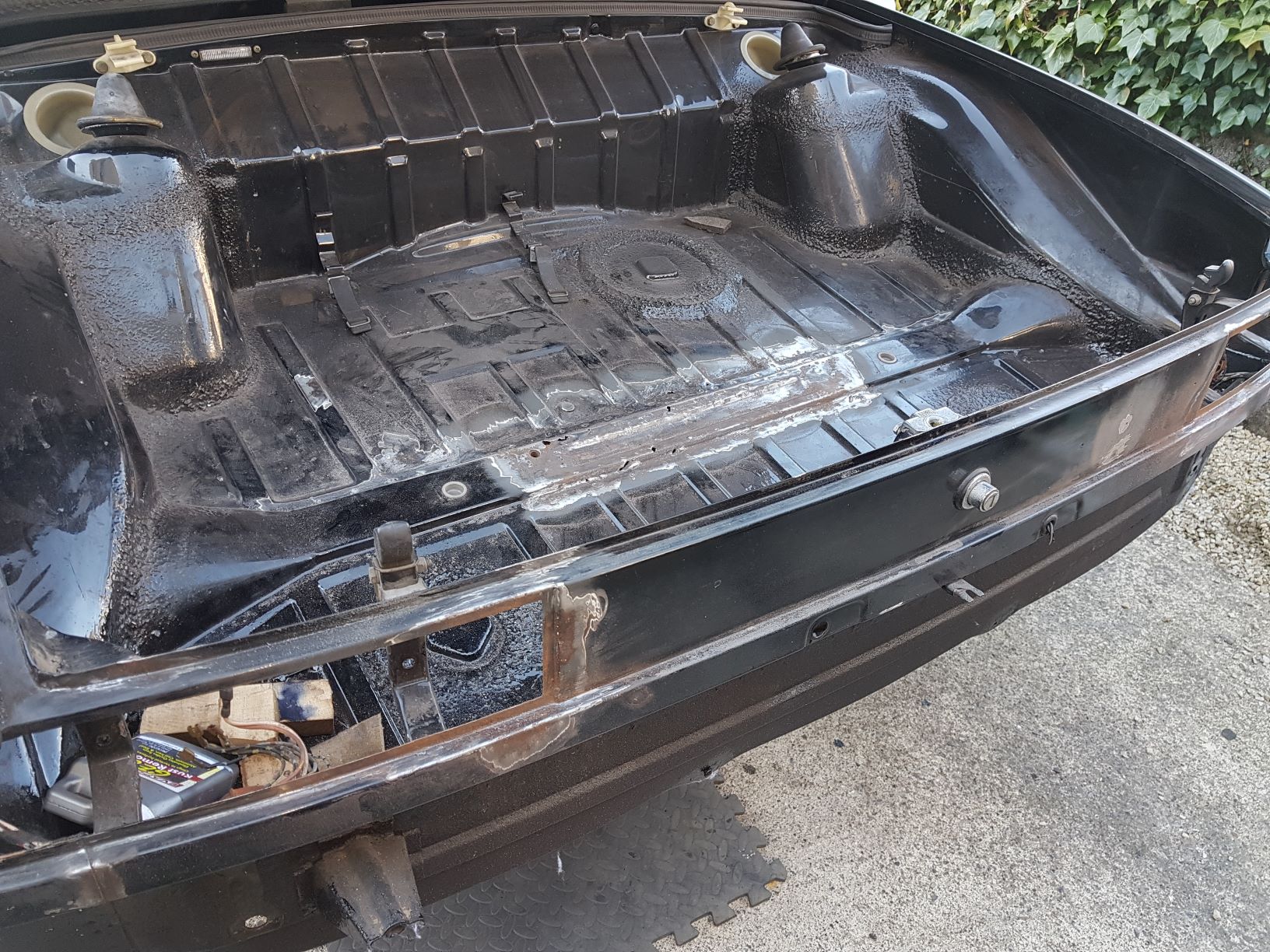

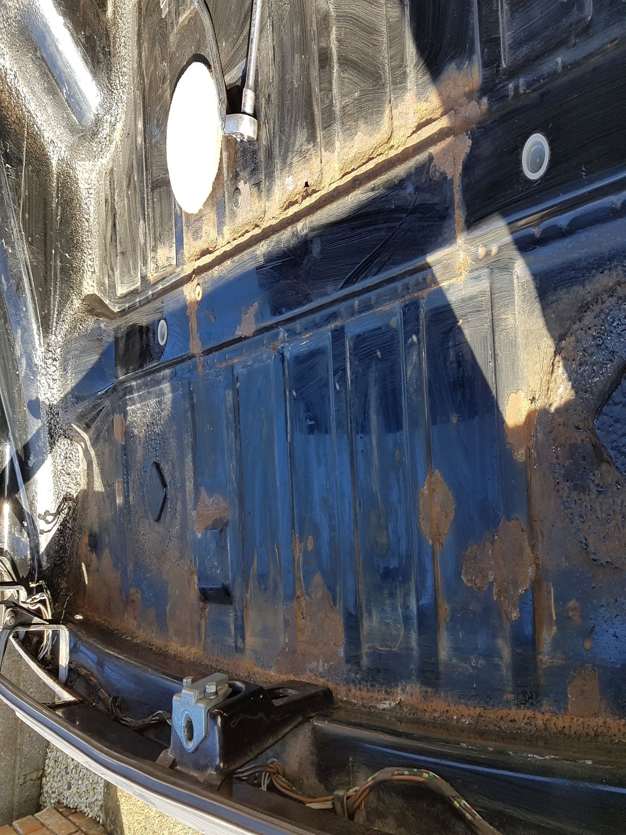

chipping away... pulled the front calipers for teardown, already have the rears apart and cleaned, getting some quotes to have them all zinc re-plated. Master cylinder out now as well, just getting new one. Best was finishing off the trunk surface rust cleaning up with por-15, just the need to weld the new reinforcement plate and a couple of pin holds just above it - i'm going to try to weld them up but it doesn't work i'll put some new sheet metal then prep for final paint. Getting all the other repair panels roughed up before i start the welding phase !Attached Image Attached Image

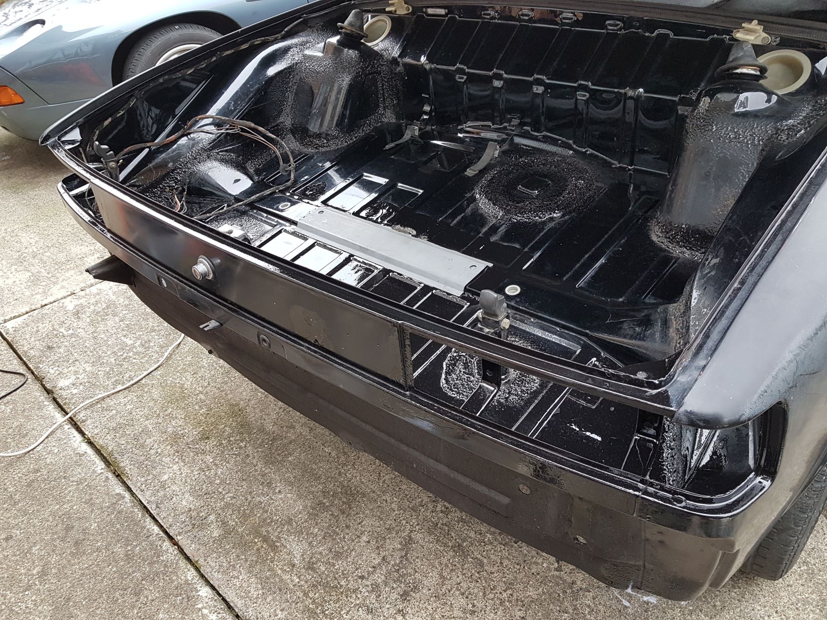

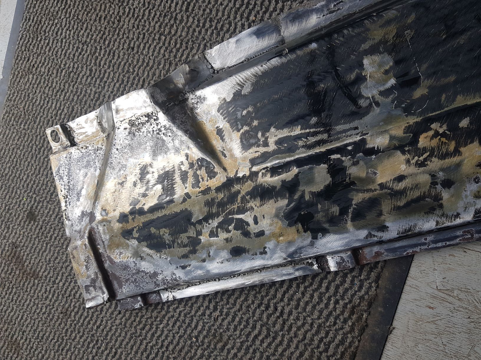

Weather has not been the best to progress the structural welding, plus I was out of practice so decided to see if I could save the front protection plate, it was very tricking to weld, so thin and even though cut and ground worst out i was blowing through all the time but got to a level could live with and then re finished. Also got to finish off the caliper rebuild, new brakes lines 50% in. realy hope to make headway on the structural welding in the next couple of weeks, really want to get it behind meAttached Image Attached ImageAttached ImageAttached Image
