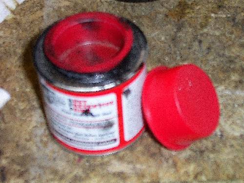

Okay, ya'll (Aarod) laughed when I brought this up last time, but to keep the 1/2 pints fresh for a looooong time, use a #18 cap-plug.......they seat down into the can, burp like tupperware, reducing the amount of air (moisture) in the can, and the POR won't stick to them, making them easy to remove and reuse.
"But Kev, where the "F" do I get a cap-plug?"
PM me your address, and I'll send you a couple.
