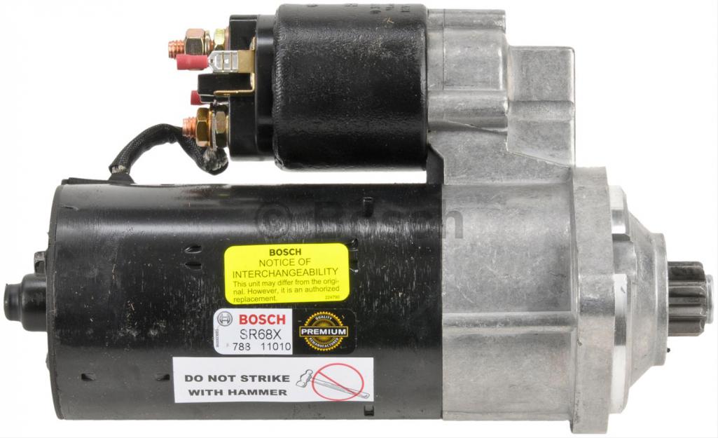

Bosch SR-68X is the NEW version of the 911 1.5 hp starter. It is high torque and smaller in size than the previous version. It is not cheap though, about $300 without core.

I like the 'Do not strike with hammer' warning. Back in the day it would have been targeted at Ford mechanics

QUOTE(914Sixer @ Mar 18 2021, 02:04 PM) *
Almost looks like a 996 starter (it's not the same number, I checked) I hope it's not the same motor as they suck. IMO they are under powered.

On the six, I run the Bosch SR-68X. It is the current Porsche recommended replacement. It turns over that 2.0 T motor with authority. But I am looking for an original early 911/914-6 starter to put on it.
