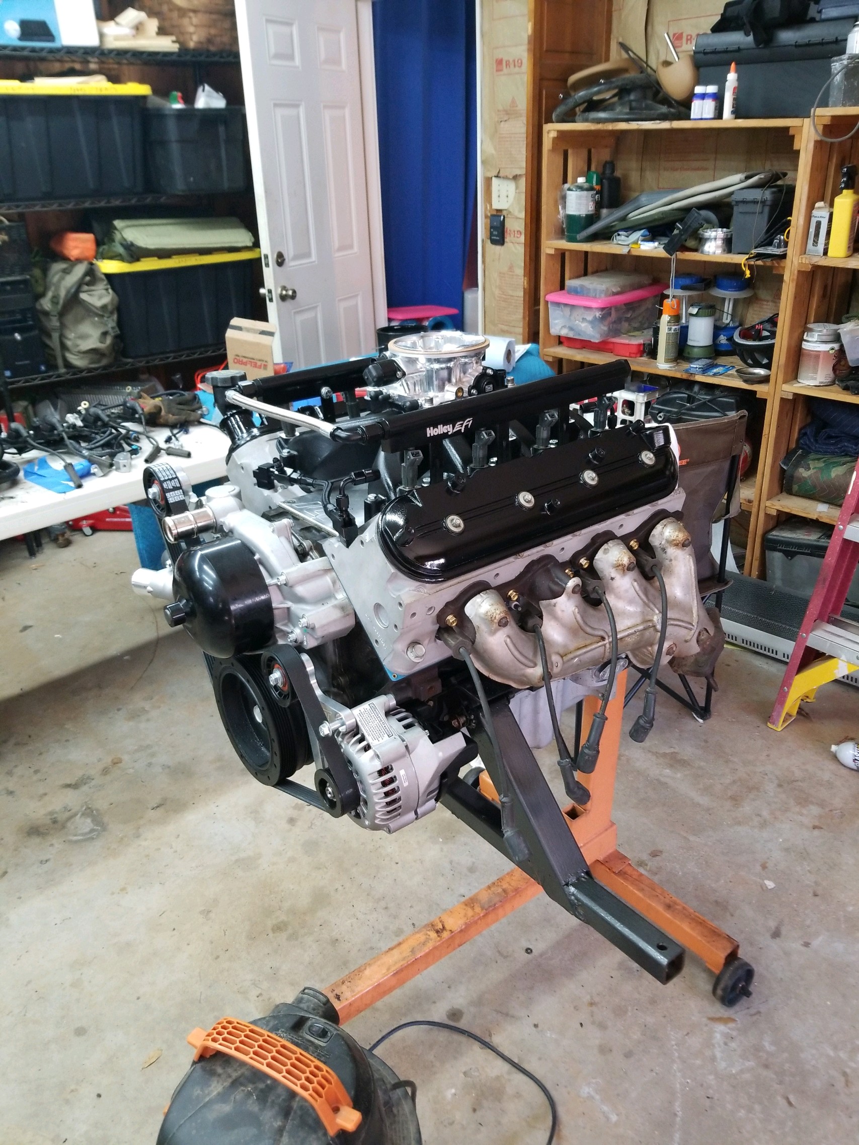

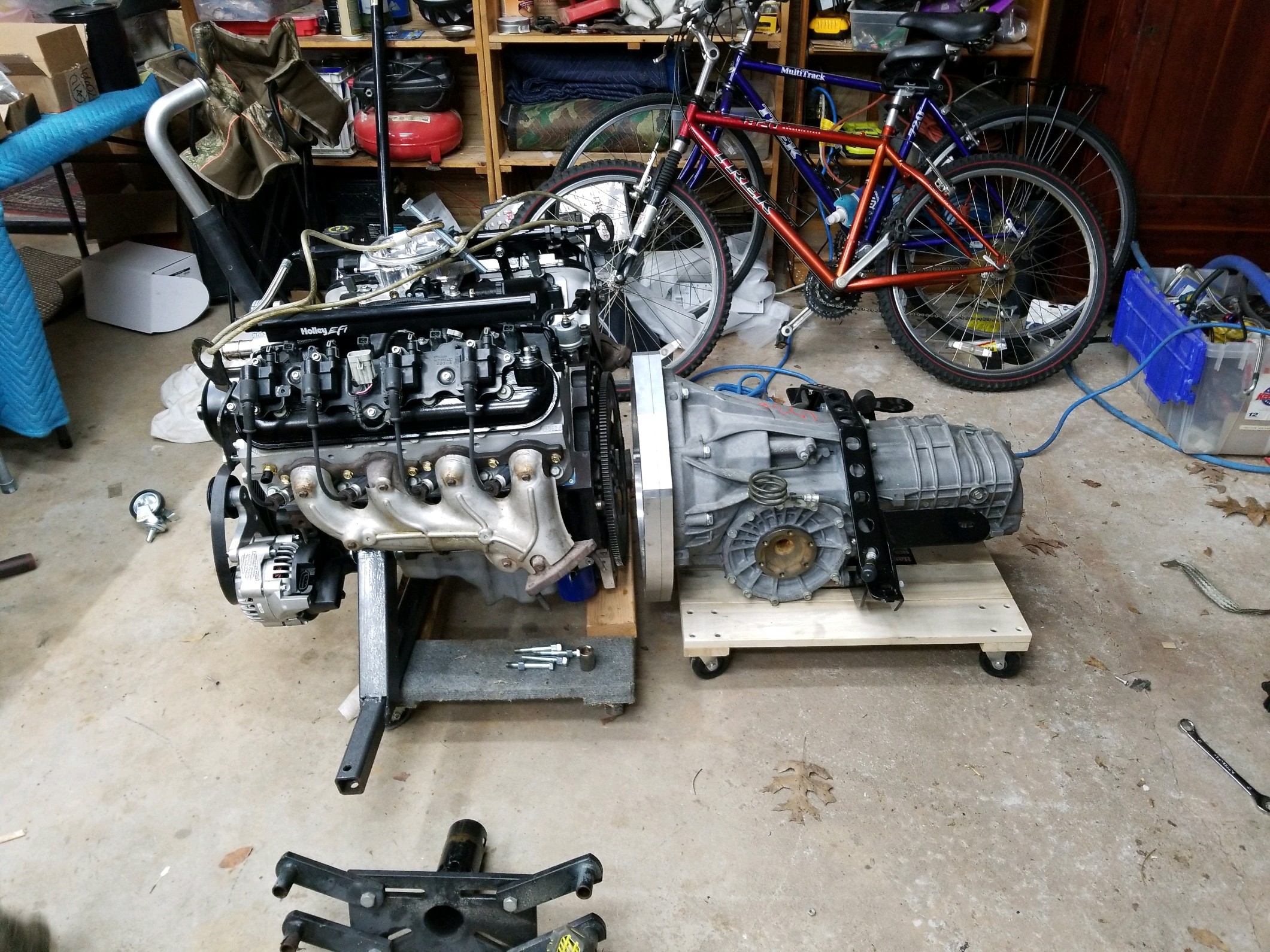

the engine and tranny.
4.8 l ls motor
holly intake, 4150 throttle body
swap oil pan
ict billet pulley sys for corvette
corvette water pump
renegade tranny mount

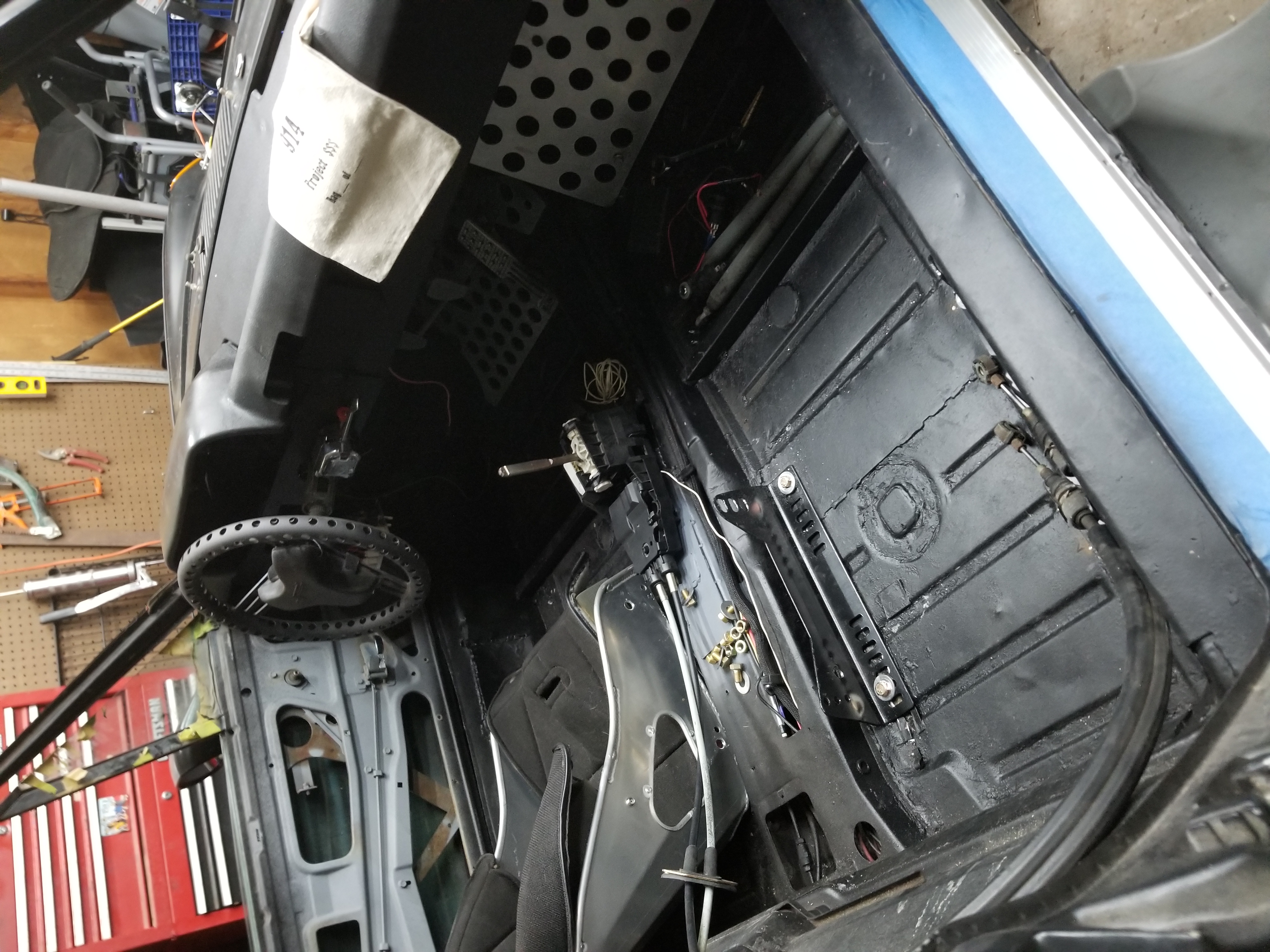

cleaned out 6 years of dirt and repainted
went back to full dash
boxster shifter future tense
cleaned up a lot of so so work that i did before.

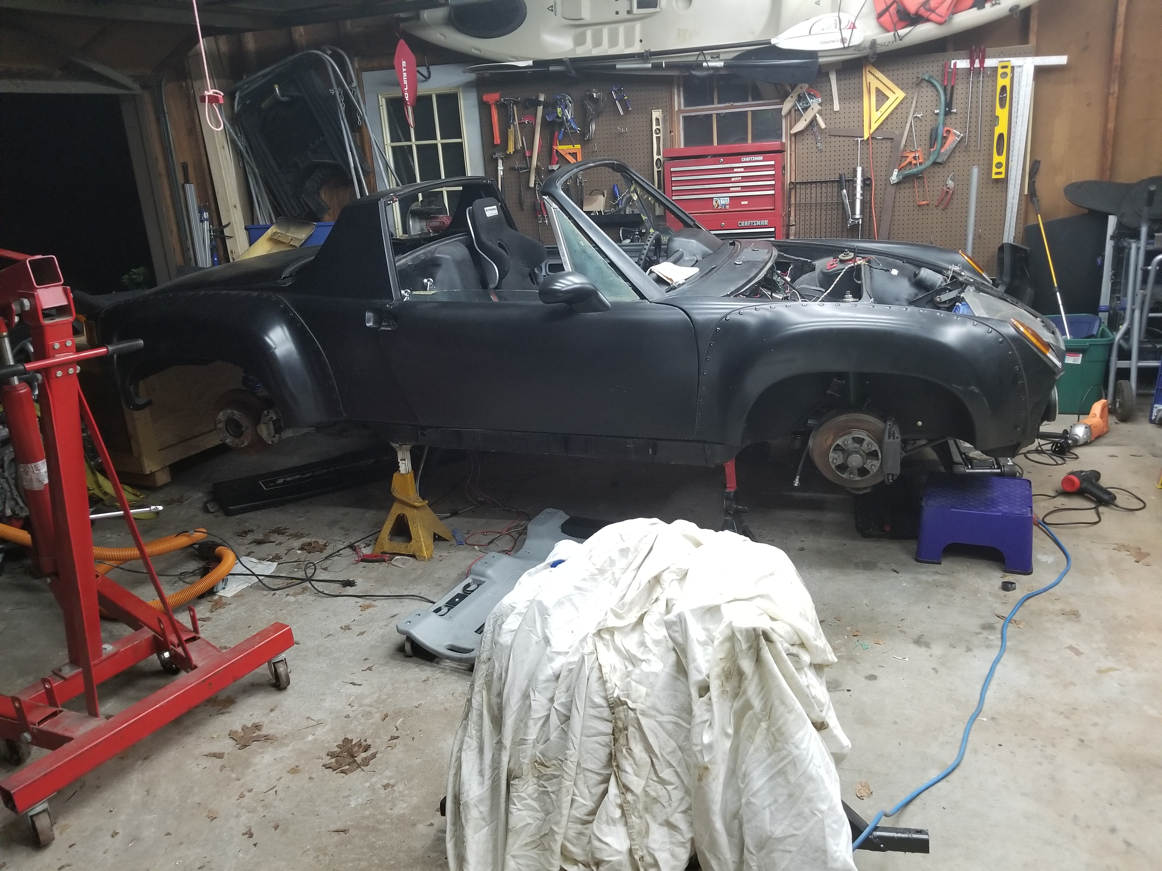

under construction
good to be back and playing again.. the car is close, i can work for hrs or just minutes.. feels good.

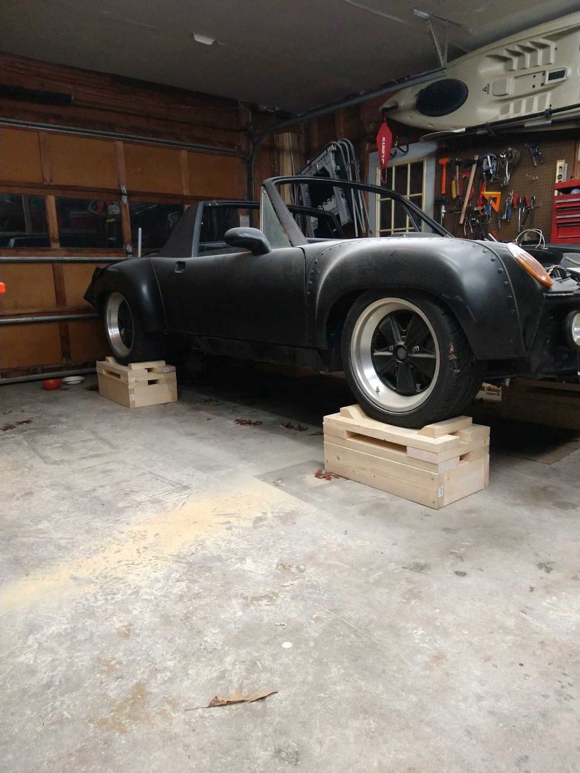

Killed off jack stands and built these
d914
post Feb 17 2022, 03:24 PM
Posts: 2,351
Joined: 12-July 03
From: Atlanta, ga
Member No.: 904
d914
post Feb 17 2022, 03:25 PM
Posts: 2,351
Joined: 12-July 03
From: Atlanta, ga
Member No.: 904
d914
post Feb 17 2022, 05:56 PM
Posts: 2,351
Joined: 12-July 03
From: Atlanta, ga
Member No.: 904
Killed off jack stands and built these. ( sorry for the dups... internet was going crazy and haven figured out how to delete.

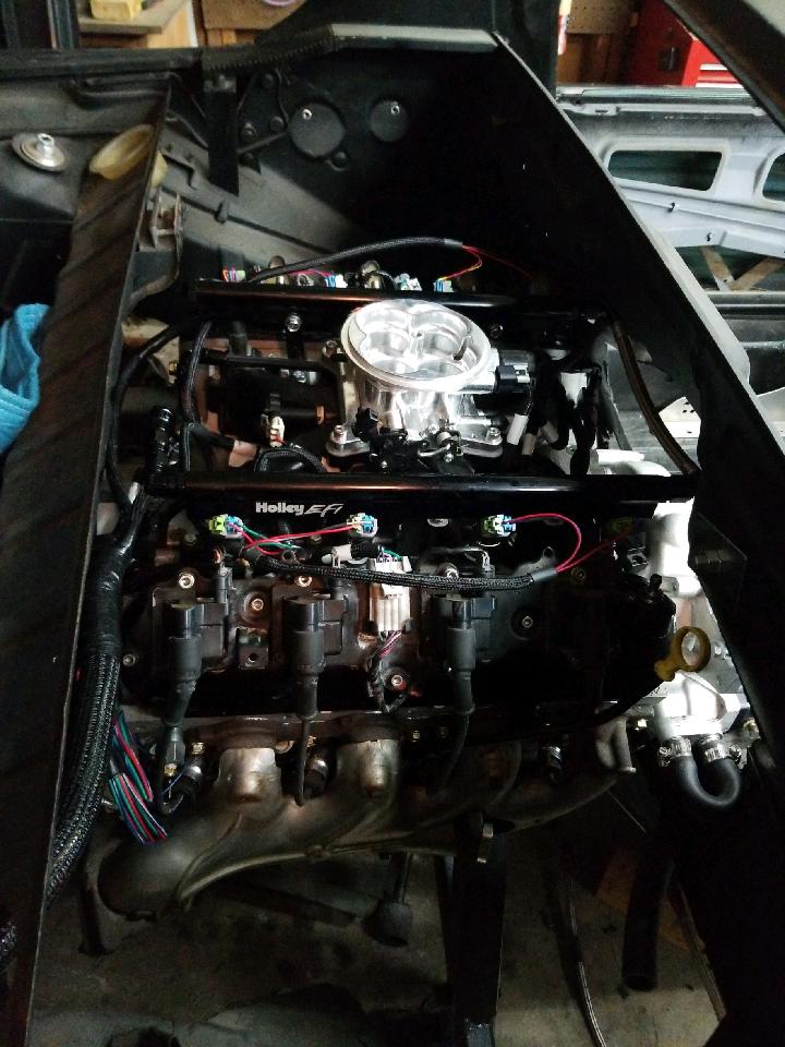

Engine in place
d914
post Feb 17 2022, 06:01 PM
Posts: 2,351
Joined: 12-July 03
From: Atlanta, ga
Member No.: 904
I'm now going through the wiring I had to cut and figure out what wasnt finished from 5yrs ago!!!
