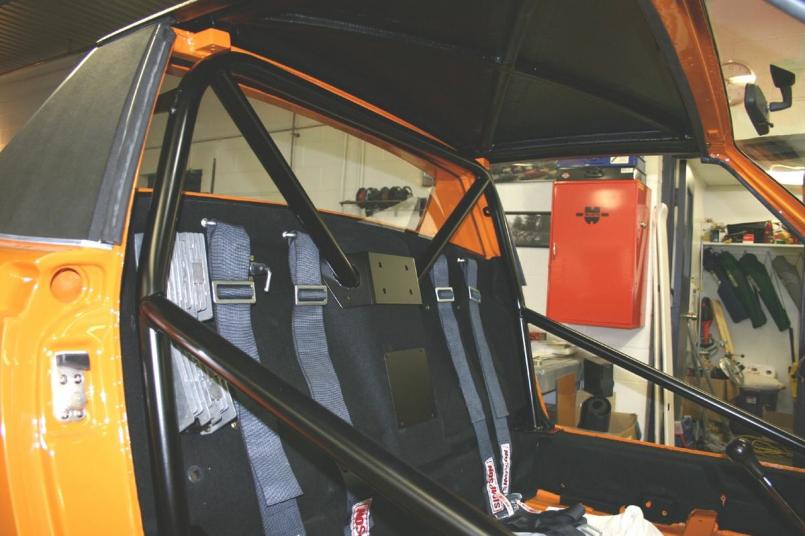

I went a bit non-traditional with my design as I didn't want a full main hoop and did things like relocating my seatbelt retractors so I'm not sure these pics help but maybe will give some ideas. I call it "the roadster cage".

Maybe these pictures will help. Photos are not my car. I have a full cage.

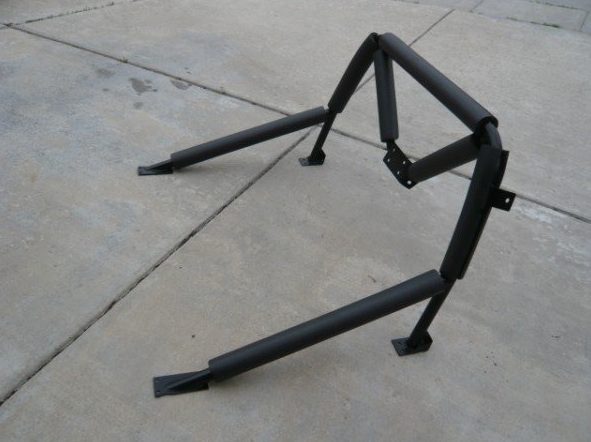

My Autopower roll bar.
http://www.914world.com/bbs2/index.php?aut...;showentry=1018

I think one of these half cages would be perfect. With the foam is it streetable? Or is it a headbanger

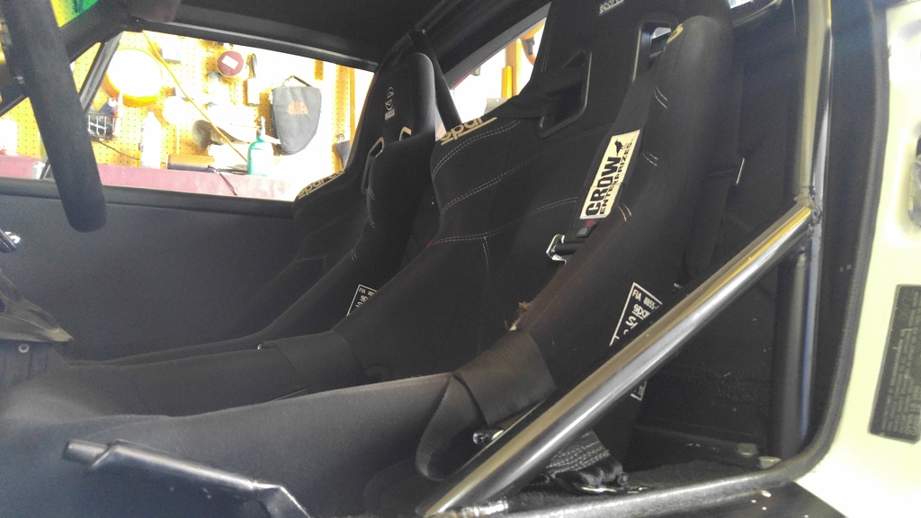

QUOTE(VegasRacer @ Apr 8 2021, 07:58 AM) *
Something like the last two pics. My brother is 6'01'' so he needs the leg room.

QUOTE(Shivers @ Apr 8 2021, 08:25 AM) *
Yes. it is streetable. Yes the foam really helps.
The only time I bang my head is when I am working on the car. Never during regular use.
QUOTE(Luke M @ Apr 8 2021, 08:42 AM) *
That car belongs to @1stworks

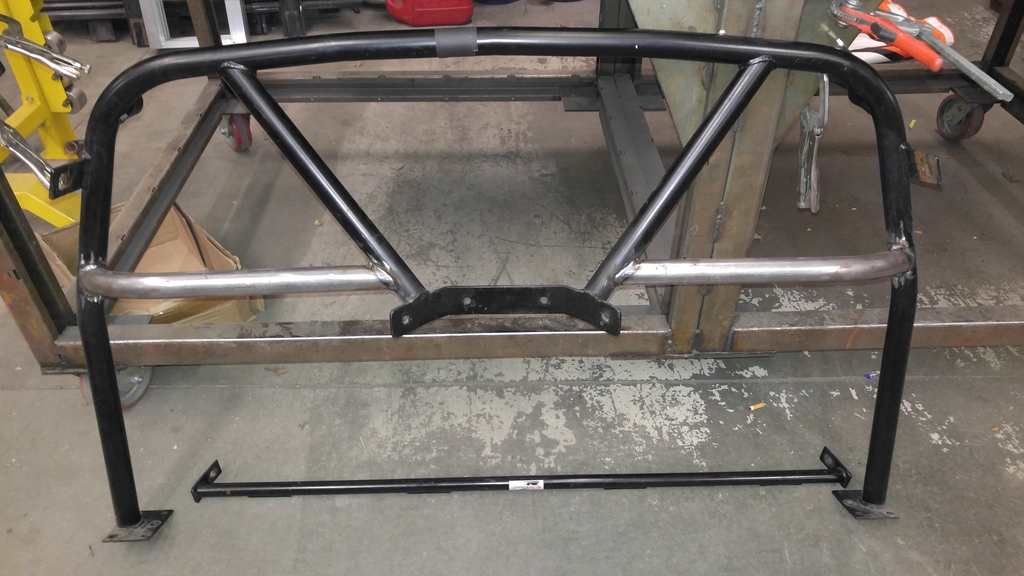

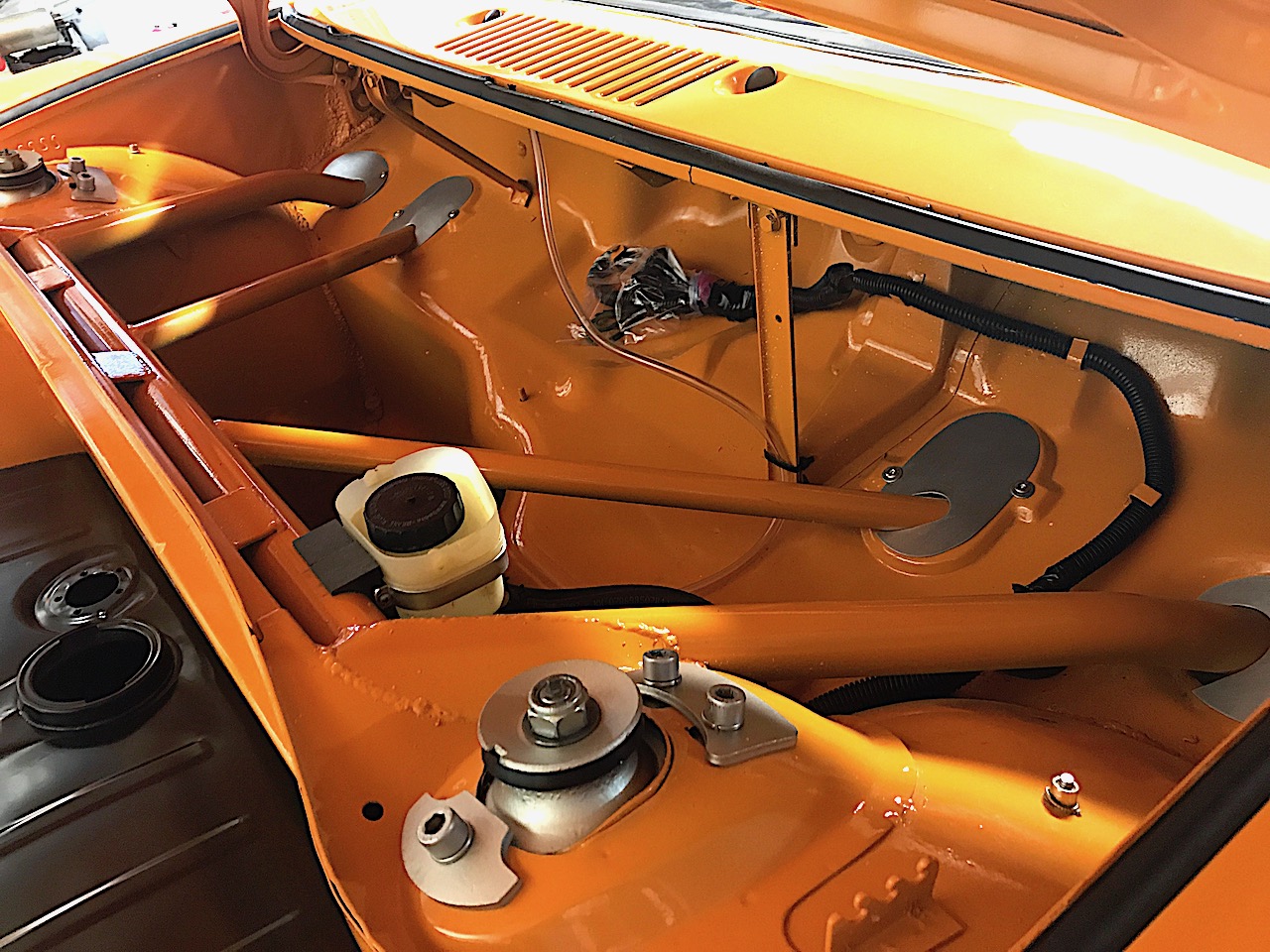

Mine is a user friendly cage extended to suspension points. MarkAttached Image Attached Image

A full cage is out at this point. Leaning towards Mark's cage with maybe a tweek or two to it. Like this one but with some bent side supports to make it easier to get in/out. Seams like the seat would be able to go back a little farther.

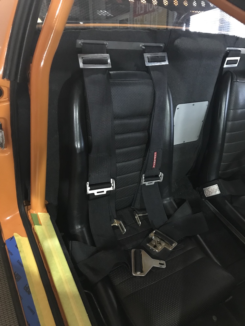

Plan your harness mounting along with putting in your half cage. Many times they tie together or may need to not interfere with each other. Might as well plan for racing seats too, they all need to work together.
The half rollbar I have allows the driver seat to go all the way back which is important for me at 6'0". I need to upgrade my padding to the harder SFI stuff. The half rollbar itself its probably not really needed, but makes be feel better incase of a roll at track events.

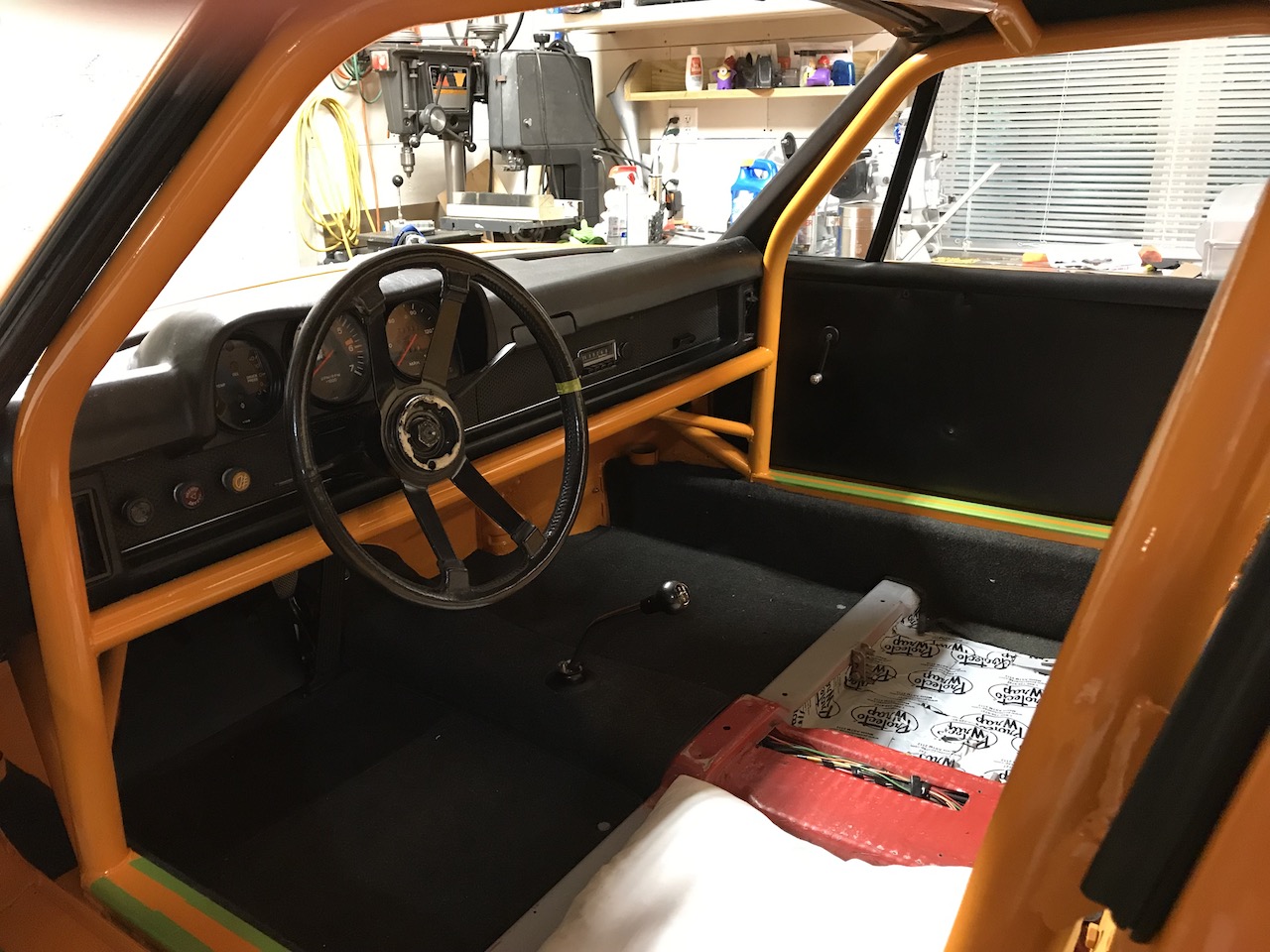

Also 6' and seat gos back all the way. I did just last winter moved the front bar six inch closer to the front wind shield. Best, Mark Attached Image
