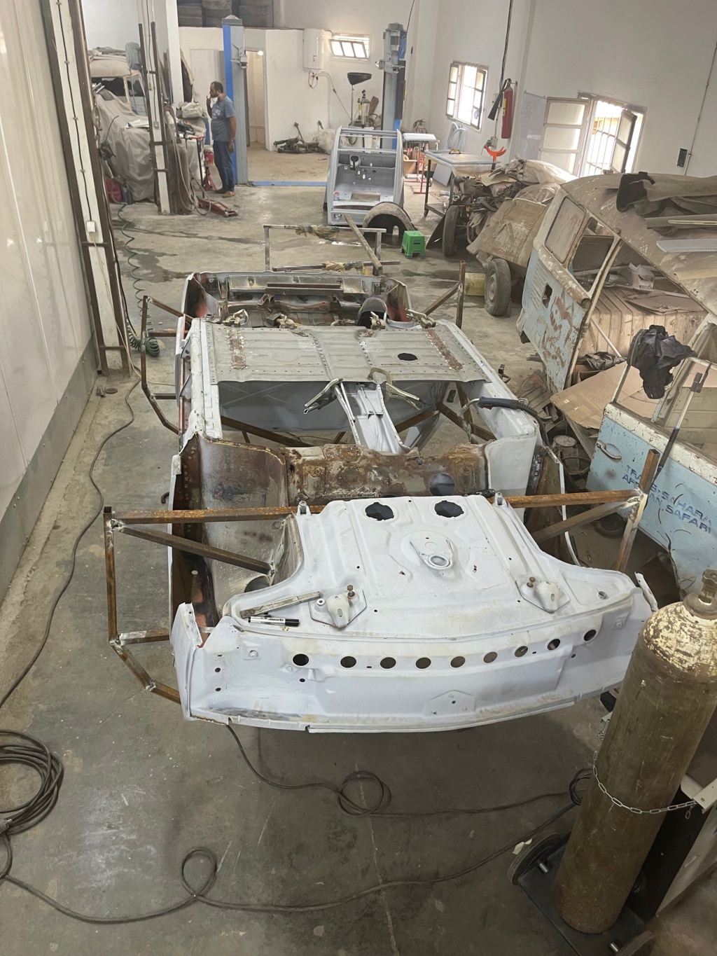

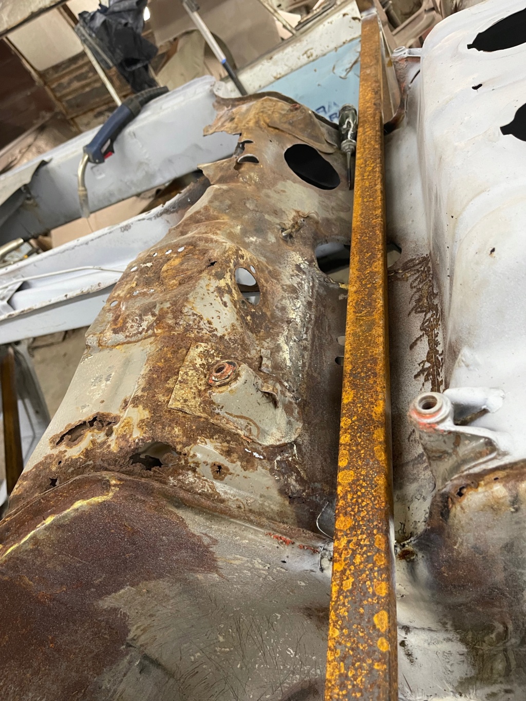

QUOTE(Root_Werks @ Jul 13 2021, 09:20 AM) *
This project is certainly a combination of small patches and full panels.
Can't wait to see how you put the new floors in.

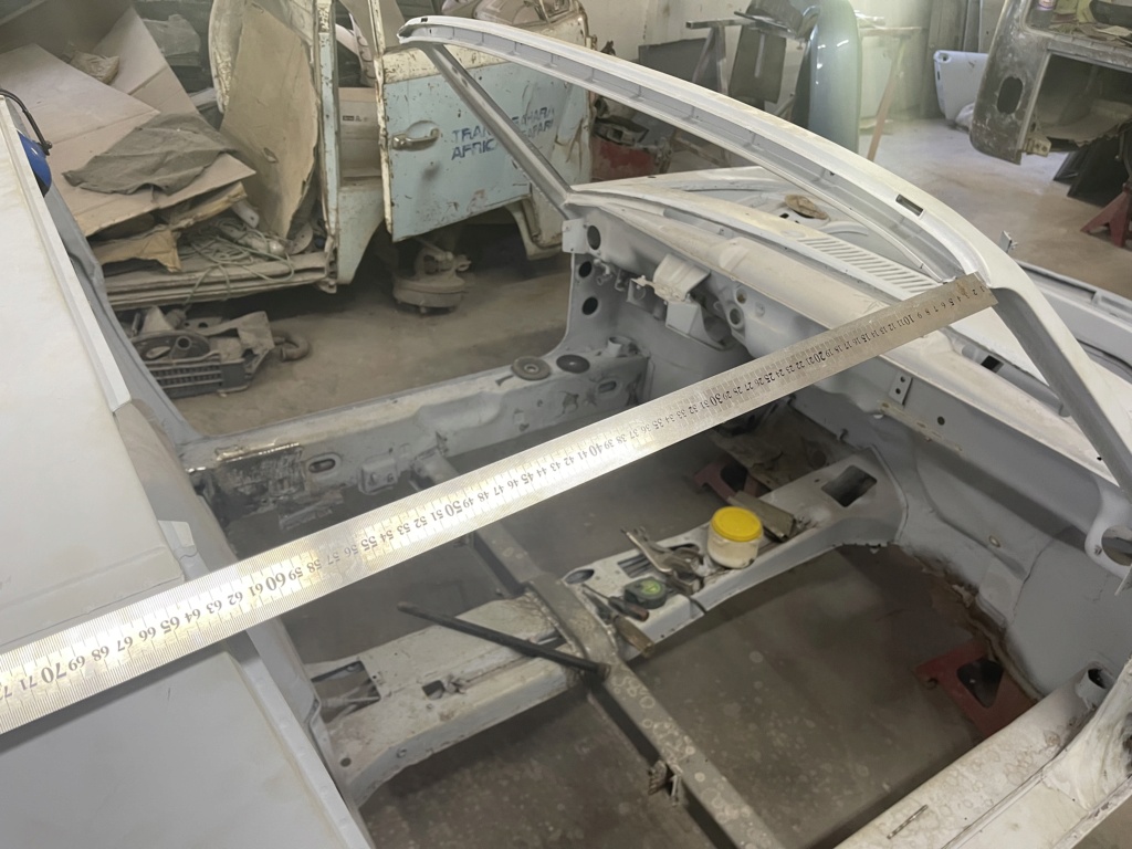

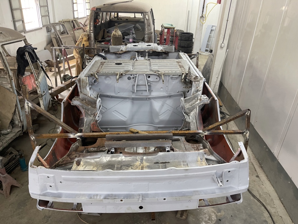

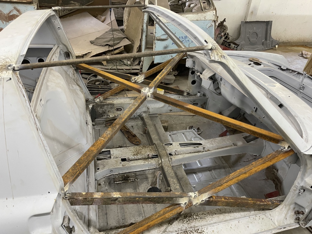

I will certainly do it the next week.
I will stabilize the door openings using roll bar between hinge and door lock pillars.
as usual I will share some pictures before welding.

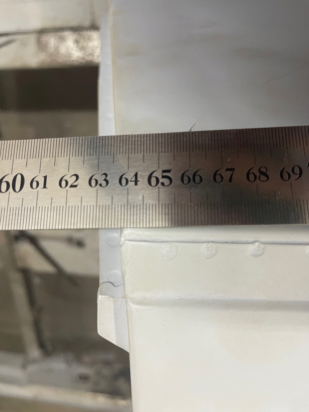

i measure 637mm on my car for same dimension. thats with vinyl coating.
looks like you get 638mm for same without vinyl.
pretty right i guess.

QUOTE(SirAndy @ May 20 2021, 02:22 PM) *
QUOTE(jcambo7 @ May 20 2021, 01:13 PM) *
With no door bracing from what I can see, what are you doing to prevent twisting while welding?
(IMG:http://www.914world.com/bbs2/uploads_offsite/i.servimg.com-25113-1626641012.1.jpg)
