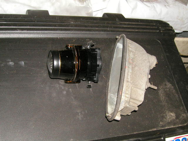

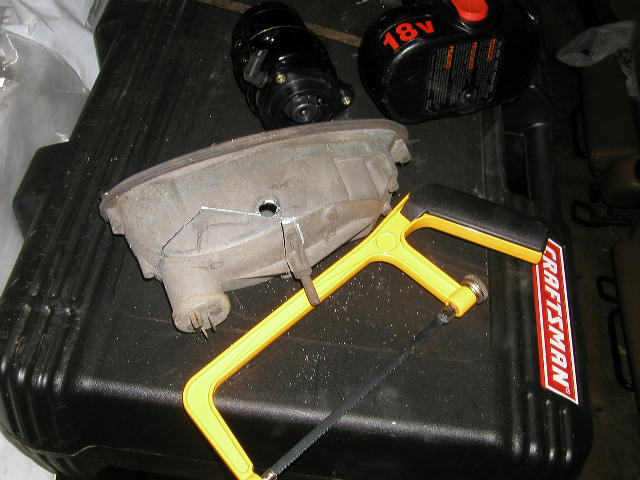

As I have said before, the "signal" light pods are a unique characteristic of the 914 design. Making them house headlights will give them a higher purpose than signaling and join the modern "smaller" lighting trend. This and using the existing headlight space where the radiators will mount are why I chose this location. Legal? We'll see if they figure it out... <!-- emo&:lol: -->(IMG:http://www.914world.com/bbs2/html/emoticons/laugh.gif)<!-- endemo -->

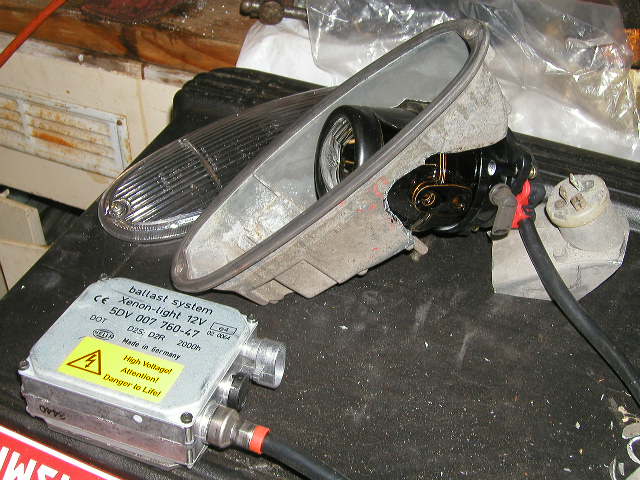

Voila! Don't worry, they are weather sealed and the fender will be wider, thanks Andrew so they will fit. Just need those clear lenses, Bruce?

I was thinking of doing this... I had an idea to spray the inside of the pod assy black, and just put a sheet of plexiglas over the front. How are you planning to protect the back of the assembly from road grime? Plexi would not be a lens so it shouldn't be a problem right? It also wouldn't ruin the projection pattern of the HID.

I know a guy locally with a plastic vaccuum mold. We could smooth out the lense and use it as a mold so you'd have all the right contour but no distortion.

That sounds great, I considered forming new lenses. My plan is to have the original lenses modified so I can keep the original shape and seal. A fellow member is experimenting with filling in the "flutes" and maybe mold crystal clear lenses. I was going to dremel the features but that takes some skill and a good eye. I've seen how "craftsman" fix distored jet plane canopies under an optical grid. "Clear enough" is good for this application.
Y'all might want to try PIAA x1100's, the bodies might be smaller. I was going to use them but want to stick with as much German or OEM parts as I can. The Hellas DE Xenon are aftermarket, fully sealed ,and designed for "new" applications. Not cheap but I'll bet you can find similar parts in several German sedans. A production version or kit is always possible, just not in the schedule yet.

I was thinking saw off the seal and use the new vac molded piece over it.

I hate to be a wet blanket.. but how are you going to keep the factory 914 clear lenses from melting?????
