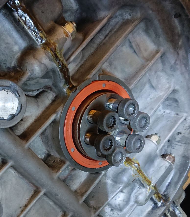

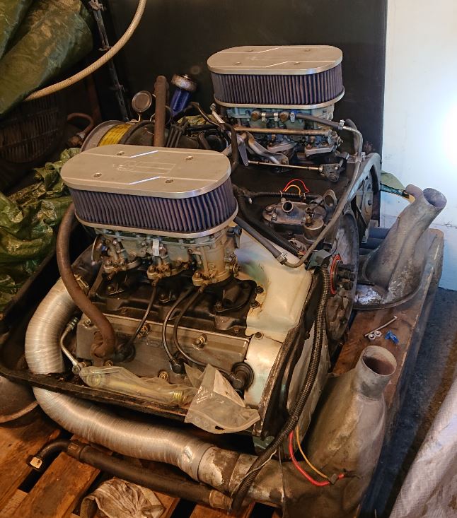

I had a dream to install a 6, that was a few years back and I even got a 2,2T motor but the project didn't get off the ground, anyway as I have run out of things to do I thought I might resurrect the idea.
According to the PO the motor came out of a running car and I want to make sure that it runs before I commit to installing it. What do I need to do to get it running? I do not have a spare gearbox for the starter or an oil tank is there an easy way to fire it up without (or using substitutes for) these parts and what about the electrics, there is a coil but I think I need more than that? Any help much appreciated as I know nothing about these engines. PS: It looks like the motor has been opened up at some time there is a lot of sealer on the case seam behind the flywheel, do you think its been opened? ![]() |
DavidSweden I had a dream May 8 2021, 10:37 AM
roblav1 Definitely been opened. Looks like wrong sealant. May 8 2021, 03:46 PM

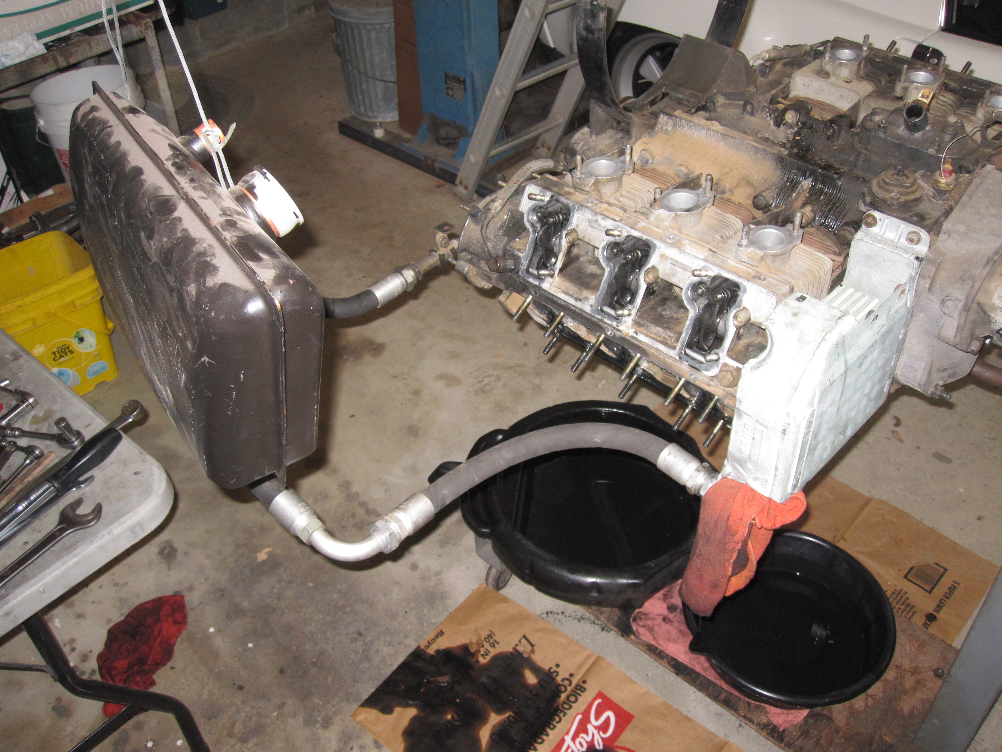

ClayPerrine To run the motor out of a car you will need:
1. O... May 8 2021, 04:13 PM
infraredcalvin Set valves
Perform a leak down
Rebuild carbs
If al... May 9 2021, 01:15 AM
Mark Henry The case half sealant looks like permatex aviation... May 9 2021, 04:47 AM
Retroracer Agree with Mark Henrys guidance and Clays list. D... May 9 2021, 10:38 AM

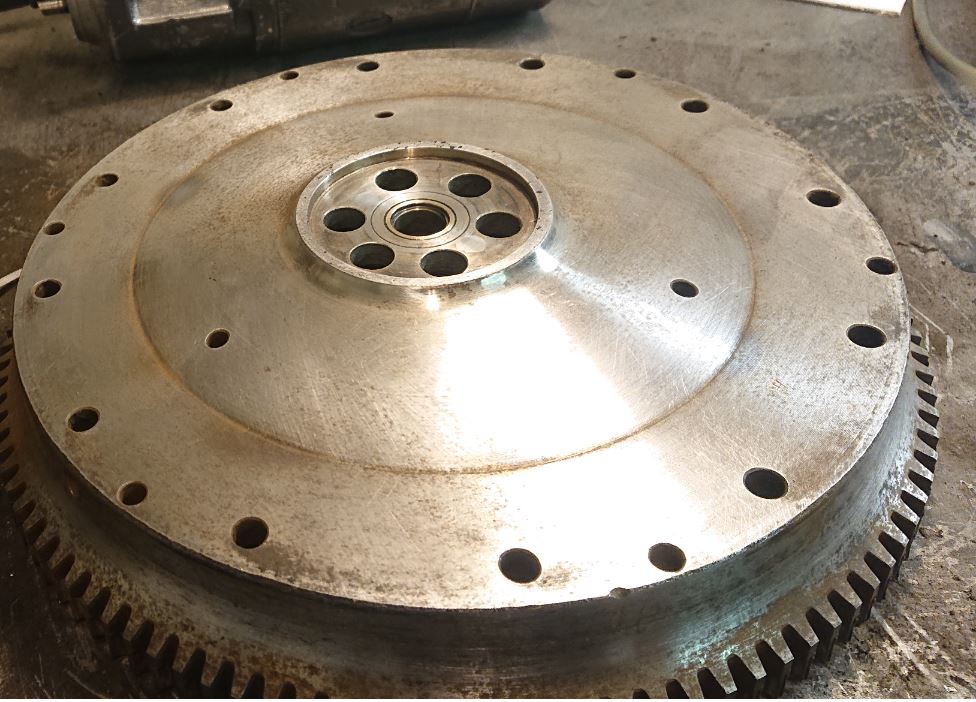

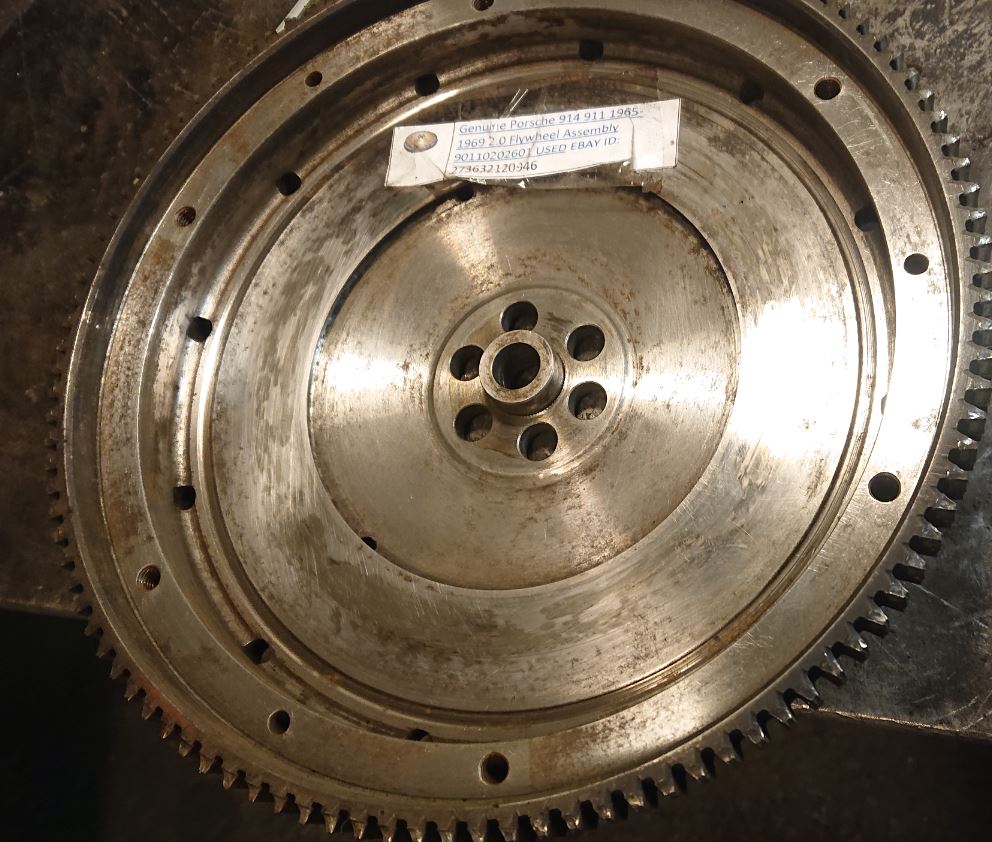

infraredcalvin I have a somewhat dumb but relevant question....
... May 9 2021, 10:54 AM
Mark Henry Numbers are useless at this point, all I'd be ... May 9 2021, 11:47 AM
DavidSweden Many thanks to all members for the good advice, it... May 9 2021, 11:47 AM
Mark Henry Yes that works, bolt it up.
IIRC the 914 ones wer... May 9 2021, 11:59 AM
Retroracer RE: Flywheel - the asymmetric bolt pattern means i... May 9 2021, 12:50 PM
infraredcalvin Thanks for the responses, I was just in a similar ... May 9 2021, 01:43 PM

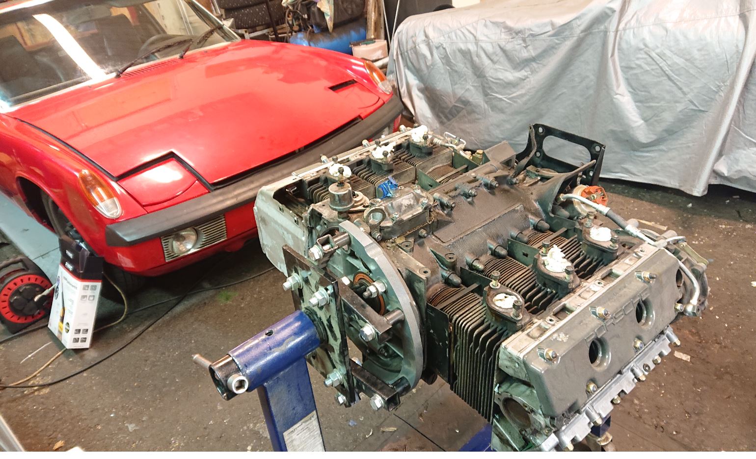

DavidSweden I have started to check over the 911T engine befor... May 16 2021, 10:52 AM
horizontally-opposed
Unfortunately the results were worse than terrib... May 16 2021, 11:09 AM
mepstein Do a top end on the engine. Not crazy expensive an... May 16 2021, 11:57 AM
flyer86d I agree with Pete and Mark. Get the heads done, ge... May 16 2021, 03:01 PM
rgalla9146 The engine pictured went from
1. 137 ... May 16 2021, 03:15 PM
mepstein Listen to Rory. Doesn’t hurt to try. May 16 2021, 03:39 PM
:agree: May 16 2021, 06:11 PM
porschetub My 2.2t engine started like that after sitting 18y... May 16 2021, 09:35 PM
Optimusglen There are some 2.2T heads in the classifieds right... May 17 2021, 05:53 AM
