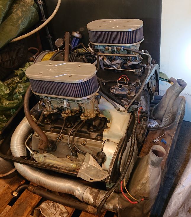

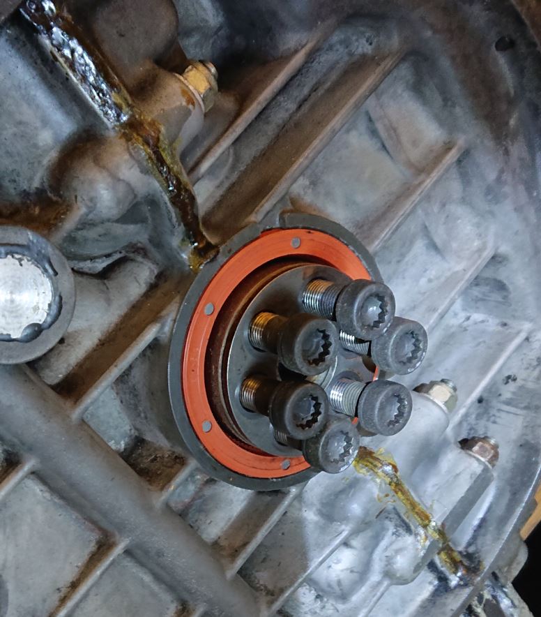

I had a dream to install a 6, that was a few years back and I even got a 2,2T motor but the project didn't get off the ground, anyway as I have run out of things to do I thought I might resurrect the idea.
According to the PO the motor came out of a running car and I want to make sure that it runs before I commit to installing it.
What do I need to do to get it running?
I do not have a spare gearbox for the starter or an oil tank is there an easy way to fire it up without (or using substitutes for) these parts and what about the electrics, there is a coil but I think I need more than that?
Any help much appreciated as I know nothing about these engines.
PS:
It looks like the motor has been opened up at some time there is a lot of sealer on the case seam behind the flywheel, do you think its been opened?
Click to view attachment Click to view attachment
roblav1
May 8 2021, 03:46 PM
Definitely been opened. Looks like wrong sealant.

The case half sealant looks like permatex aviation sealant, I stopped using it mid-90's, so the rebuild is likely 25+ years old.

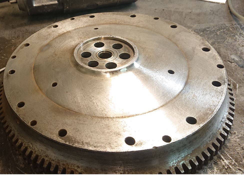

DavidSweden
May 9 2021, 11:47 AM
Many thanks to all members for the good advice, it is very much appreciated.

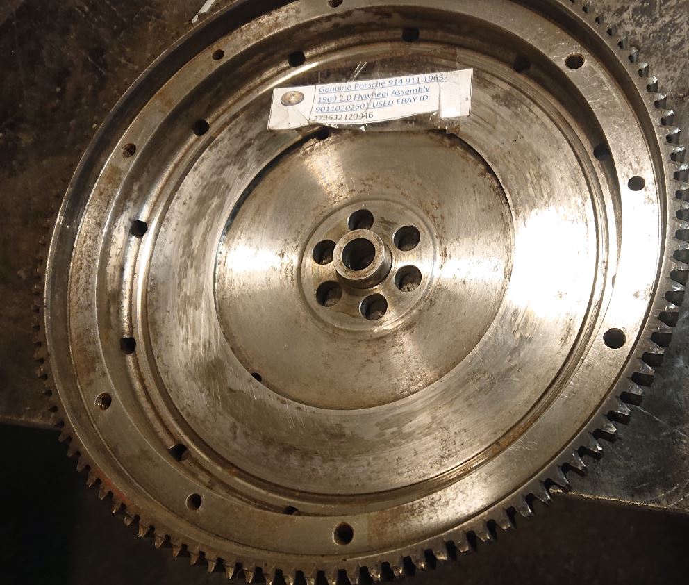

I bought an early flywheel a few years ago, It was advertised as a 65-69, however I cannot see any TDC marks, I thought that all the early flywheels had a TDC mark? There is also no part number stamp.
As I know near to nothing I am hoping that a member will be able to see if this is indeed an early flywheel and suitable for use with the 914 gearbox.
Mark Henry
May 9 2021, 11:59 AM
Yes that works, bolt it up.
IIRC the 914 ones were marked but not 911, they are the same.
Retroracer
May 9 2021, 12:50 PM
RE: Flywheel - the asymmetric bolt pattern means it will only match all holes in one position - then you can get TDC from the front crank pulley. I bought an aftermarket flywheel with no markings, but duplicated the crank pulley marks (in color!) such that they are visible when mated to the 901 transmission. Oh, and don't tighten the flywheel bolts fully until final assembly - as they're only supposed to be single use...

that flywheel isn't great and will need a full resurface to spec,the starter ring gear is very worn also,may be cheaper to find a better one ?,replacement ring gears are expensive after all.

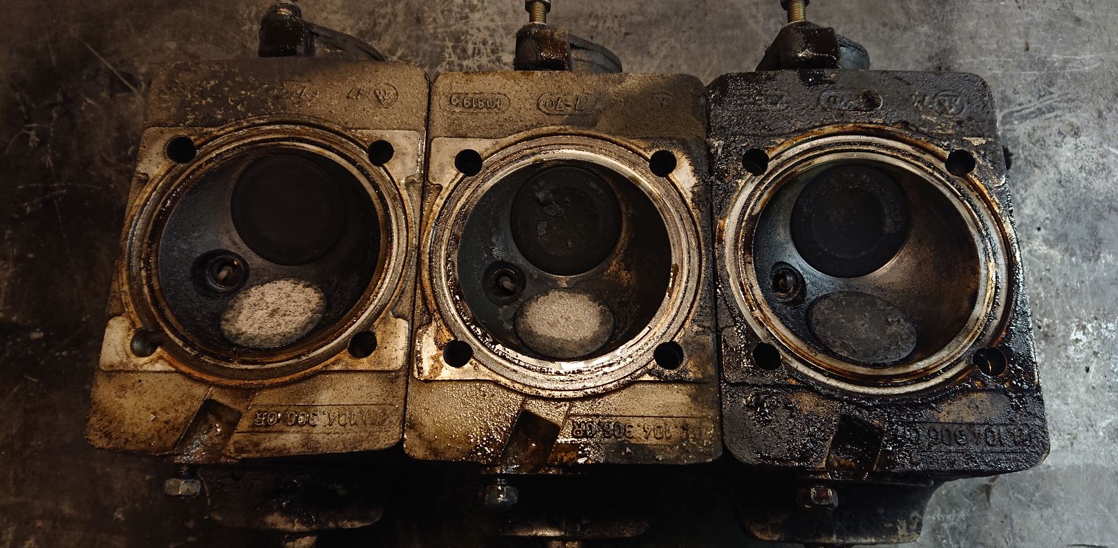

DavidSweden
May 23 2021, 02:05 PM
Thanks for sharing all the good advice/knowledge

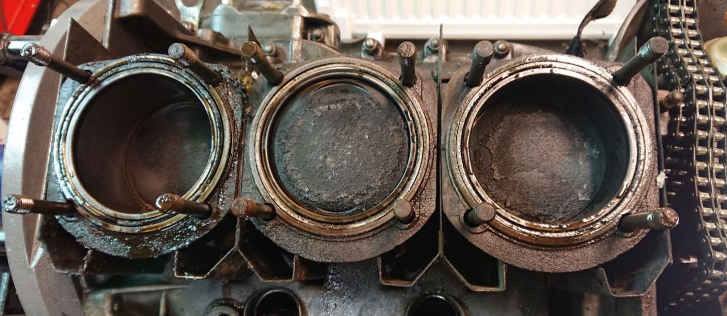

I did not want to put the engine in the car and end up with a major problem and as I enjoy taking things apart....... did I make the right decision and what do these picture tell the initiated?
Heads 1 to 3 from left to right
Click to view attachmentClick to view attachment
mb911
May 24 2021, 06:34 AM
Looks like it needed some new seals anyway
Retroracer
May 24 2021, 01:05 PM
I think you did the right thing FWIW. Lots of carbon and unknown valve seat condition...
I agree with
@mepstein - your lowest cost / best value alternative is a top end overhaul, clean & inspect cylinders and pistons, new rings; and, don't split the crankcase. If you do, dollar bills get sucked in....
- Tony

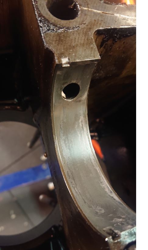

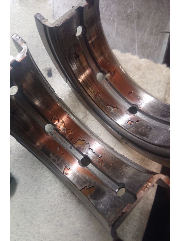

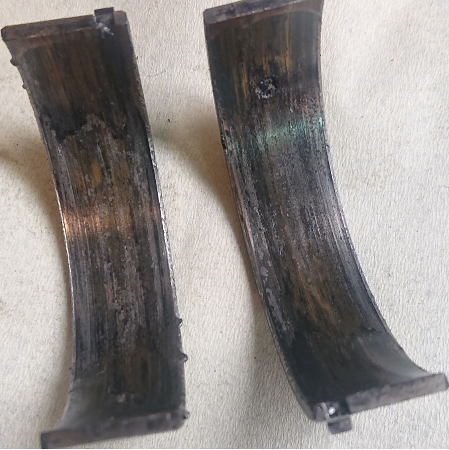

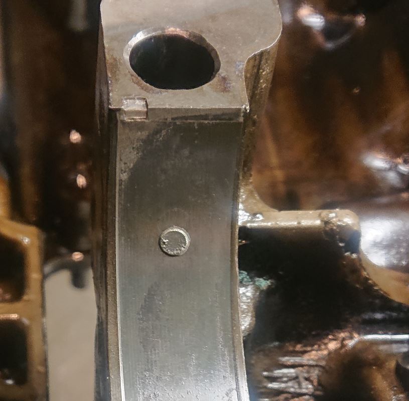

After the problems I discovered with the heads, I could not stop myself splitting the case and I found more problems.
The thrust bearing at the flywheel end was toast, big pieces missing, on the positive side there does not appear to be any damage to the case or crank. What would cause this type of bearing failure?
What was a bit worse was one that the number 6 bearing had rotated in the case, the oil hole in the bearing shell was full with what looked like metal (molten from the bearing?) and both bearing tags have cut into the case, there is also a round metal deposit on the bearing seat in the case (deposited through the oil hole in the bearing shell) this is probably more molten bearing metal?
Can anyone tell me how serious this damage is?
Thanks in advance.

porschetub
Jun 20 2021, 02:55 PM
QUOTE(DavidSweden @ Jun 21 2021, 06:22 AM)
Thanks in advance.
Click to view attachment Click to view attachmentClick to view attachmentClick to view attachmentOh dear not what you were expecting
,there was talk on Pelican a while back about a bad batch of Glyco bearing which were delaminating the white metal as per your issue,it was said that the top engine builders in the US stopped using them and went Federal Mogal brand if memory serves me.
This issue was occurring in a rather sort period of time ,to me it looks like white metal has migrated to the bearing that has spun,biggest problem here is all that crap has gone thru the engine ,I would expect the oil pump with be damaged and the oil cooler will full of it not to mention other area's of concern.
Personally I would look for another shortblock as the cost to remedy that case could end up to be very expensive,most likely better not to go there as a replacement may only require a line bore and oversize bearings.

Jun 20 2021, 03:34 PM
Get a quote from your machine shop and go from there. When you buy any core engines be, it’s impossible to tell what you have until you open it up.

Rod Bearings have to be worse...

ClayPerrine
Jun 20 2021, 06:59 PM
The 2.2T is a mag case, so I would consider it a doorstop now.
If you were any closer to me, I would give you a good case I have from a 72. 2.4. But shipping it halfway around the world probably won't be cost effective.
If the crank is not damaged, I would suggest you get a replacement case.
You can find a case from a 2.2 or a 2.4. The spigot sizes are the same. The only difference is the 2.2 uses a 66mm stroke crank, and the 2.4 uses a 70.4mm stroke crank.

Jun 20 2021, 08:56 PM
QUOTE(mepstein @ Jun 20 2021, 02:34 PM)
I agree - get a quote from a knowledgeable machinist before writing the case off. Also, at this point, strip down the rest and see what the rod bearings look like; cams, followers, etc

DavidSweden
Jul 8 2021, 11:32 AM
Bad news from the machine shop it looks like the 2,2 T case will be difficult to put right
Their advise is to find a replacement case, that is not what I wanted to hear. If anyone has a servicable 2,2T crankcase they want to part with then please get in touch.
Thanks in advance
