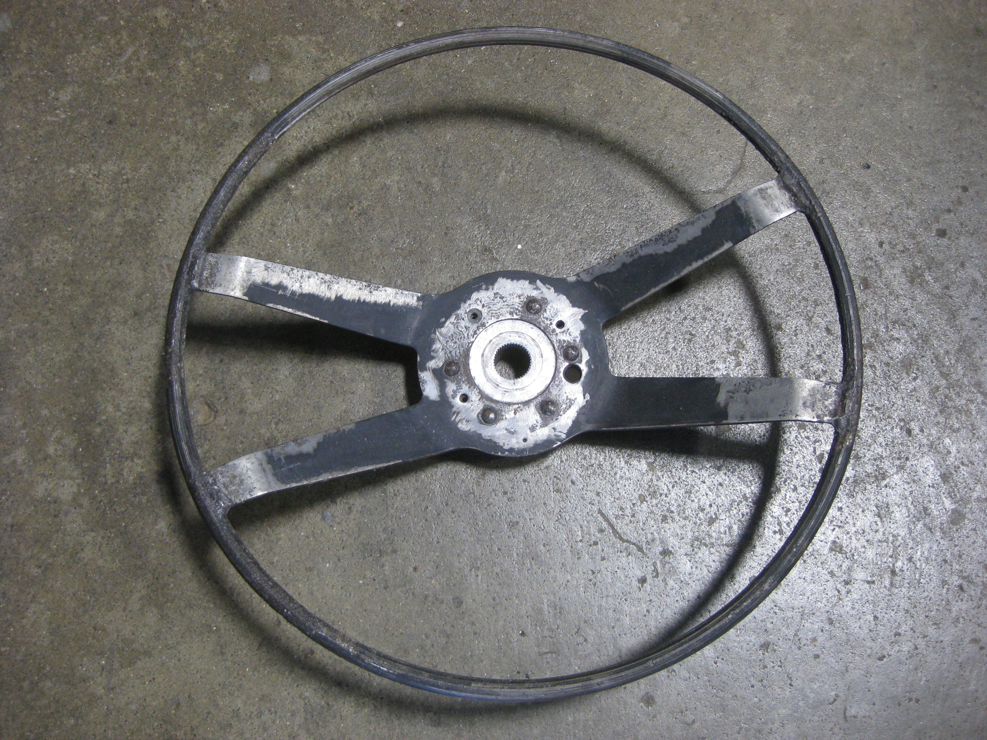

Rob...it's a round steel rim under the rubber/plastic....I think I have a picture or maybe even a bare wheel....if your rubber material is not loose and twisting you can have it recovered.

Thanks John and Bruce. I imagined it was a steel rim under there. Just never wanted to destroy a wheel to find put for sure.

here you go...this is what it looks like at the core....

Yea, don't pull off the foam. It makes a good base for leather.
Though you might want to trim back the foam on the spokes before you paint it. Otherwise the covered spoke part comes out a bit long.

Mark do you mean trim the foam on the spokes back so that after painting the wheel and putting the horn pad back on there is room for the horn pad to move? I thought about what to do there. I was afraid that with the foam that if that just got covered with leather, the leather would then ‘end’ just a bit closer to the center of the wheel, potentially causing interference with the horn pad.

QUOTE(johnhora @ May 20 2021, 07:29 AM) *
Awesome, thank you for that!! (IMG:style_emoticons/default/biggrin.gif)
Is this your wheel? I swear I’ve seen this picture before. Part of a post where the wheel was stripped so the dish could be made deeper? I may have to do a search and see how that was repadded.

Yes. You can always talk with Dallas custom to confirm but I found the spokes will be a bit long unless you cut back the foam. Do it before you repaint.
