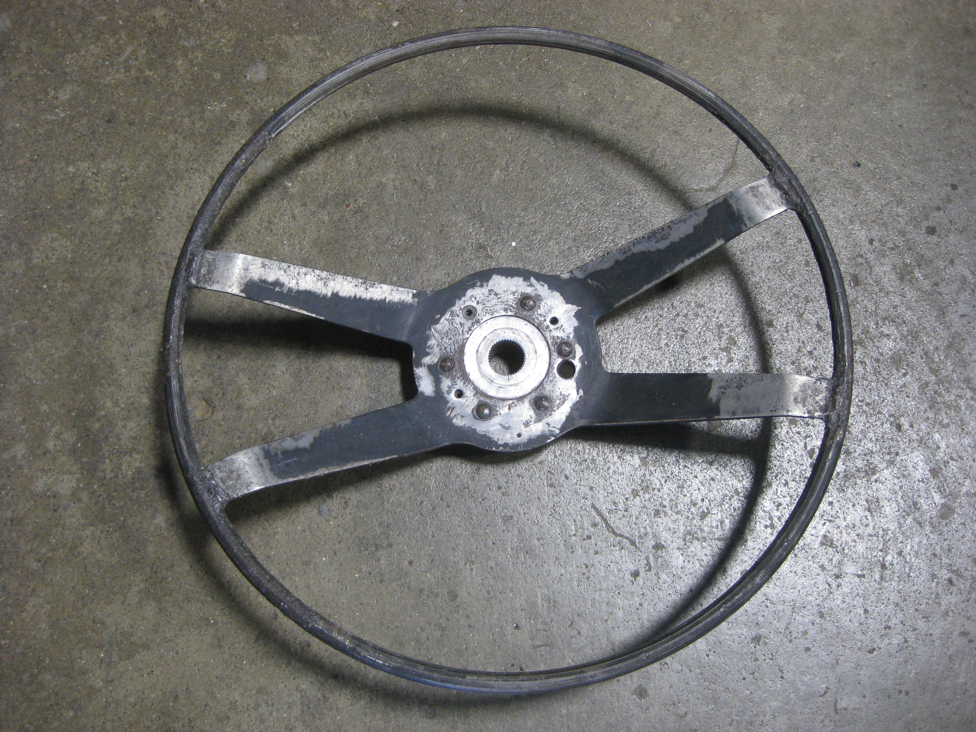

Rob...it's a round steel rim under the rubber/plastic....I think I have a picture or maybe even a bare wheel....if your rubber material is not loose and twisting you can have it recovered.

here you go...this is what it looks like at the core....
Yea, don't pull off the foam. It makes a good base for leather.
Though you might want to trim back the foam on the spokes before you paint it. Otherwise the covered spoke part comes out a bit long.

QUOTE(johnhora @ May 20 2021, 07:29 AM) *
Is this your wheel? I swear I’ve seen this picture before. Part of a post where the wheel was stripped so the dish could be made deeper? I may have to do a search and see how that was repadded.

Yes. You can always talk with Dallas custom to confirm but I found the spokes will be a bit long unless you cut back the foam. Do it before you repaint.
