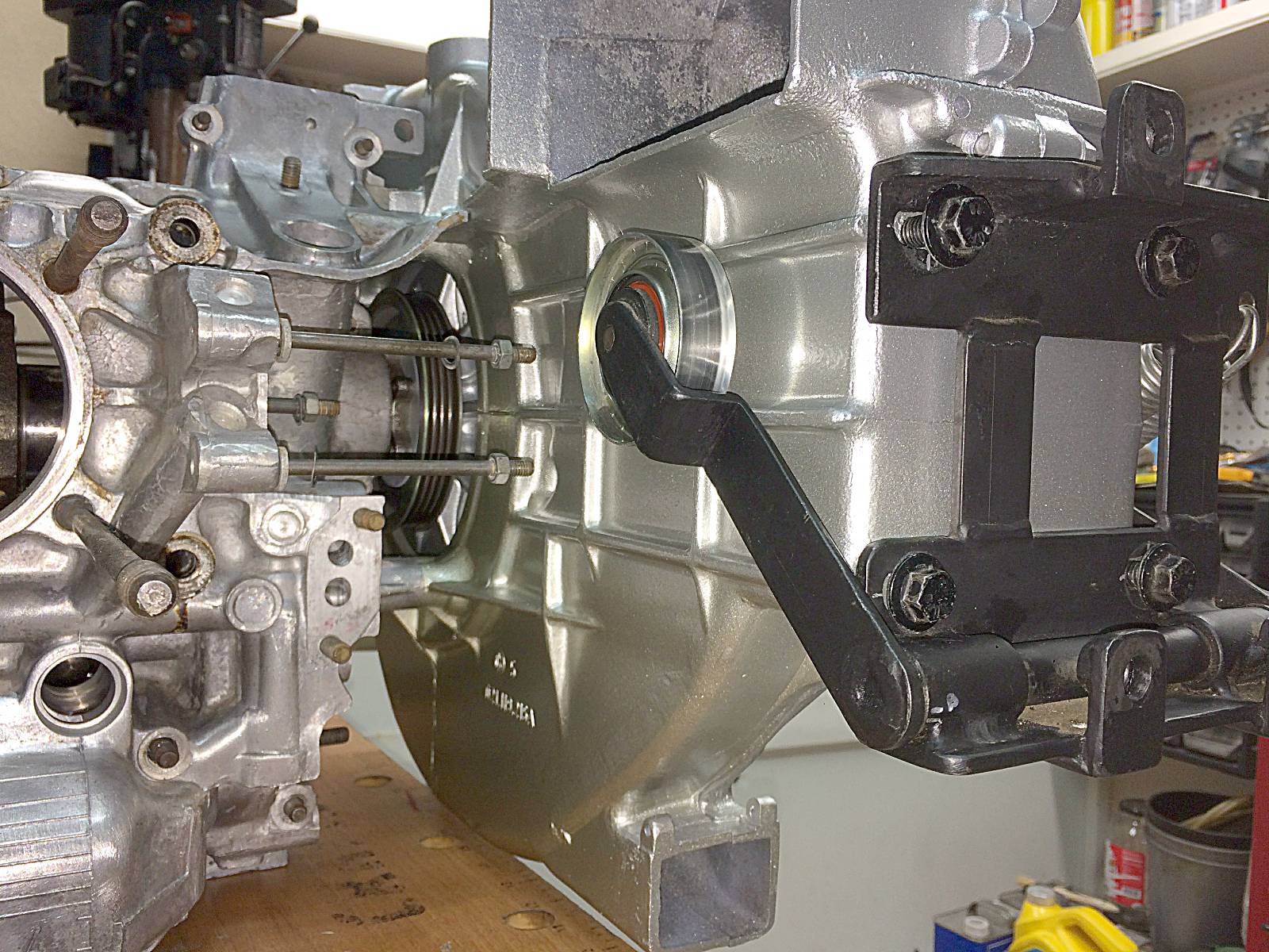

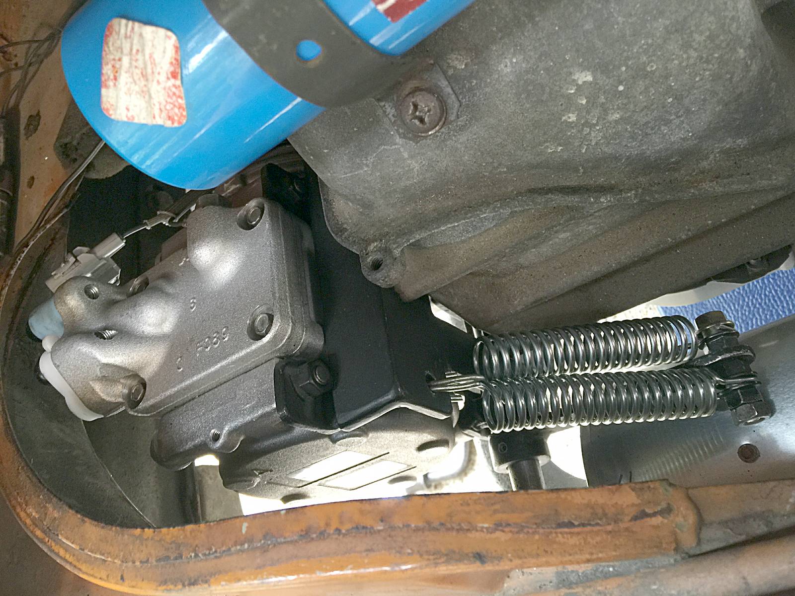

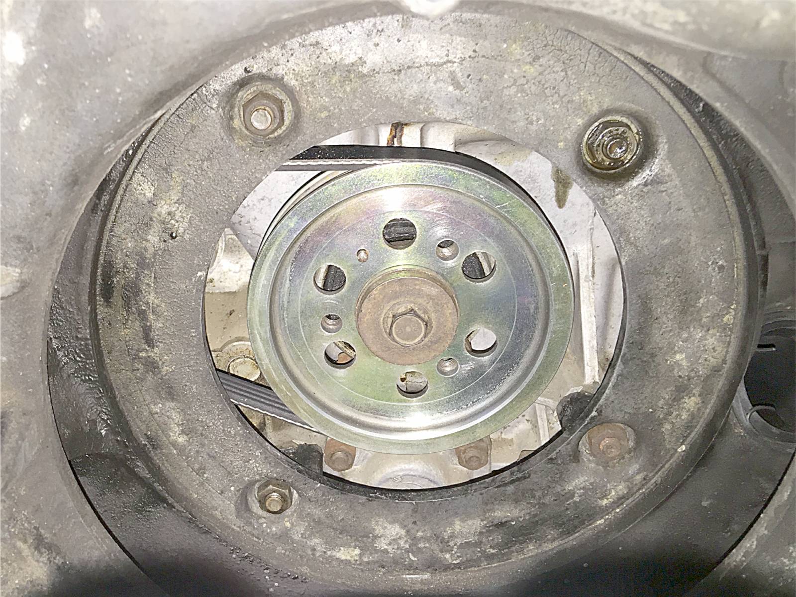

Here's something I came up with to mount a compressor on a type 4 motor in a VW Bus, using a serpentine belt. It has been bulletproof for about 6 summers now.
