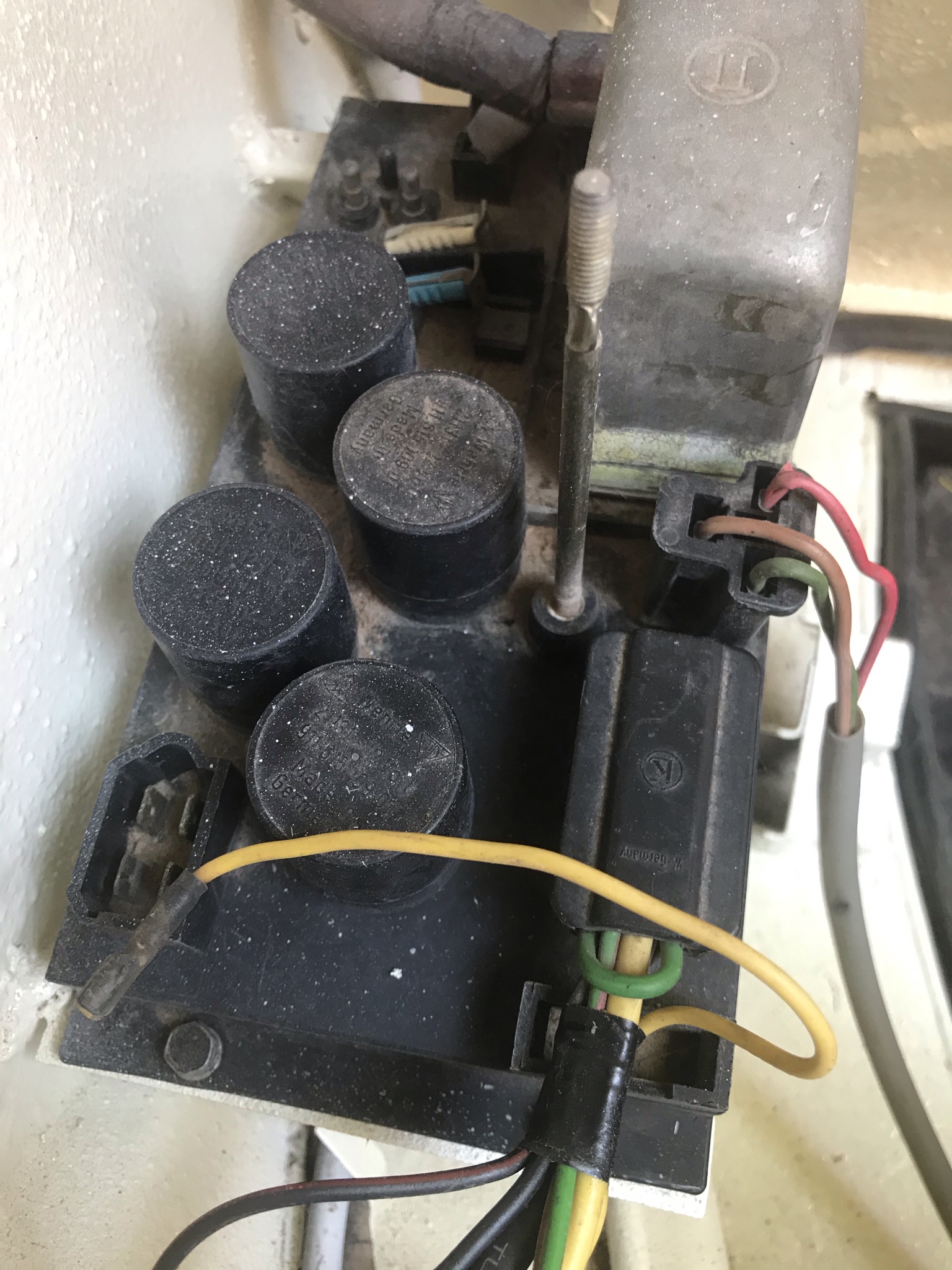

Front yard mechanic Color blind Jul 7 2021, 10:53 PM
falcor75 Yellow Jul 7 2021, 11:06 PM
ClayPerrine It is yellow, and goes into either of the rear two... Jul 8 2021, 06:19 AM
mate914 The red one has an issue, cut or sliced maybe :fla... Jul 8 2021, 06:39 AM
Front yard mechanic Thanks I was unsure . The front spades test positi... Jul 8 2021, 07:21 AM
burlybryan No. It's not plugged into anything on my carbe... Jul 8 2021, 08:59 AM
Ansbacher Agreed- I have carbs too and nothing goes to those... Jul 8 2021, 10:18 AM

mate914 I am also interested in this. Having a Double spin... Jul 9 2021, 07:10 AM
Front yard mechanic thanks for the help im inspired now and searched f... Jul 8 2021, 12:33 PM
ClayPerrine I just use a short piece of wire, an a spade conne... Jul 9 2021, 11:16 AM
