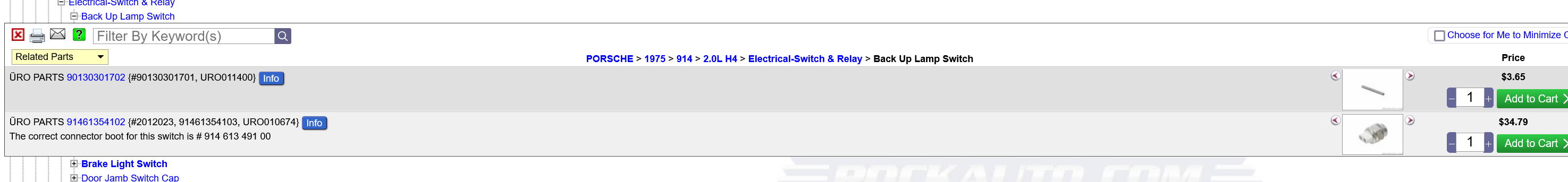

URO makes a replacement part. About $4 Cheap insurance. Screenshot from Rockauto, click to open

Thanks guys! Perfect information. Makes sense that it's about level with the fill plug.
I have a new switch and tang/rod already, so I should be good to go.
