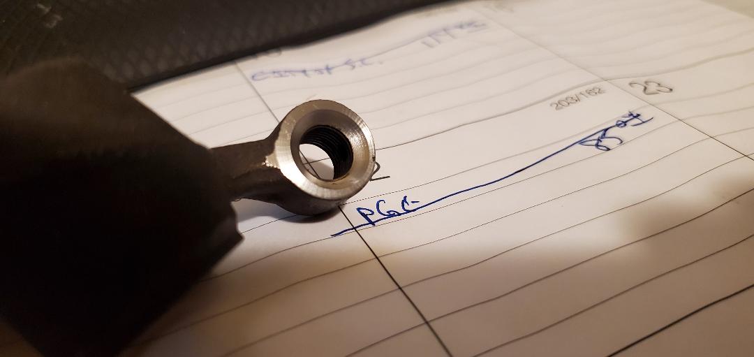

It's all been so long since the initial machine work was done I just don't remember any more. I remember it came up but foggy now. Anyone have a write up on what modified rockers should look like? Photo?

warpig
post Jul 18 2021, 11:13 PM
Posts: 290
Joined: 2-August 10
From: Portland OR
Member No.: 12,002
Just had mine done and they are still sitting on my desk. (IMG:style_emoticons/default/biggrin.gif)
