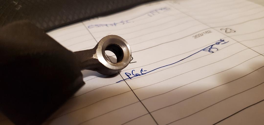

It's all been so long since the initial machine work was done I just don't remember any more. I remember it came up but foggy now. Anyone have a write up on what modified rockers should look like? Photo?

warpig
Click to view attachmentClick to view attachment

warpig
Got them done by a guy over on the Samba. bugguy1967
I will PM you his #
