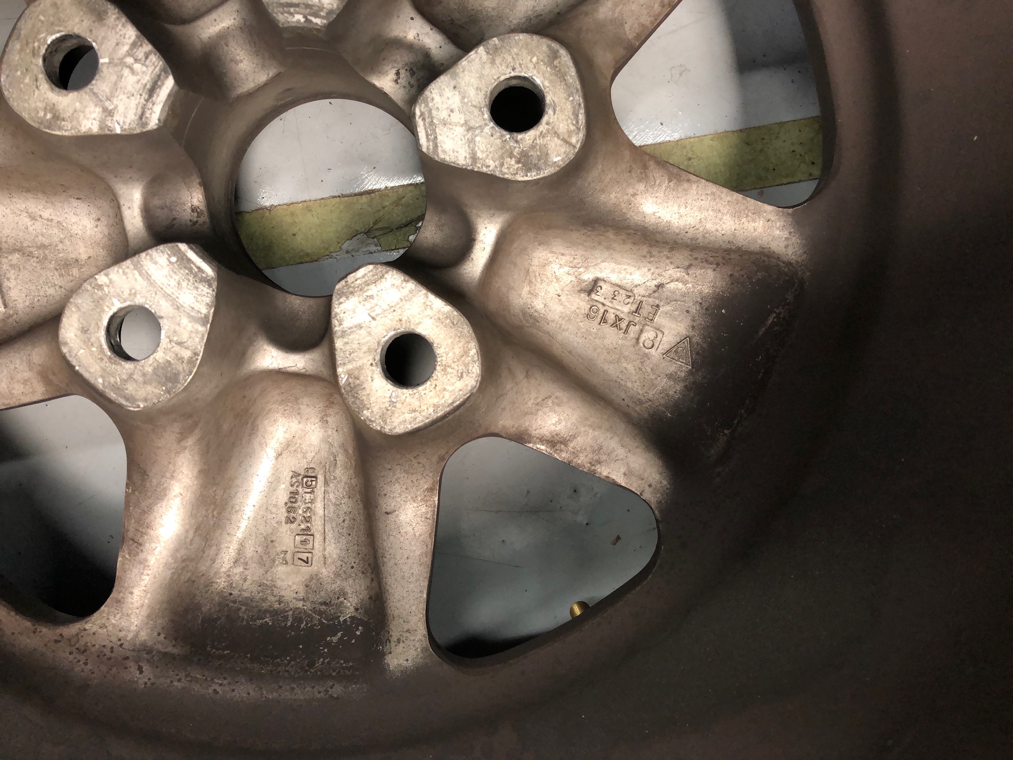

post Jul 21 2021, 12:00 AM
Distracted Member
Posts: 1,650
Joined: 25-August 08
From: Ladera Ranch, CA
Member No.: 9,463
Those look to be real, backside markings will look like this. The fox logo is below the “7” of the part number, it should be in the vicinity of the part number or somewhere on the hub. It’ll also have a triangle with two letters inside as you can see by the wheel size stamping.
