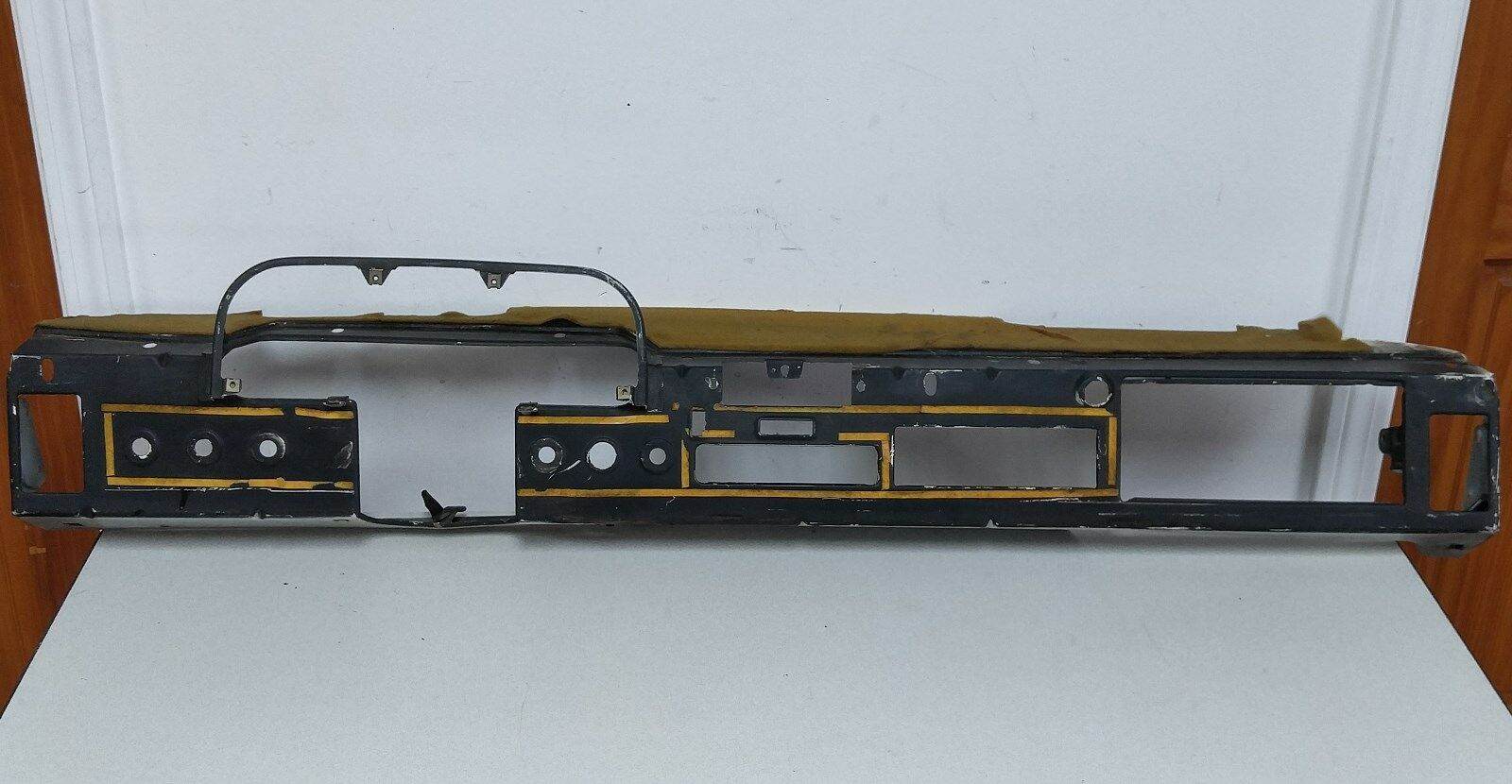

Hi everyone,
Realized I needed to create these for my car, any interest in these on the site? Plan to have a whole kit including the dash panels, clam-shell, etc.

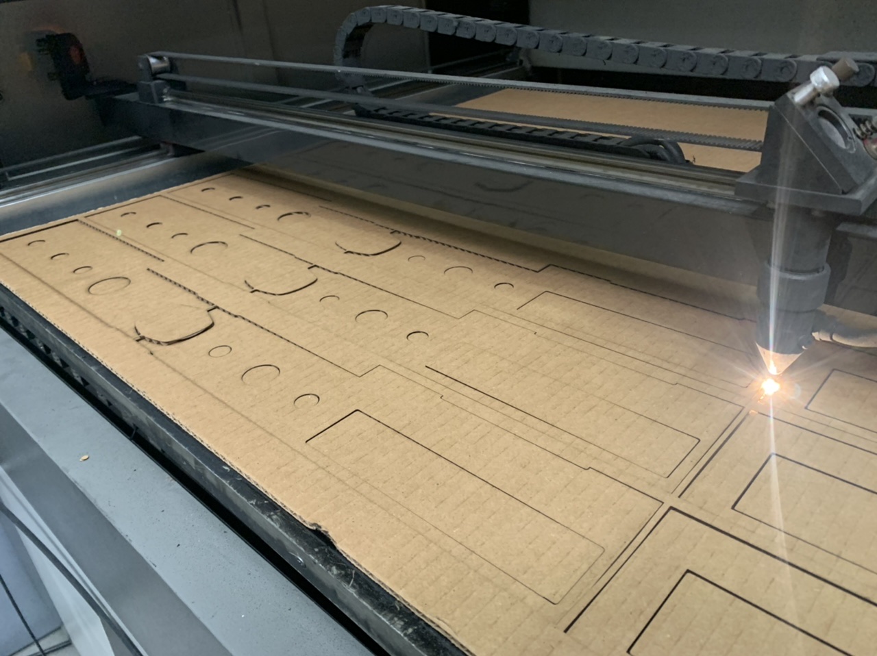

Testing these last night, few minor adjustments. I should have an ABS model this evening, and first pieces in 7-10 days. Elaborating on the design, I plan to have different models and the ability to customize; With / without radio or blower controls, glovebox, ability to use with later-dash(s), etc.
Simultaneously, will be pulling a mold of the 914-6 clamshell / trim-pieces and, maybe, the lower dash-pad.

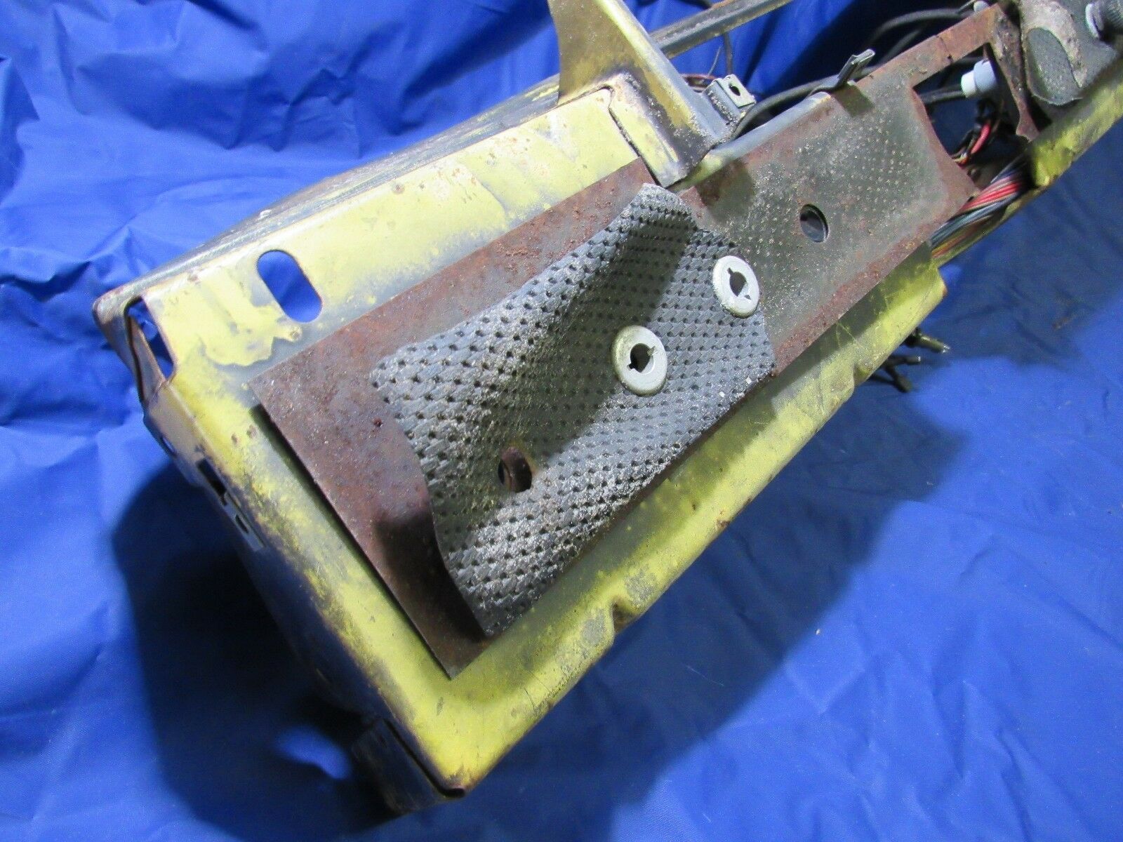

I haven't worked on the dash of my car as it is reasonably good looking. That beeing said, I am interested in what you are working on and trying to understand your offer.
If I get this right, there is an extra layer that seems to be double faced taped to the dash structure as we can see in the borrowed pictures online.
You are then offering that face layer that gets the vinyl, and you could offer to customize it, for example having a 52mm opening for fuel gauge? (IMG:style_emoticons/default/idea.gif)

@Montreal914 - Yep, all correct (IMG:style_emoticons/default/smash.gif)

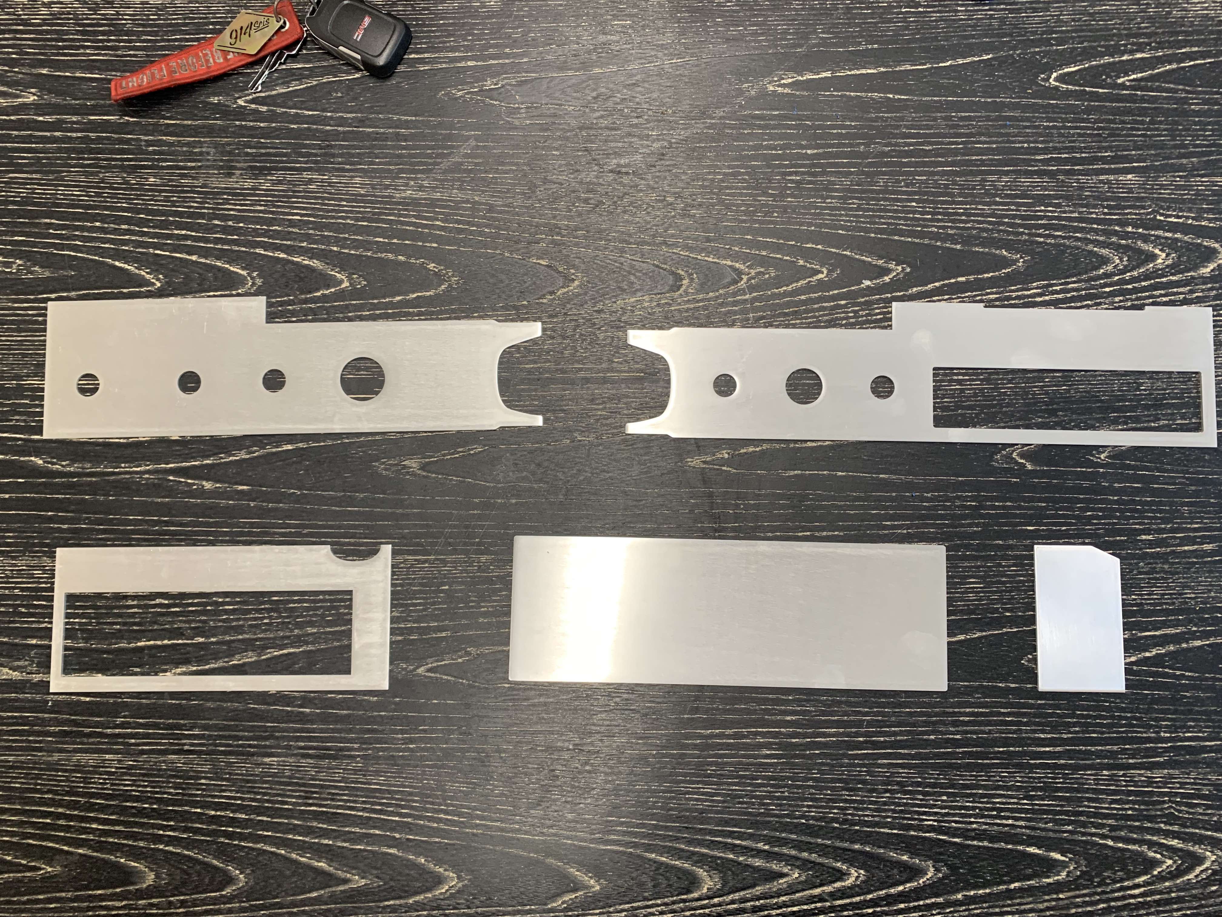

Happy to say that I finished the final test-piece last night, and first units are in production. Currently, all pieces are laser cut .080 Aluminum, and I'll be offering these initially for $150.00 - shipped. From my research, believe this price to be pretty competitive, as what I could find was at or over the $300 mark.
For those looking for 914 dash-plates, either somewhat 'stock' or with modifications (Holes, No-holes Radio delete, etc.) post here or send me a PM or email, enrique@914seis.com
I'm heading to Werks Reunion Thursday-Friday (anyone want to meet up?), so I hope to get a few pictures of the finished item this weekend or early-next week.

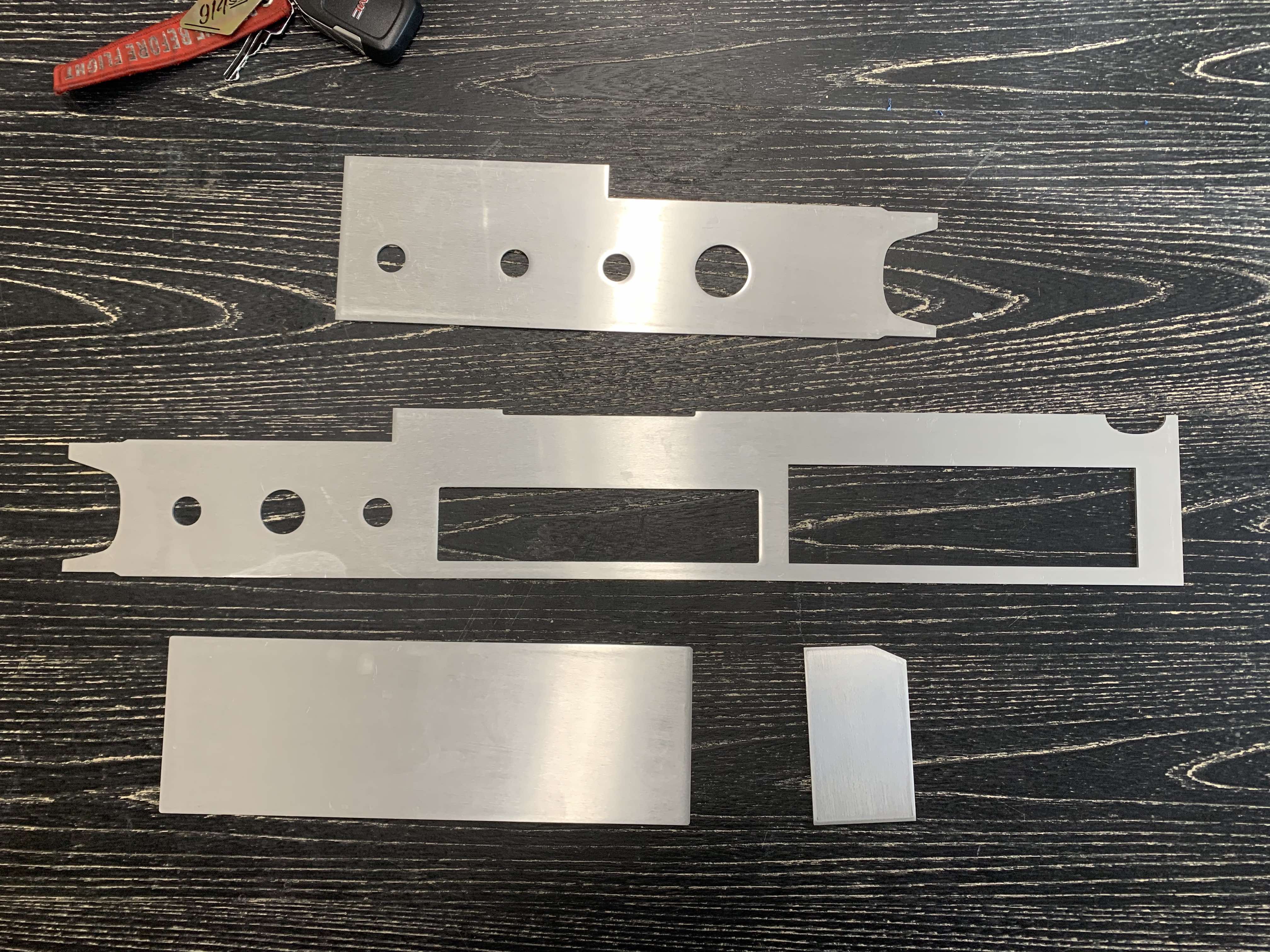

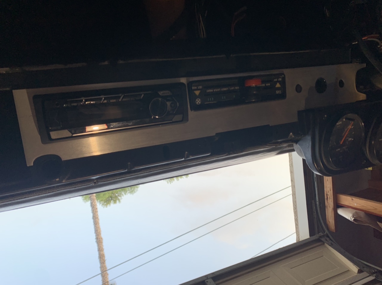

First units DONE! Very proud of how these turned out!

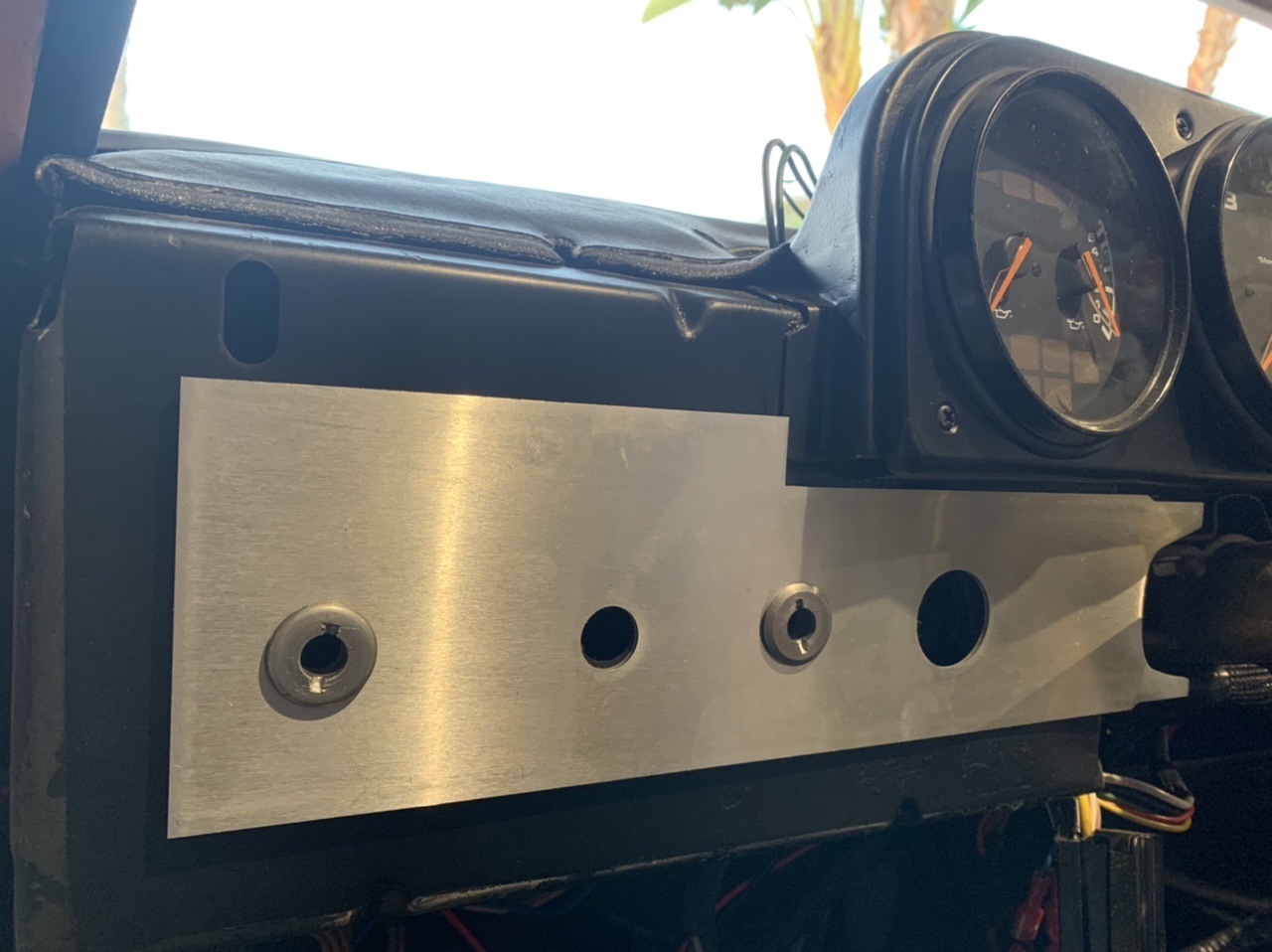

Test-fit these, and the fit is perfect. Almost a shame to put the dash-face vinyl over them, they would look great with a deeper-brush finish on the Aluminum.
