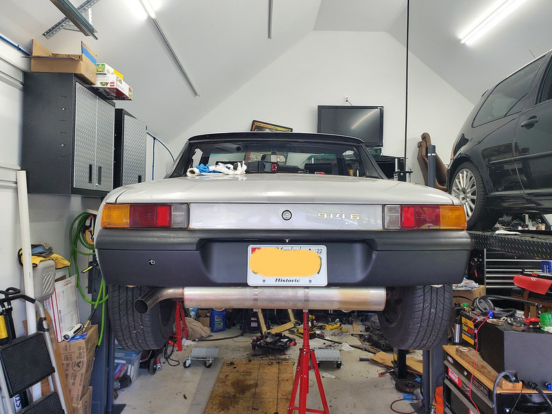

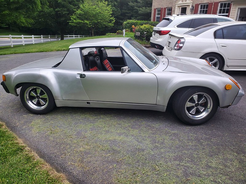

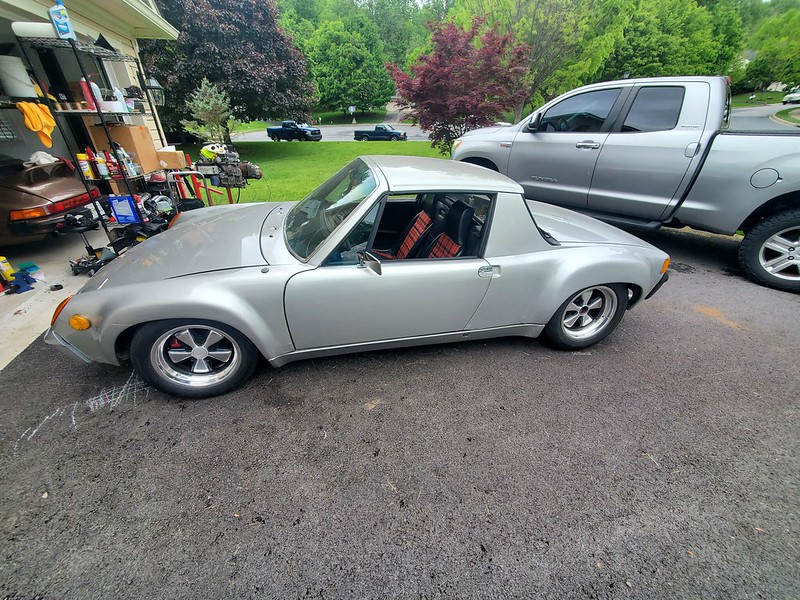

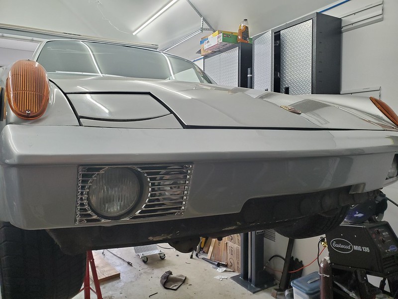

I got the rear bumper fully in place and just need to reinstall the parking lights. The front bumper is also now fully attached. I needed to cut out some of the grill boxes as the QRS fiberglass bumper leaves an outline. If I didn't have fogs it probably would have taken a custom grill cover and be fine. I did have to shave the top of the 914rubber grill as it would not fit flush in the QRS fog light opening. This must be a QRS quality control issue as the opening should have been able to accommodate. No biggie and it looks fine. Not like the front end of my car is pristine with some accident decades ago.
Still need to throw a piece of sheet metal up front to cover the gaping hole left by the AC removal.
(IMG:http://www.914world.com/bbs2/uploads_offsite/live.staticflickr.com-18763-1652917887.1.jpg)
(IMG:http://www.914world.com/bbs2/uploads_offsite/live.staticflickr.com-18763-1652917888.2.jpg)
(IMG:http://www.914world.com/bbs2/uploads_offsite/live.staticflickr.com-18763-1652917888.3.jpg)

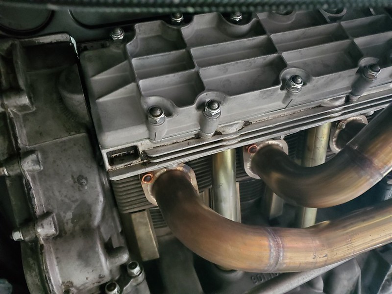

Take that leak, in fairness the old cover was most likely compromised due to the blue shop towel being pinched as well as just sitting in there. Thanks World for having pics of what to notch on the cover to get it to fit engine in situ.
(IMG:http://www.914world.com/bbs2/uploads_offsite/live.staticflickr.com-18763-1653077636.1.jpg)
(IMG:http://www.914world.com/bbs2/uploads_offsite/live.staticflickr.com-18763-1653077637.2.jpg)

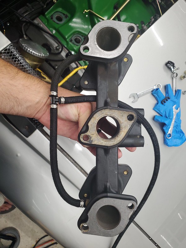

So I got the carbs from fduval who bought them from DaveO. Looked them over, sprayed some cleaner through the passages, ported idle jets, squirters, vents over from the existing Zeniths. Didn't touch anything but the air bypass to make sure they were fully closed. Started up the car and...same issue. Cyl 5 is low on the STE and fluctuating alot. Popping at 3600 not there, but that could be mixture screw adjustment, possibly even the squirter adjustment. Anyway, I took it for a drive and seemed like it might have been a little better or it was just in my head. Still popping, still huge backfire out the exhaust on decel. Ok I need to pull this intake off and have a look at the gasket/spacer/gasket setup. I trust the guy I traded the engine with, but after seeing the towel closed in with the valve cover I was not sure what else might have been overlooked.
Well it just so happens that the cyl 5 was missing an extra gasket OR that 4 and 6 had an additional. Regardless, this had to be the problem.
(IMG:http://www.914world.com/bbs2/uploads_offsite/live.staticflickr.com-18763-1653615807.1.jpg)
I was elated. I scraped off the other 2 and took it to some glass and 150 grit sand paper. I was able to shave some off cyl 4 and 6 which will also help seal. Got it back on the car and swapped items back to the original carb since that seems like it had no issues. Started it up and (IMG:style_emoticons/default/cheer.gif) she was running again with better numbers. I needed to open the air bypass just a minor amount if any to bring it up to cyl 4. I could tell almost immediately when I closed the air bypass all the way how the engine smoothed out. I was also able to remove the idle jet and it actually drop the RPM's down as it should. It was revving smoothly with no pops. The next test would be the butt dyno. Took her out and she was running good. No pops, no hesitation, no loud gunshot out the back on decel.
