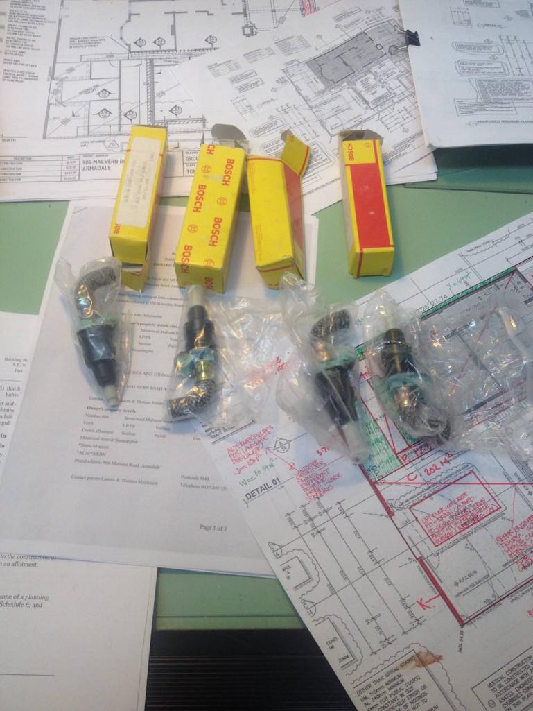

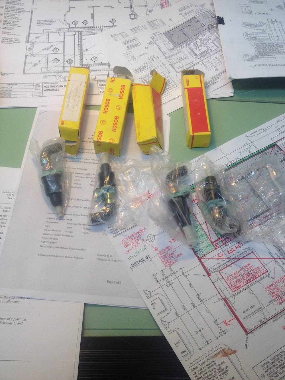

no - that # is right for a 1.8. you must be color blind (not insulting you (IMG:style_emoticons/default/beerchug.gif) ) - alternately i am color blind?
should be a blue color. maybe altered/faded with age?
some freshies. you seeing blue or green in this image?
i'm seeing blue.

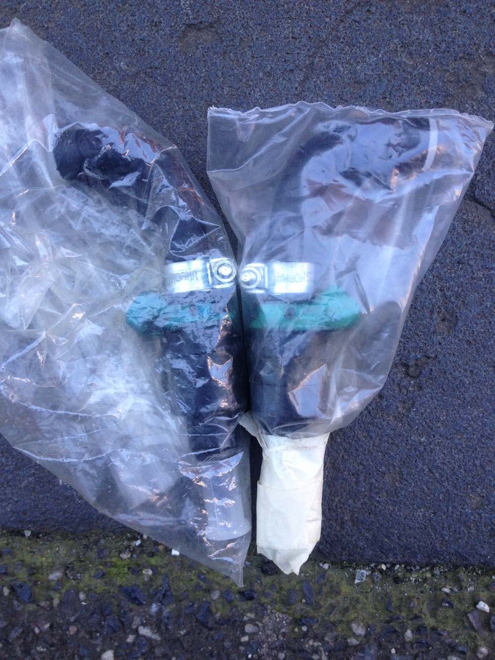

To me, those are closer to a green than a blue (IMG:style_emoticons/default/shades.gif)

i got the box down with the injectors i removed last year, they date from 89 when i installed them after buying the car.
two of them are blue and two are green.
i see one on right as a shade of green.
the ones now in the car are like the one on left - which i see as a shade of blue.

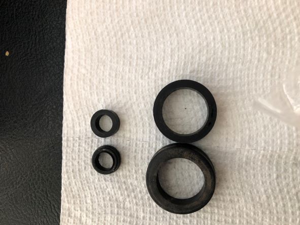

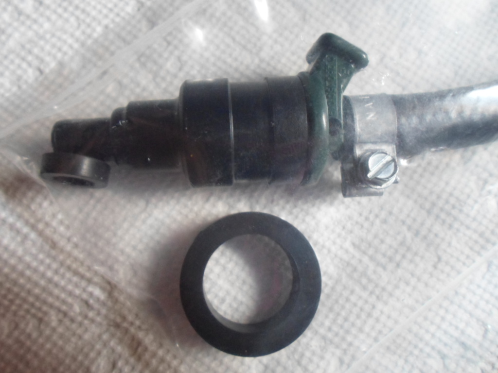

I received the SMP injectors from RockAuto. The body looks like a match, but the "nose" is way shorter and the hose is straight.
Also, I ordered new seals and the larger seal is quite a bit smaller than the original.
Will these work???

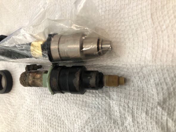

Just for a reference, because I noticed the "snub-nosed" design of the SMP injectors as well, here is a picture of my original Bosch injectors (2.0). This will give you some idea of how much they differ from the SMP in design. That said, they worked great.
The pic is AFTER I sent this one to Mr. Injector.
