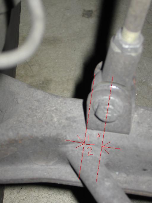

ask and you shall receive.....
Here's a pic of my passenger side a-arm with factory tab. The two lines represent the centerline of the u-tab where the bolt goes through, and the centerline of the bracing where it intersects the main part of the a-arm. That distance is about 1/2" (the u-tab being inboard of the CL of that brace)
Demick
McMark
post Aug 4 2005, 10:09 PM
Post #84
914 Freak!
Posts: 20,180
Joined: 13-March 03
From: Grand Rapids, MI
Member No.: 419
And roughly 6" from the torsion tube to the edge of the U Tab. That is the distance between the two, not including either. (Wouldn't that be called the exclusive distance?)

QUOTE (Demick @ Aug 4 2005, 08:27 PM)
thank you sir! (IMG:http://www.914world.com/bbs2/html/emoticons/pray.gif)
sooooo, is there a difference between the 914 a-arm and the 911 a-arm?
like in the placement of the small rod and/or u-tab ???
(IMG:http://www.914world.com/bbs2/html/emoticons/idea.gif) Andy

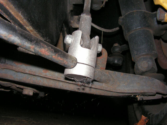

how about a lower mount that goes around the small round support rod on the a-arm with a top that can move freely and won't hit anything?
That's the set up that is used with SRP's front bars.
If you can't pivot the drop links with the car on the ground, that is a problem to start with.
The hime joints need to be centered and parrelell with the u-tabs.
here's the drops attached to the stock u-tabs.
KT

post Aug 4 2005, 11:12 PM
Post #88
I do things...
Posts: 7,809
Joined: 2-December 03
From: Napa, Ca
Member No.: 1,413
Here's the lower mounts installed below the stock u-tabs.
You can buy just the lower mounts from Smart.
KT

QUOTE (trekkor @ Aug 4 2005, 10:03 PM)
trek, with that setup, how far can you move the bar back (tighter) before the lower himejoint hits the u-tab (or is out of movement) ???
from your pic, it looks like it would hit long before you reach the end of the bar (to the right) ...
