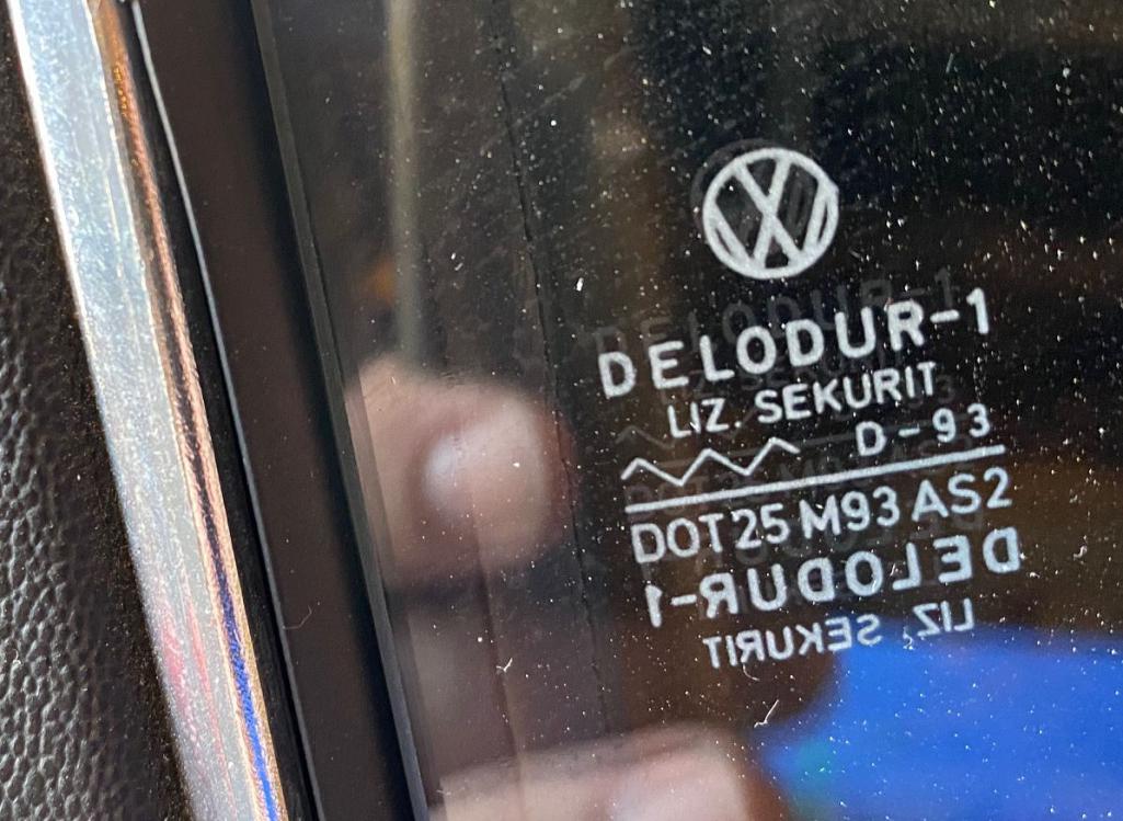

One side note, the 74?-76 glass has VW/Audi logo. Do not know change over time frame though.
Early 1973 built up to Jan 1 1973 had the 70-72 early glass. Jan 1973 was when side beam was required and inertia seatbelts were required, door glass had to change with it to later style

QUOTE(914Sixer @ Sep 13 2021, 05:29 AM) *
Both sets of early glass that have been in my doors had the logos—now curious if all early glass had the logos?
I've always wondered about those markings, as the glass has to be unique to the 914, no? Not exactly "on brand" for a sports car that was marketed, sold, and supported as a full-fledged Porsche in its biggest market. Perhaps there was a legal reason for the four markings on the door windows…?

Side window bug from a late 1974 model. This one is clear glass.

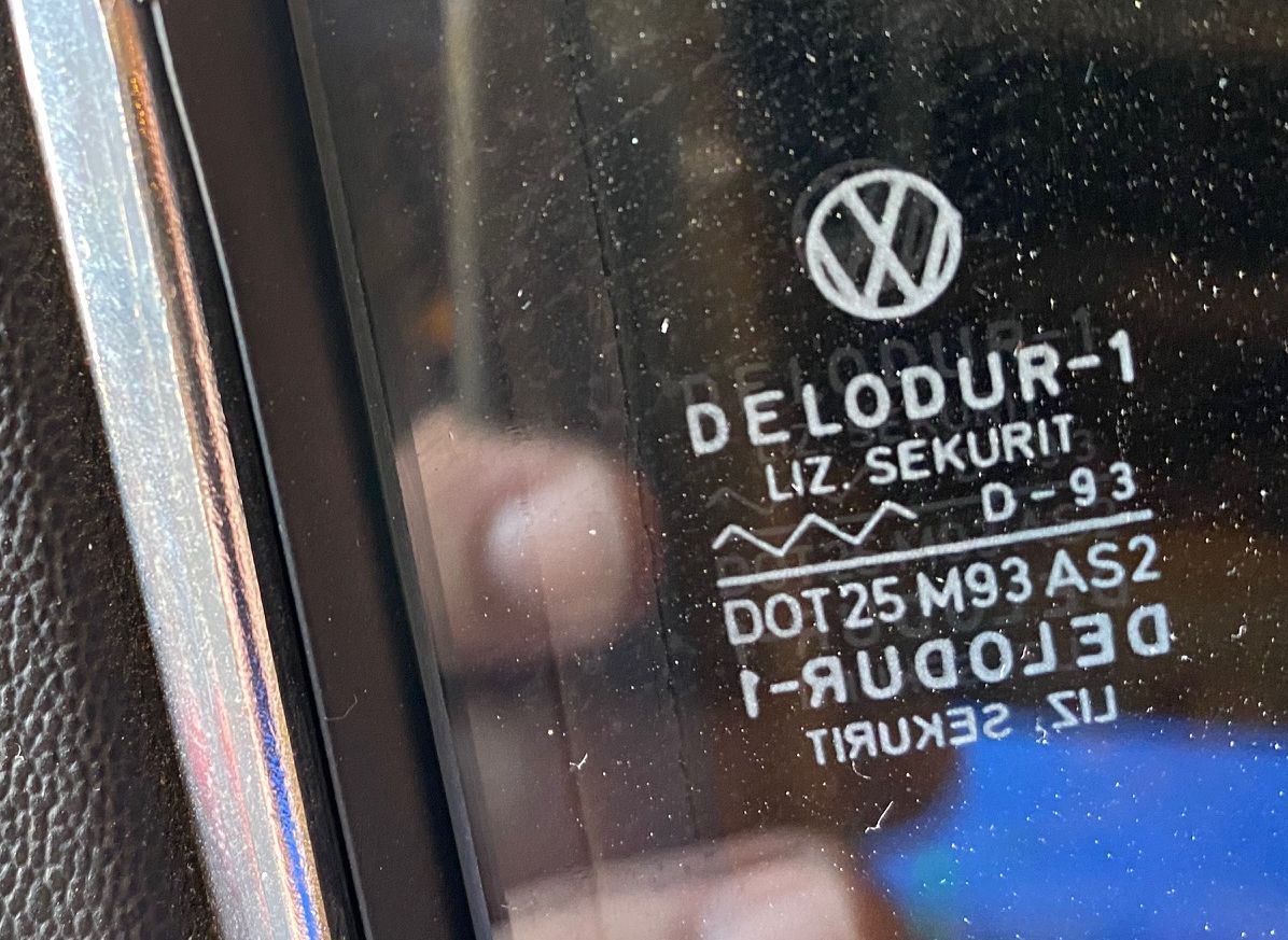

Early 73 doors had late glass and regulators, earl door posts with the fuzzy insert and not reinforcement bar.
Thanks Bruce, believe that's what I've got. Its got a 72 manufacture date but a 73 VIN. Its not one of the early 1000 cars with the vinyl on the windscreen frames, but is an early 73.
