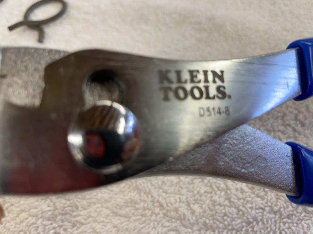

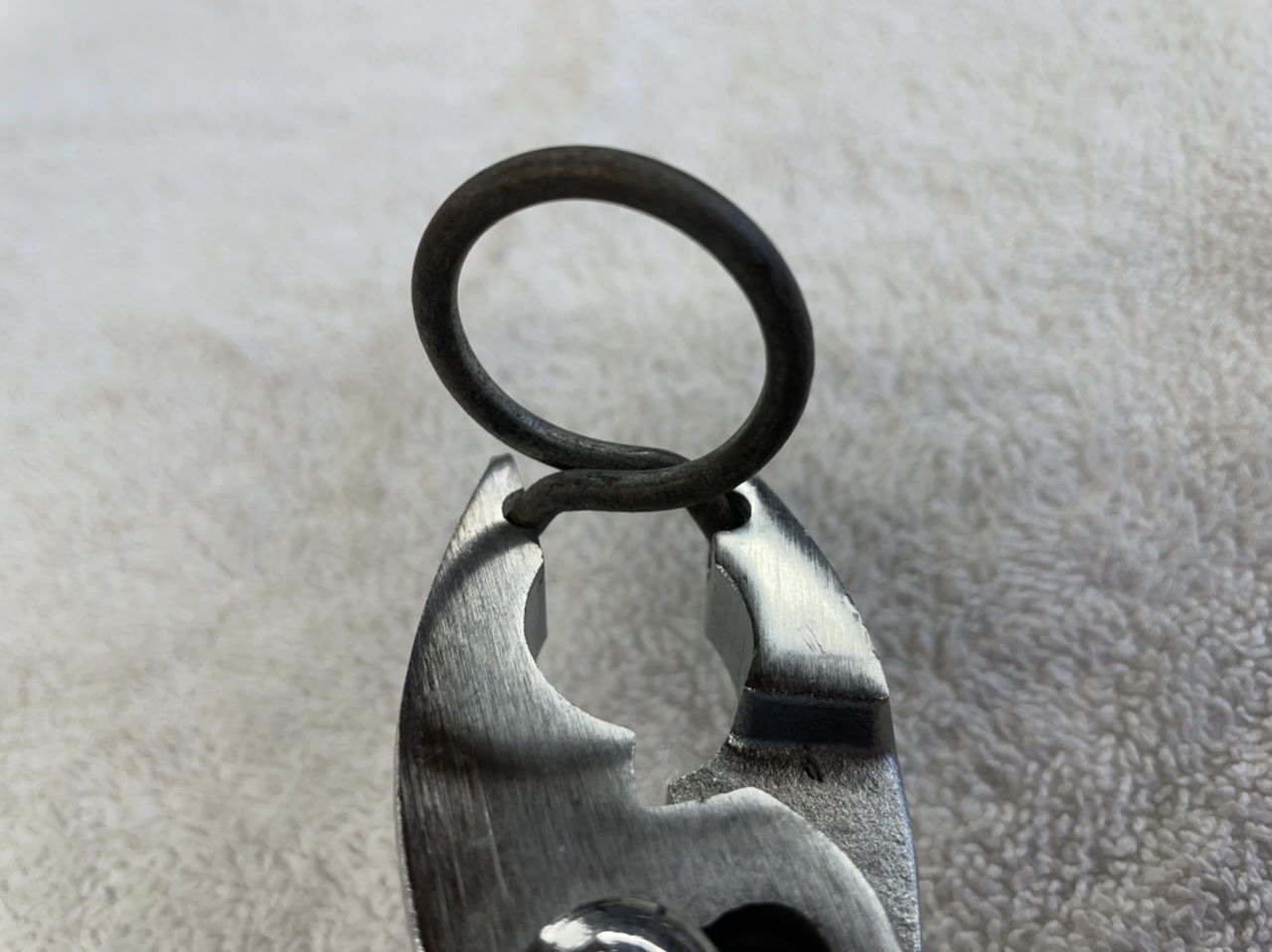

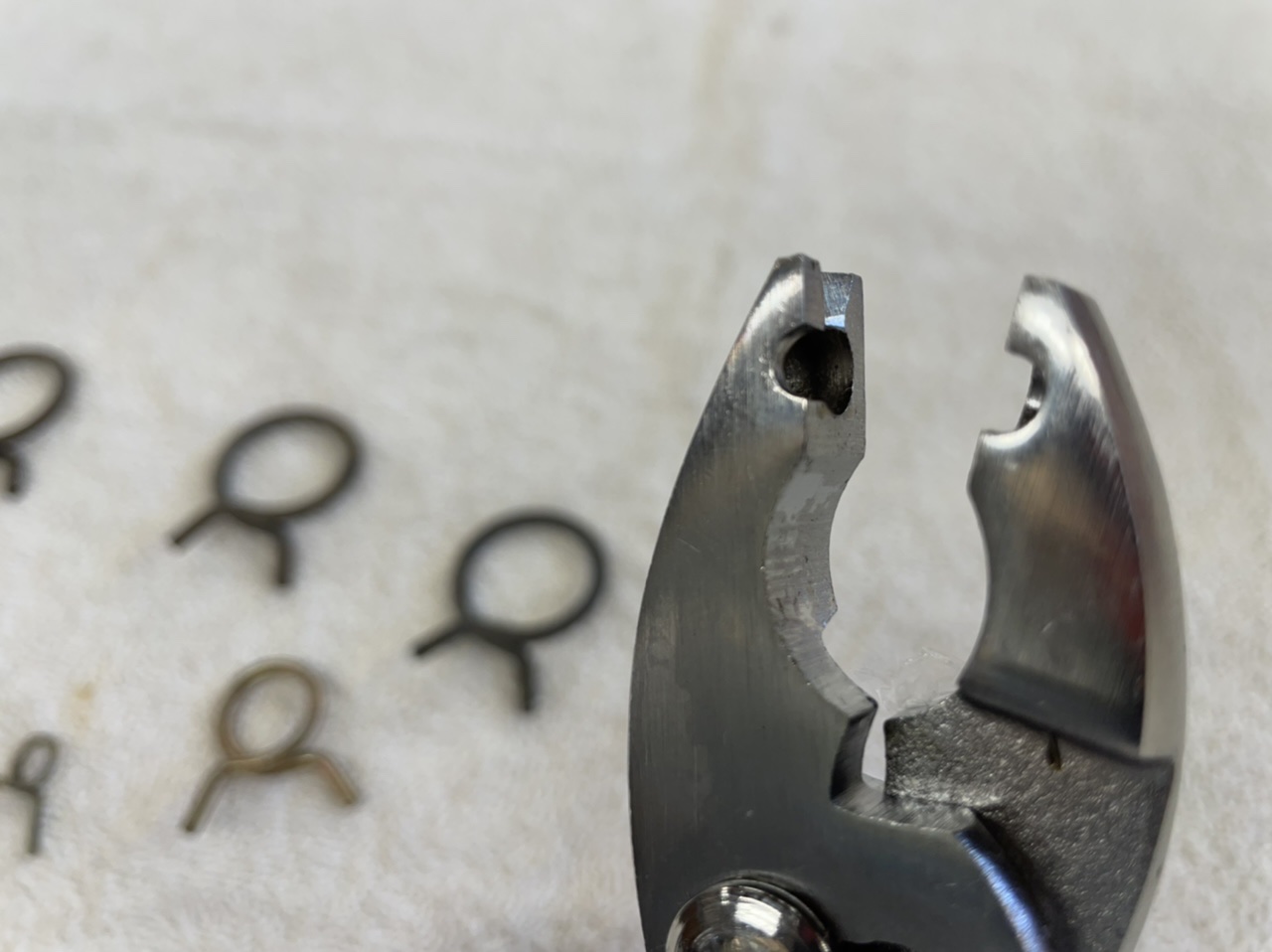

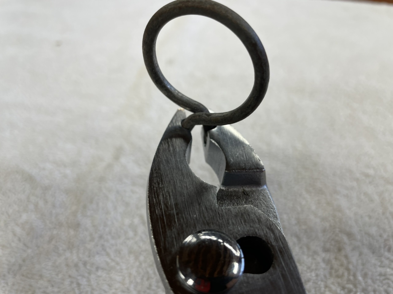

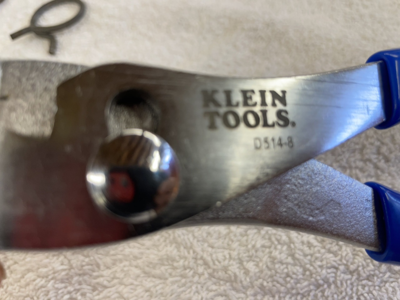

We all probably tried squash ueezing a wire clamp with pliers and POOF -it’s flying…
Thanks to Bruce Stone; I ordered the Klein D514-8 slip joint hose clamp plier from
McMaster/Carr
Works great on all sizes of wire hose clamps

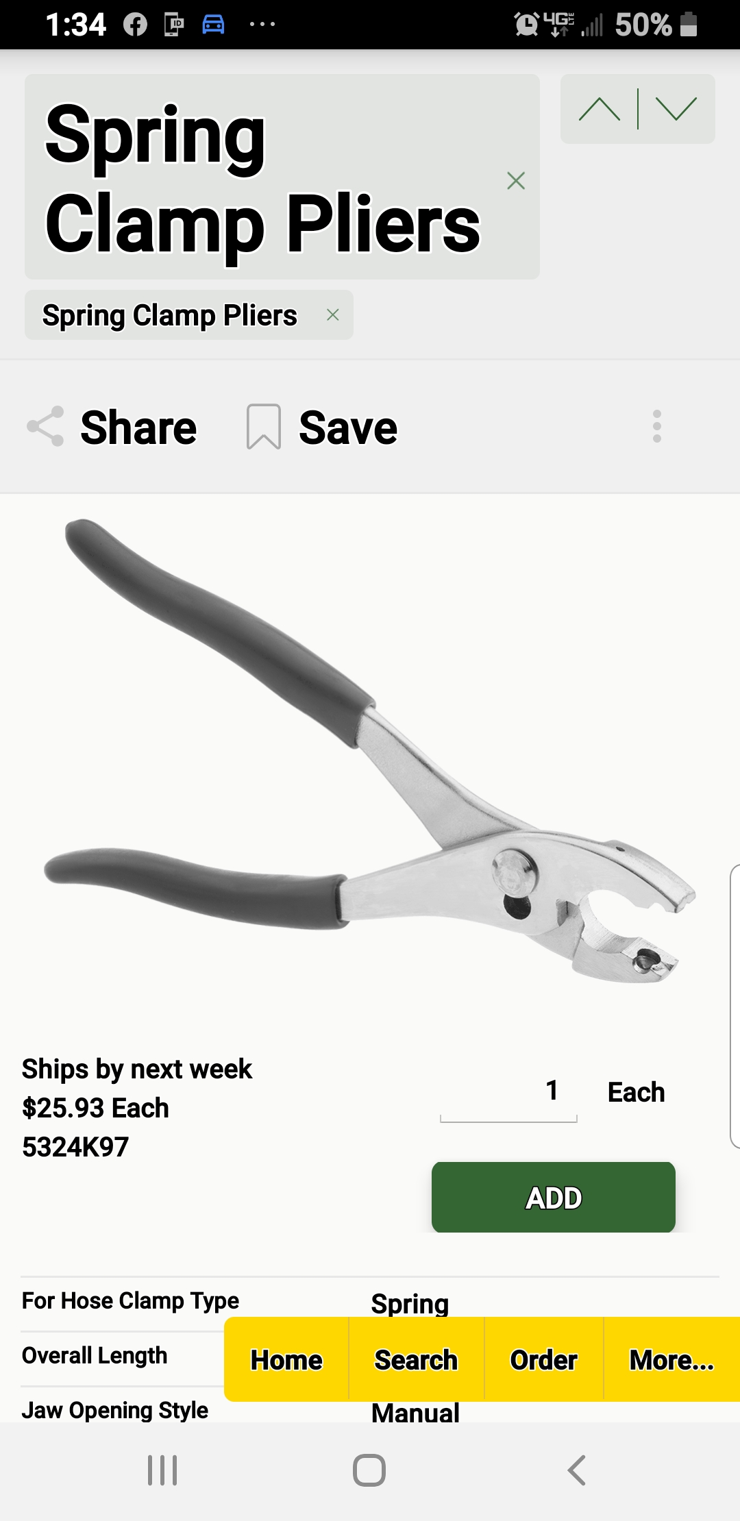

Mc Master Carr has several types. Or cut a groove in a pair of plyers

Thanks Bruce. That’s the one. Their web page shows it gripping a wire hose clamp… (IMG:style_emoticons/default/smile.gif)

Updated first post after receiving the tool.,.

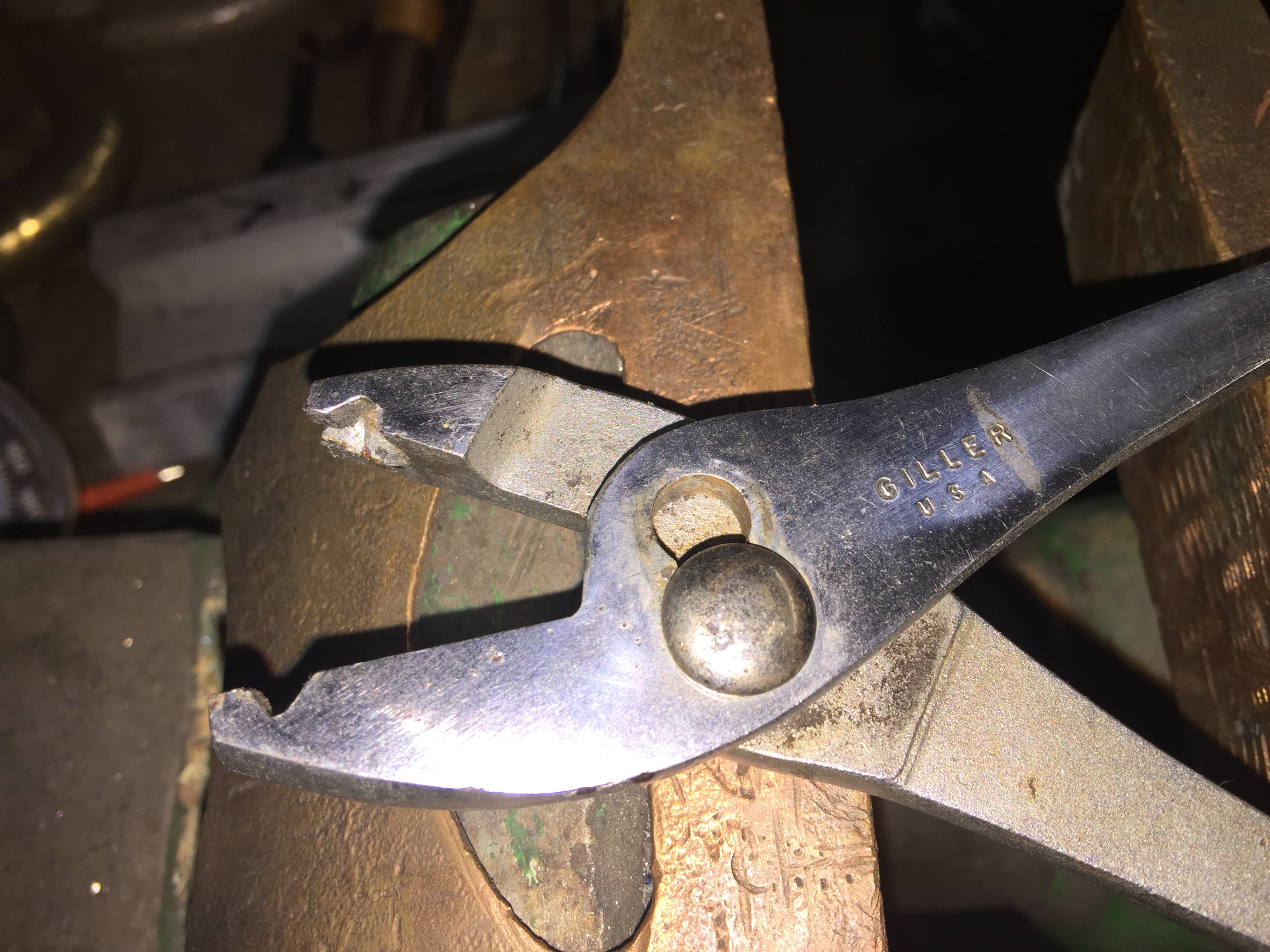

Even my old set of gillers will get the job done. Might have paid 5.00 for them used
