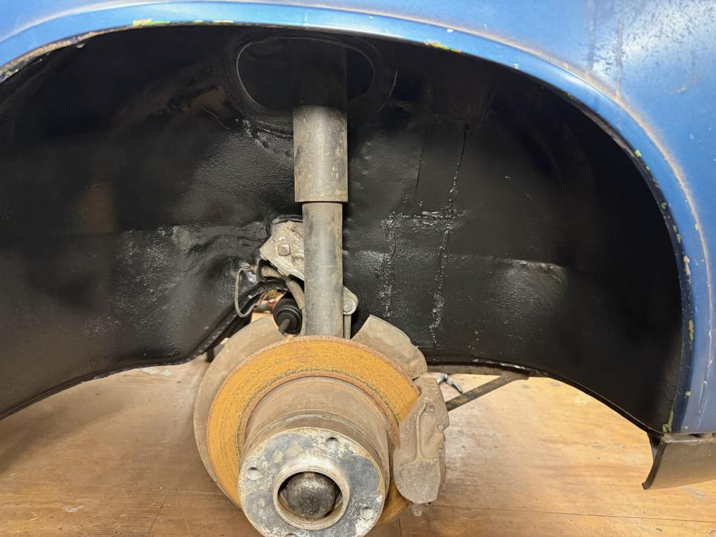

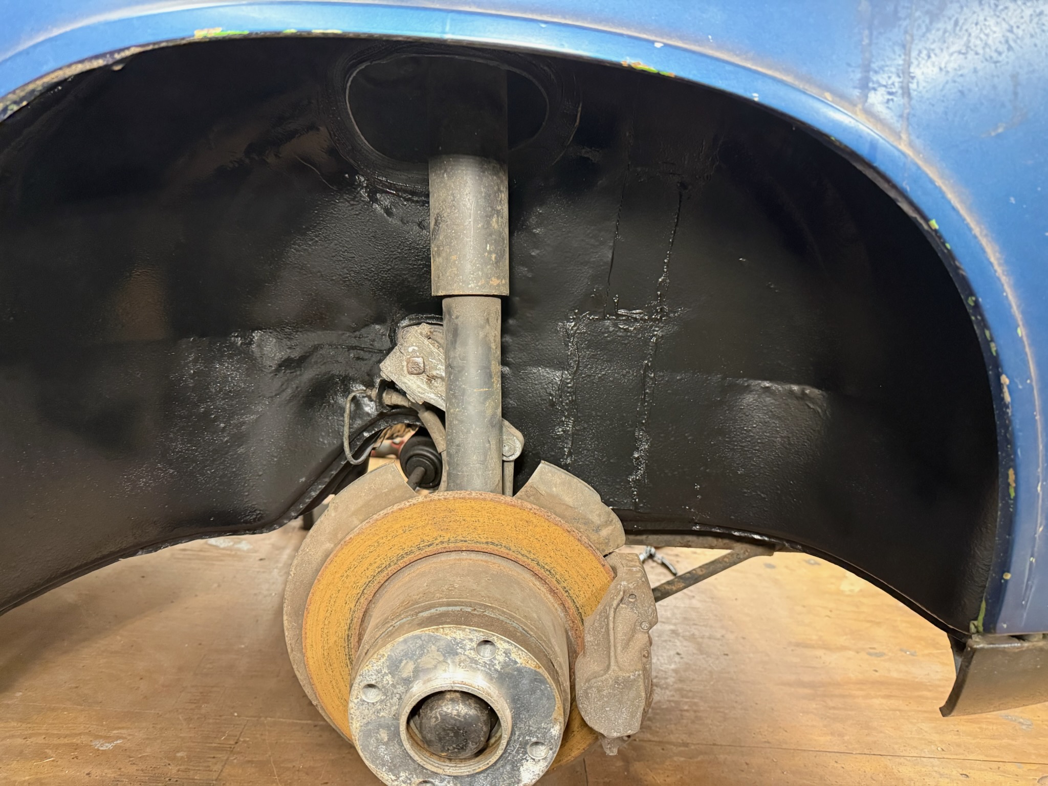

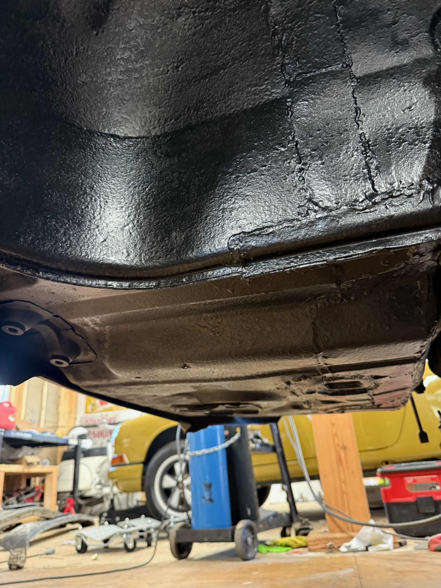

Underside of the front end is now 2k primed, and sprayed with a stone guard.
My garage is extremely cold right now so I preheated for 2 days to get it up to 65 degrees to spray and cure. (IMG:style_emoticons/default/beerchug.gif)
So the suspension is now ready to go back in and will once again be a roller!
The list has been whittled down so much now to really just a lot of little day jobs.

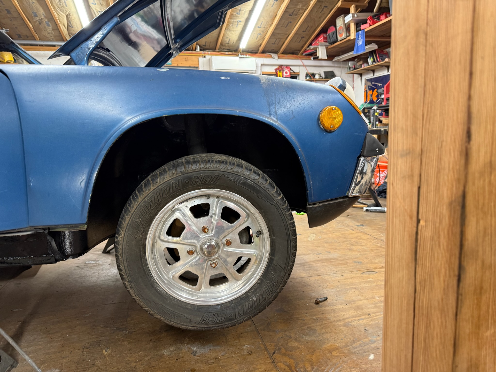

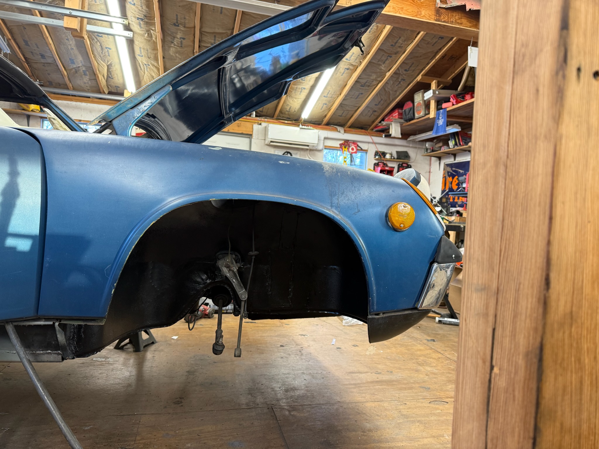

Pictures from Jared. It has wheels !!!! (IMG:style_emoticons/default/shades.gif)
