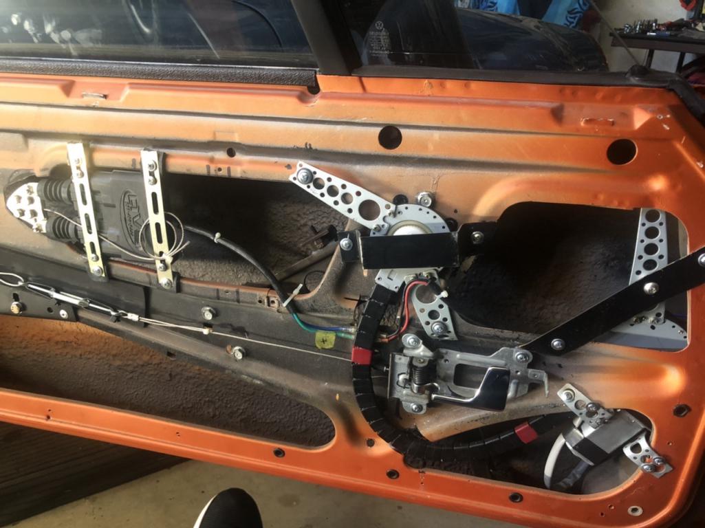

Both doors have electric windows and vernier actuators that open the doors. Sounds better than a clunk from solenoids. I want to take the doors apart to see how they are setup.
Way cool how they setup the vernier actuators and electric windows.
Still going through the car. Got rid of the gas smell, by adding back the stock expansion tank and charcoal canister. I’m also having Dr. Evil build a 914 trans for it with tall gears.
The rear view camera and display gets easily washed out with too much sunlight, so I installed a stock rear view mirror and visors. Im also adding RS door handles. No way to close the doors with the windows up. I also installed a rotary switch in the dash to get the fresh air fan working again. I’m leaving the outside alone.
