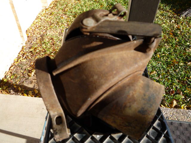

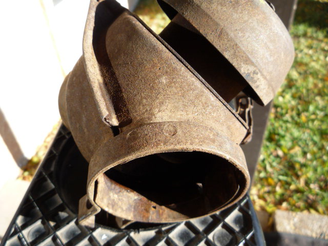

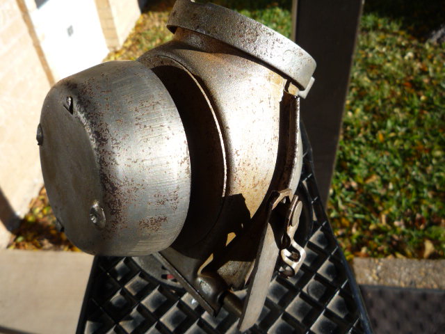

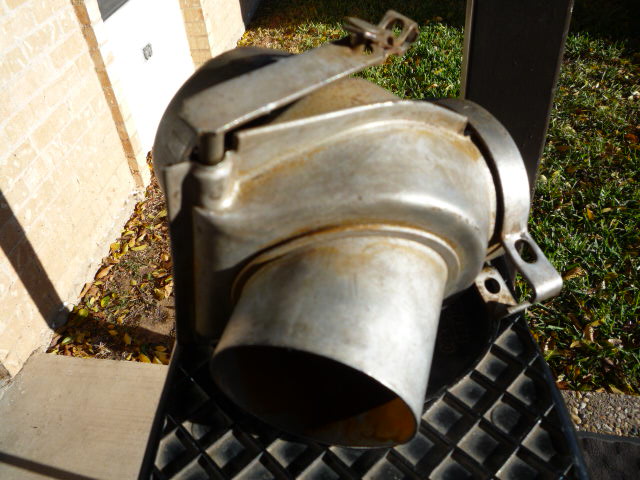

You will need a bucket, gallon of white vinegar and quart of lemon juice. Depending on the bucket size, mix 2 parts vinegar to 1 part lemon juice. Soak part along as needed. Pull part from time to time and scrub with small tooth brush size wire brush. Keep repeating until you are satisfied clean enough to paint. Wash, dry and get ready to apply paint as flash rust will appear as soon as the part is dry. Took about 6 hrs to soak and come clean. Going to finish off with wire wheel. Before and after, you can see flash rust .

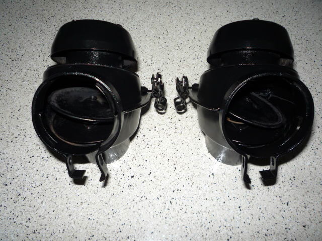

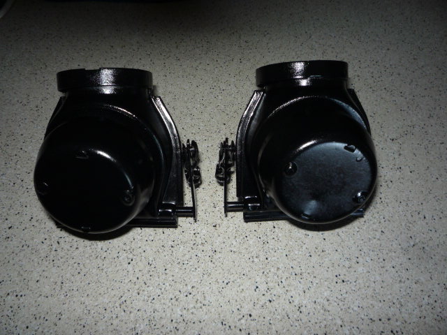

Final result

Very nice Mark, thanks for sharing. Mark

Turned out nice!
